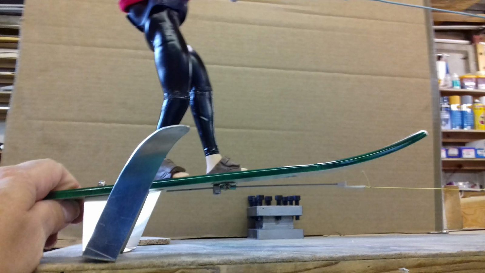

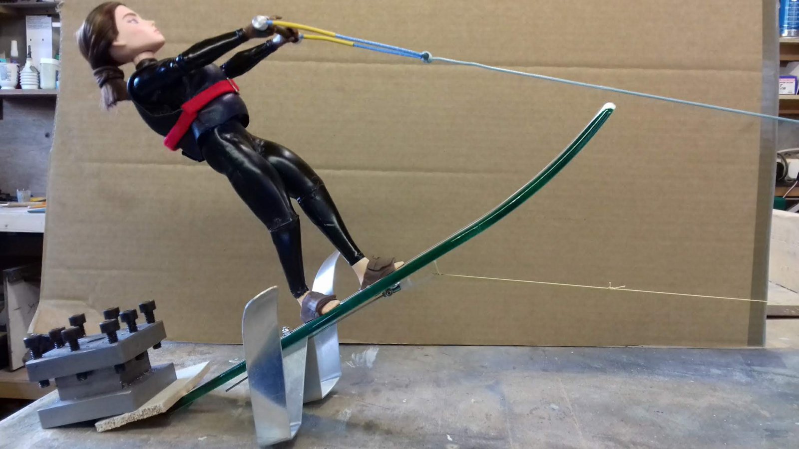

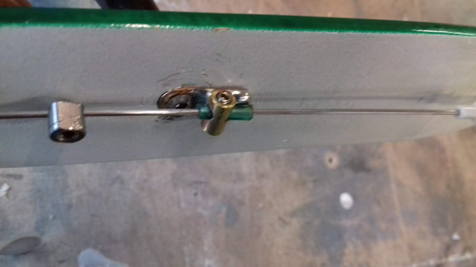

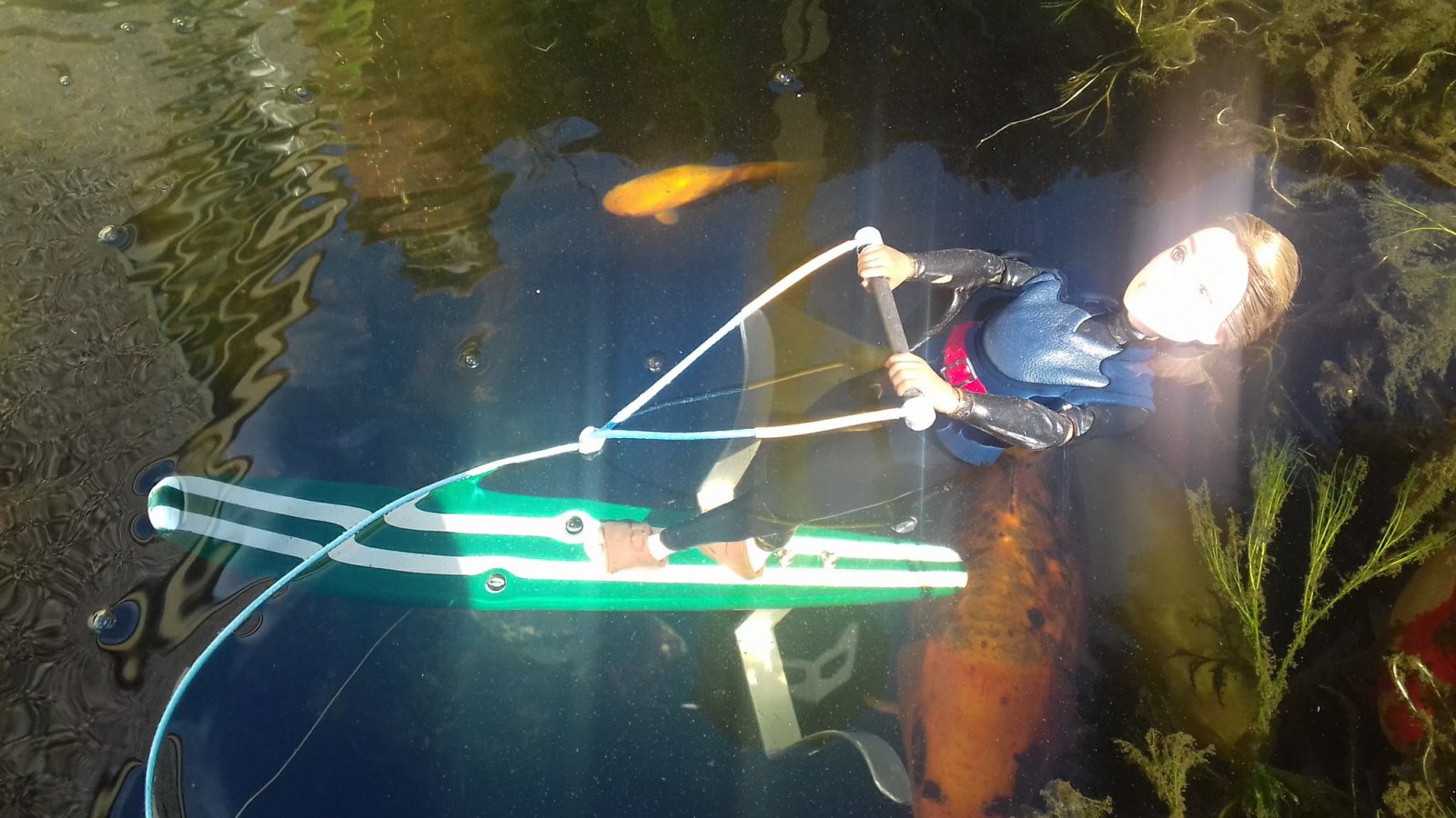

I have made a new ski. Printed in two pieces a flat bit then the curved bit printed hollow and vertically to 1mm wall ,I then cut foam and pushed it right inside. It worked now the ski sits pointing upwards ready to do a deep water start. Will be testing today.
Lex, you are the master, So tried today, the green ski worked with the lightweight foil, though the aluminium is a bit soft and needs regular bending. It can't pull her nice and straight up from deep water, because of the different rope lengths, don't see a way round that. So at rest in the water is a different angle to actually skiing. When I set off she is dragged sideways for about 3 meters then she pops up. I would love to see her rise up as the ski is pulled.
It's some trial and error before such a skier works well. Getting her straight out of the water is also difficult with my skier. Usually it's sideways for a short time, and then she pops up.
What might help are a bit longer foil tips that rize out of the water more. (from what I can see your's are a bit shorter then mine) That way they generate more torque to turn the skier upright. A bit wider foils will also work that way. I use aviation grade aluminum 1mm thick for the foils. That bends a lot less easy then your average hardware store variety.
Mine also takes a meter and a half or so to get up. Later in a corner she falls over, and needs a bit more speed to get back up again. In the first pass you can see the foil tips over the water surface. Also try experimenting with the angle of attack of the ski, that also might help. I trim the ski to maximum AOA, up to the point where its starts to jump. Then a few degrees down, and you're in the sweep spot.
The heavy duty blades for the ski failed, but that could be the curve not set right, but better to find some stronger 1mm ally.
The new green ski worked well with the old lightweight blade, however I can't get her to rise vertically out the water due to the difference between the rope lengths. Got my thinking cap on and what if i made a pulling rod to the ski exactly the difference between the ropes. This would be made stiff to pull by grub screws, so to start i pull the rod back. Then as she rises the rod slips into the skiing position, I know, it'll never work but i may try anyway.
The friction on the rod can be adjusted, also the ride angle of the ski is also adjustable. A gentle pull to start keeps both lines tight, then as she rises more power pulls the rod and the angle changes. When the rod is in final position the ski is at the right angle for running. That's the theory

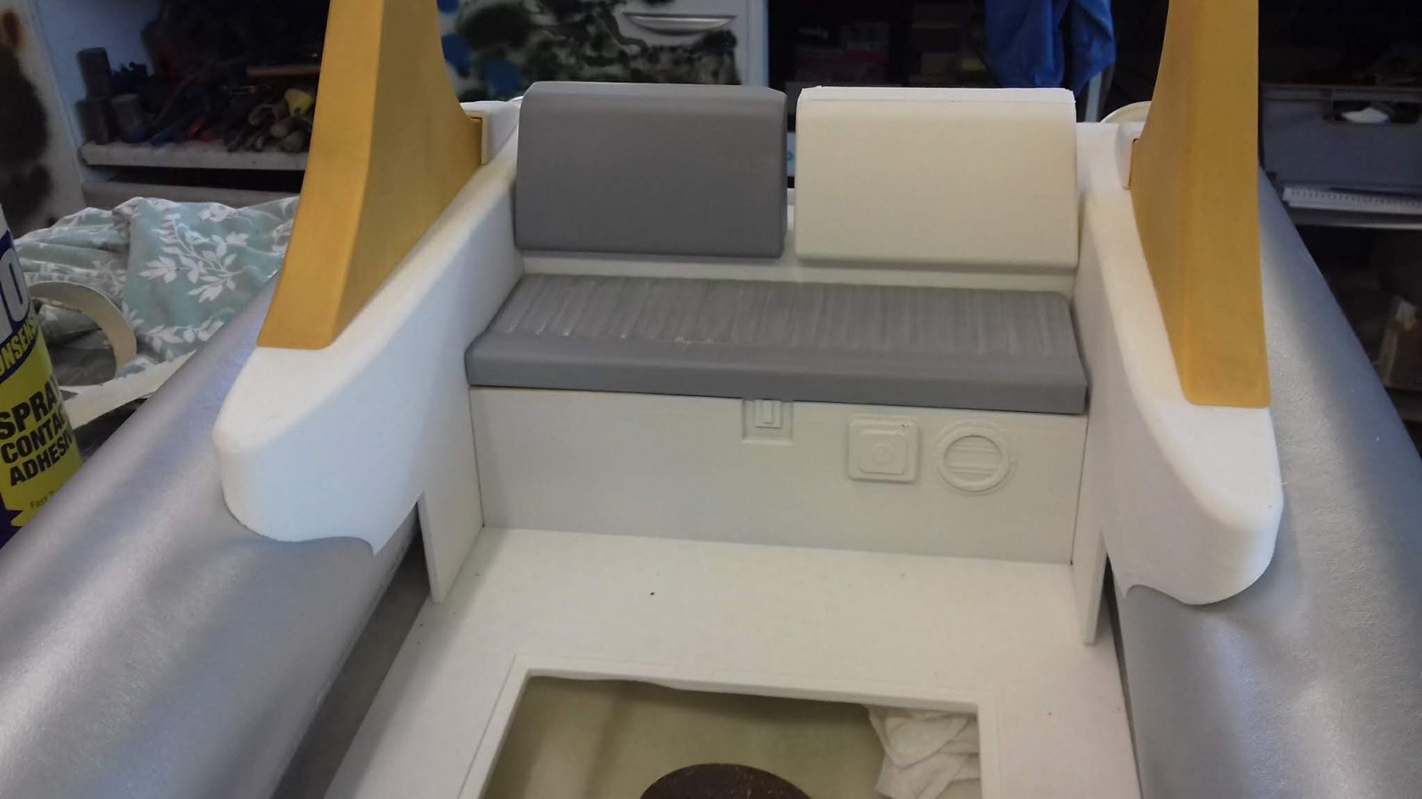

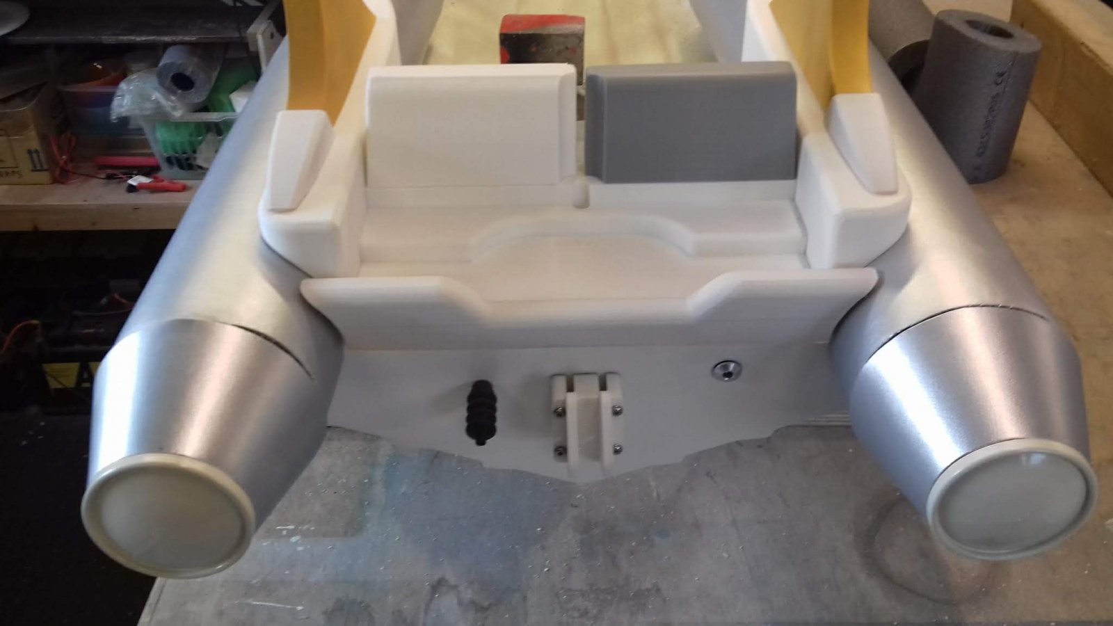

I am building a new ski boat, it is a RIB with a fiberglass hull, it will have a dedicated ski pole between the rear seats. It will be powered by my own Yamaha outboard.
