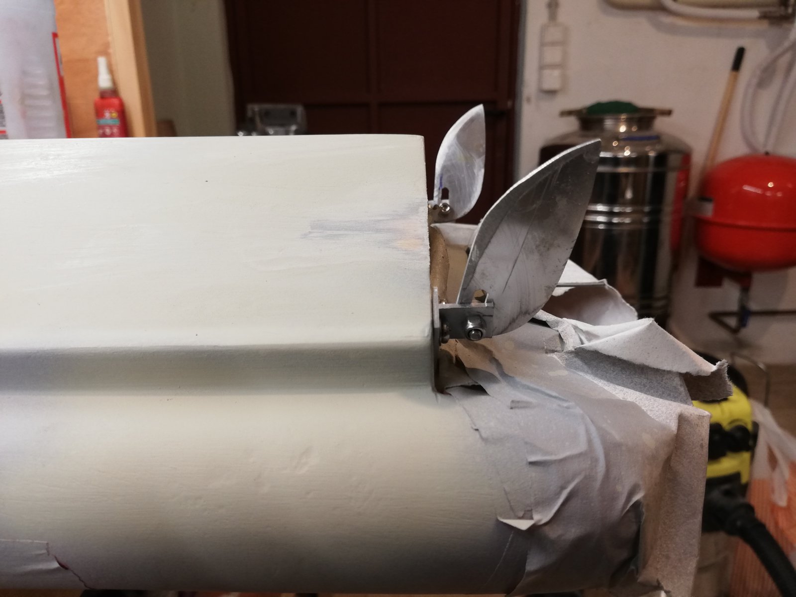

    De spiegel wordt steeds voller; de turnfins zitten gemonteerd. Ik heb ze gemaakt van aluminium hoeklijn en 2mm carbon plaat.
    De vorm heb ik afgekeken en de lengte is zo gekozen, dat ze bij rechtuit varen het water niet raken.

  19. Dim L
    Dim L
    18 aug 2021
    891
    Athens, Greece
    Fantastic work Jan! I love every single part of it.
    The cockpit came out super cool and I will make a copy for the mini monos.;)
    The turn fins are just perfect and you won't believe it but yesterday I also made adjustable turn fins for the Penarib.
    To be honest I didn't know how to adjust the turn fins in terms of height and angle and I was planning to ask here in the forum.
    So the general rule is that the turn fins should not touch the water when you go straight, right?
    Dirk Jan, Unusual RC en cadcam vinden dit leuk.
  20. Dirk Jan
    Dirk Jan Forum veteraan
    2 apr 2003
    3.548
    Veenendaal
    That's a coincidence Dim and your turn fins look good . Did you make them from steel or aluminum?
    I'm also new to turn fins and I don't know about the height- and angle adjustment either. I made the height adjustment in the bracket instead of in the fin.
    Let's experiment with it. I guess the effect is not much..
