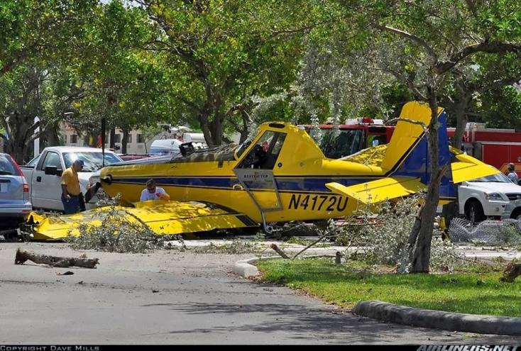

The purpose of the flight was to deliver the agricultural airplane, which had accumulated about 10 total hours since new, to its owner. The pilot was attempting to depart from a 3,502-foot-long asphalt runway. The pilot reported that the airplane accelerated to takeoff speed and lifted off without incident; however, it would not climb out of ground effect and settled back on to the runway. The pilot continued the takeoff attempt, allowing the airplane to gain speed while on the ground for another 1,000 feet, and rotated again as the airplane approached the end of the runway. The airplane climbed to about 10 to 15 feet above the ground before settling again onto a grass area that extended about 600 feet beyond the runway. The pilot subsequently aborted the takeoff. The airplane traveled through a chain link fence and struck trees.
A postaccident examination of the airframe, engine, and propeller assemblies did not reveal any preimpact malfunctions. The airplane weighed about 8,384 pounds during the takeoff. While the normal maximum takeoff weight for the airplane was 7,000 pounds, the airplane’s maximum gross weight for agricultural purposes was 9,170 pounds. According to a representative of the airplane’s manufacturer, at the conditions reported at the time of the accident the airplane’s ground roll was estimated to be 3,373 feet, and the air distance to clear a 50-foot obstacle was an additional 3,195 feet.
While the pilot did not indicate that he performed an assessment of the required takeoff distance for the flight, the investigation also discovered that the airplane’s flight manual did not provide a takeoff distance chart for a takeoff weight above 7,000 pounds.
The National Transportation Safety Board determines the probable cause(s) of this accident to be:
The pilot’s delayed decision to abort the takeoff, which resulted in a runway overrun and a subsequent collision with obstacles and terrain. Contributing to the accident was the airplane’s high gross weight.

The pilot reported that he was attempting to takeoff from runway 10, a 3,502-foot-long, 150-foot-wide, asphalt runway, utilizing 10 degrees of flaps. The airplane accelerated to takeoff speed and lifted-off without incident; however, it would not climb out of ground effect and settled back on to the runway. The pilot continued the takeoff attempt and rotated again as the airplane approached the end of the runway. The airplane climbed to about 10 to 15 feet above the ground, before settling again, onto a grass area beyond the runway.
The pilot subsequently aborted the takeoff; however, the airplane traveled through a chain link fence and struck trees. It sustained substantial damage to both wings and the fuselage, before coming to rest in a parking lot. The distance between the end of the runway and the fence was about 600 feet.

The Air Tractor Model 420 single-engine crop duster came to rest between vehicles on Saturday morning in the parking lot of the Pompano Beach Municipal Golf Course, 1101 North Federal Highway, with torn fencing still attached to the rear landing gear.OMPANO BEACH — A pilot walked away unharmed Saturday morning after the single-engine plane he was flying crashed shortly after taking off from the Pompano Beach Airpark. Ken Elliot, 68, a 50-year veteran aviator, crash-landed the crop duster in a parking lot of the neighboring Municipal Golf Course on Federal Highway, according to Pompano Beach Fire Rescue. The plane’s engine failed, according to Fire Rescue spokeswoman Sandra King. The plane – a Air Tractor model 420 – smashed through a fence into the parking lot and nudged itself between several parked cars.

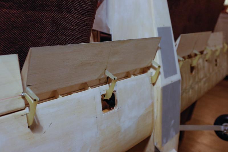

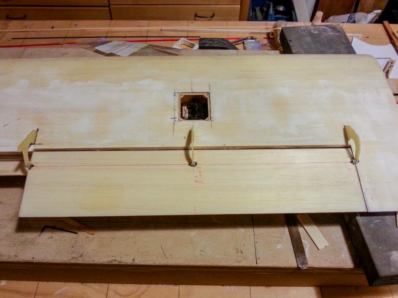

De ergste rommel van de bouwtafel opgeruimd en de Airtractor weer van de kast gehaald. Volgend jaar zou die toch eens moeten vliegen.

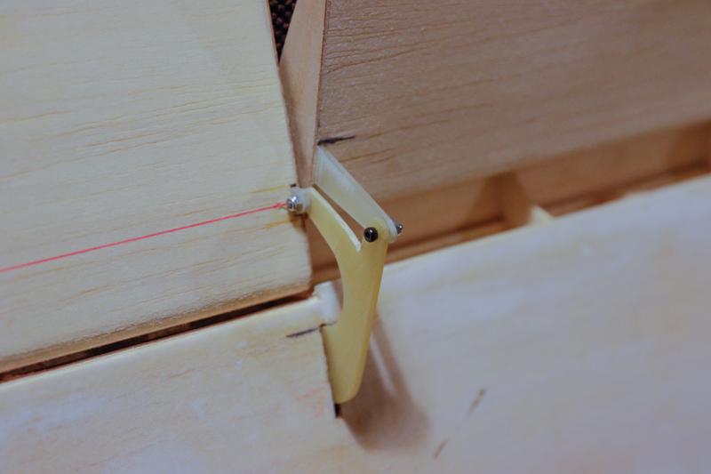

Vol goede moed met één van de rotste karweitje begonnen, het afstellen en verlijmen van de scharnieren in de vleugel.
1 aileron is klaar en het resultaat valt niet tegen. Ook de inwendige aansturing vanaf de servo werkt goed. Dat geeft moed voor de rest. :-)
full
Soms zit het mee :)

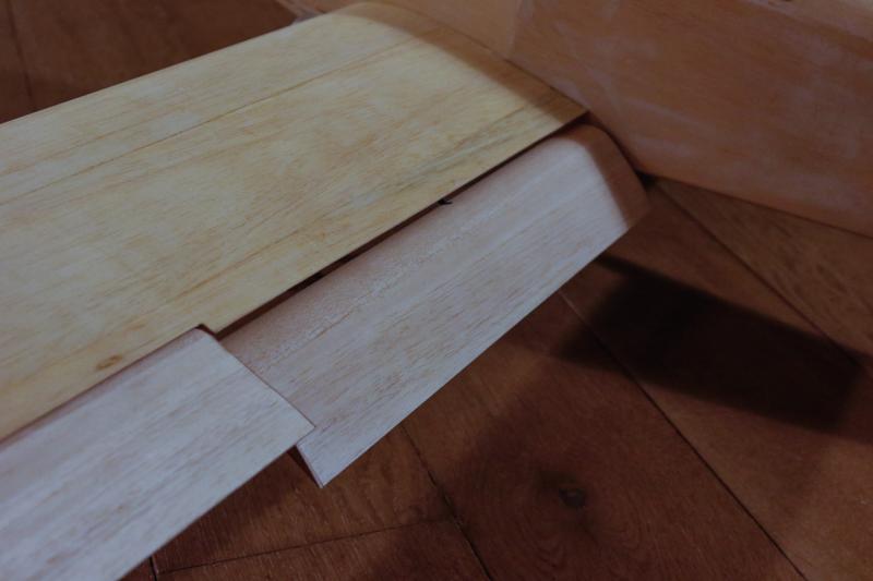

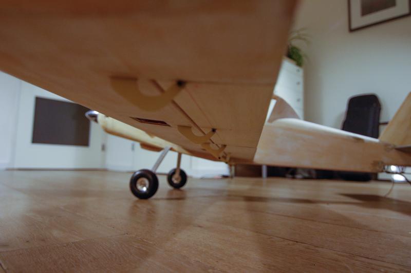

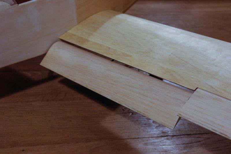

Flap ook ingebouwd en de boel werkt naar behoren. Nog een beetje finetunen, maar dat is voor later zorg. Nu eerst de andere vleugel.
De roeren zitten in de vleugel!
Nog een beetje finetunen, maar het lastigste klusje zit erop. :)

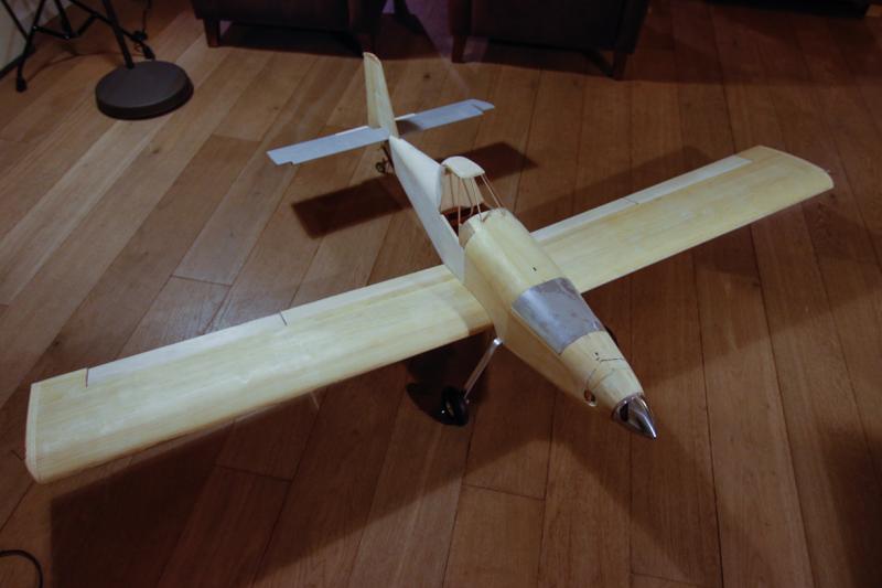

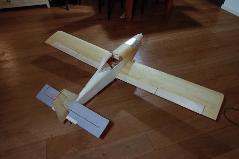

Langzaam gaan we richting de eerste vlucht. :)
- Ruwbouw is zga klaar
- servo's ingebouwd, afgesteld en mixers geprogrammeerd
- motortje trekt 50A op 5S met een 14x10 prop
- gewicht is nu 2850 gram (incl laatste dingetjes en accu verwacht ik net boven de 3500 gram uit te komen)
- zwaartepunt ligt zonder accu zo ongeveer op de goede plek (heb ik nog nooit meegemaakt)
Alleen de aansturing van het hoogteroer is niet naar mijn zin (te veel speling). Ik denk dat ik er een steviger bowdenkabel in ga zetten. Verder nog 5S accu's aanschaffen en dan is het zover.
