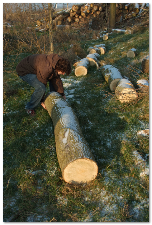

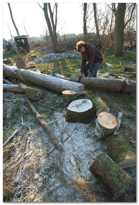

January 2012

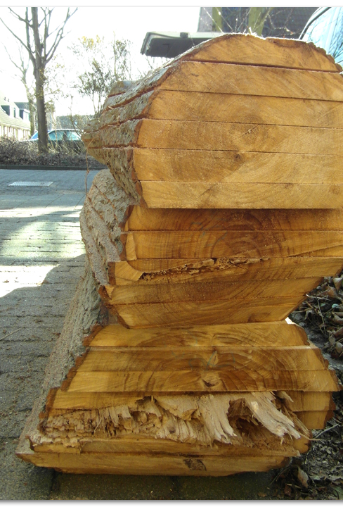

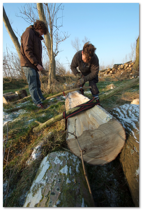

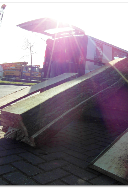

We found someone who had cut down a whole forest and we could take what wanted.
But it took four men to move these strains.
Some M'giver skills and 2 hours later the load was on the road.

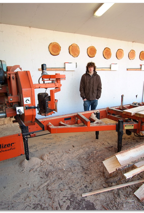

This saw cuts it into planks

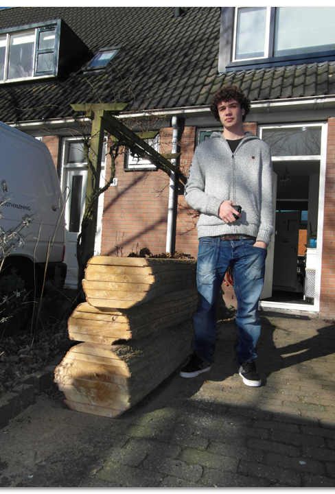

February 2012

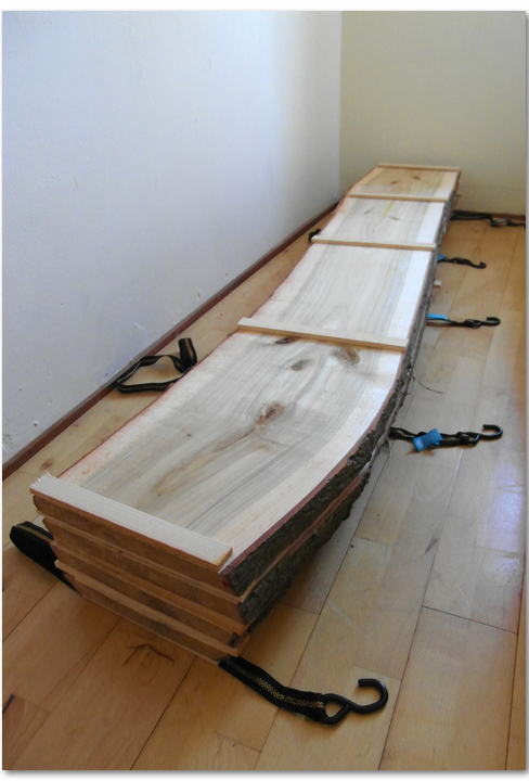

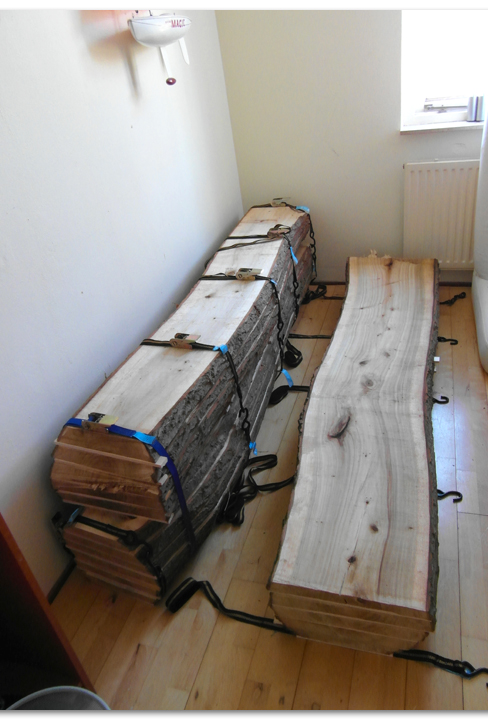

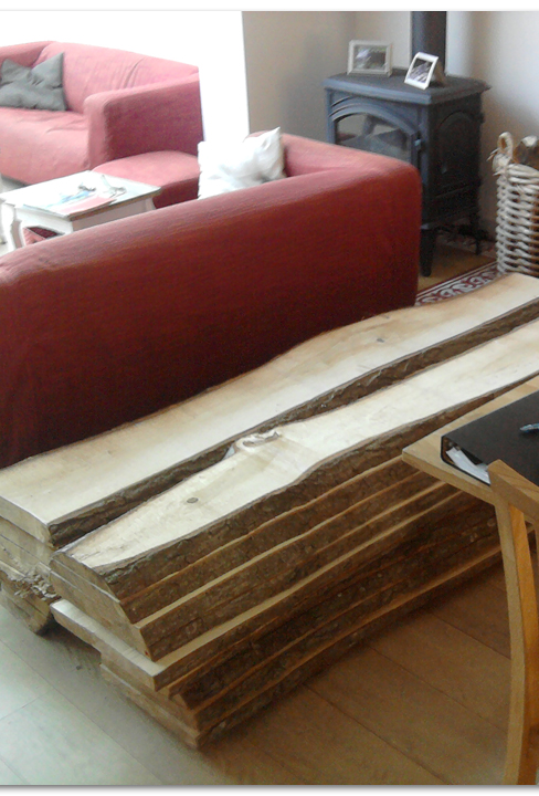

We moved the load back home to let it dry.
piled with slats in between to ventilate.
Whatch this timelaps movie----------
we left it five months drying,
occasionally with a fan in there.
July 2012

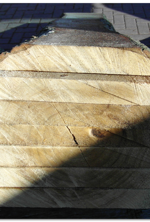

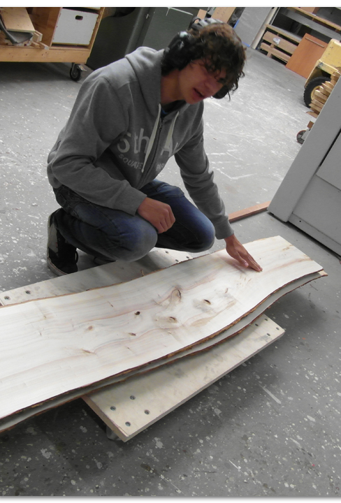

The plan to let it dry with straps was successful.
The shelves remained pretty flat.
We have a shelf weighed before and after the drying,
the difference was 24 kg to 9.5 kg!

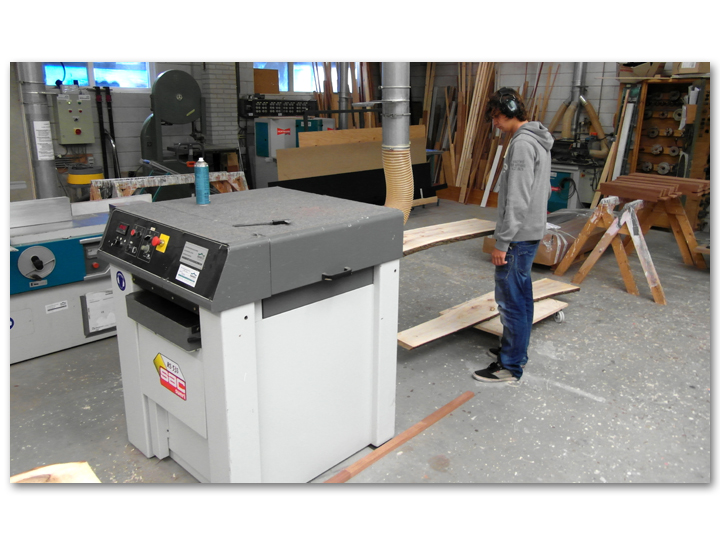

Next step, planing the shelfs.
a friendly local contractor let us use the thicknesser
see this little movie----------

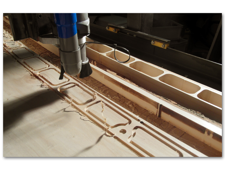

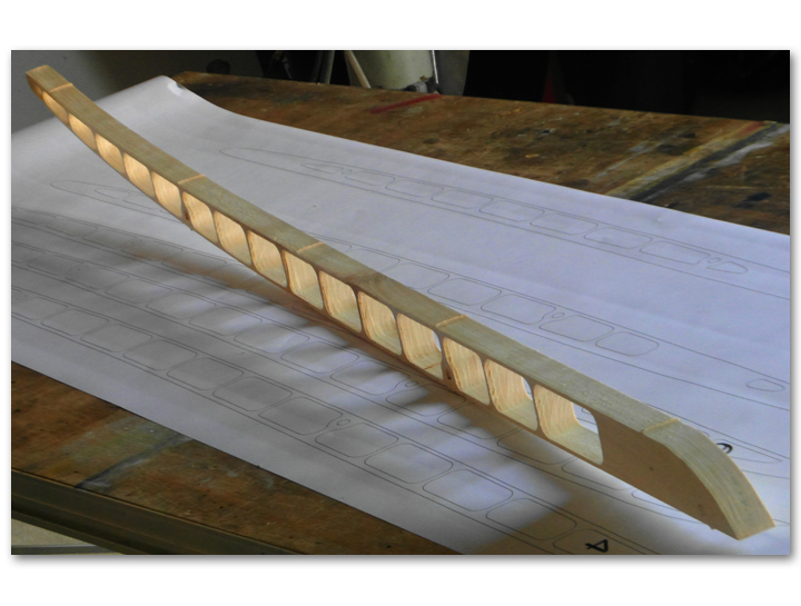

We made an 3D cad drawing in Rhino 3D of the complete board.

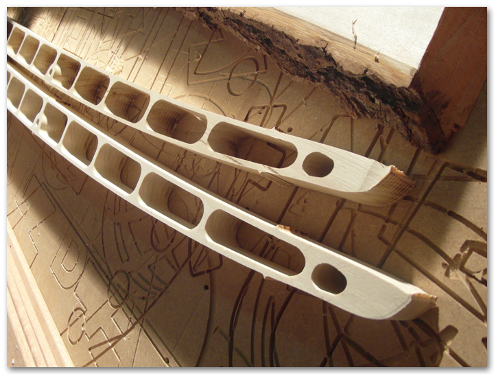

We sliced the drawing to make the ribs.

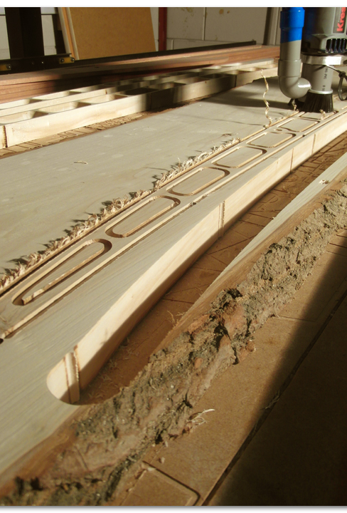

These ribs where cut out on my CNC machine.
short video---------
an other video close up ----------

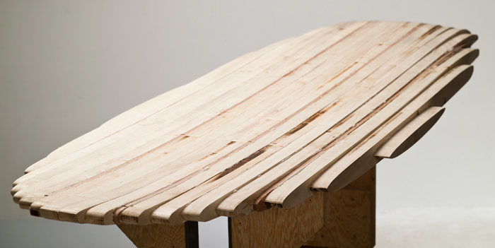

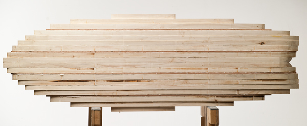

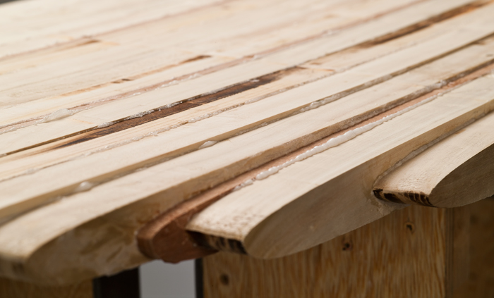

All the ribs glued together to form the rough shape of the hollow surfboard.

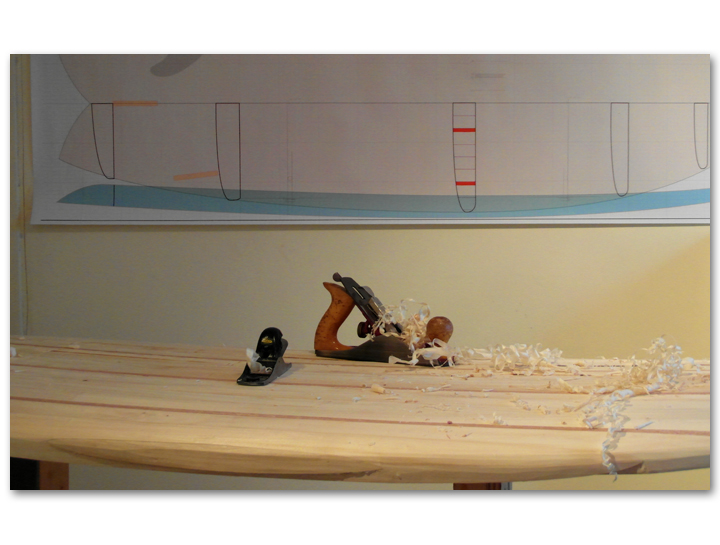

After a few days planing and sanding

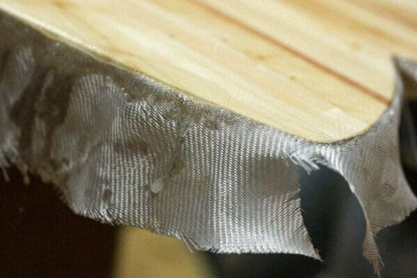

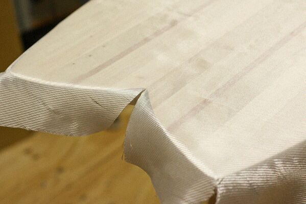

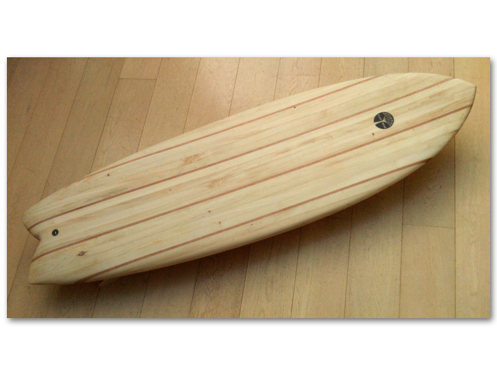

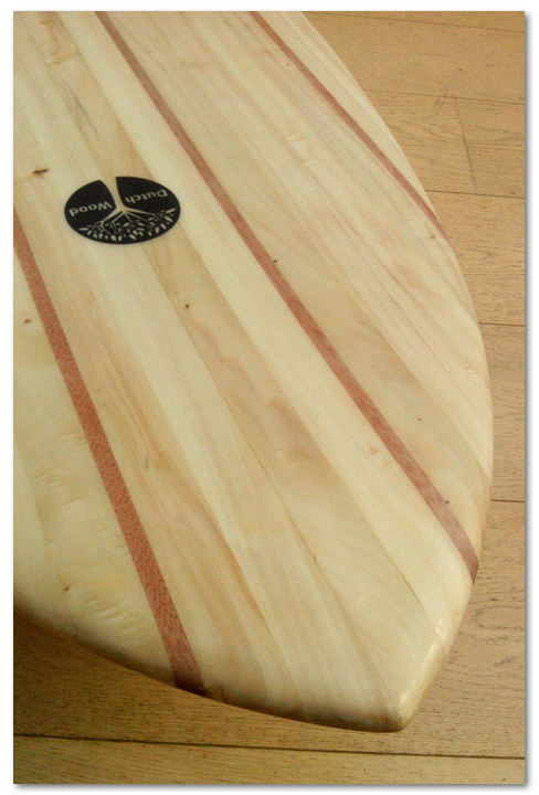

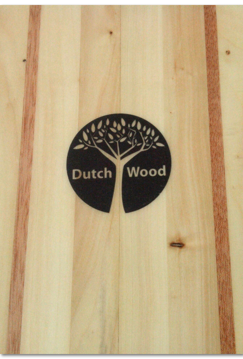

To finalize the board we laminated it with a thin layer of glass and epoxy.
The final finish was very finely sanded almost shiny.
