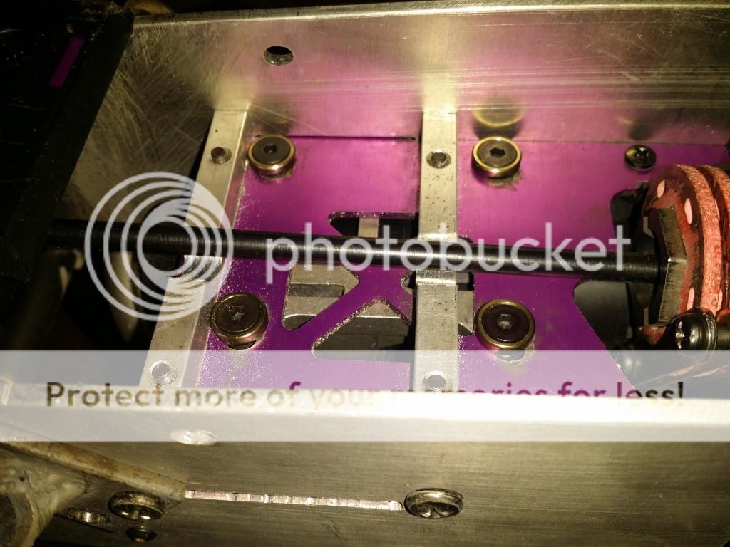

Nitrotrippertje had hetzelfde met zijn JVD. Die heeft de sleufjes van zijn motorplaat aangepast zodat hij de motor iets naar achteren kon schuiven.

Hier de JVD van Nitrotrippertje.
nitrotrippertje";p="756636 zei:
Ok here it goes when mounting the ascendancy effordless clutch (with is developed for truggy and buggy,s)
First things first this is the best clutch to run in race conditions.
When installing on a savage you wil get into trouble with fitting correctly.
The cb will rub the spur bigtime (composite spurr that is)
It will only work with a steel spur and nova mount or modify the engine plate.
As you can see the spurr is running on the edge of the cb with is not the way to run i think.
So you need to shift the engine towards the back, but you can not cause the engine mount can not go backwards.
You need to mod the engine plate to shift backwards.
You need to file the slots a few mm to be able to shift the engine more to the back.
Thats why youre better off with the nova engine mount.
BTW a shame whe in europe dont get a black one here it is red clutch.
Let us know how it turns out or if you got some better way to get it working for you.
