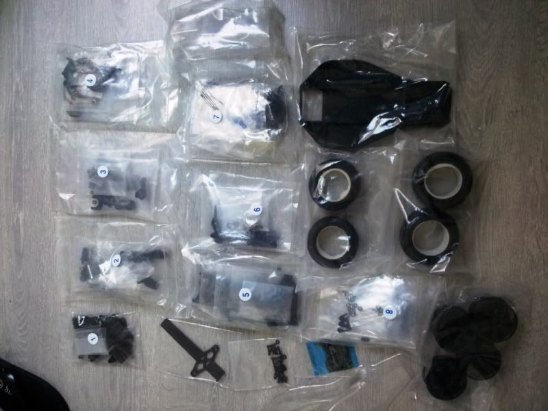

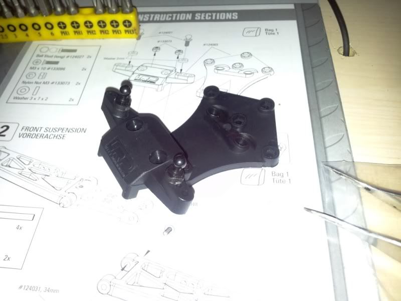

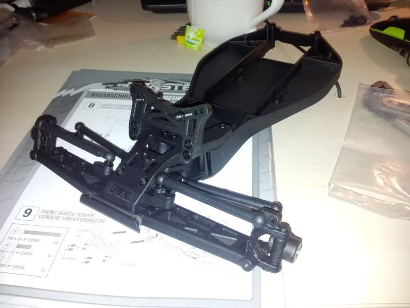

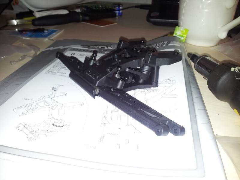

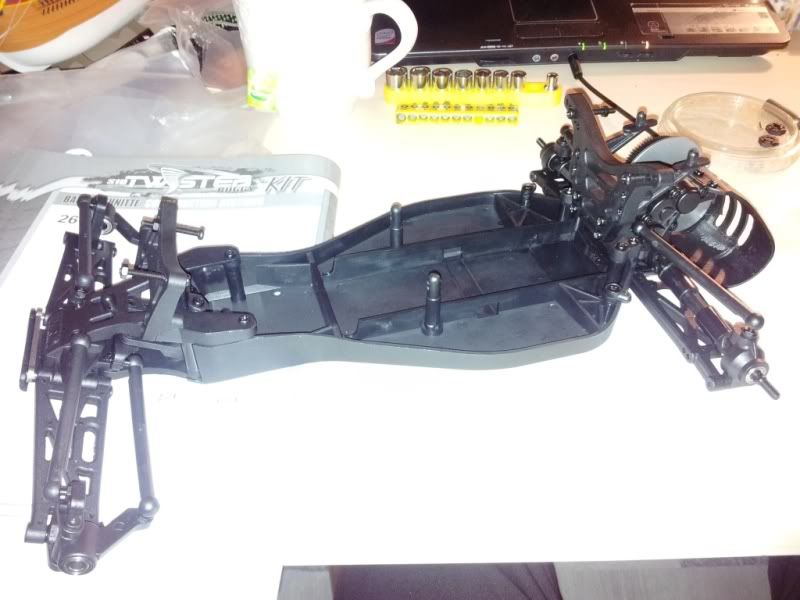

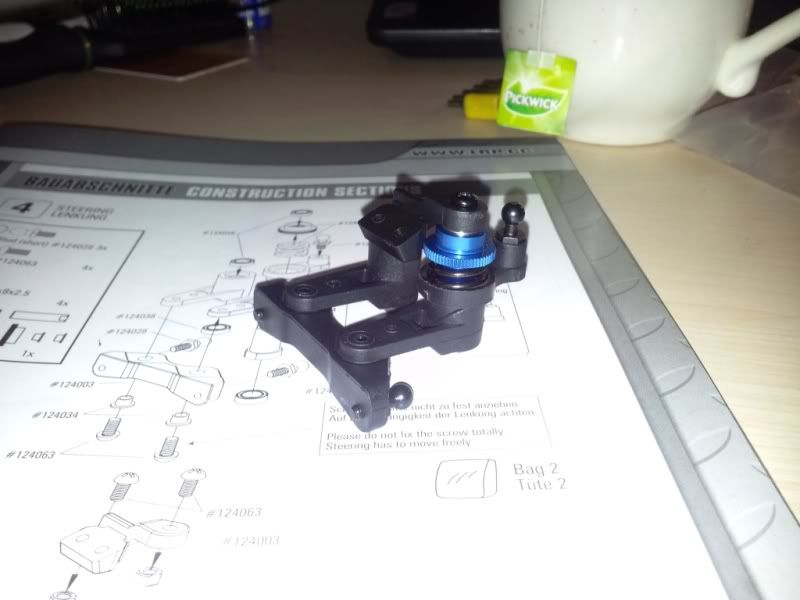

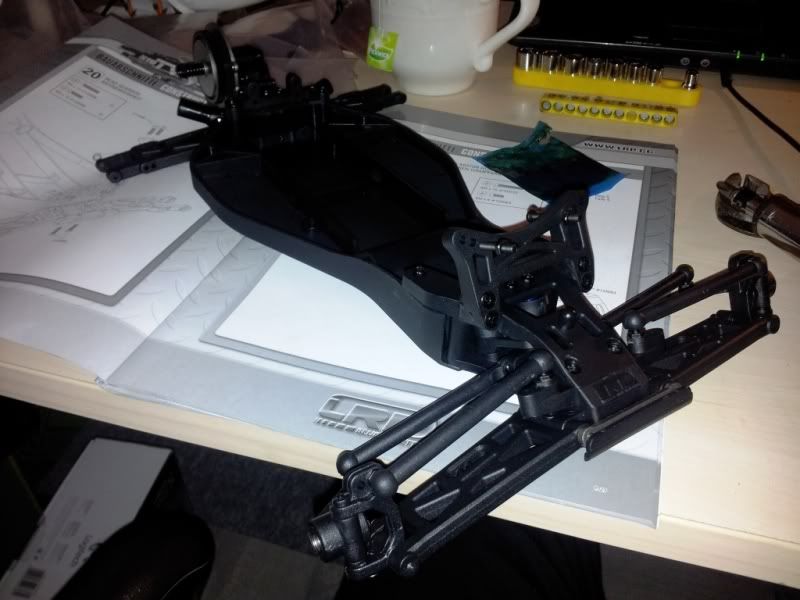

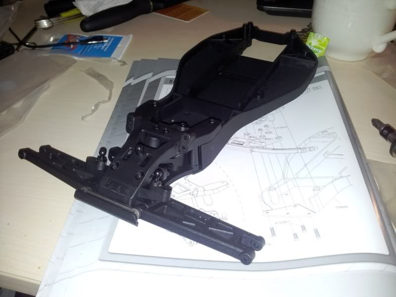

Starting the assembly:
all parts:

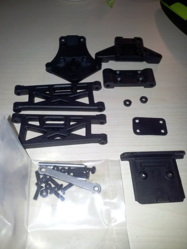

1st and 2nd part (1st bag)

Doesn't the manual include a list of required tools? You would need some philips screwdrivers (probably a PH 1), a 7mm socket driver (for the wheelnuts), and some hex wrenches (at least a 1.5 mm for the pinion gear).

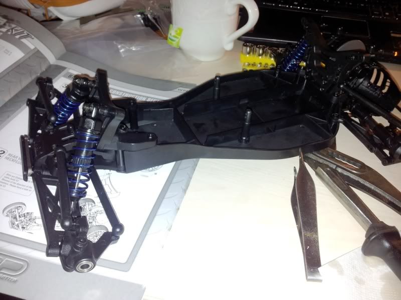

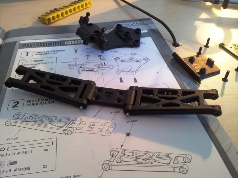

If the wishbones aren't running smooth against the part between them, you could file them a little, like on the picture in this post.

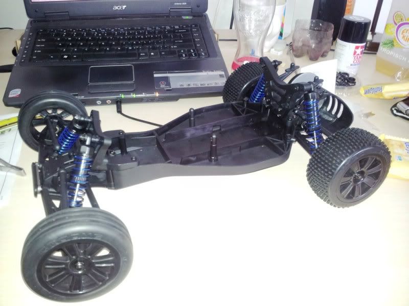

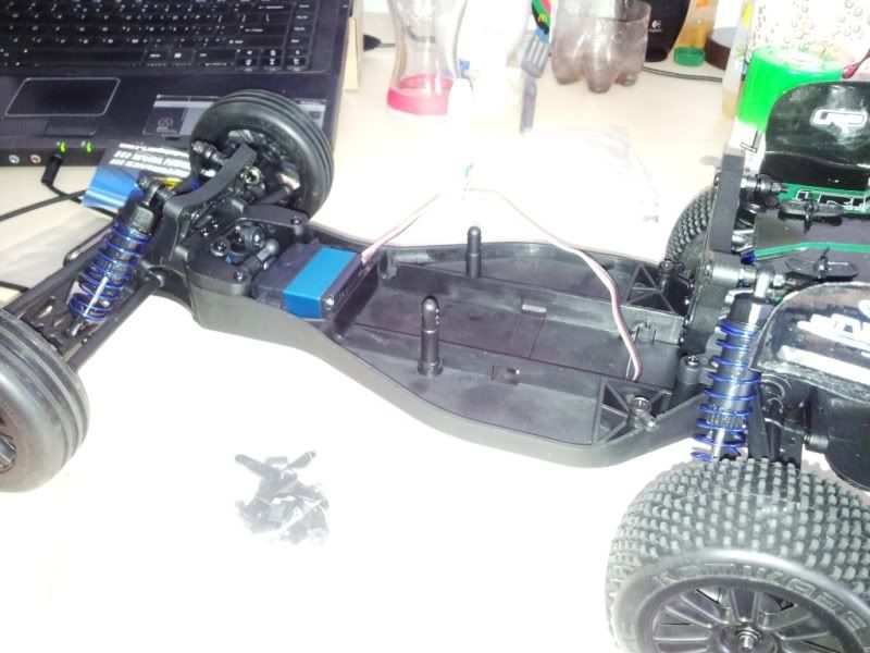

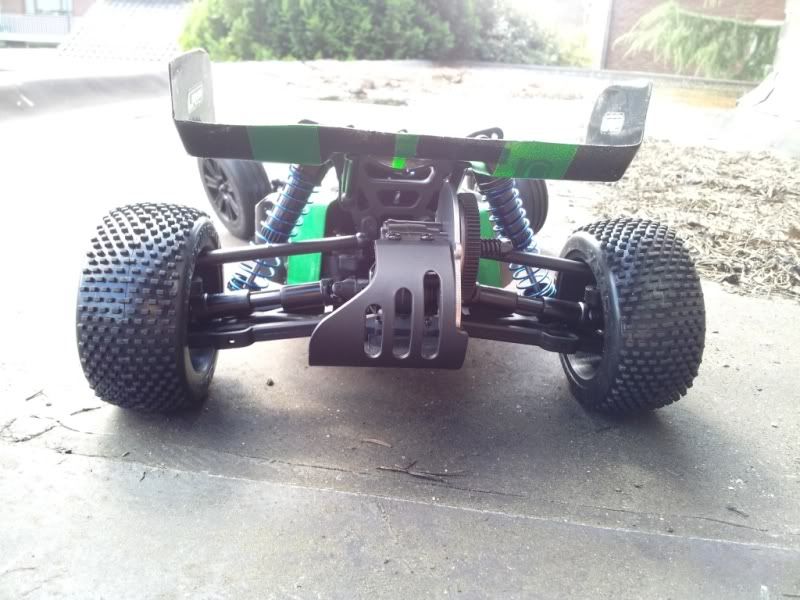

Nice! On the photo's it only looks like you've forgotten the short front axles!
for the wheels? no I didn't :) they fell out without the wheels mounted on, so i kept them in the bag (not the wheels are on, so everything seems okay :) )

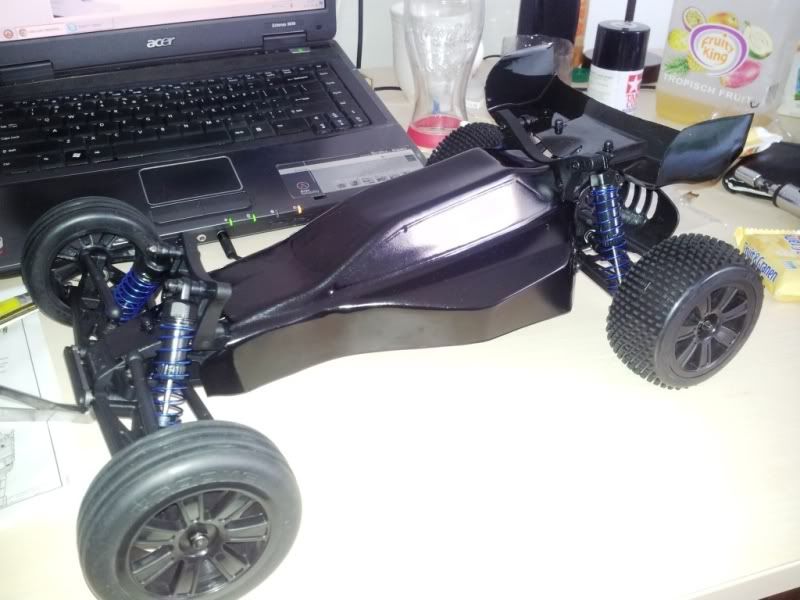

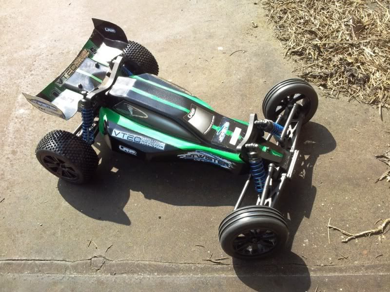

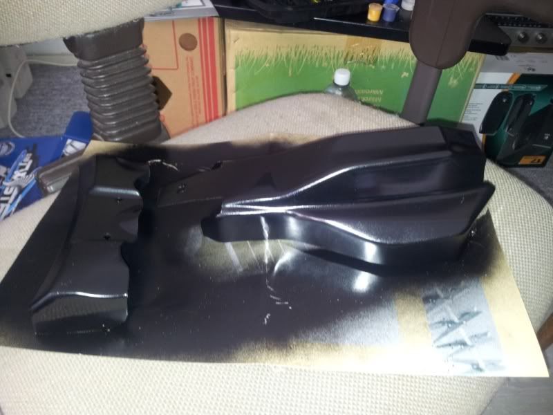

maybe 2 colors? It isn't very hard. I have a construction report of my xray 808e and I've painted my body in 2 colors. This was my first paint job and it was nog very hard. the only thing you need to do is masking your body very good. a very good tip. first paint the dark color and then the light color. I gonna make a new body with much more colors. On Goolge you have some nice designes. As the guys on this forum say much: Google is your best friend
Hi, thanks Bryan :)

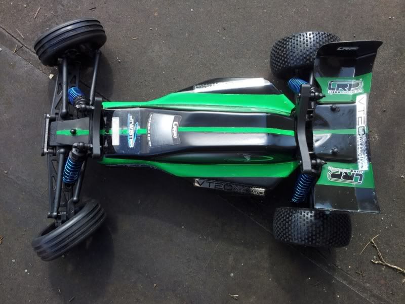

I am not quite satisfied with the painting, but for the beginning it will work i think :)
