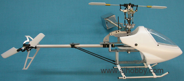

Dit is de pro uitvoering:
Ook te koop met 3 rotorbladen, de minizoom 100EP 3 blades
Minizoom 100EP STD:
Minizoom 100 EP PRO
techinische info van deze micro heli:
The tiniest 3D capable helicopter equipped with precision metal parts.
1mm thick carbon mainframe and fin set.
Adjustable carbon servo mounting brackets.
Precision CNC titanium anodized aluminum swash plate, washout base assembly, mixer arms, main rotor yoke and rotor grips.
Fully equipped ball bearings.(30 micro bearings)
2-bearing tail pitch sliderproduces precision tail control.
Installed a brushless motor (option) for even more 3D acro flight capability.
Seesaw head with bell-hiller system.
ECCPM collective pitch mechanism (variable pitch).
Only a short time needed for completion. (95% factory assembled)
Belt driven tail rotor.
Extensive upgrade parts and option parts available.
Specification:
Overall length: 355mm (including cabin & canopy)
Main rotor diameter: 340mm
Tail rotor diameter: 100mm
Motor: KV4800 brushless motor (option)
Flying weight: 195g (It may vary according to size of a battery pack and R/C gears.)
Main rotor blades: wooden(included) or fiber(option)
Flying duration:
7~8 minutes with 7.4v/800mah Li-Po battery
Items needed for assembly:
6 (or more) channel heli-capable transmitter (with CCPM function)
4 Micro servos (4g~6g servo is recommended)
6 (or more) channel micro receiver
Micro gyro (heading hold gyro is recommended)
ESC (10A~12A)
Battery : Li-Po battery (7.4v~11.1v/550~800mah)
Charger: Li-Po battery charger
Zie voor meer info en foto's:
http://www.gaui.com.tw/en/100pro.htm
