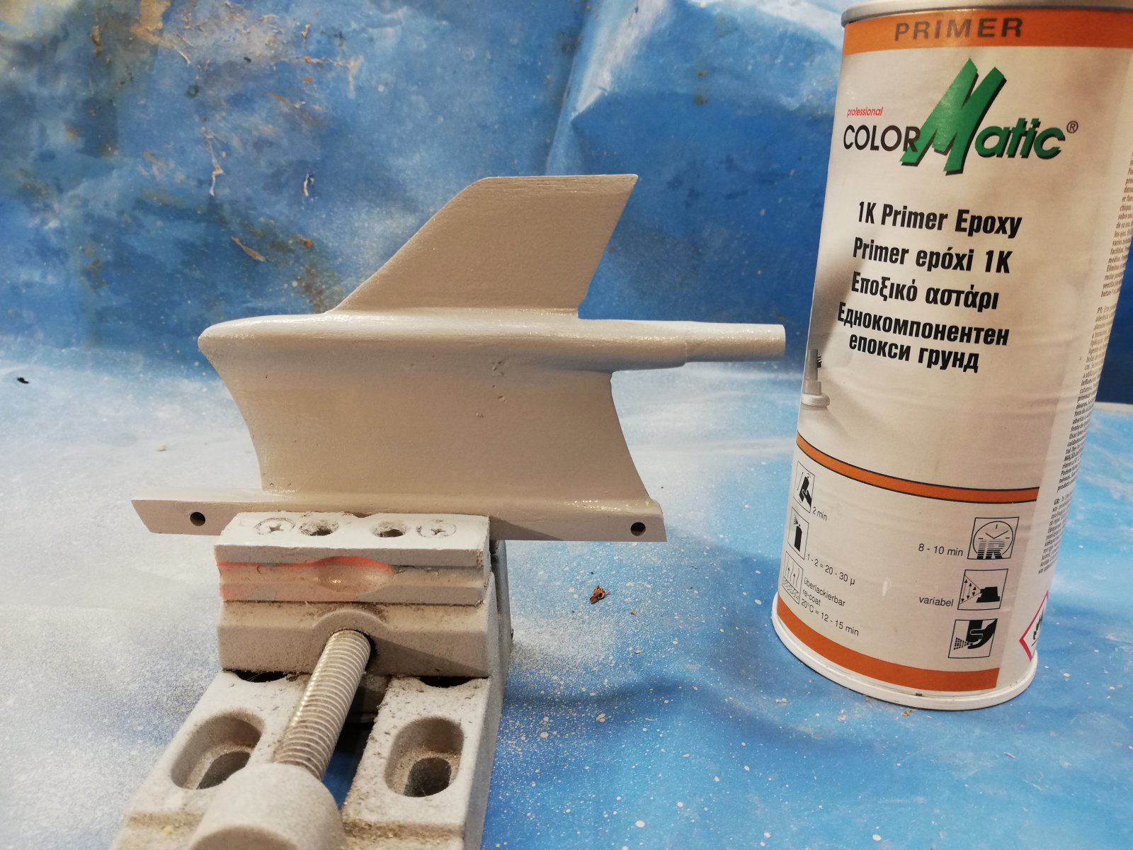

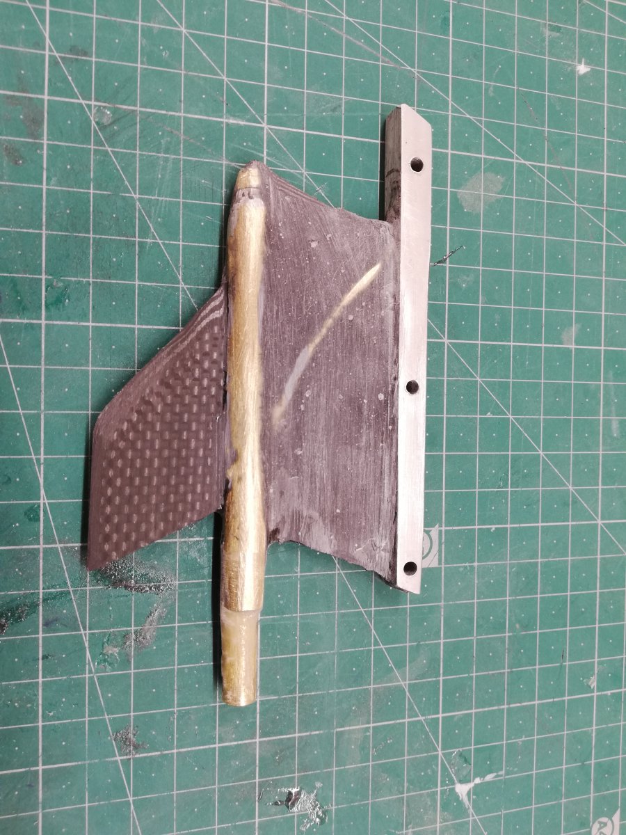

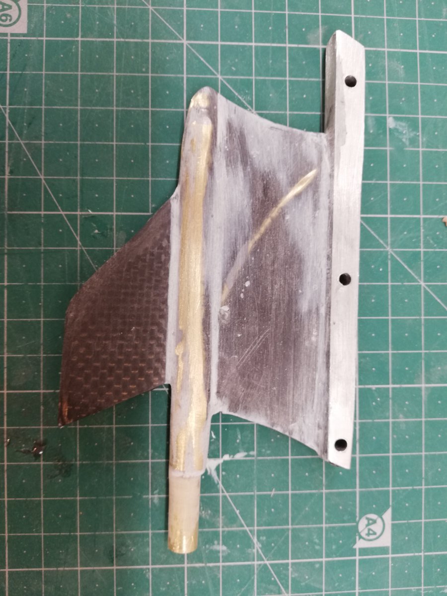

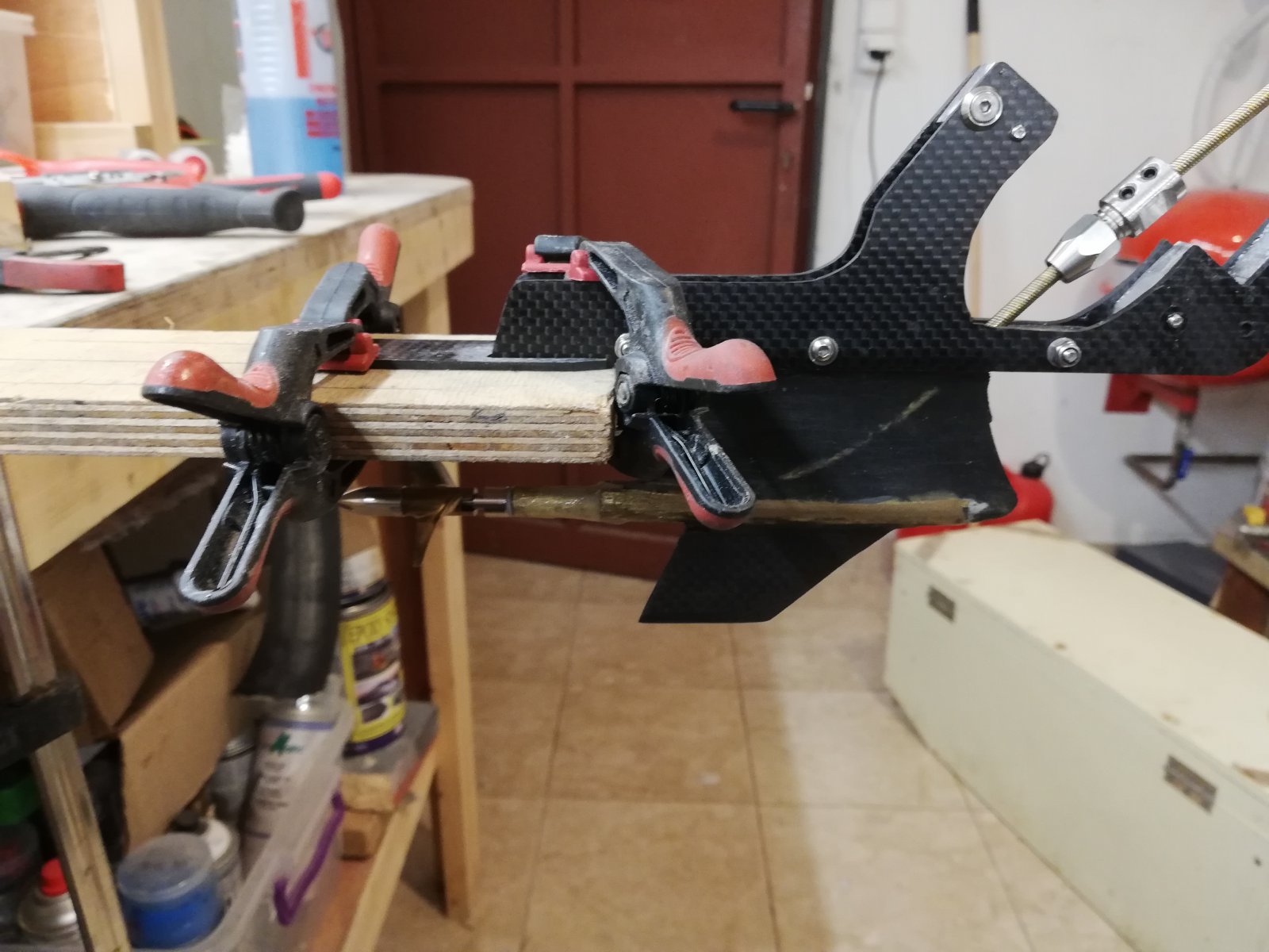

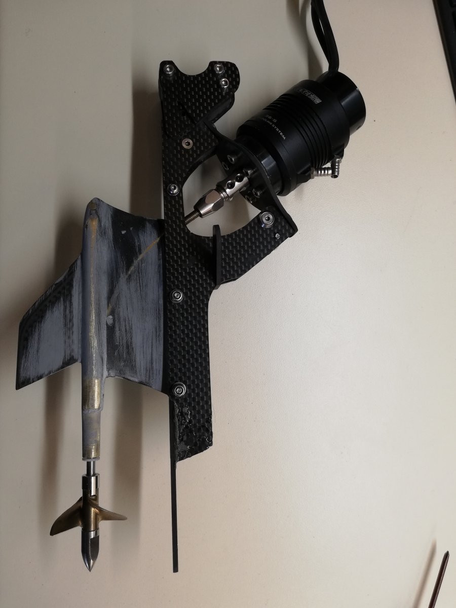

Goodmorning rc friends! I applied a first layer of putty and epoxy primer on the leg of the outboard, I secured the aluminum parts with thicken epoxy + screws and bolts and lastly I glued a carbon plate to hold the water inlets. A 85% of the work has been done.

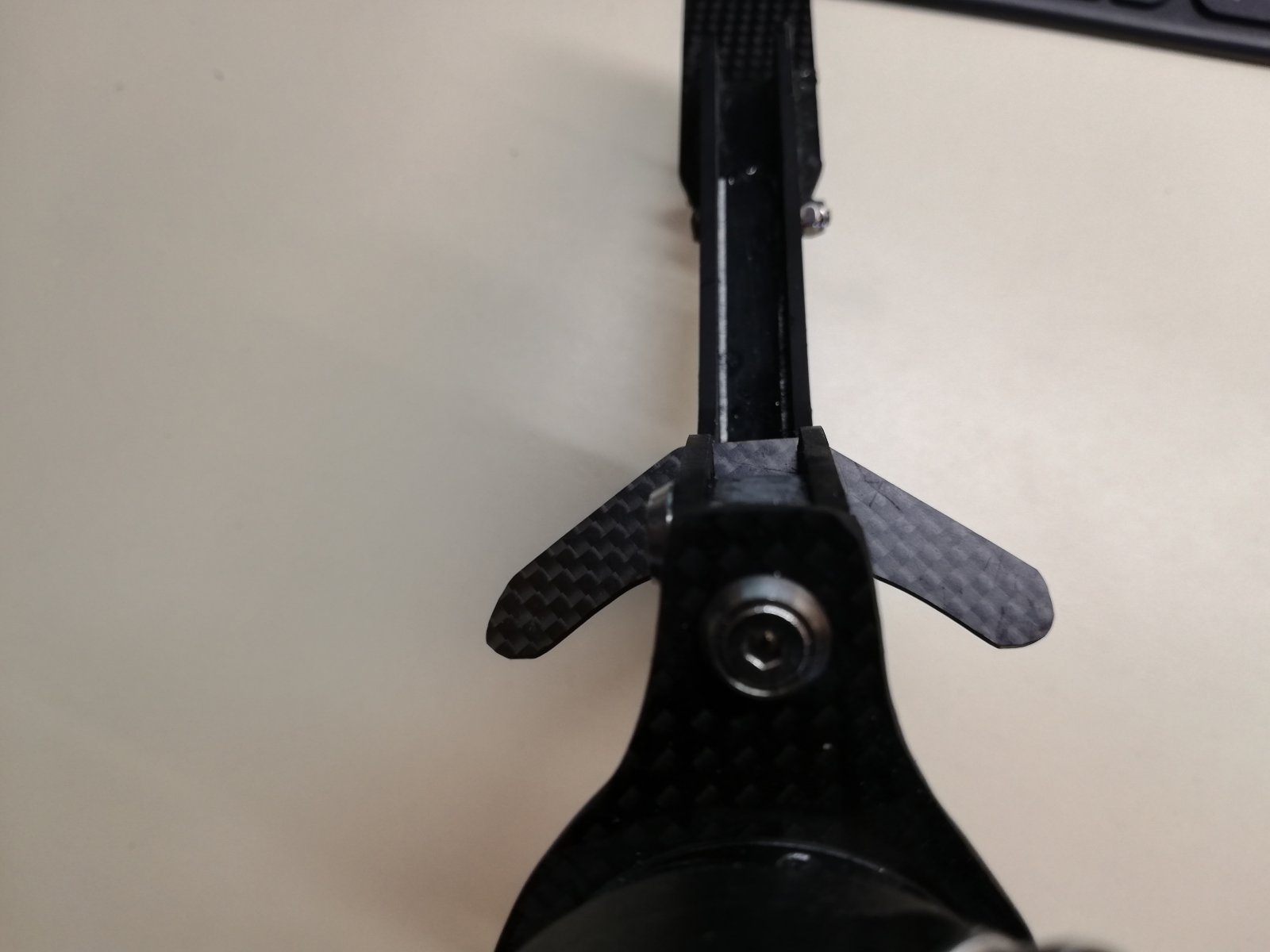

I really like your design. And make me want to build one myself. I specially like the flex shaft angle . Must be way more forgiving then my k&b 7.5. Wo tents to eat flex shafts with the 4082 1520 kv motor mounted. I think I go order a nice piece of carbon fiber sheet and try to build one to. Keep us posted with your progress.

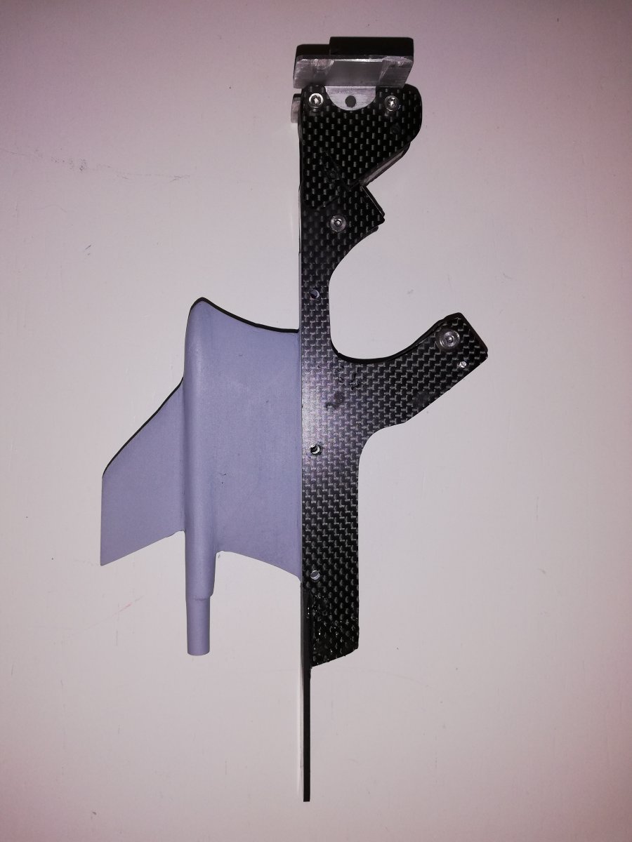

Thank you very much Alex! Indeed, this outboard has even larger angle (~ 115 degrees) than my previous one (~113) and the reason is exactly to protect the flex shaft and increase efficiency. The "plans" are available in previous posts so you can get ideas. The critical point in this construction is to glue the turn fin, the brass tubes, the carbon fiber plates and the U shaped aluminum in a straight line. All other parts are relatively straightforward.

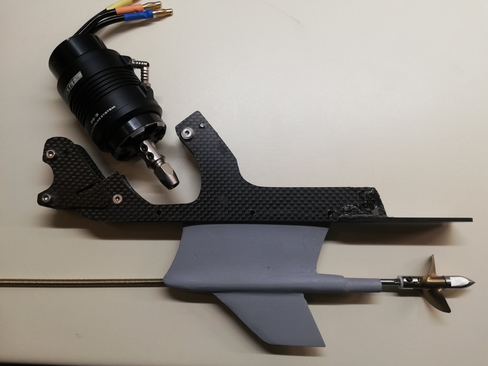

Yes, really good looking! What thickness of carbon plate did you use? And how will you mount the motor to the leg? Regarding the flex shaft angle, I think for the life time, it is more about the radius of the bend than the total wrap angle. Let's say, the radius of the bend is 100mm, it does not really matter if the wrap angle of the shaft is 45 degrees or 180 degrees. In other words; it is really important to use a nice continuous bend. For the flex shaft resistance, the total (wrap) angle reduction will also help.

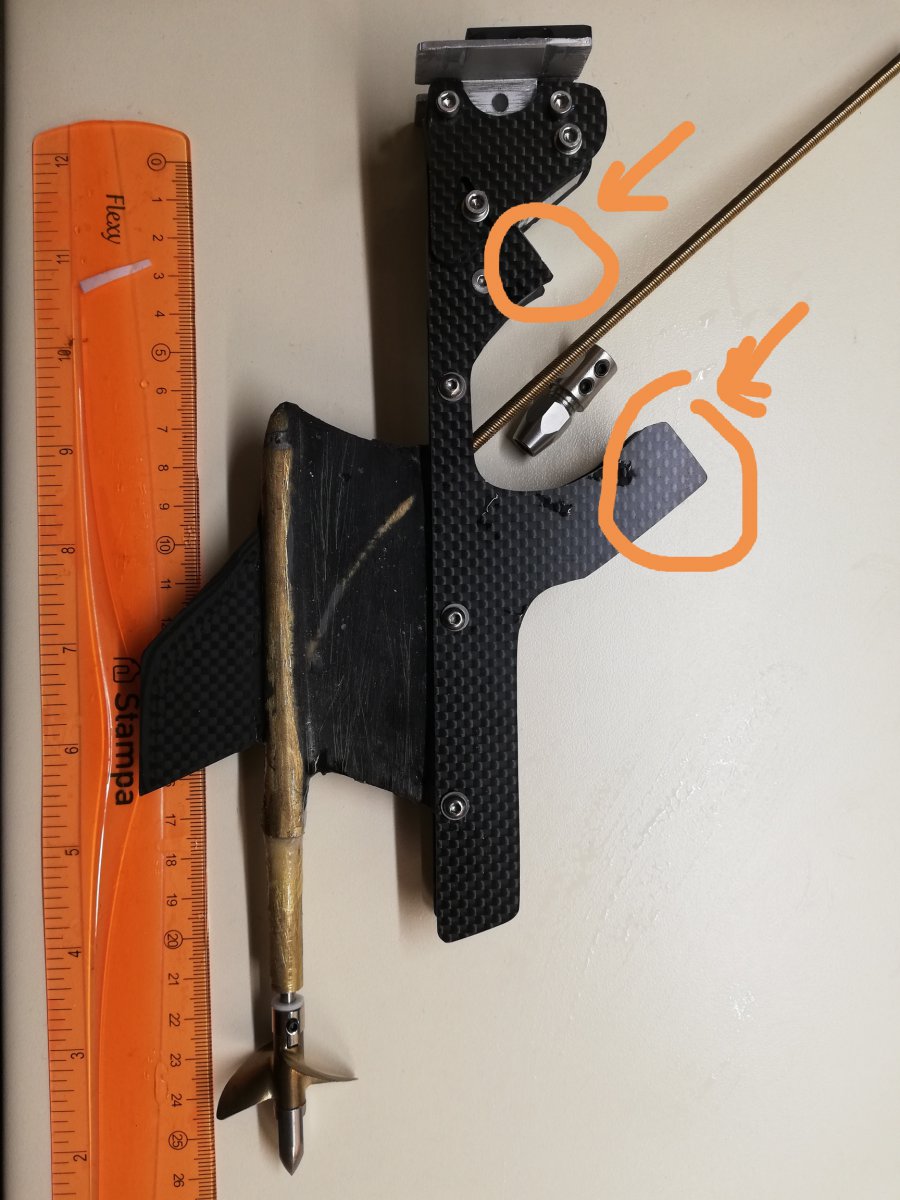

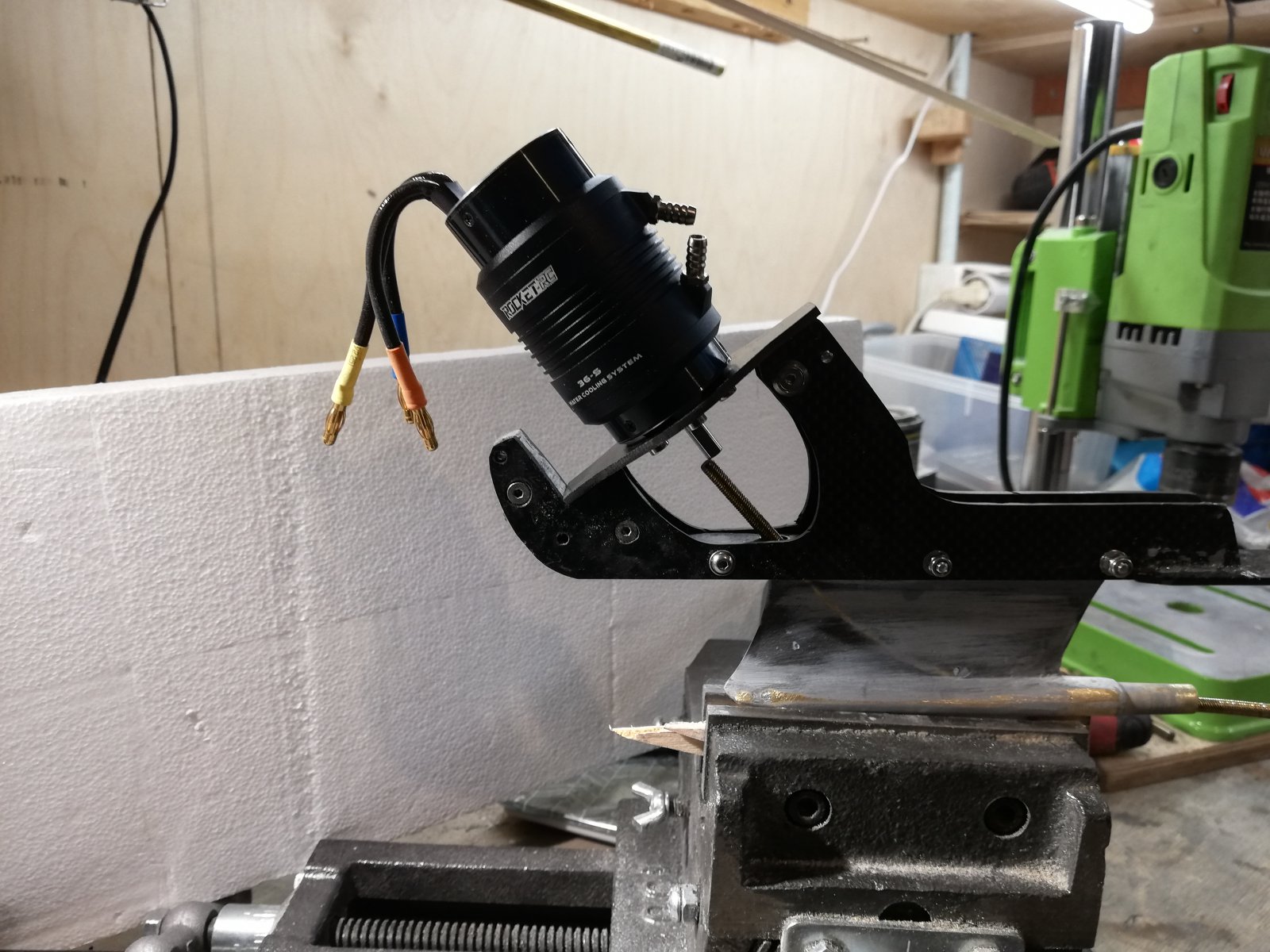

Thank you Jan! I use 2 mm cf plates which is strong enough and easy to cut. If necessary I glue two parts with epoxy to make a 4mm plate. The motor will be mounted using a 4mm cf plate which will be screwed with 4mm screws exactly where the arrows show This makes sense Jan for sure. However, given the limitations to the size of the outboard, and consequently the length of the radius, wouldn't be better to have a larger wrap angle?

Thanks Jan ! I have a 5S (previously a 6S but I removed one of the cells because it was inflated) and I want to try it first . Perfect! It will the first diy "insane style" O/B. I believe one of the main advantages of thwlis setup will be its low weight.
