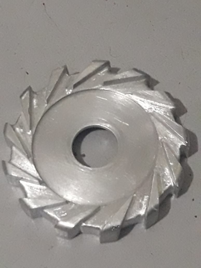

This is my first attempt at building a diffuser. I did it completely by hand. It has some mistakes since I don't have the necessary tools and cast the aluminum at my backyard and it also got some bubbles of air in. I based it around the UT 160 but the wedges are shorter unfortunately.
Yours looks good! Ideally around 1-1,5mm. Some manufacturers have it zero and some even 4mm, depends on compressor, diffuser match.

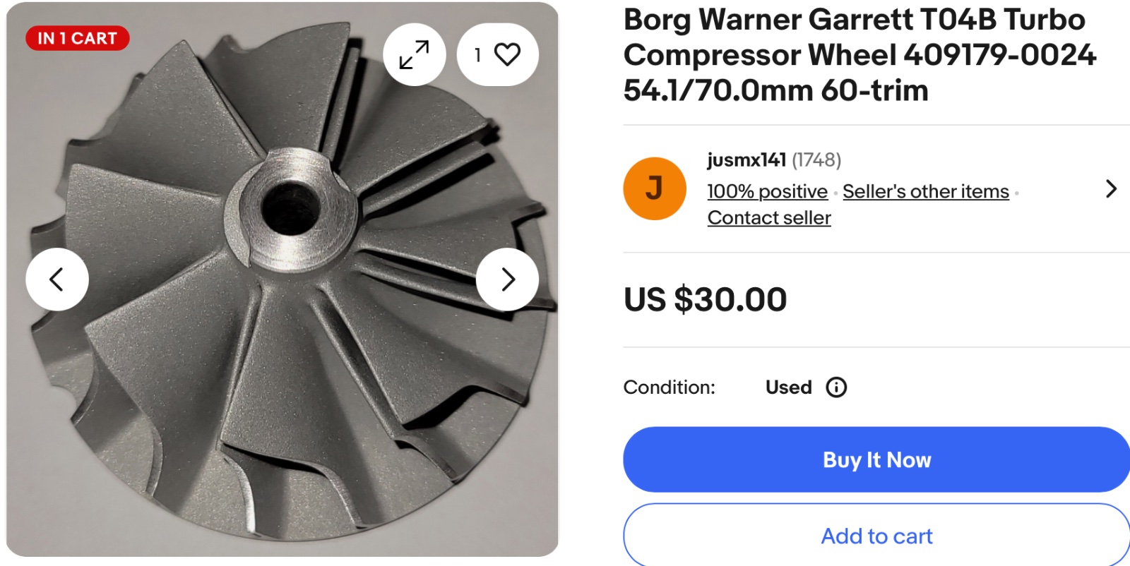

This is the comp wheel what will work in the UT 160, see picture.
The wheel you showed above is not correct, inducer is much to narrow.

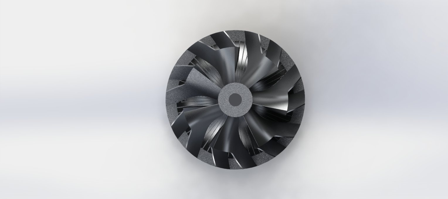

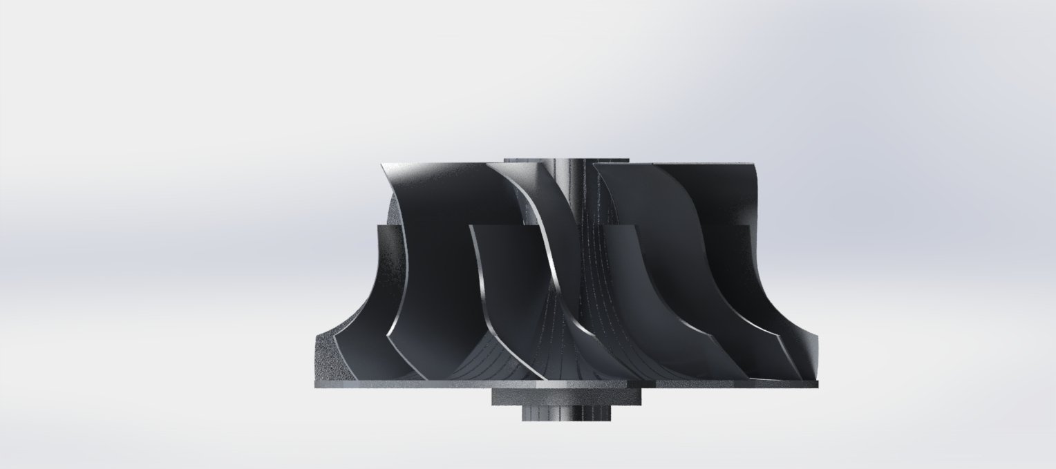

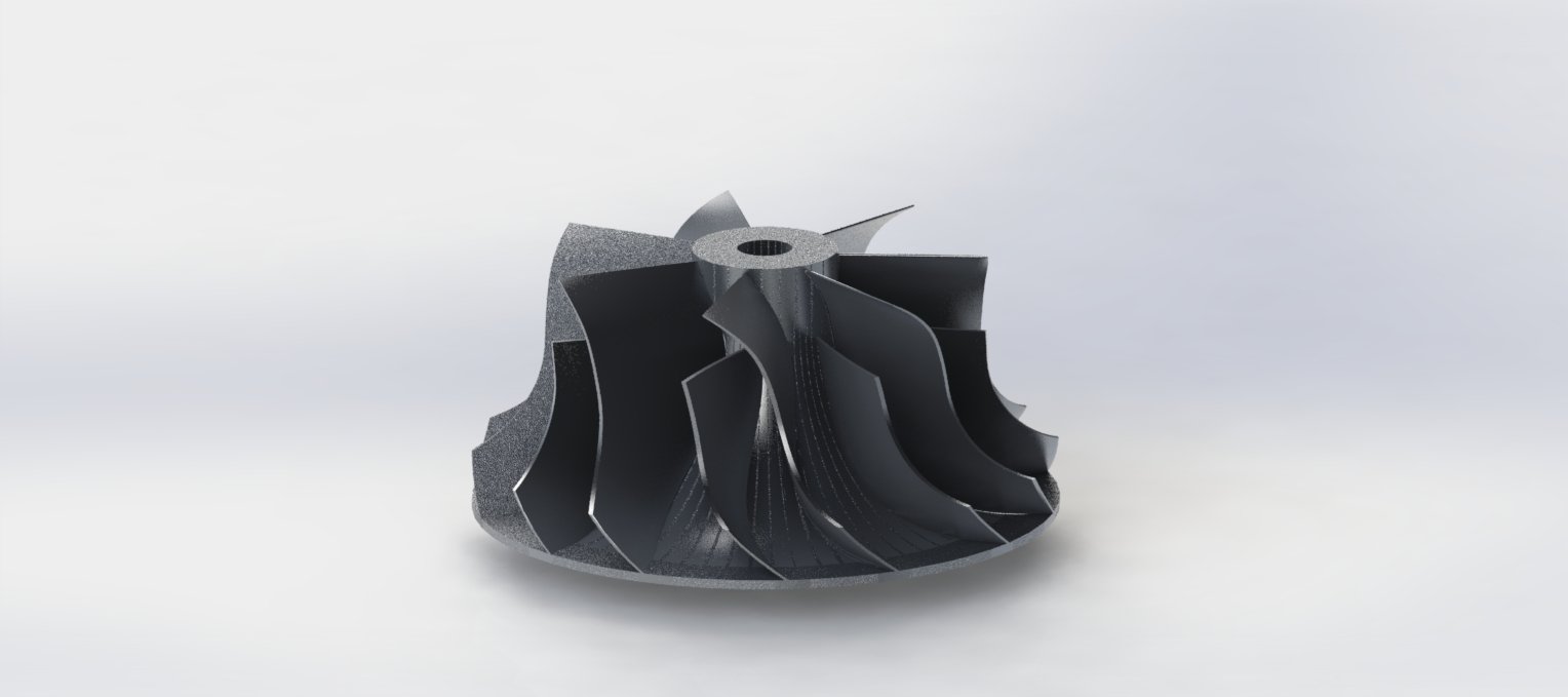

Sorry for being so random. I just wanted to share my attempt at modelling the GR 180 from Gerald Rutten.
