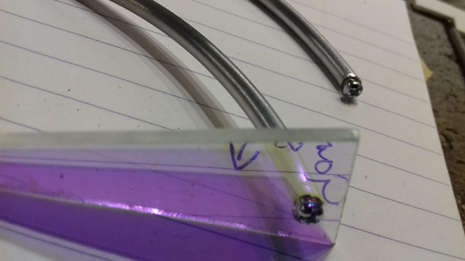

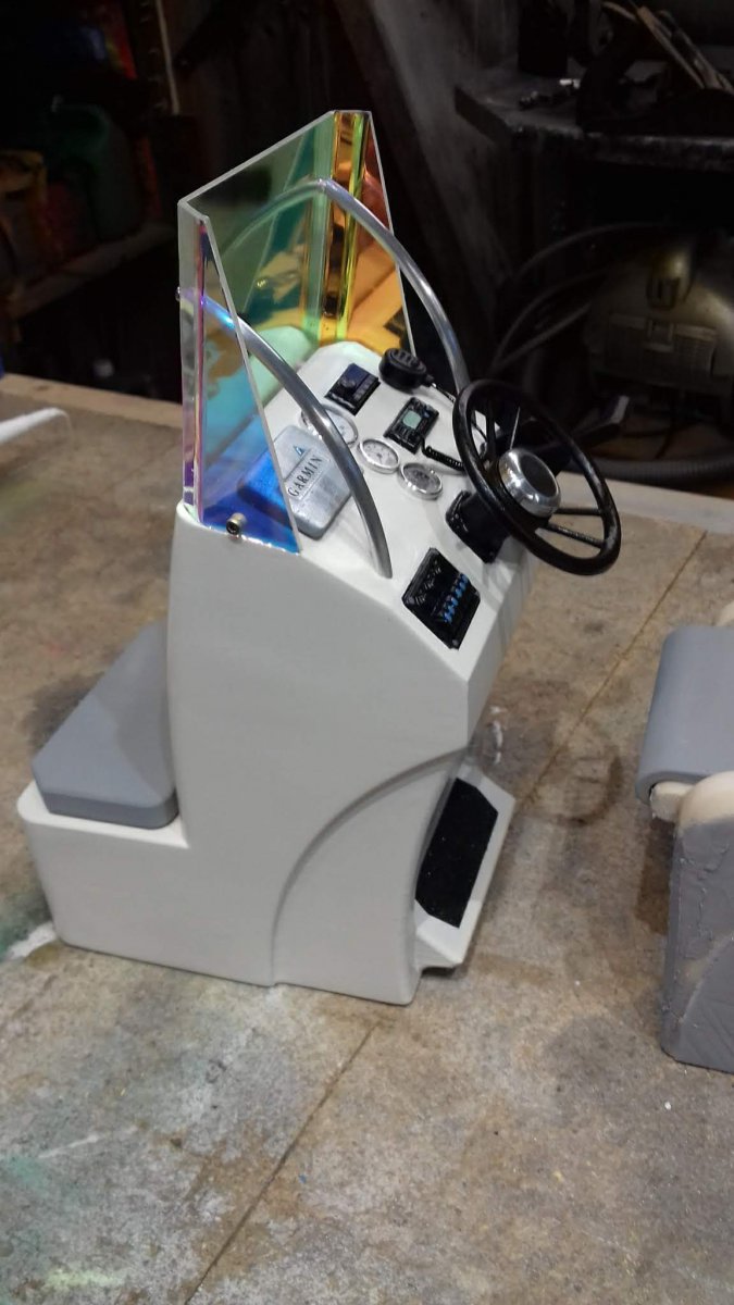

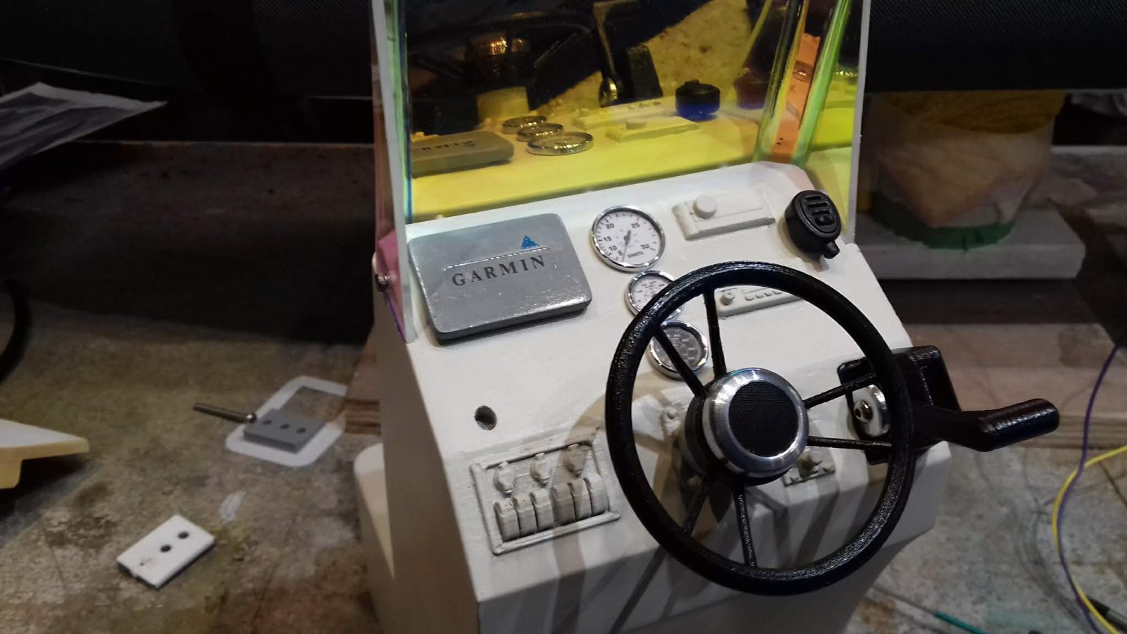

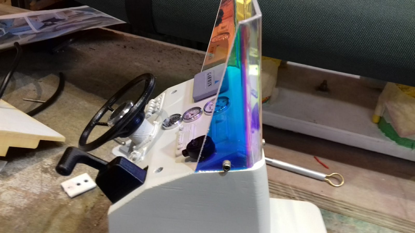

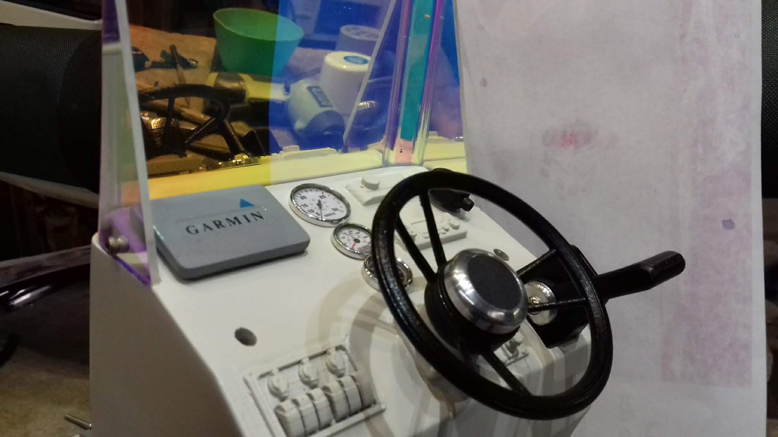

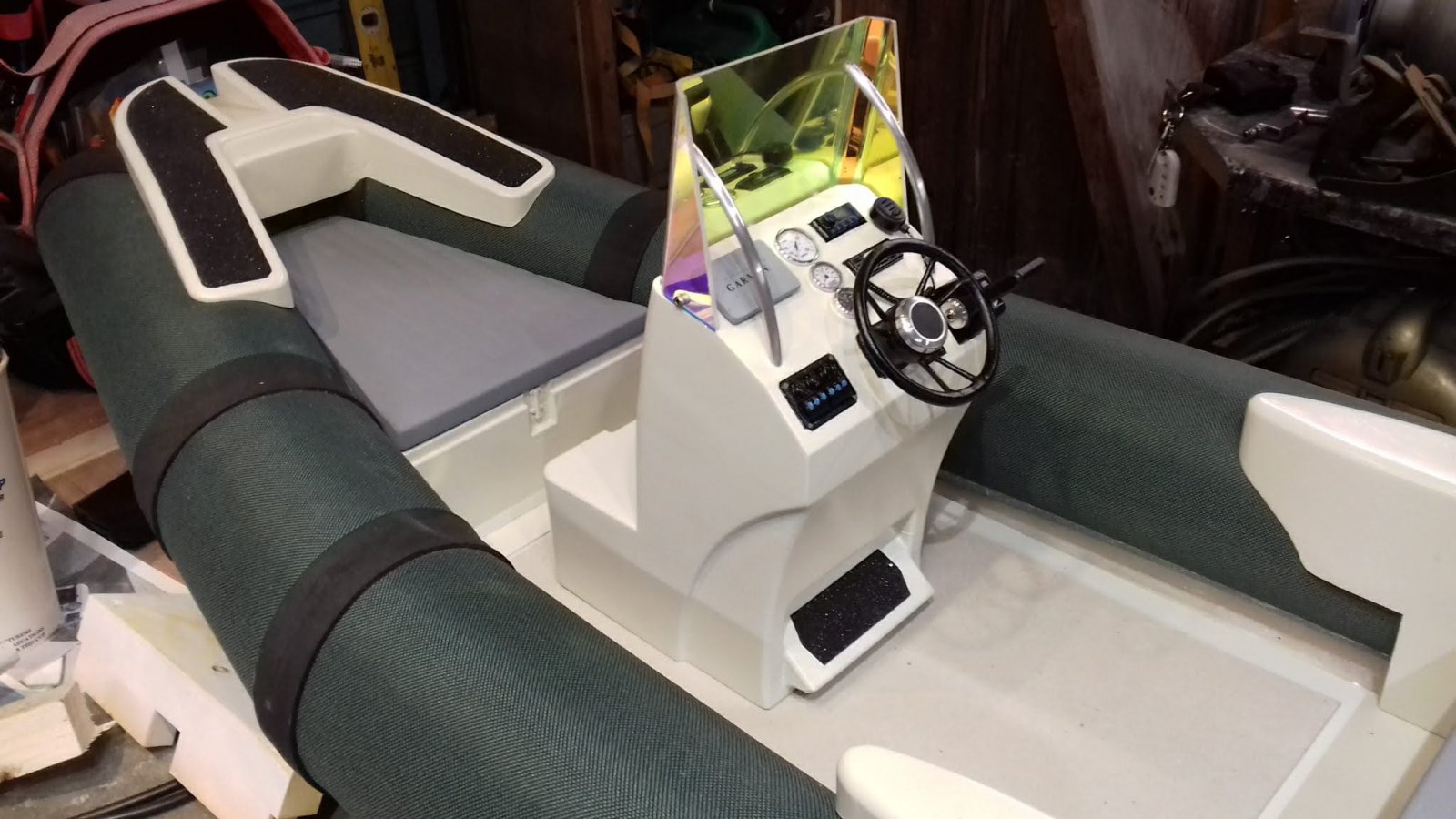

Took the bull by the horns this afternoon, to make the windscreen. If nothing else it would be a good practice. It actually turned out well so it's a keeper. I've had a good day, even broke my speed record with my jet outboard.
Glad you like it Dim..
Amazing level of detail for this type of 3D printing.
And this model moves fast, so only for display these details are interesting.
Blackpool, I presume?

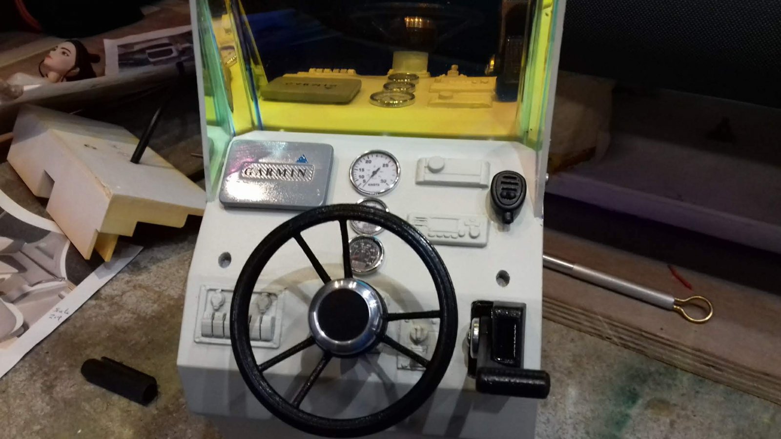

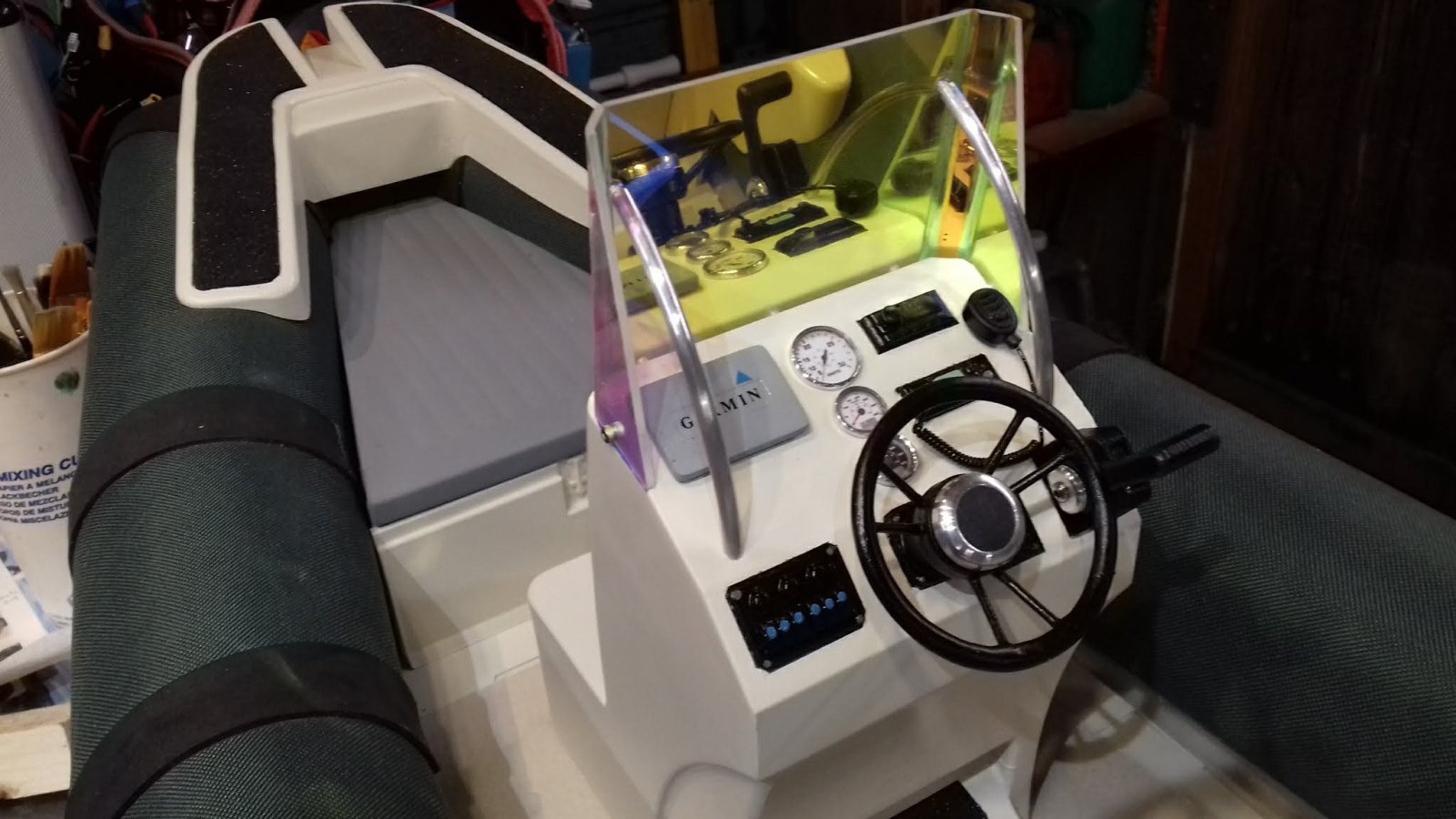

Used 2mm brass inserts for these windscreen supports, and printed a painting holder for the console.
Definitely for show at Blackpool, but the console will be used all the time the boat is sailing.

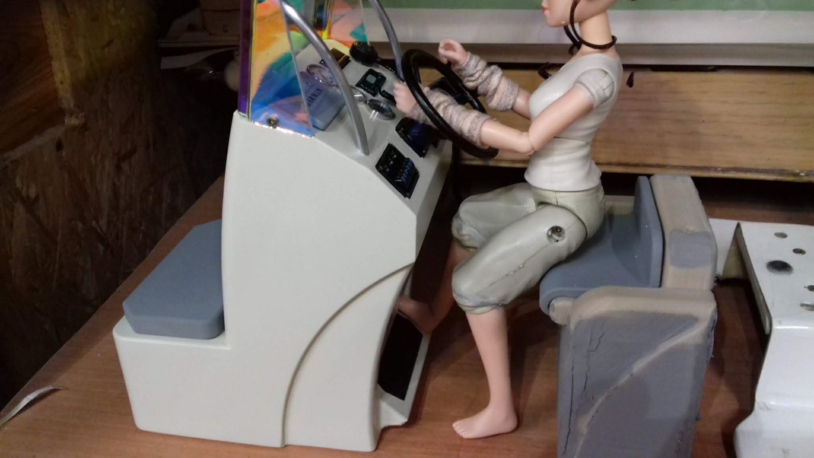

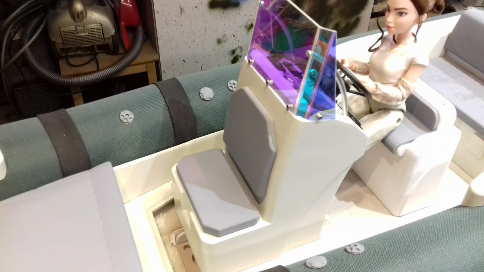

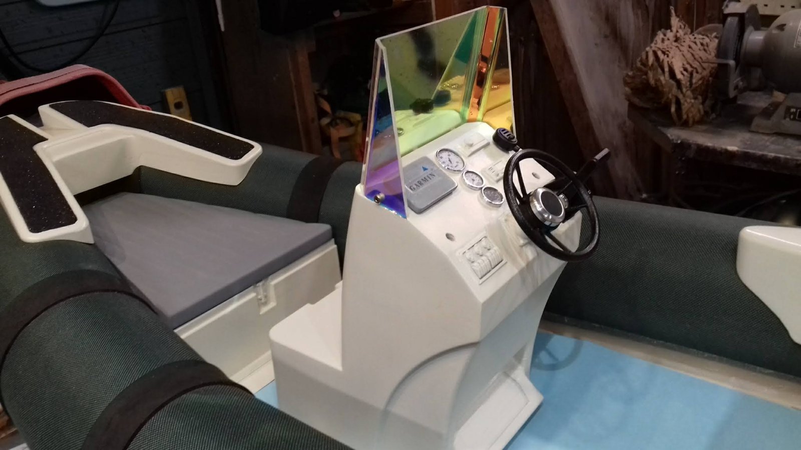

The seat ended up taking 20 hours to print, so much for estimate of 14, don't know who's going to pay the electricity bill
At least it came out perfect, I was worried if there was enough filament, just with a little too spare.
That square bit at the front is the support for the overhang, it needs removing.

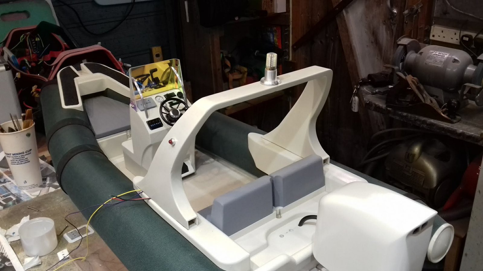

I have drawn the fuel filler part which fits in the starboard side, only a 5min print, then make a fuel cap on the lathe.

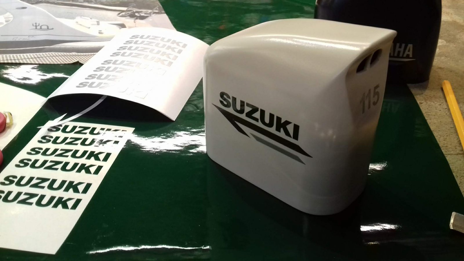

Got enough Suzuki stickers now for 12 more outboards.. I've used green on the cream cowl to match the boat. But I also have them in silver.

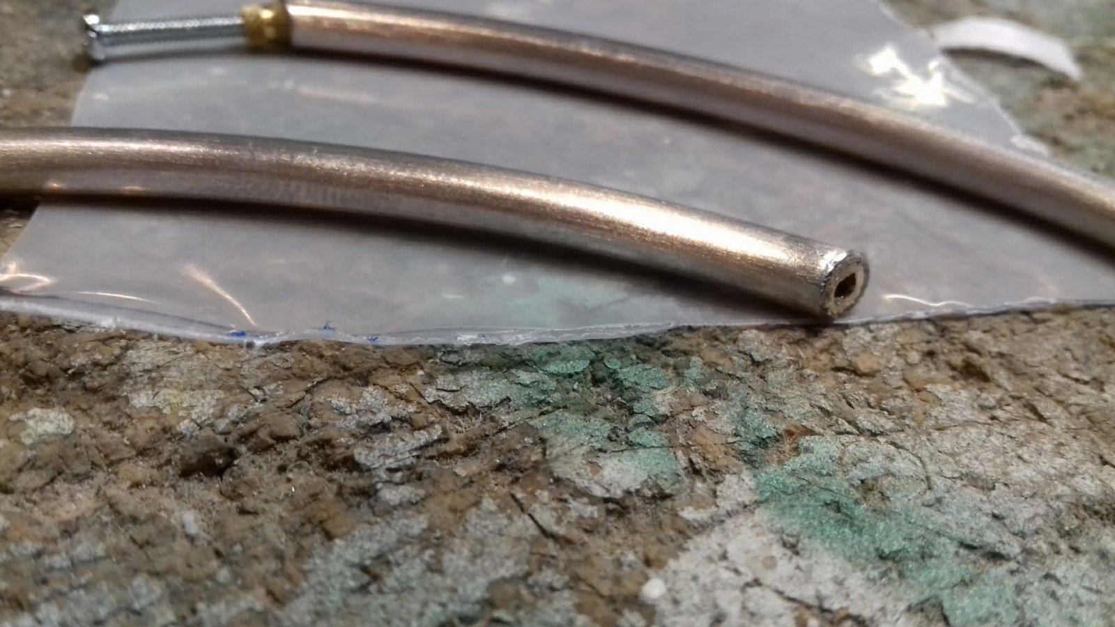

8mm removed from the forearms brings her hands into the right place, brass rod 2mm and cyano to refix.
The seat is getting the fill and rub down treatment. So very cold here at the moment it can be hard to get the painting done.

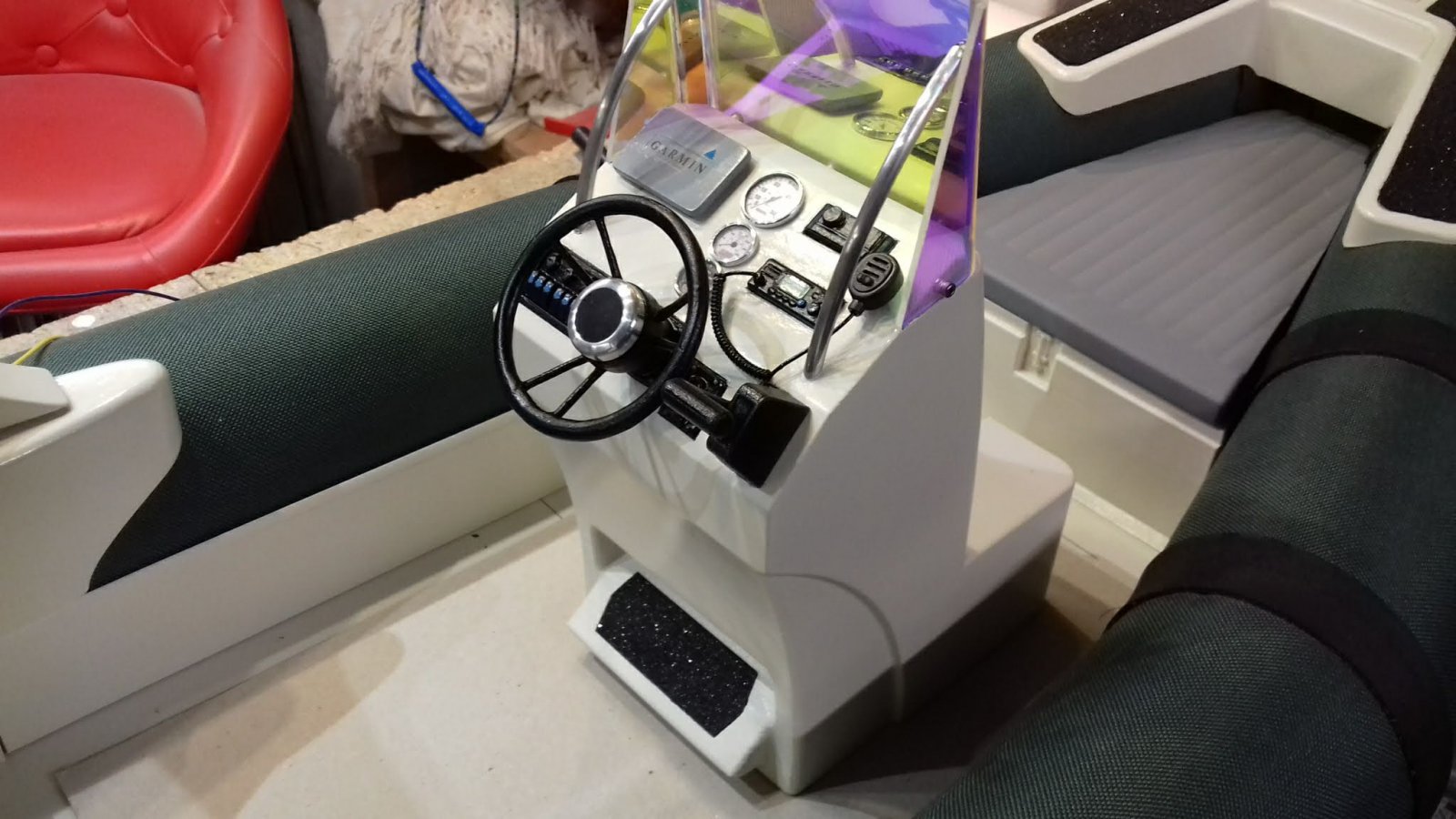

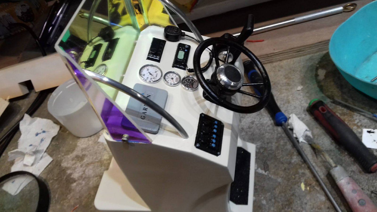

Cushions now fixed to the console.

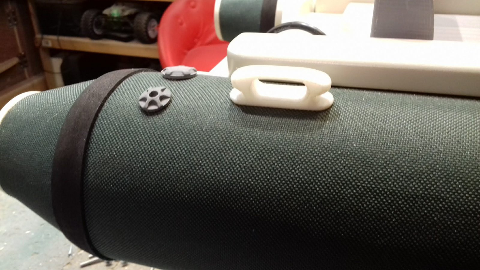

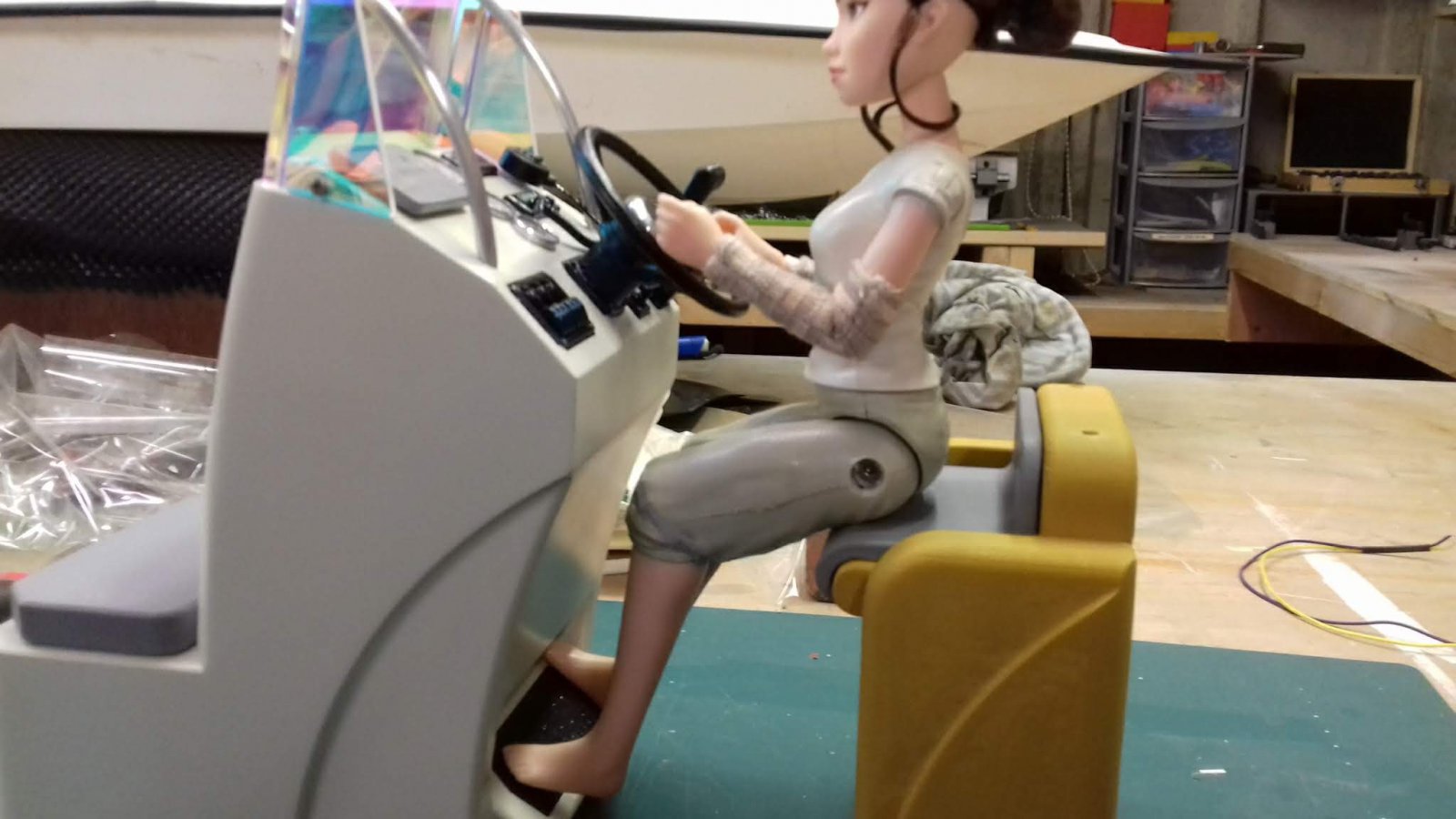

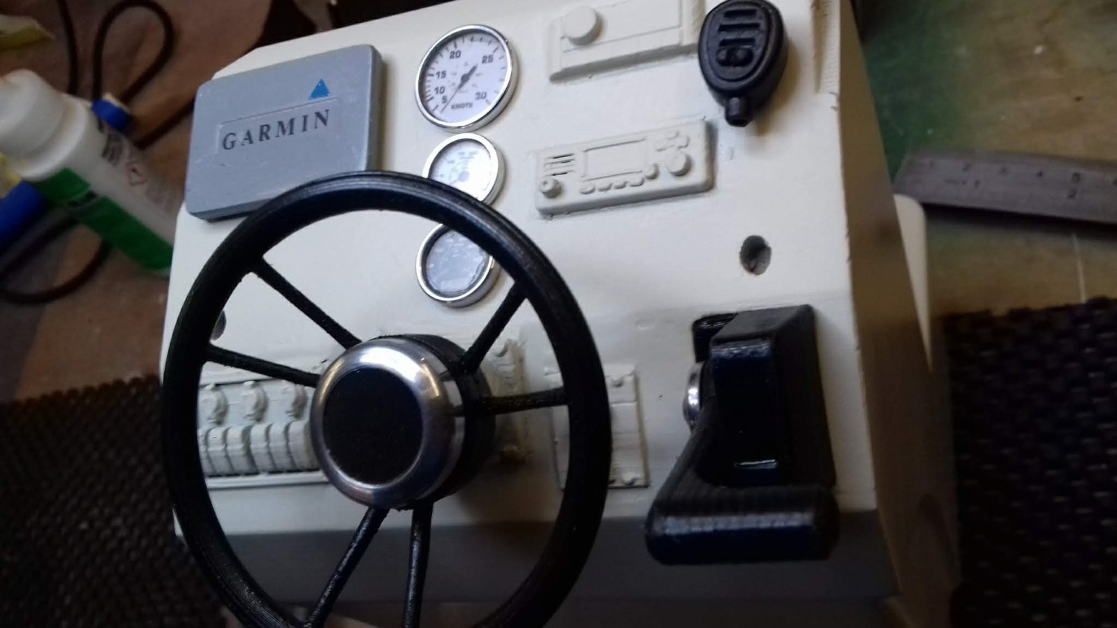

The air valves were printed at 0.15 normal, I think they were worth The trouble to make, once other bits are added they will blend in and add to The overall look. The captain will need to be screwed to the seat from inside, I think I can do that.
Decided I didn't like the cowl so it's now going to be black with silver Suzuki lettering just like full size.
Neptune Ribs in Ireland

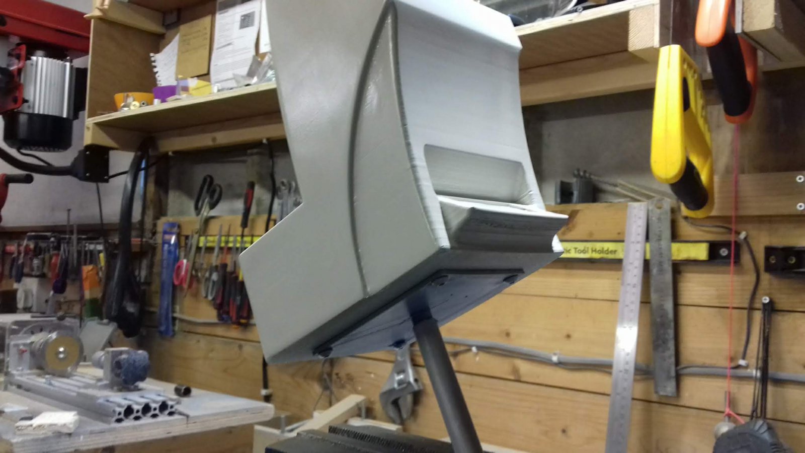

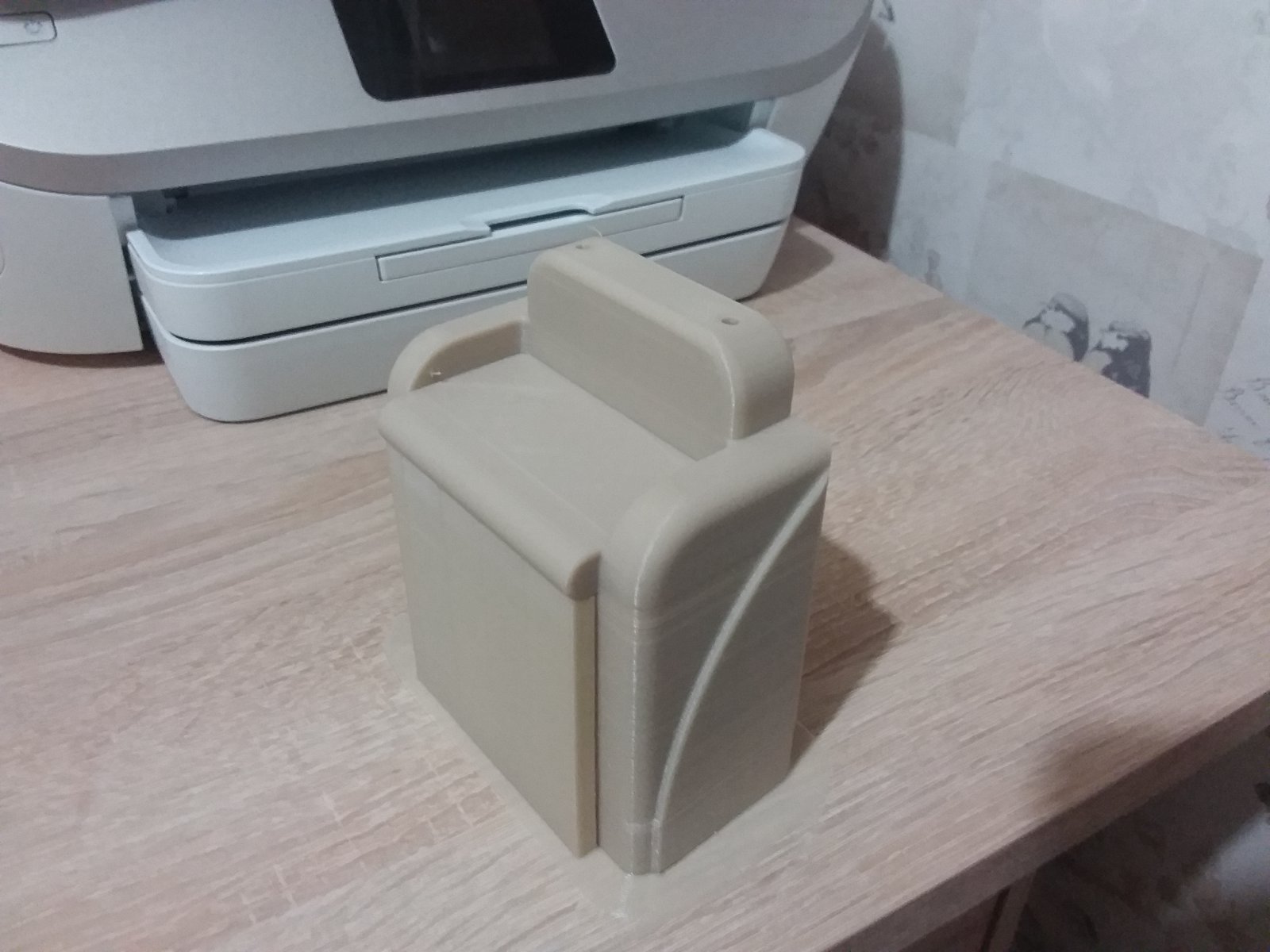

Good job I only made one of these, it needs to loose some height, be a bit thinner on top and maybe a tad shorter. Wish I'd realised before cleaning it up.

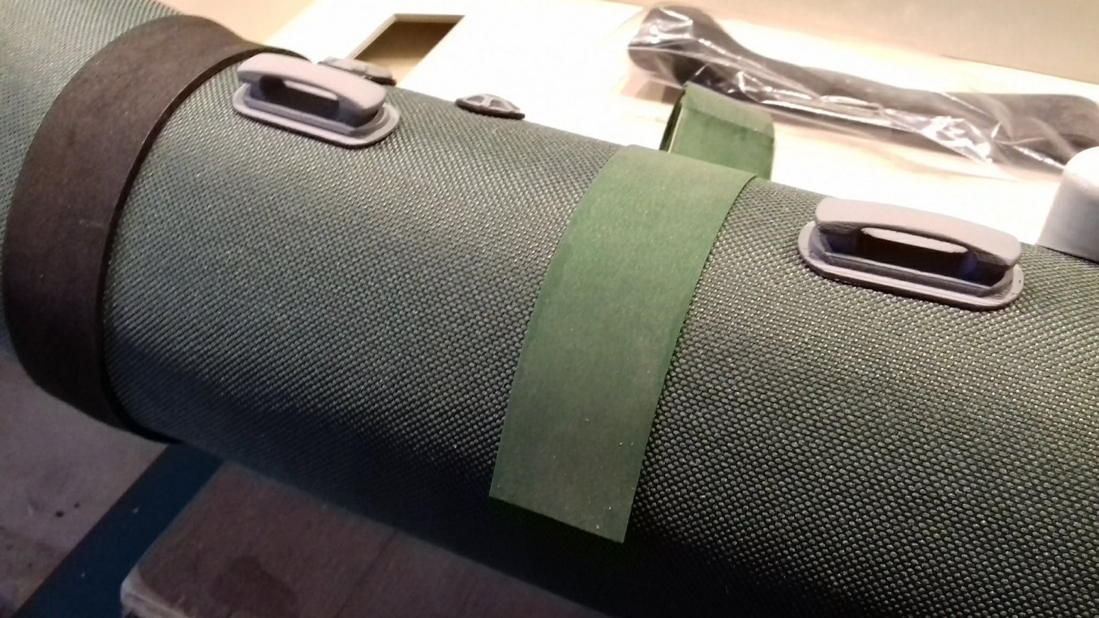

P.S. seems I opened a can of worms with this latex. Its difficult stuff to glue, it began to look like spending £20 on the special glue and thinners. Anyway I did a small test using some rubber cement innertube glue I had on my bike. It worked quite well, might be even better if I clean first with acetone, so I've ordered 2 tubes for £4 , more like it. The latex reacts by curling up at first, but gradually flattens out again. Both surfaces are coated then left to dry for a while and then pressed together.
