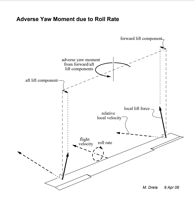

Nalv. het bovenstaande er toch nog even dieper ingedoken, en dan komen we (via Rob) al snel uit bij Mark Drela.
Die zegt:
It's important to realize that adverse yaw is mainly caused by a fore/aft rotation of lift forces due to roll rate, and not by a drag imbalance. This is illustrated in the attached PDF.
Yes, there will be some additional adverse yaw contribution from a left/right imbalance in profile drag. But if the airfoil and flap are designed appropriately, and the deflections are modest as is typical in thermalling (less than 5-10 degrees, say), the profile drag contribution to yaw moment will be quite small compared to the primary rotated-lift effect shown in the PDF. There will also be an additional yaw moment contribution from a left/right imbalance in induced drag, but again this is very small in a typical roll maneuver.
The reason why the drag contributions are small is because deflecting the ailerons causes surprisingly little lift imbalance between the left and right wings. The roll rate which ramps up in a fraction of a second after the ailerons are applied mostly cancels the aileron-caused lift imbalance. And if the left/right lift is nearly the same, the drag will also be nearly the same as long as the flow stays attached.
The drawback of aileron differential is that in order to be effective, it must intentionally create a large profile drag increase on the upward-deflected aileron side, typically via flow separation off the hinge. "Frise" ailerons actually promote this separation by protruding the aileron LE below the airfoil bottom contour. The reduction of drag on the downward-deflected aileron side will not be sufficient to signficantly cancel the adverse yaw if the flow there is clean to begin with --- can't reduce the profile drag very much if it's already close to the minimum "clean" level.
.pdf:
Nadere toelichting is hier te vinden:
https://www.wattflyer.com/forums/showthread.php?t=77285
Ingewikkelde materie!
Ik ben geneigd voor de Blanik vooralsnog een 1 : 2 differentiering aan te houden, en rudder mee te mixen.
jan.

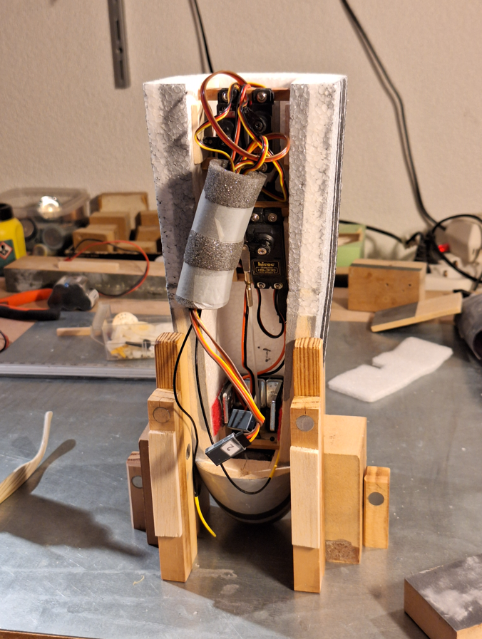

Vandaag was dan het plan om toch weer een keer met de Blanik te vliegen (en zelf aan de knuppels te staan).
Ik had 'm opgebouwd en tijdelijk even onder de tafel gelegd (er stond toch iets meer wind dan verwacht).
Op zeker moment til ik 'm onder de tafel vandaan (twee handen om de vleugels, hand onder, duim boven), blijft de staart onder de tafelrand halen.
Dus glijden m'n handen van de vleugels en @#$%^&*! dondert het hele ding (hoe hoog is een tafel?) een kleine meter naar beneden.
Landt (. . .) op het wiel, en door de traagheid breekt de neus er af.
Dat zijn van die gebeurtenissen waar ik slecht tegen kan.
Maar goed, een 'mooie' breuk (deugt die lijm wel?).
De neus, met alles waar magneetjes in zitten neergezet.
Dit er op gesmeerd . . .
Achterstuk er op geplaatst; drukt zichzelf aan.
Morgen maar eens kijken . . .
jan.

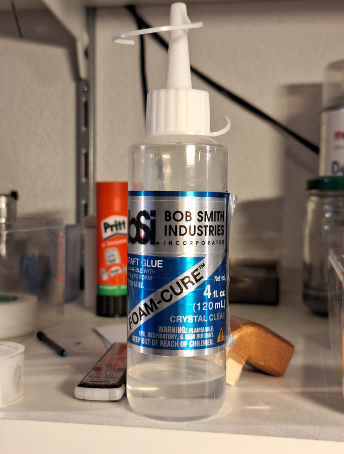

De FoamCure lijm is een Chinese variant van UHU POR en laat zich op dezelfde manier verwerken:
óf beide vlakken insmeren en laten aandrogen en vervolgens aandrukken, geen correctiemogelijkheid want het zit gelijk vast.
Óf dun aanbrengen en gelijk de te lijmen vlakken samen brengen en laten drogen, waarbij fixeren nodig is, want het schuimt licht op.
Als de delen bij een val breken op de lijmnaad, dan deugt óf de gebruikte lijm niet, of het schuim is niet 100% vetvrij en licht opgeruwd geweest...
Groeten, Jan.
