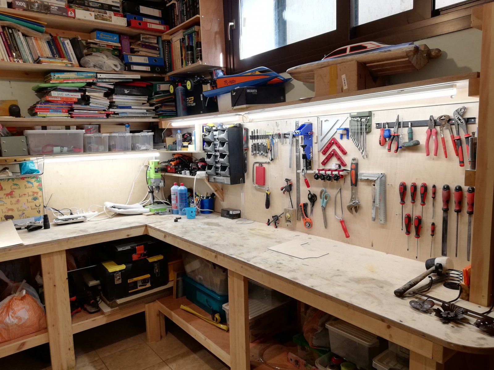

Oh oh Jan you have such a nice working bench now. I love it, is it diy?
Let me show you my diy working bench which may help you to get some ideas for further expanding this hobby corner:
Recently I added three selves and I also want to make a couple of of drawers. The plywood on the wall is very helpful in order to easily hang the tools you usually need.

Nice hobby corner Dim and thank you for the tips. I will definitely consider the plywood on the wall.
My hobby corner is diy. Partly made by the previous home owner and now being extended by me.
