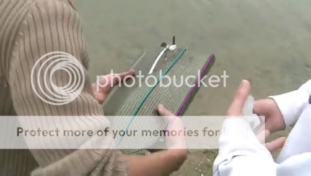

Hello Majestic,
wow, I came here just by chance and was totally surprised to see my old F1E+1kg here in a discussion :-))).
The hull is from Jürgen Winkler. The hull was disigned as a F1-6,5 cm3. I guess that Jürgen still has a hull at home.
I build the boat for the Naviga championship in 2008. It was equipped with a Lehner 2250/13 and 30 cells 4200. Speed controller was a YGE 200. Propeller was CH 3.
In comparison to other boats I must say that this boat is quite stable on the water (even if there are some waves) and easy to handle.
Because the geman "nauticus" refused to take part at the championship, I skipped my hobby a sold the boat. So it´s intresting to see what kind of journey the boat is doing. :-))
I you´ve questions about the hull you can contact me.
Best regards
Marco

Hi Joris,
yes the boat that you can see in the youtube video was originally from me, but the guy who has bought it could not drive very well and not very fast. ;-)
I got the hull from Jürgen. So if you also want to have an additional one, I guess that you can directly order one from him.
To have an better impression about the speed that would be possible, I recommand this video (it´s the boat from Gerhard Zibauer):
[URL="
+ 1kg Lehner Motoren Technik - YouTube[/URL]
Regarding your question about the weight: I´m not sure, but when I remember right it was something around 300-350g.
I also saw that you had build in a ca. 1-2mm concave part in the longitudinal direction, which is very important. This part should begin at the point where the prop is placed.
I also made a pic of the recommanded assembly dimensions for the 650mm long boat.
The plan for the rudder you can see here:
