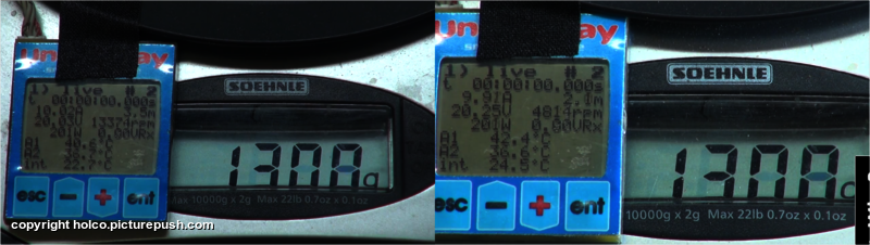

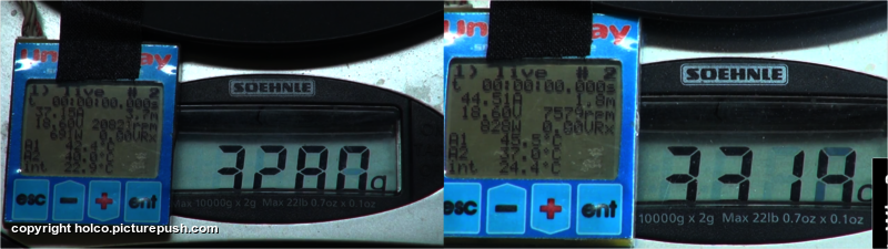

Wat test indicatie van de Plet bij verschillende belastingen,
Wat g/Watt uitkomsten, rechts is de Plet
7,3g/Watt------------------------------------------------------7,8g/Watt
6,9g/Watt------------------------------------------------------7,3g/Watt
6,5g/Watt------------------------------------------------------6,5g/Watt
6,2g/Watt------------------------------------------------------6g/Watt
4,7g/Watt------------------------------------------------------4g/Watt[/quote]
