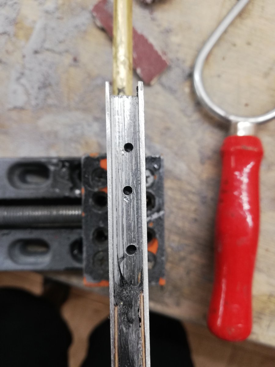

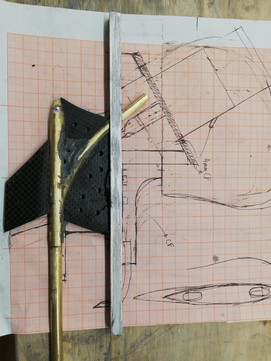

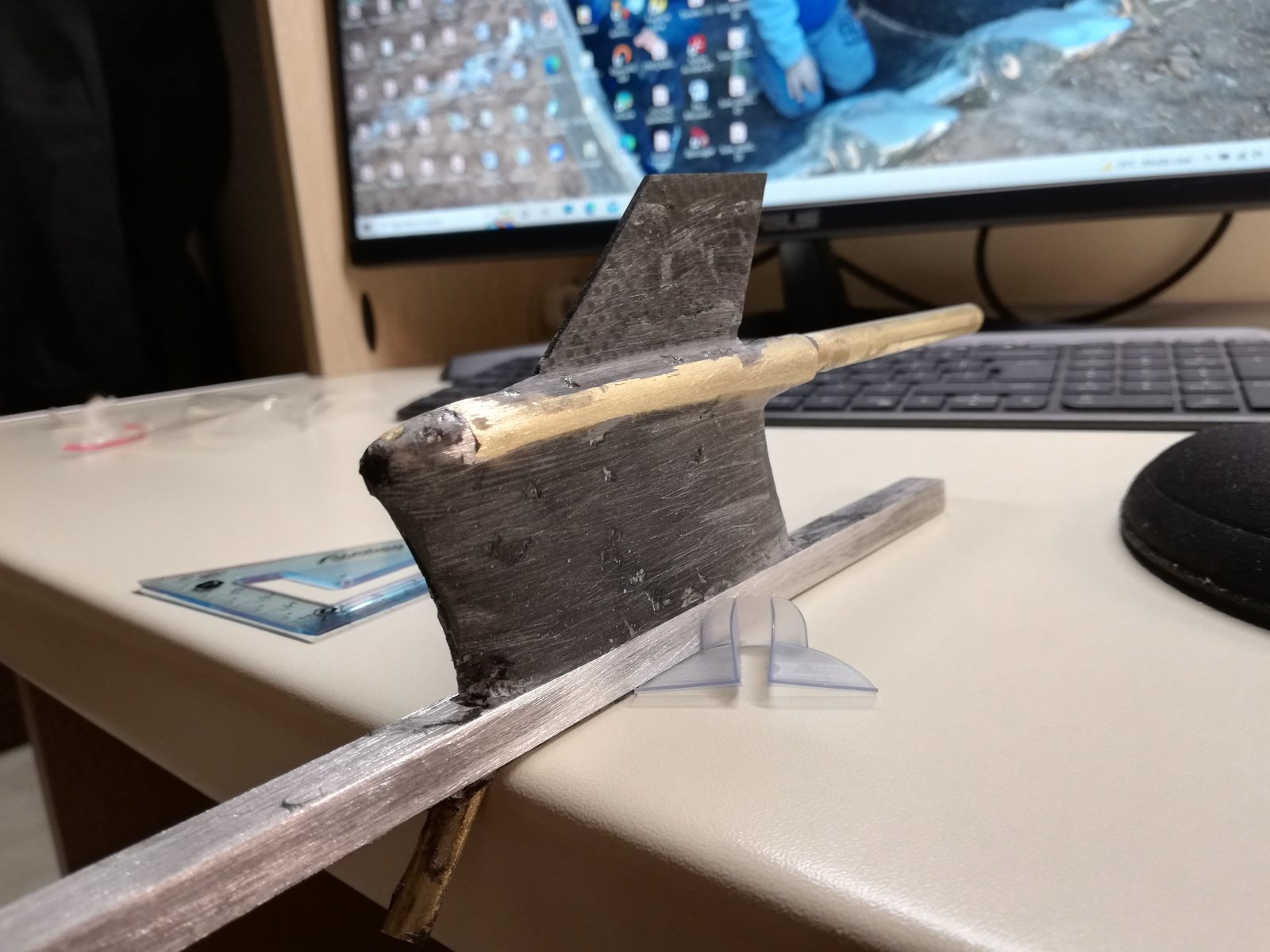

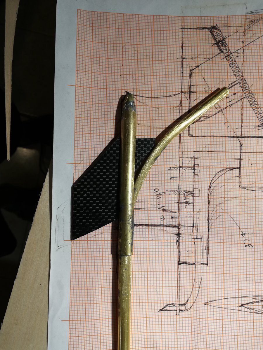

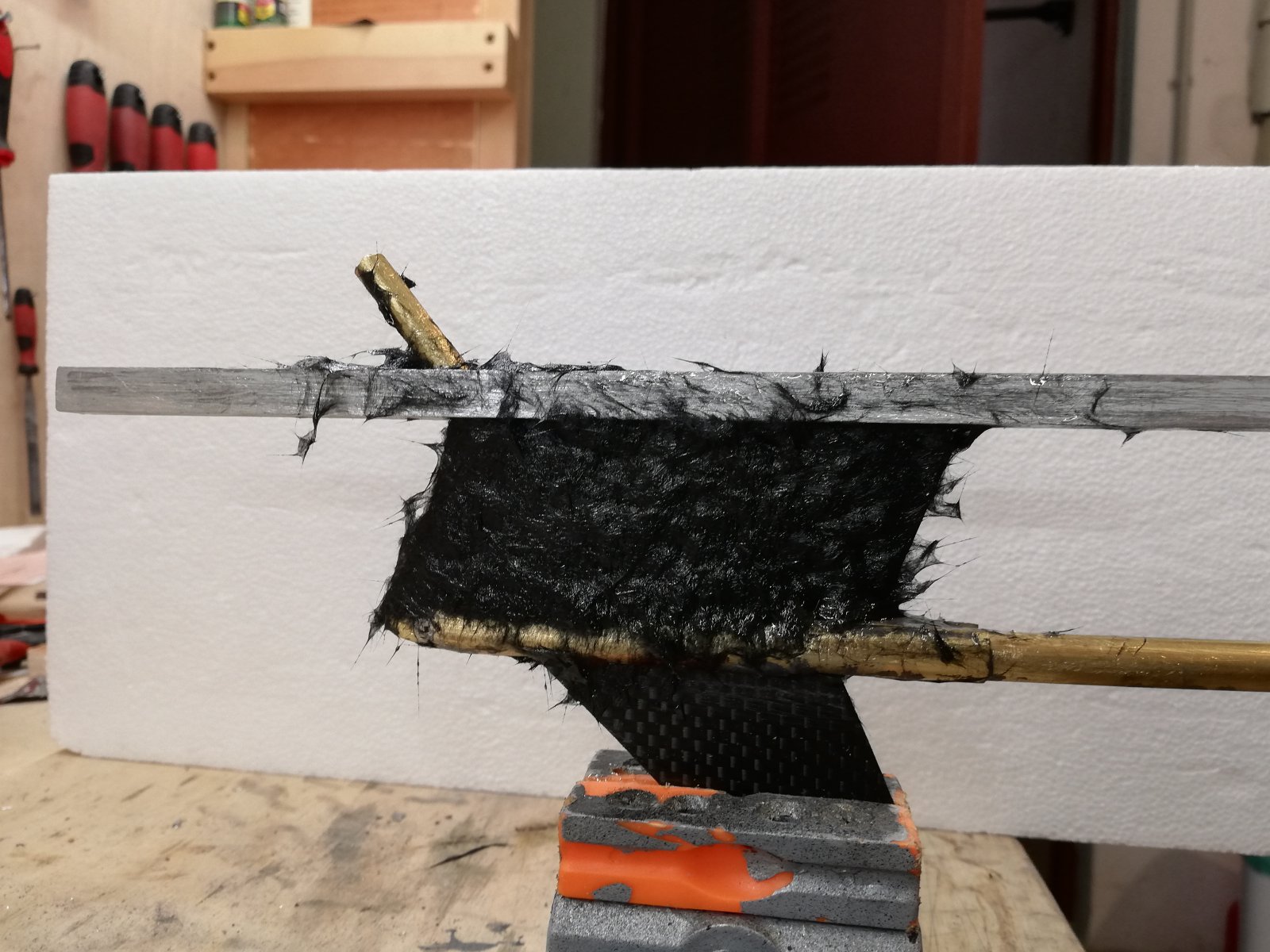

A new outboard drive is under construction! This time is a bullet drive with a 4mm flex shaft in order to handle the torque of a 36 mm motor. Again the end piece of the flex shaft will be based on two ball bearings. The building technique differs from my previous DIY outboard as you see in the photos below. Chopped CF with epoxy resign to make the hydrodynamic shape of leg and strengthen the construction. Then sanding, putty and maybe fiberglassing the whole construction for even more strength. To be continued....
Wow, nice project! I lost count of your ongoing projects, but it doesn't matter, I like this one . How did you mount the fin below the flex shaft? Did you cut a slot in the brass tube? And I also wonder how you mount the ball bearings and how to prevent they fall out? I like this way of modeling, using just hand tools. I have some ideas for a DIY outboard as well and the chopped CF is a really nice method!

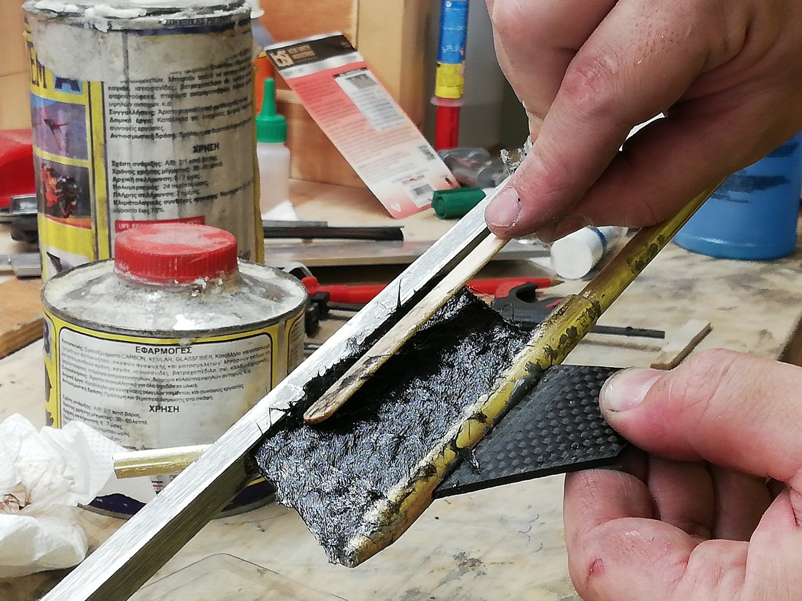

Thanks Jan! Having already some experience from the previous outboard, this time things seem to go really fast. This is a 3 day part time work, a couple of hours in the afternoon. So I believe it won't take long to finish this one. You are right Jan I cut a slot in the brass tube so that the fin anchors in the main body of the leg. The ball bearings are secured with Loctite. It has worked perfectly in my small outboard. I realized that the chopped CF or Fiberglass is another way to thicken your epoxy glue or resign. I also used chopped fiberglass to thicken the epoxy glue and the results were great.

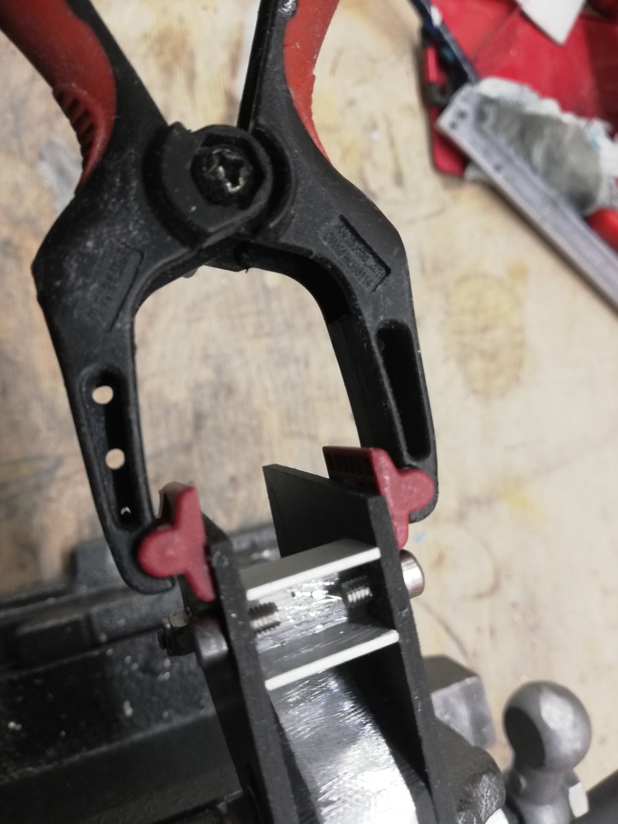

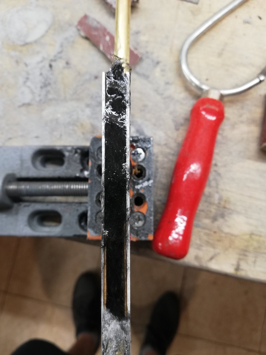

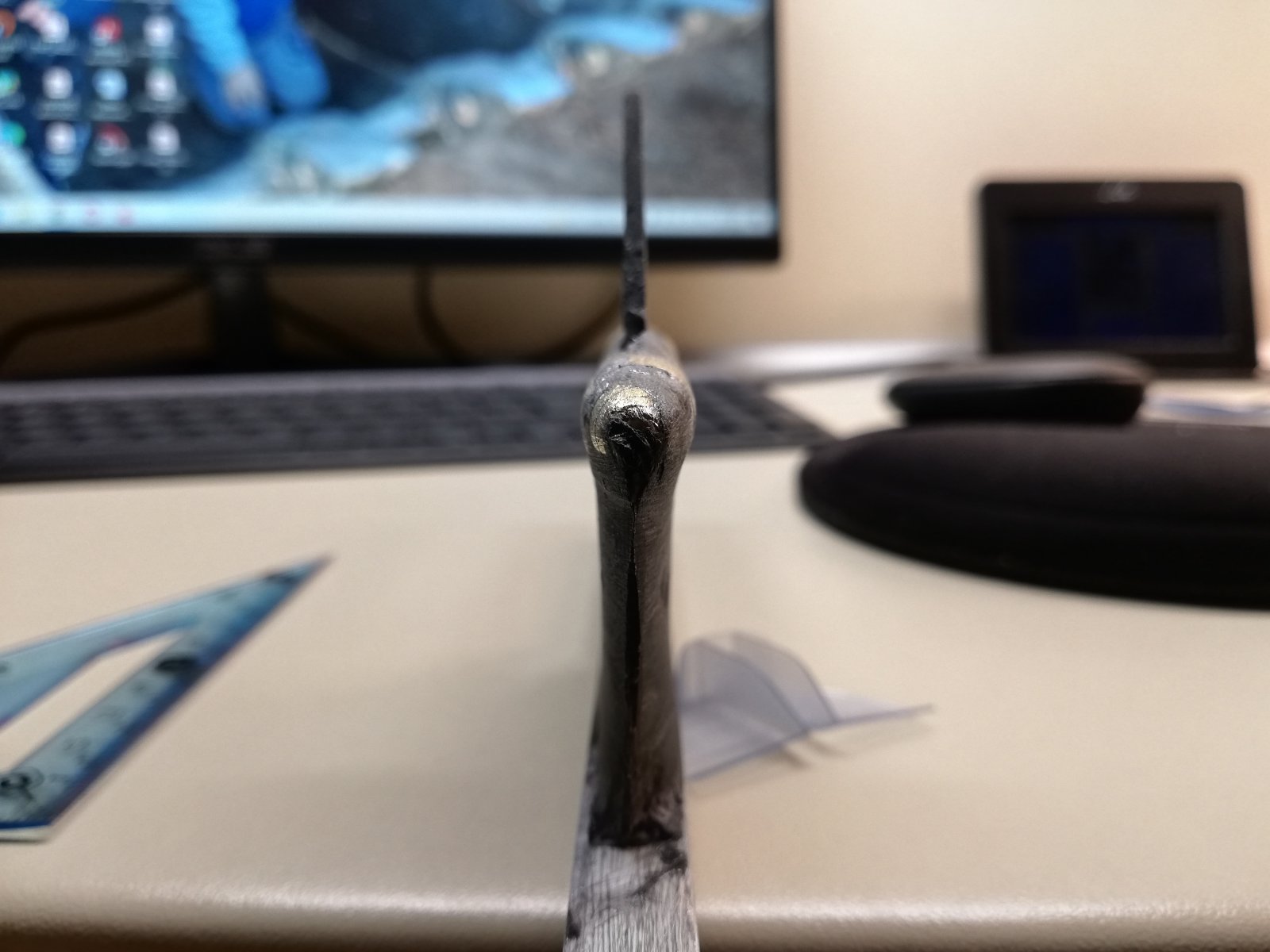

After some sanding (~ 20 min) with a 60 sandpaper the leg looks like this: The mix with the chopped cf (10% of the total weight) and the epoxy resign came out very nice. It is hard, solid and easily sanded.

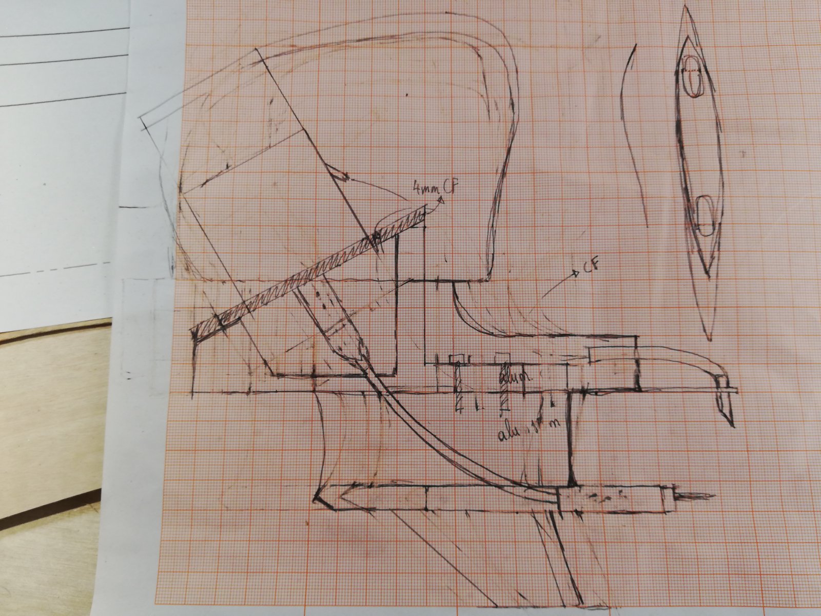

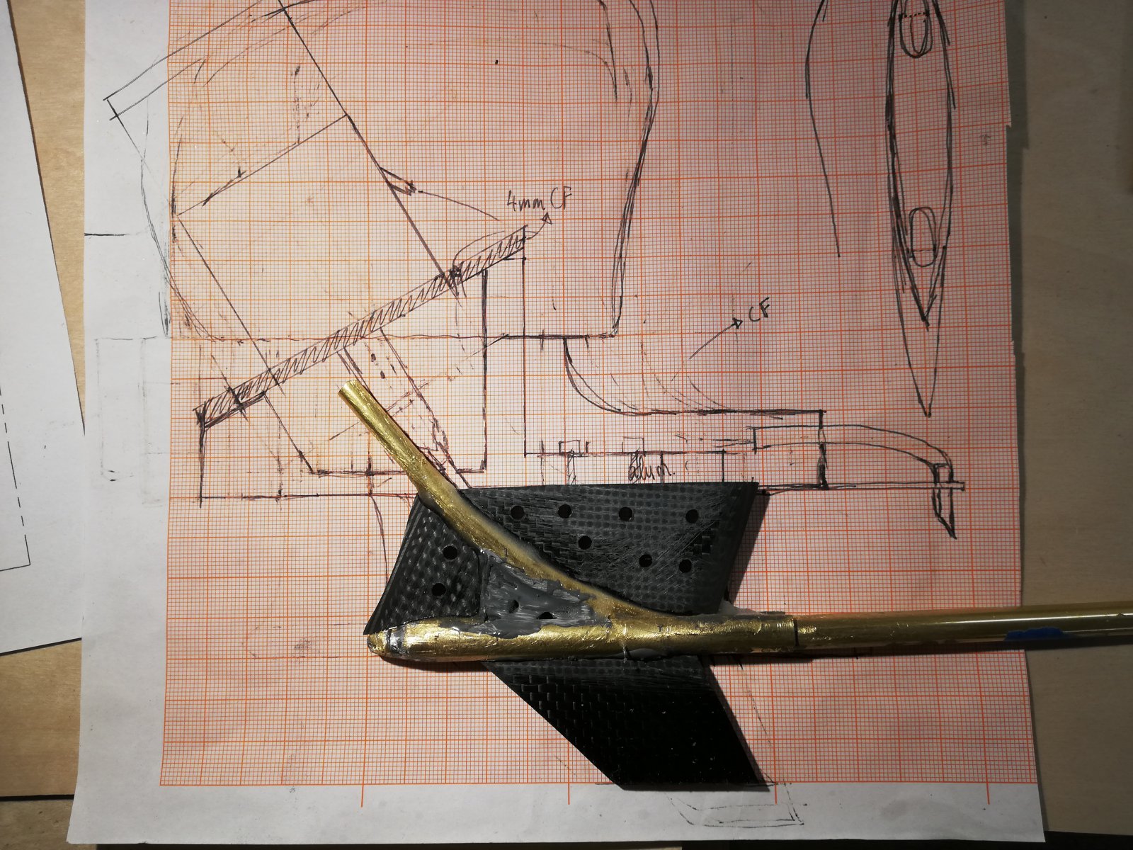

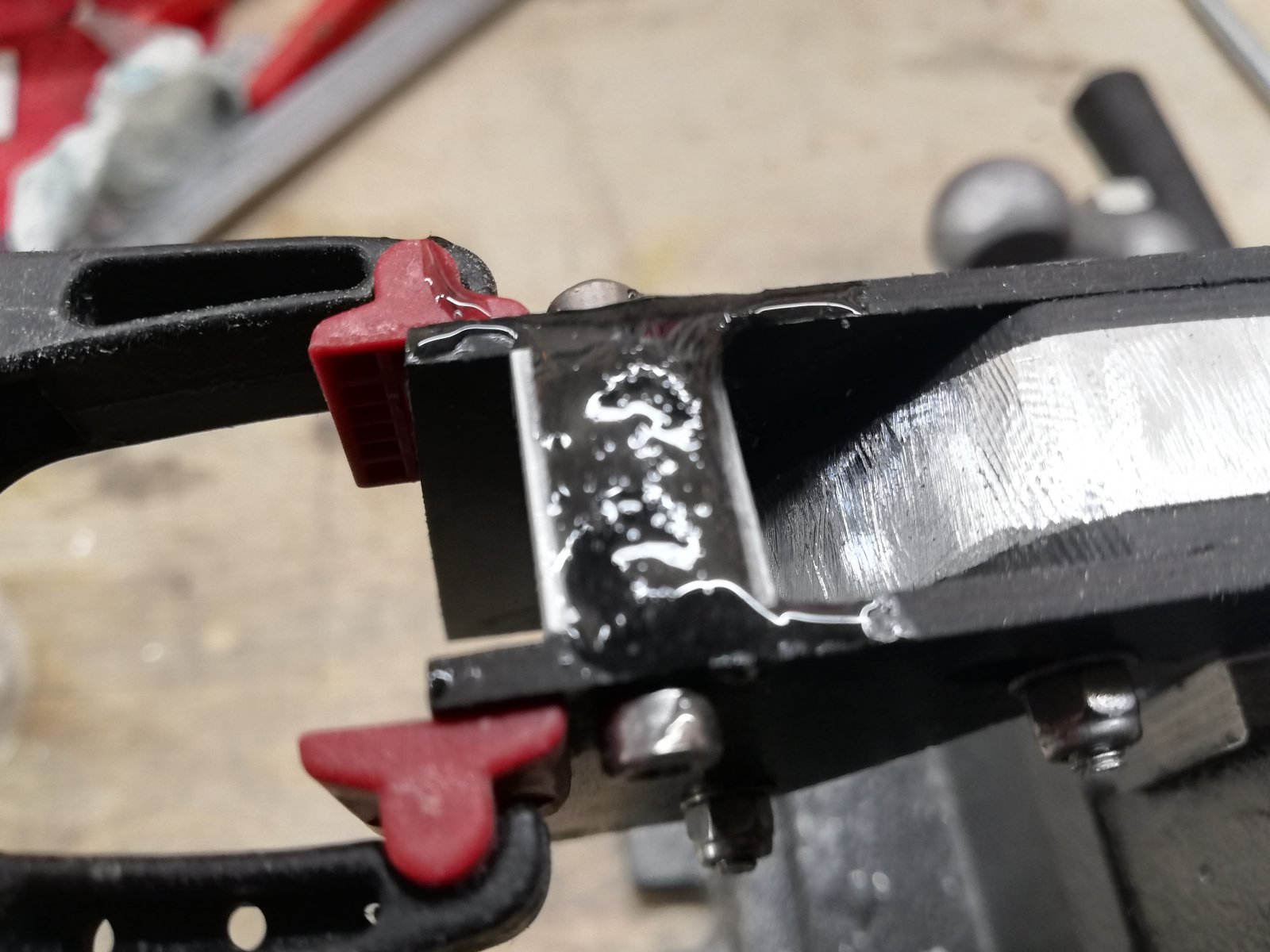

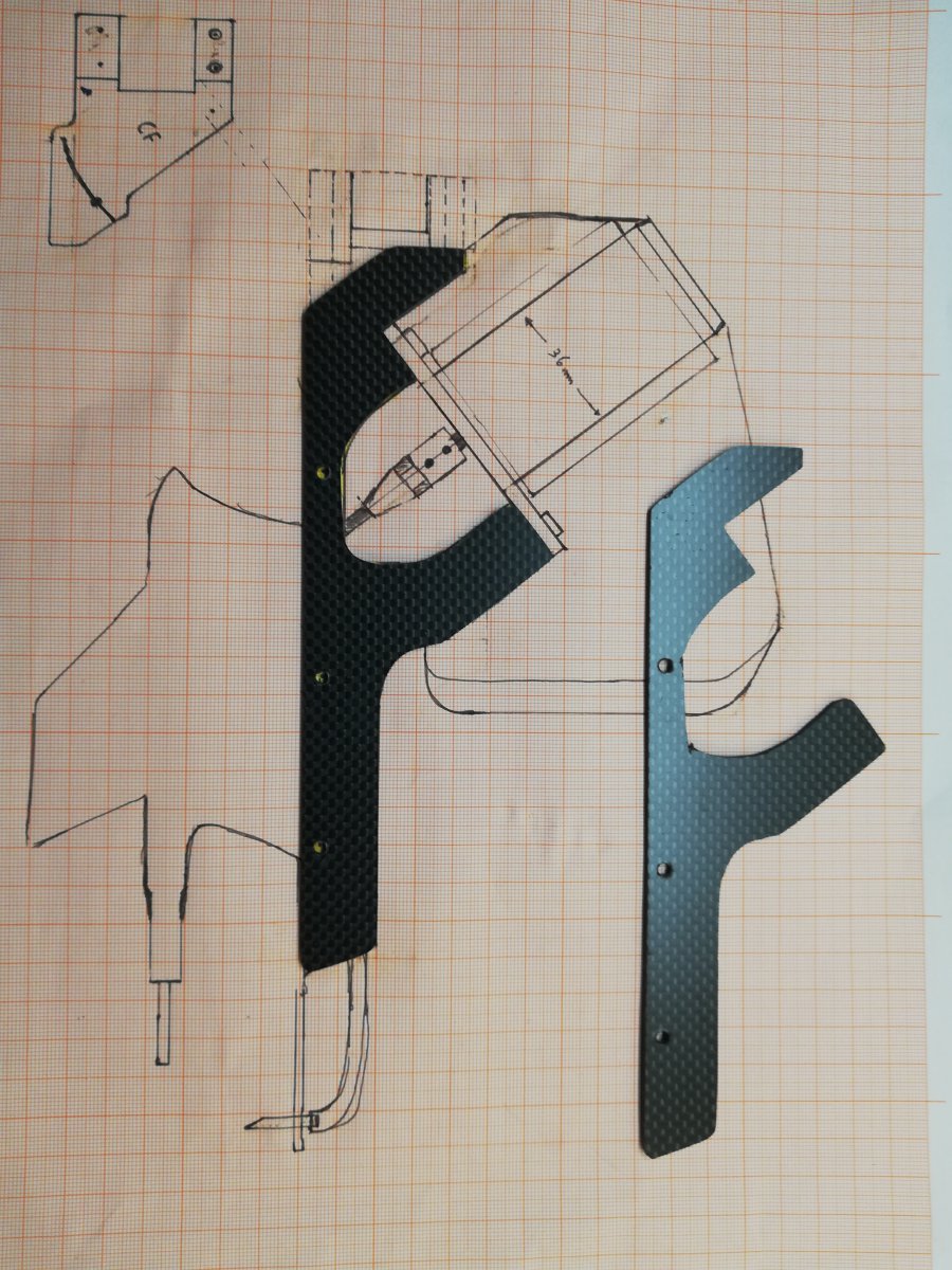

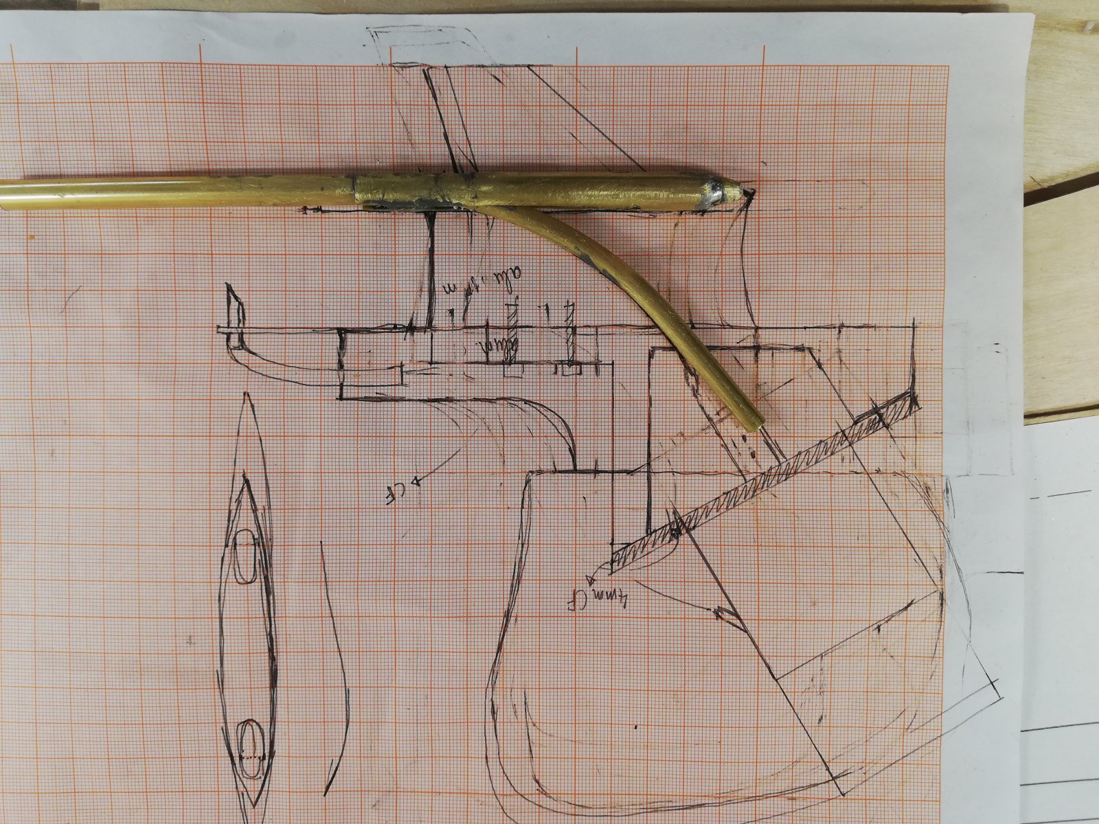

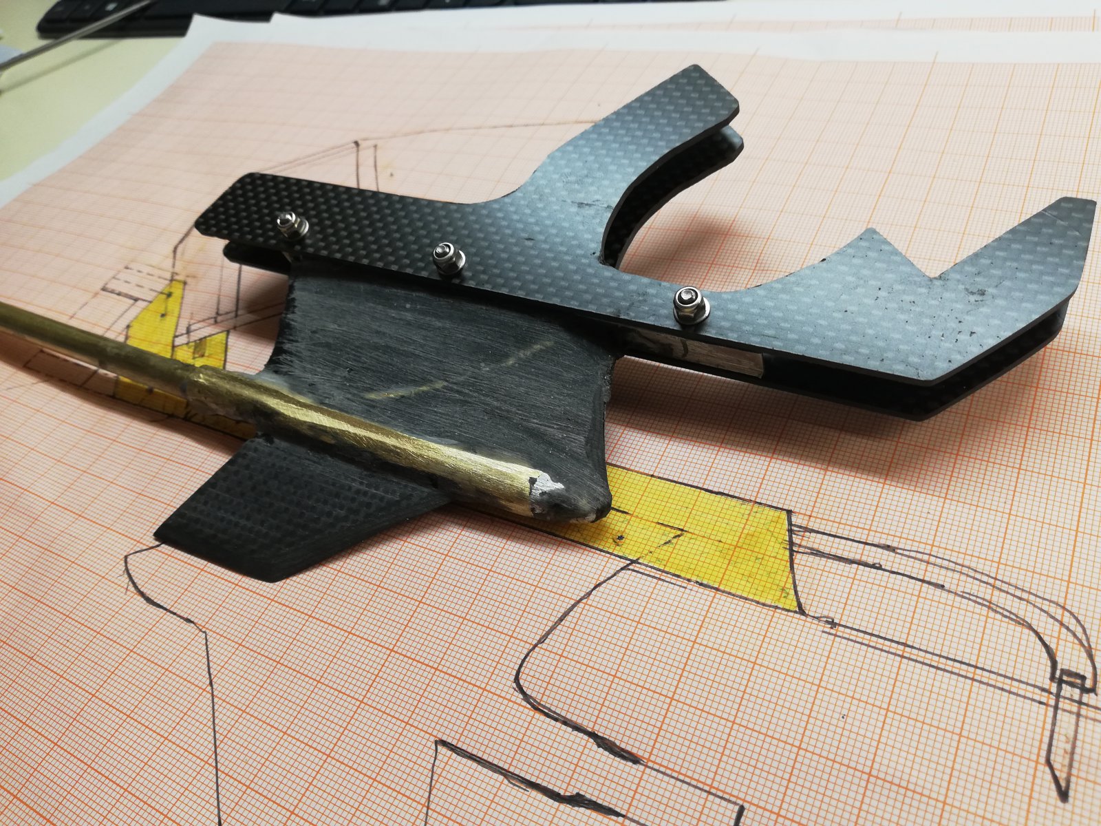

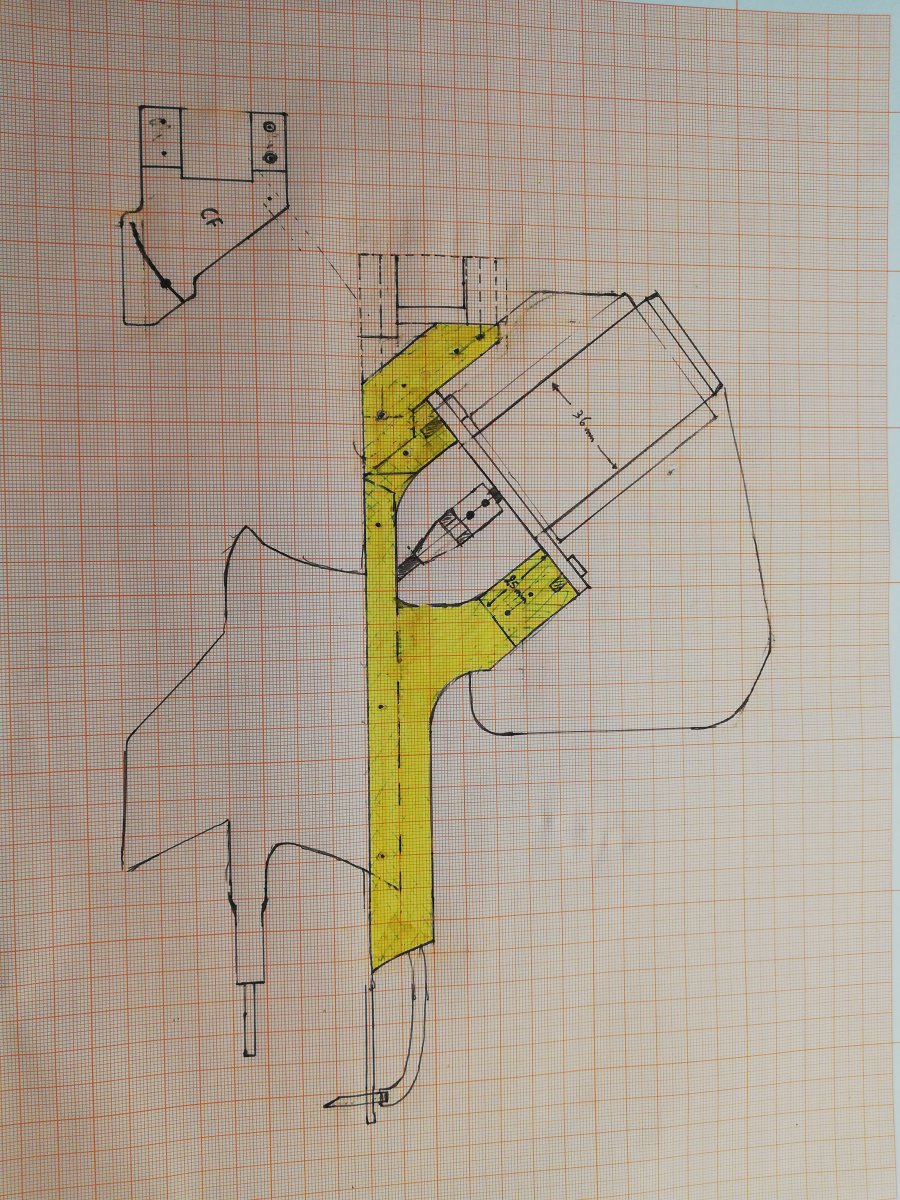

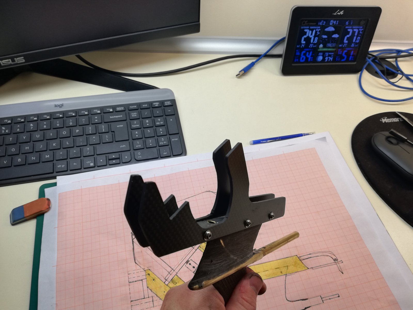

Some progress with the outboard. - I filled the U shaped aluminum with the CF resign mix. - Final detailed plans. - I cut the CF parts following the pattern. The outboard starting to take its shape. To be continued...
Wow, great work! How do you cut the carbon fiber? By jig saw? And do you wear a mask, or use a vacuum against the dust? I like your hand sketches, very 'engineering' style
Thanks Jan! This time I used my dremel with a disk to cut the pattern and then sanding to make the two pieces equal. Every now and then I stop to clean the dust with a vacuum cleaner and of course I wear a mask with filters. Then, I clean the surfaces and tools with alcohol because they are painted black due to the dust. It is not the best thing to work with CF you get messy. Oh that is a compliment from a real engineer!
It is considered more complicated to make a technical drawing or sketch on paper, than it is in 2D or even 3D design software! My compliments, true engineering!

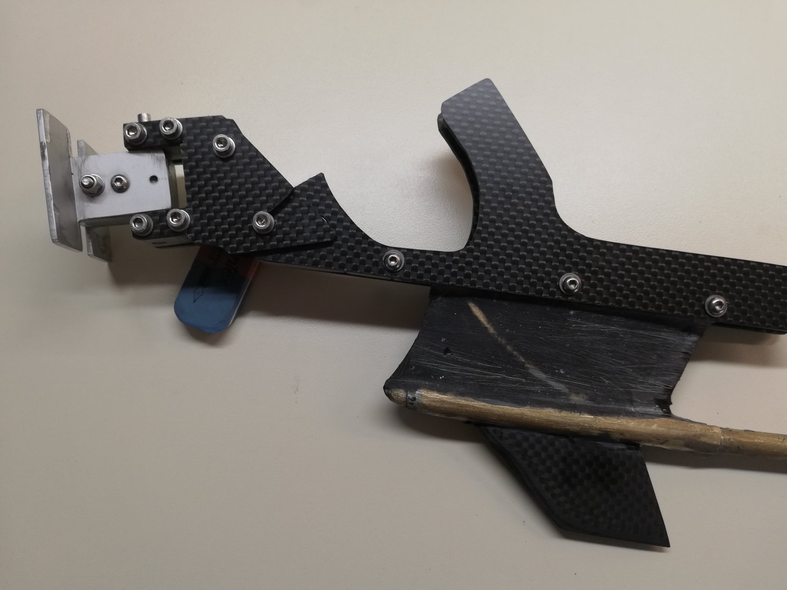

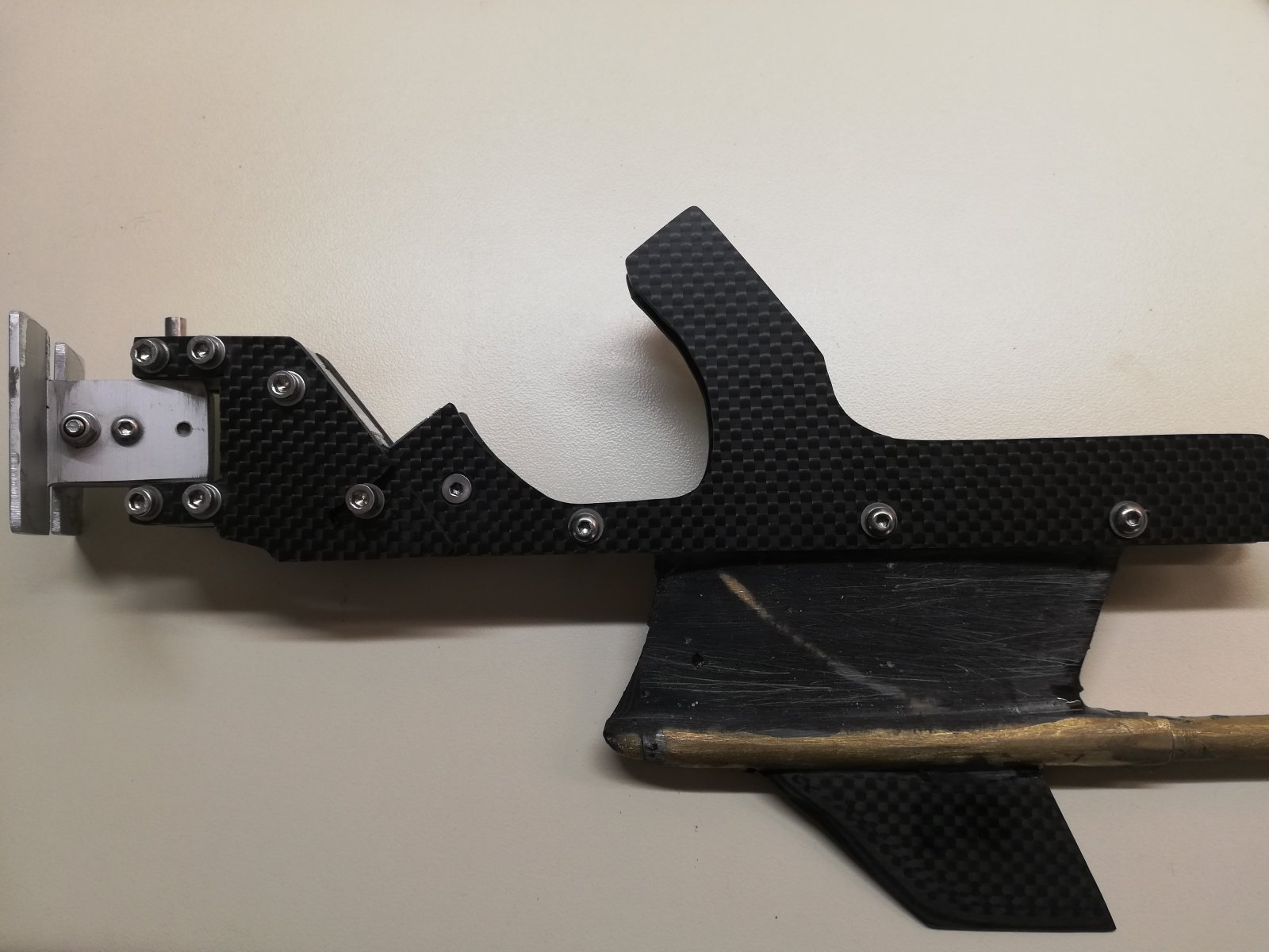

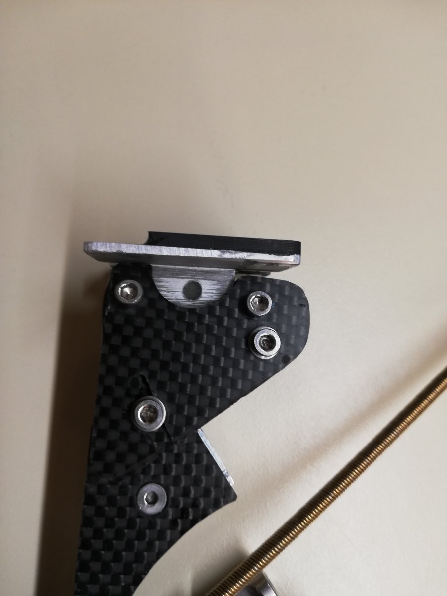

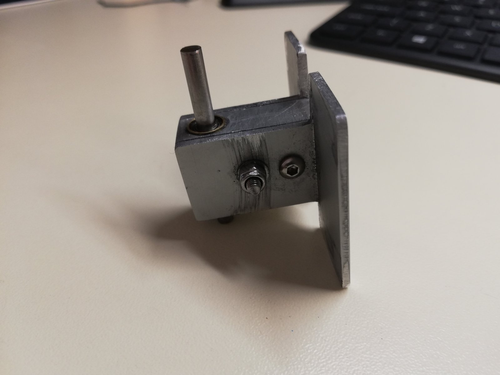

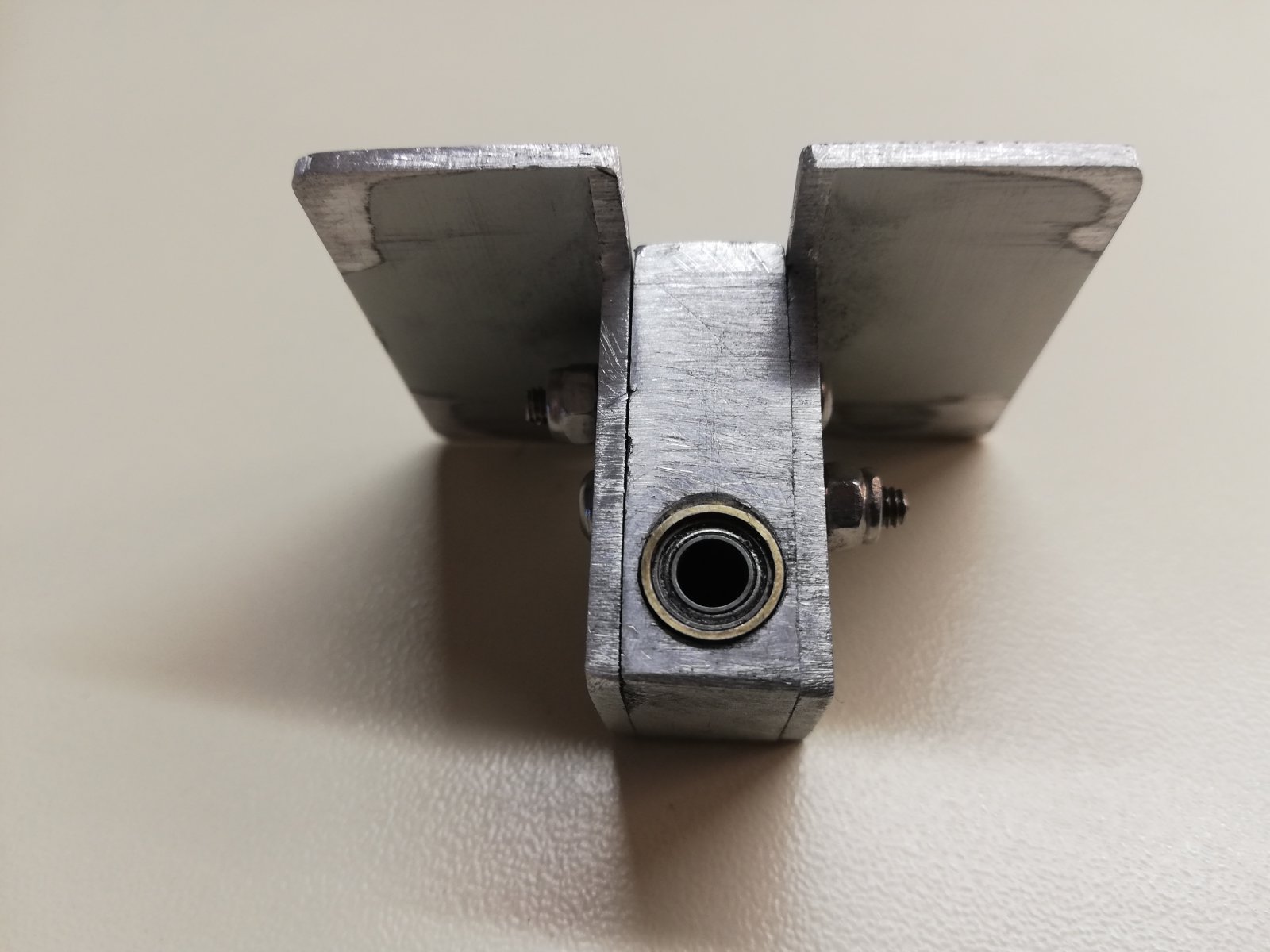

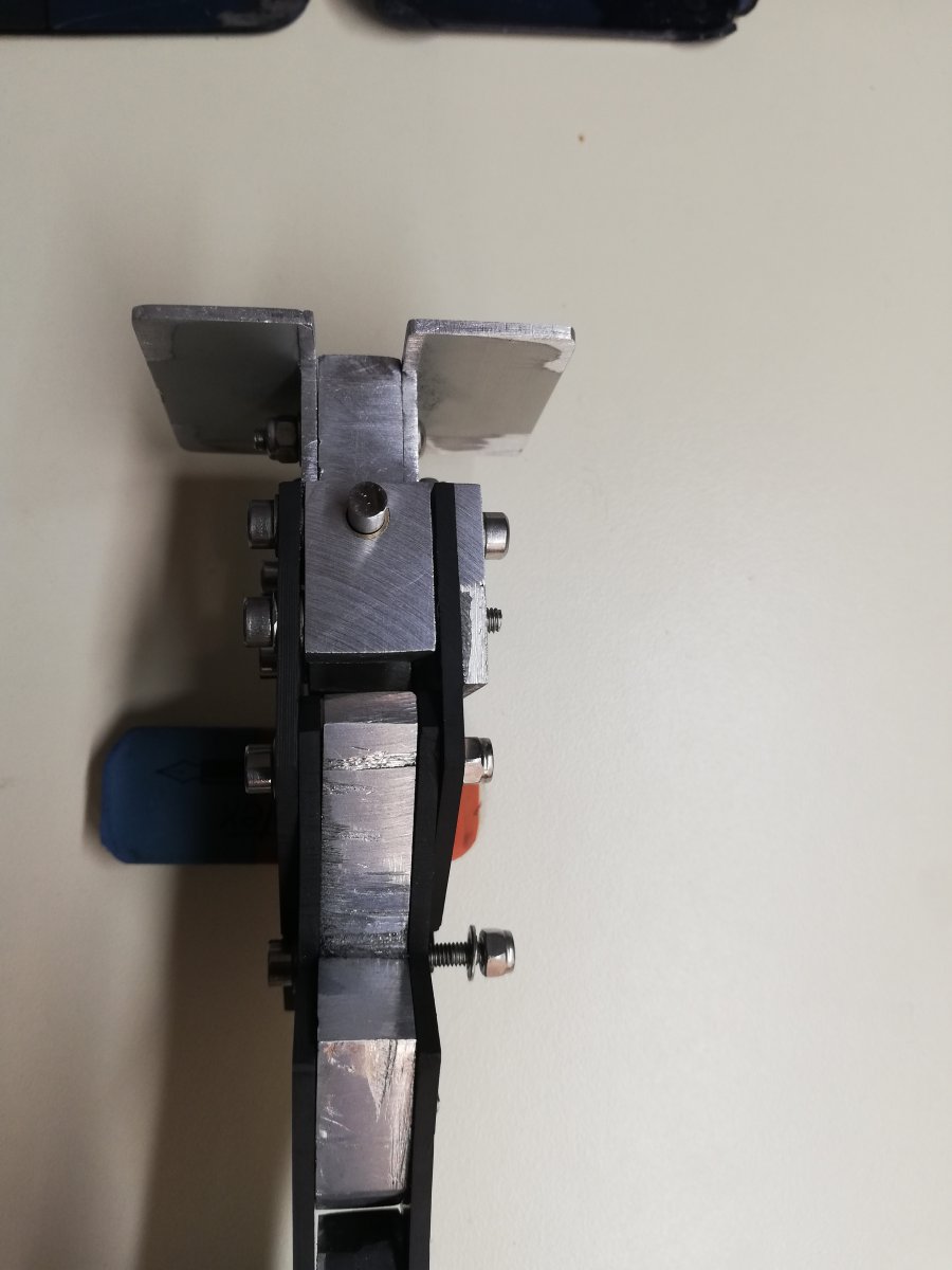

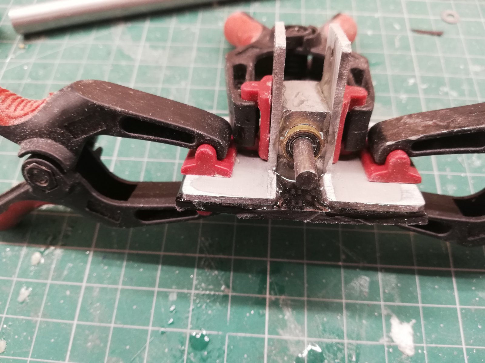

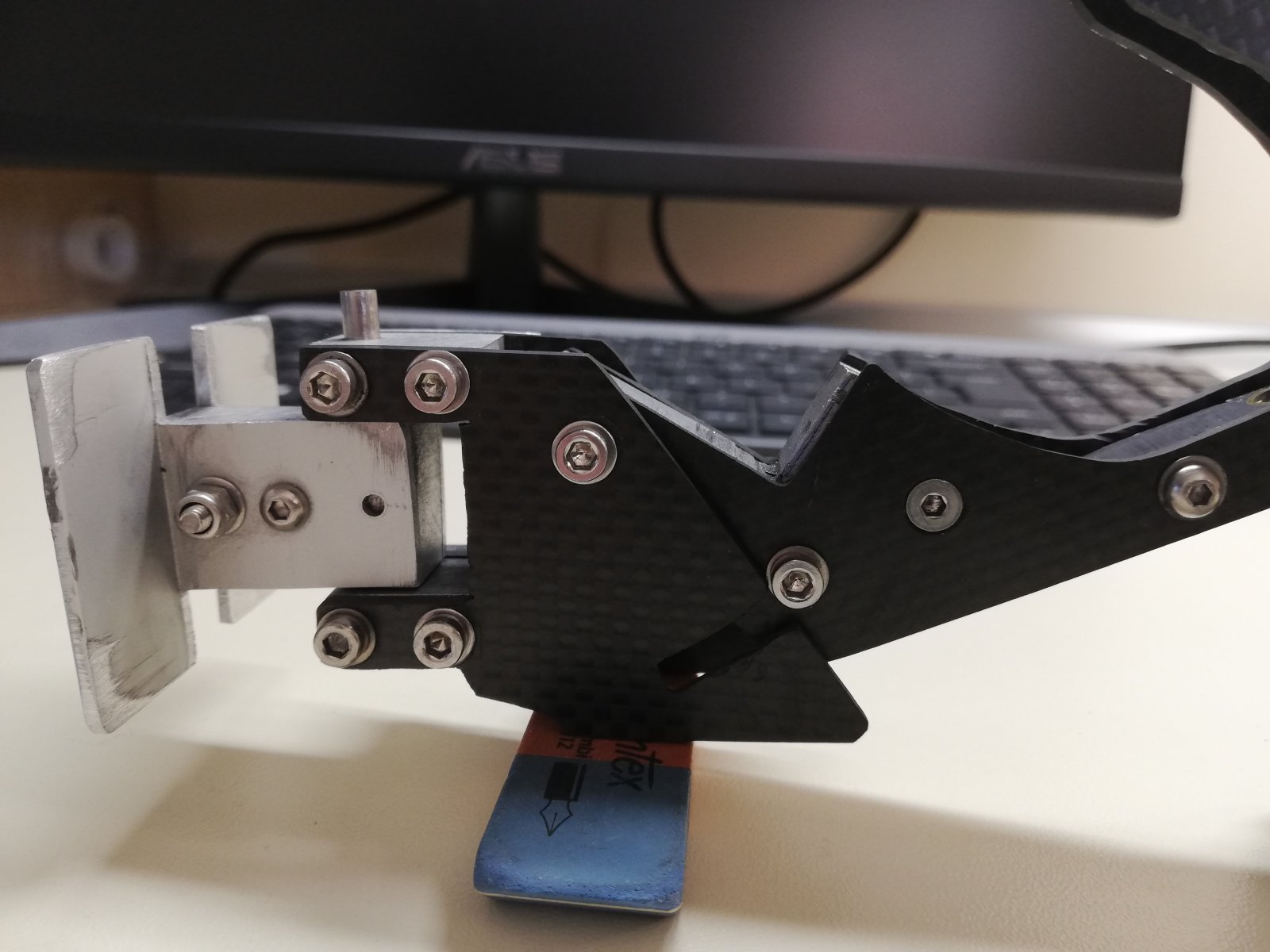

Well, this was by far the most tricky part of the construction, but I have adopted a number of innovations: 1. The hinge pin is based on two ball bearings for literally zero tolerance. 2. The angle of the hinge pin is unchanged when you change the angle of the outboard. For the advantages of this property and a related discussion you can see: https://www.intlwaters.com/threads/another-lower-unit-option.81251/page-3#post-809409 3. The outboard will go all the way up if it hits something in the water so as to protect the transom. Some details To be continued...
Wow, great job! I know the discussion about the hinge pin angle. I'm not sure if it is noticeable for fun boating around, but it is certainly nice that you adopted this. The assembly looks very professional with al the bolts. Did you glue the bearings in the outboard adapter with Locktite?
Thank you Jan! I agree that some things are just for the joy of construction . Yes, I secured the ball bearings with Locktite.

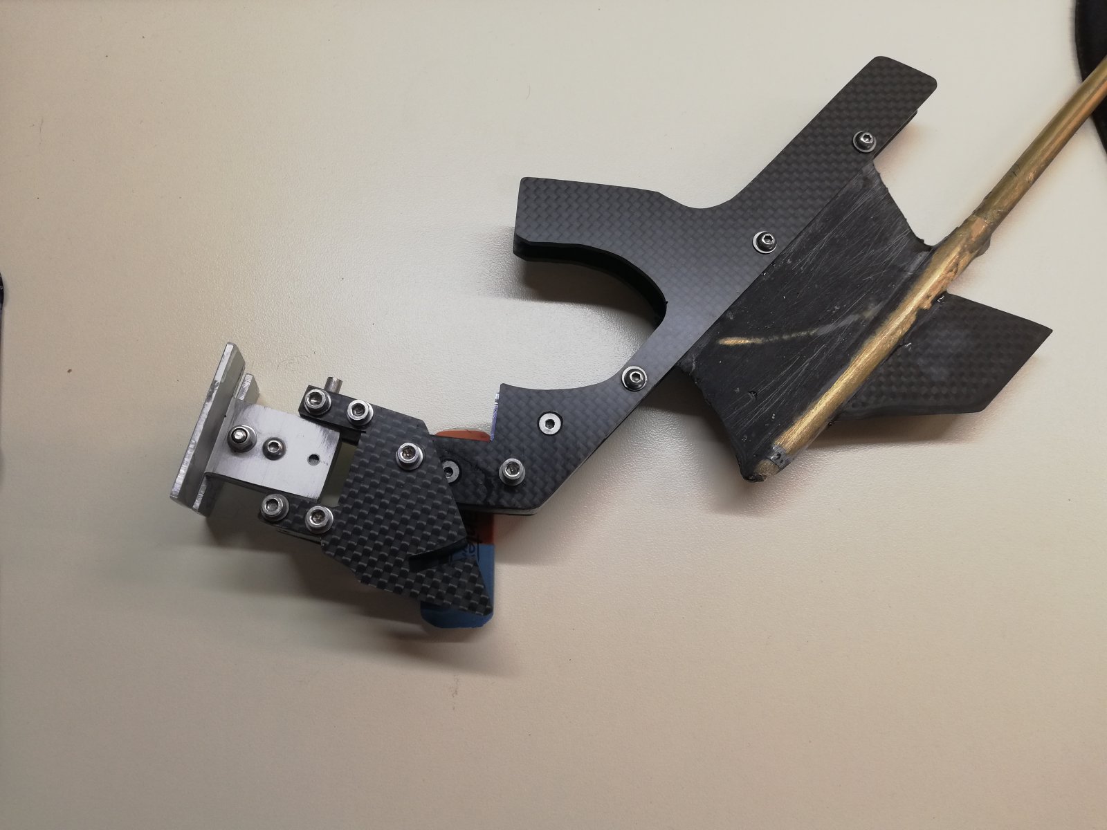

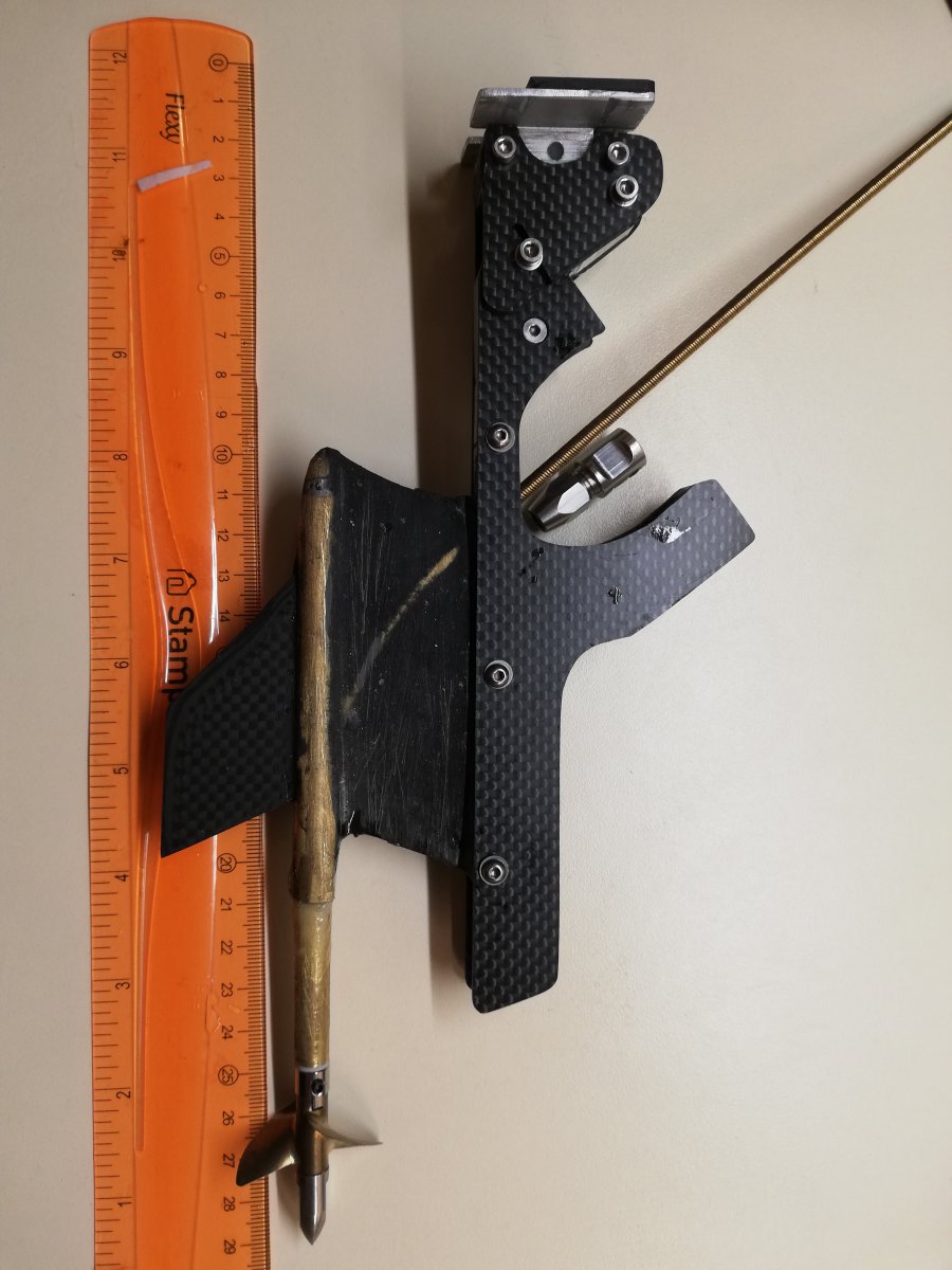

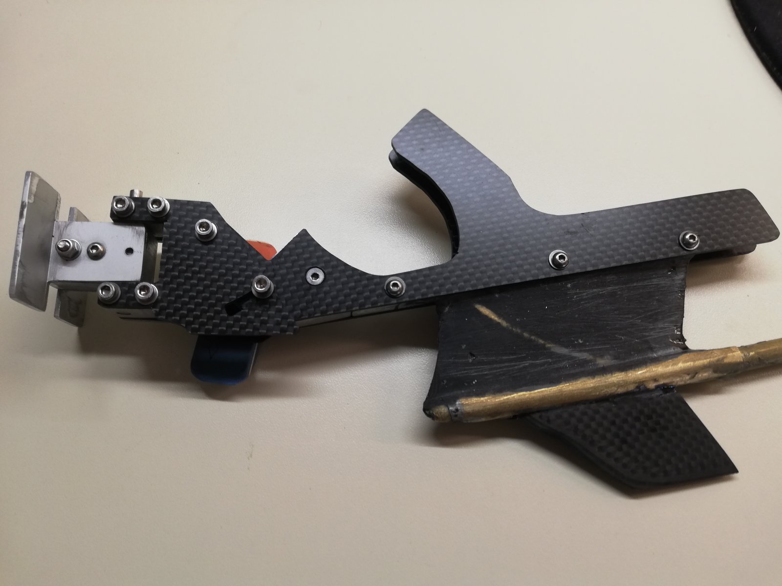

The hinge pin system has been re-engineered in a more concise way to reduce the overall length and weight. You can also see the angle of the flex shaft on the last photo. Now, regarding motors do you look at watts or amps all other equal? Because there are significant differences between companies.
