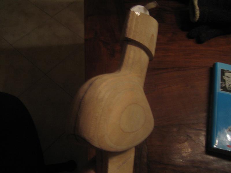

    Ju 87 Sirene
    [​IMG] [​IMG]

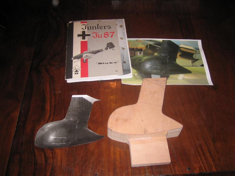

    Noord Holland
    houten Poot
    :)[​IMG]
