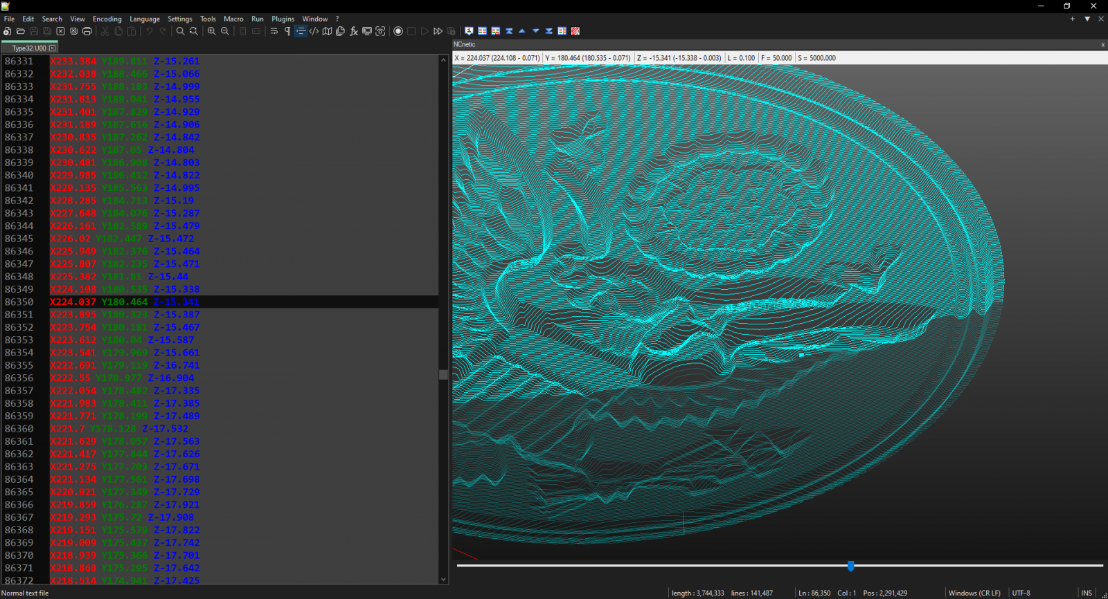

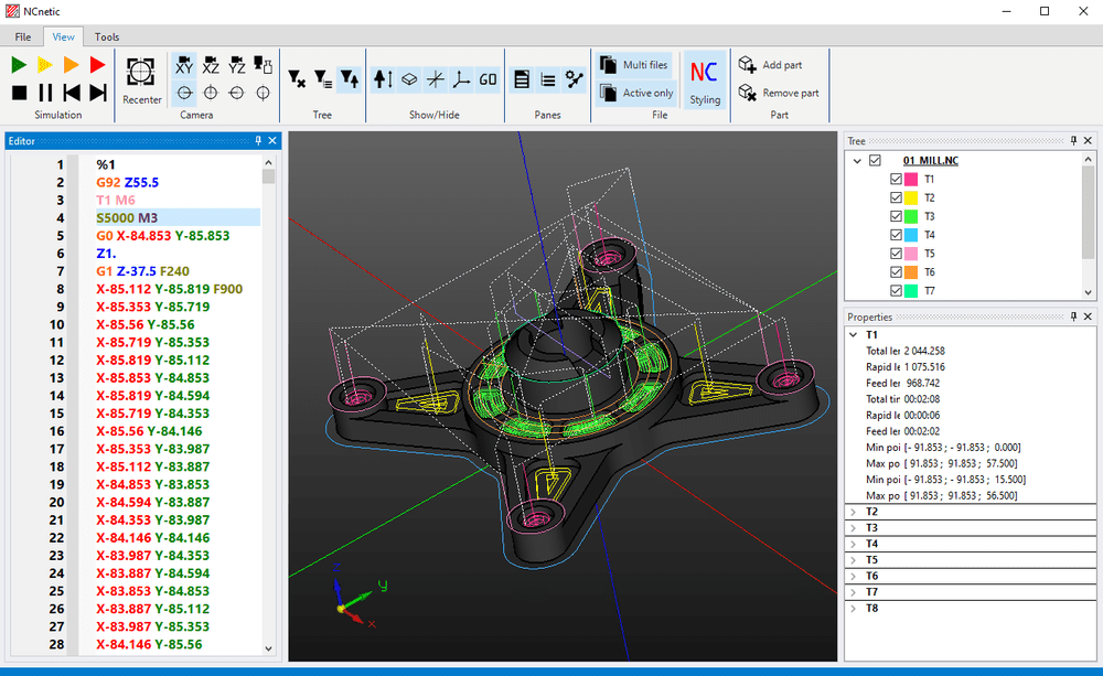

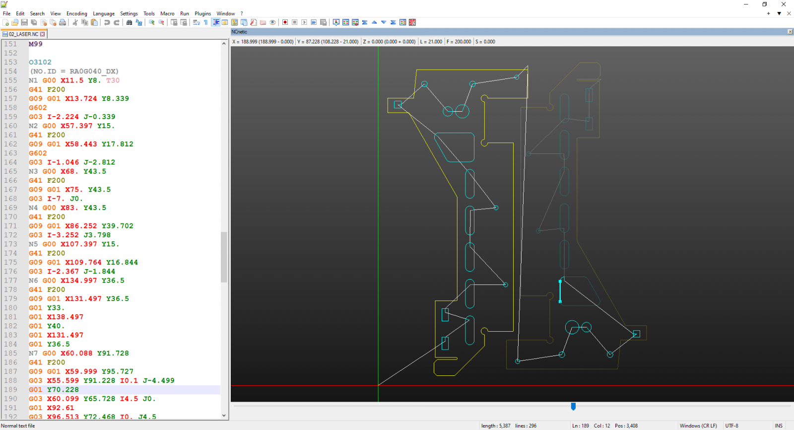

I'm here to share my friend's project.
He created a plugin to plot gcodes in Notepad++. Could you guys test it?
It is written in C# .NET so it will work exclusively on Windows.
This is the website: https://ncnetic.com/notepad-gcode-plugin
Thanks in advance for any feedback :), here are a few screenshots :
