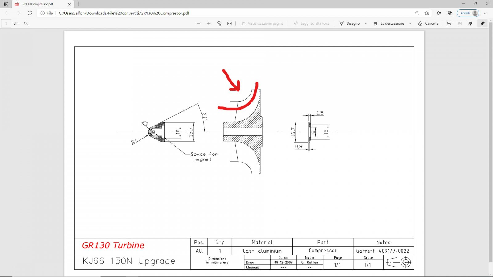

Hello Gerald,
I started to build a KJ66 from Artes, but I find later your GR130, as I have already made some parts, I'm building a KJ66 - GR130 hybrid.
I read your modification of the diffuser to change the angle from 14 to 13 degrees is my sketch is good?
893Z9UjKD8sz36VZ8

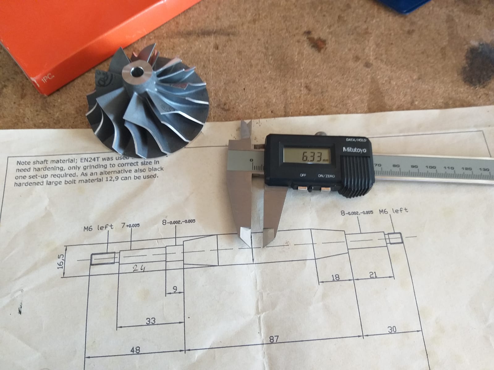

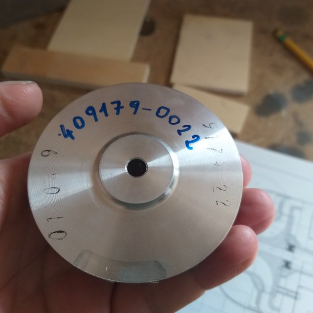

I have bought a T04E, https://fr.aliexpress.com/item/3295..._list.0.0.6c355e5bIsSIDk&gatewayAdapt=glo2fra, looks like the same you used
could you send me the profile file, I can't download it from your site?

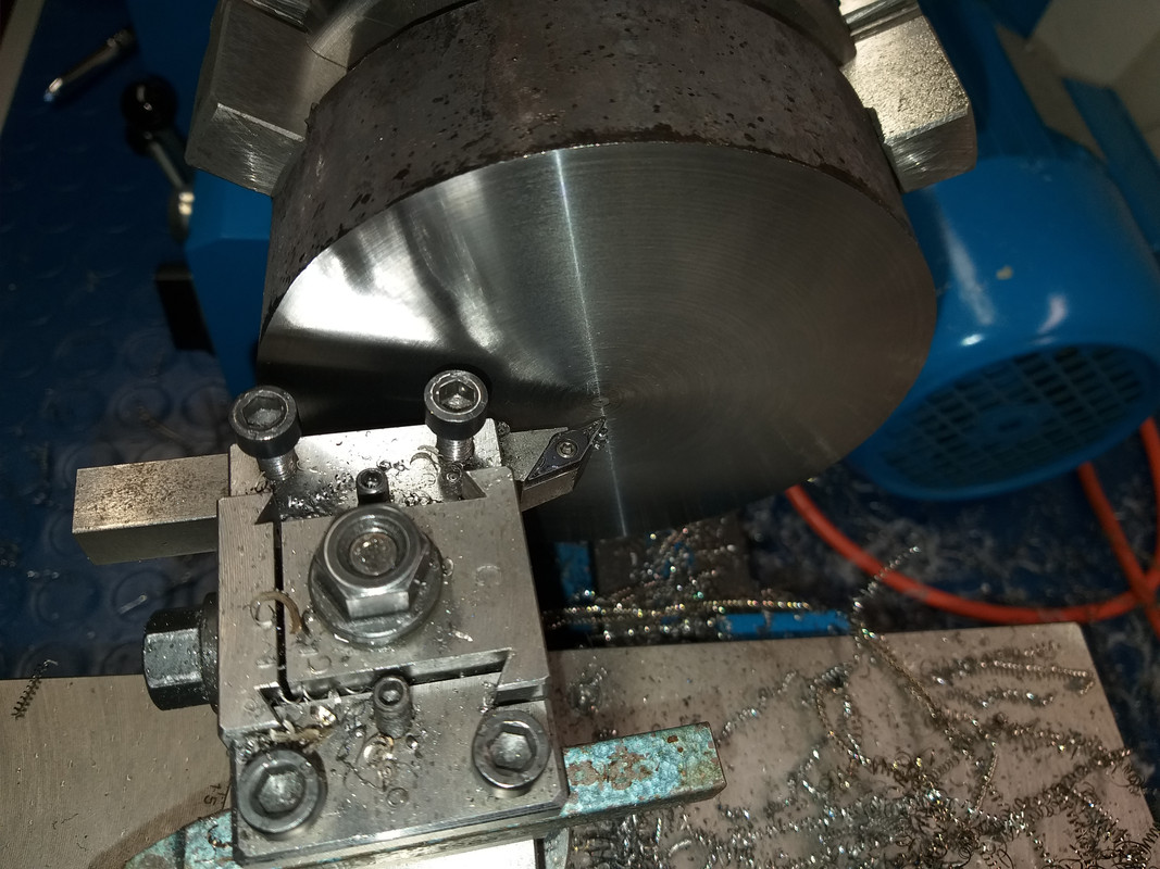

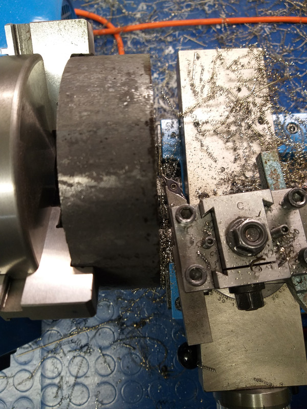

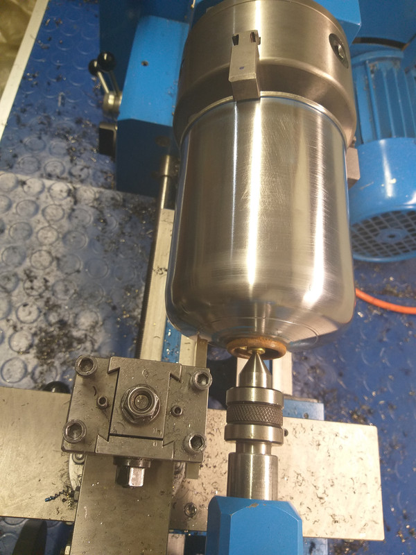

Here is the firsts parts
Z5xmfAaSEHjzmEqZ7
RqANaS6zvCzvnmQz8
Thanks for you help
Joachim

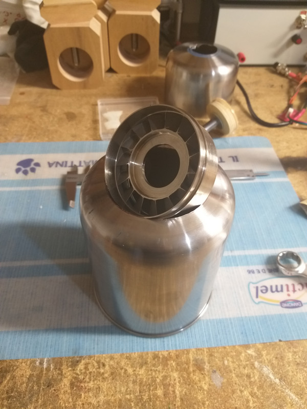

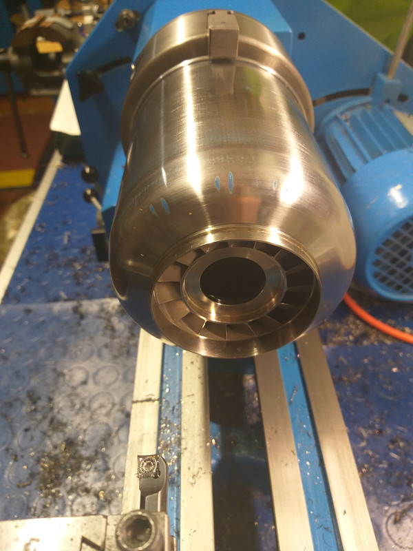

Hi Joachim
You should change the spring in the tunnel to the front. If i see it correct, then it‘s in the back now!
Regards Lukacs
