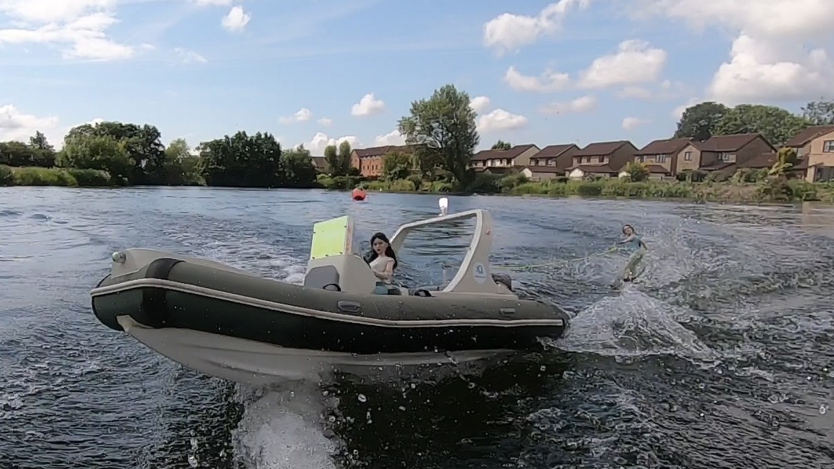

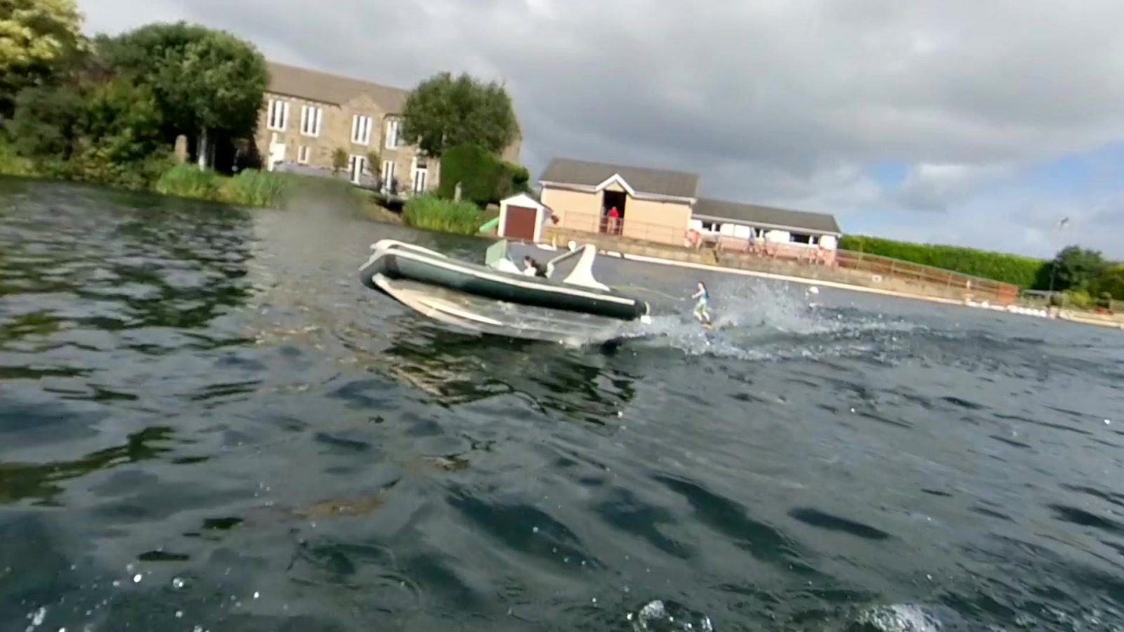

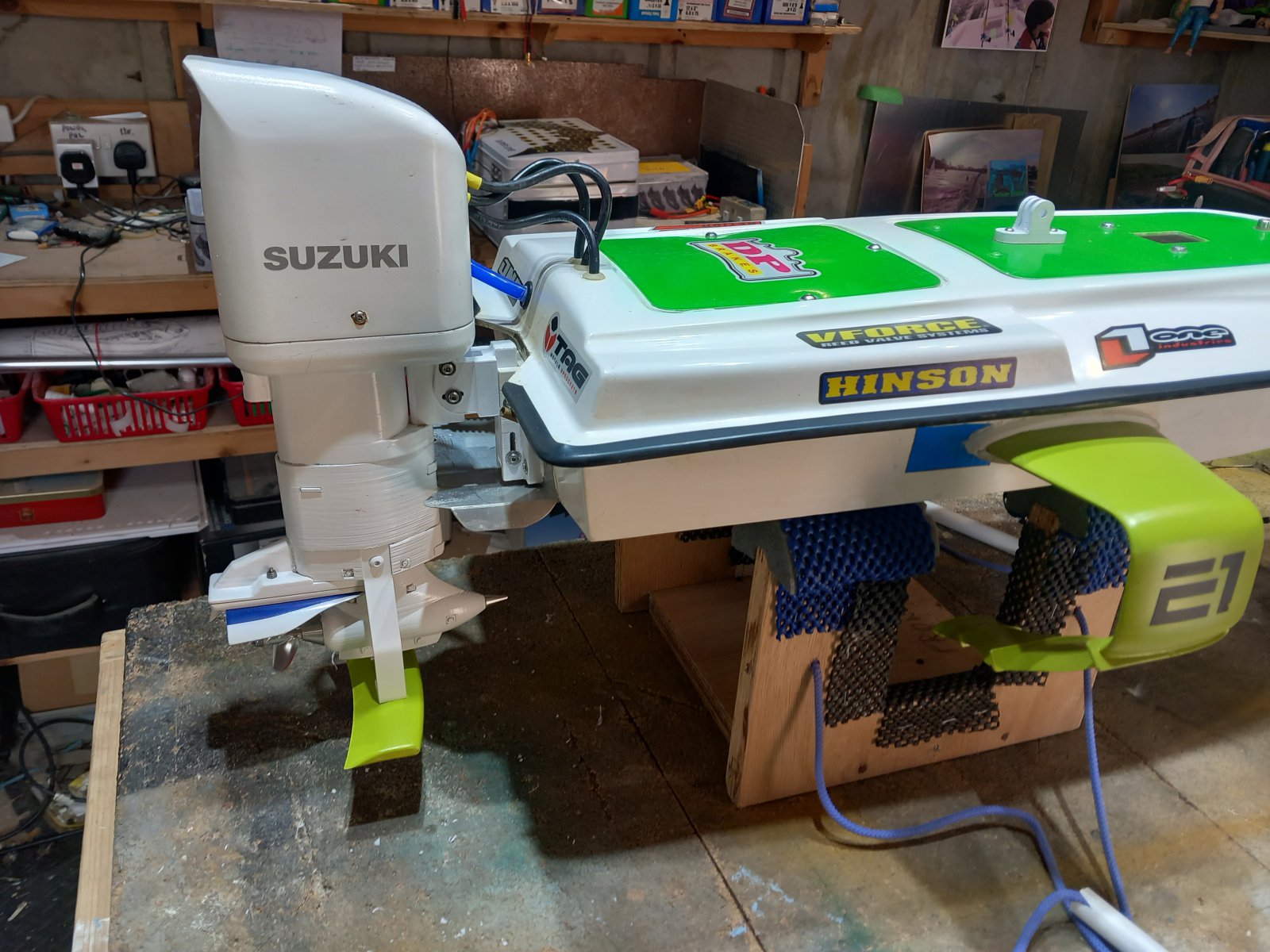

The new outboard is ready for its maiden run, however its our club open day today so not the best time to be testing. I might have a quick run just to see what happens. I am taking 5 boats all with outboard motors on them plus a spare jet outboard which I could sell, but I don't think that's very likely. I will be towing a wake boarder round with my Neptune rib for the crowds, weather is cold but no rain forecast. I have a new captain on the rib so I have been busy making a film for YouTube to be released soon, I got nearly 3000 views last month and 4 new subscribers. The F1 will be getting a run, and from the far end of the lake at speed she is quite a sight .

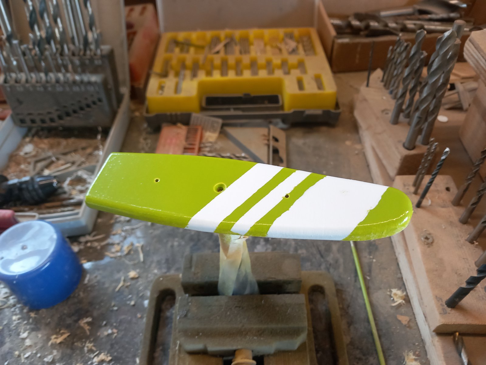

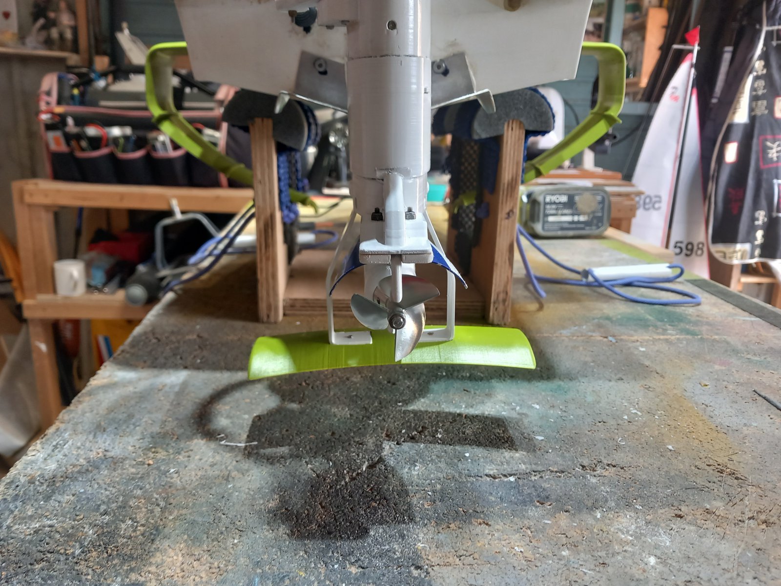

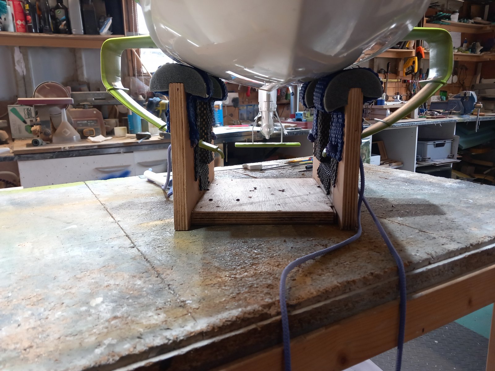

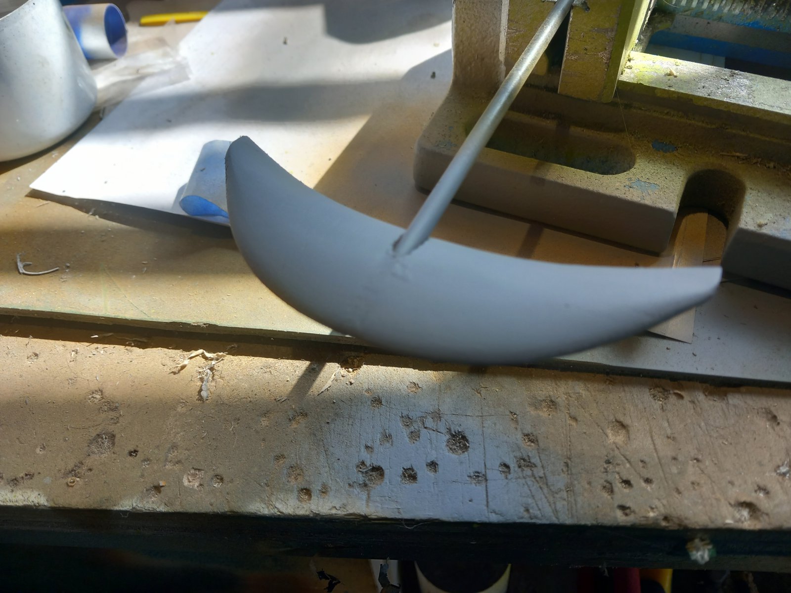

I started by trying to copy the full size e1 boats hence the foil well back, but now I have to find my own way through these rabbit holes I've created. I feel I got a bit closer to daylight yesterday. I know from months of development on my outboards that they have their limitations and I also need to keep things as simple as I can. So next I can print some more rear foils with some trim built in to get it running level. I did have a go without any rear foils and it actually did work reasonably well, but there was a lack of control and stability, so they providing that. Like throwing a dart without any fins it wouldn't have any directional stability.

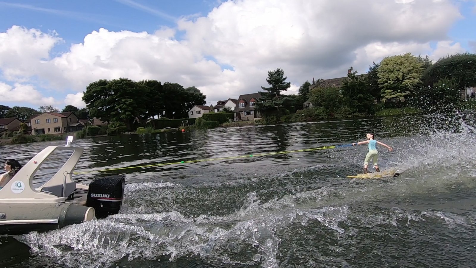

Having fun making the hydrofoil board. There is a lot of interest at the club and everyone has an opinion on whether it is possible.

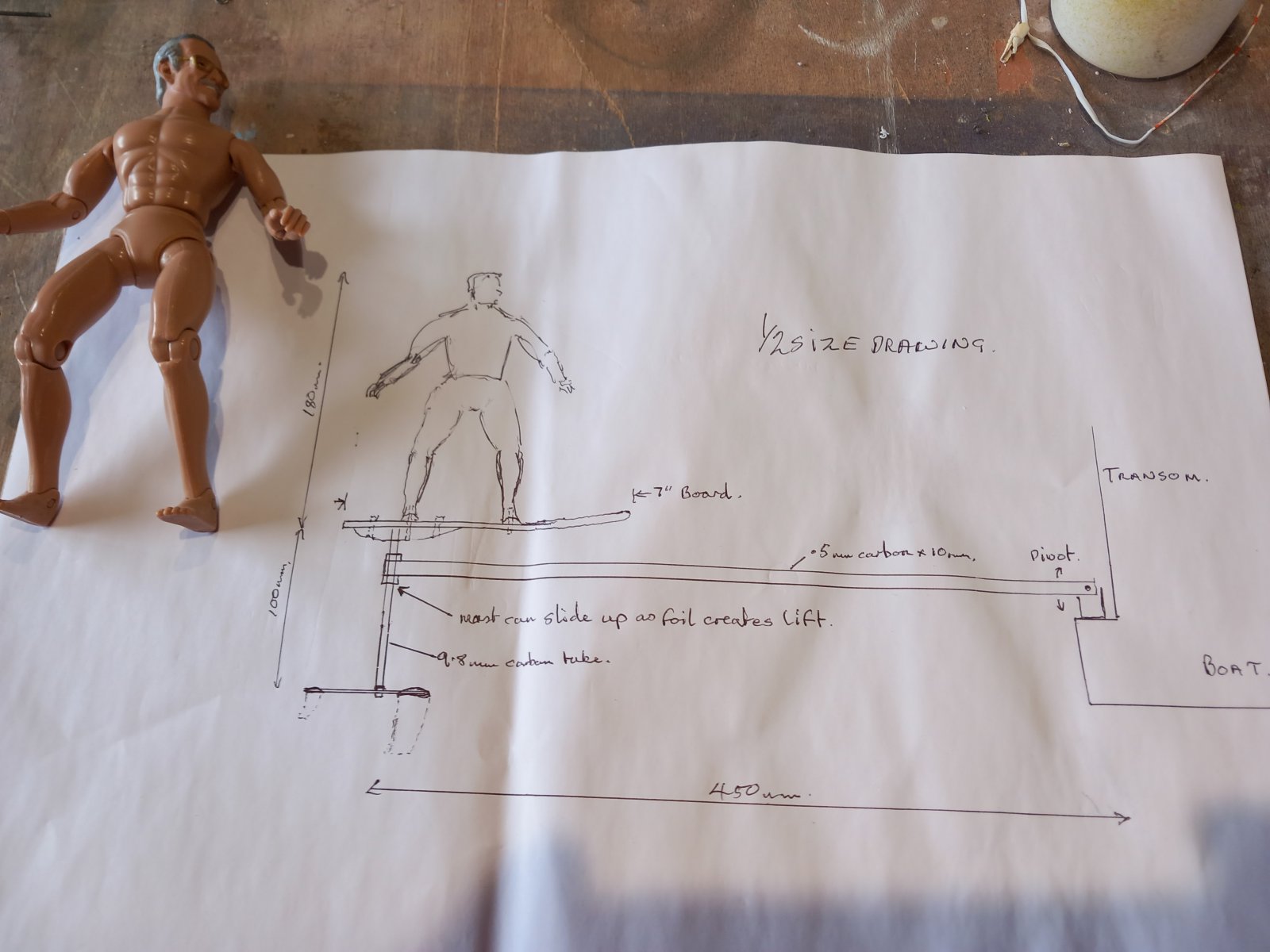

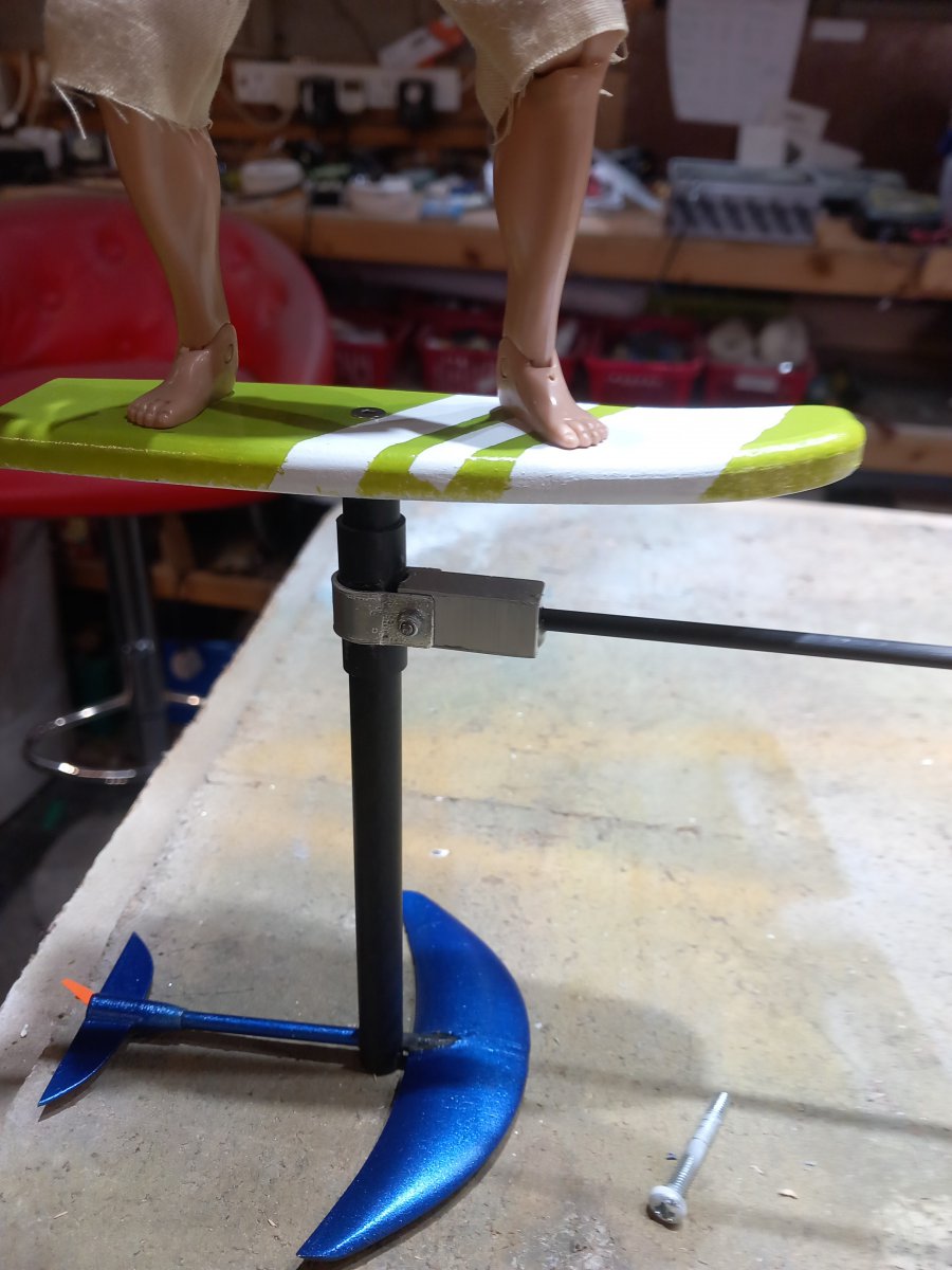

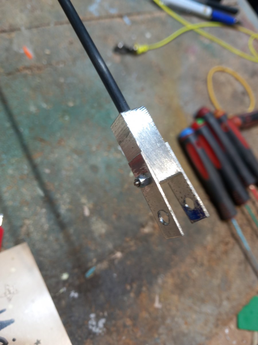

Another project is growing in my mind, wake surfing, behind a boat. See drawing in photo, so carbon fiber parts, with some printing as well. So the foil and board will be free to move up and down and spin on its axis. The boat outboard will be trimmed to create a good wake, and speed kept down. As it sets off a small tail fin on the foil will keep the board pointing forward. Once moving the board rises out the water by 2 to 4 inches, the tow stick then just becomes a support as the board is propelled forward by the wake. The height will vary by the speed of the boat creating bigger wake.

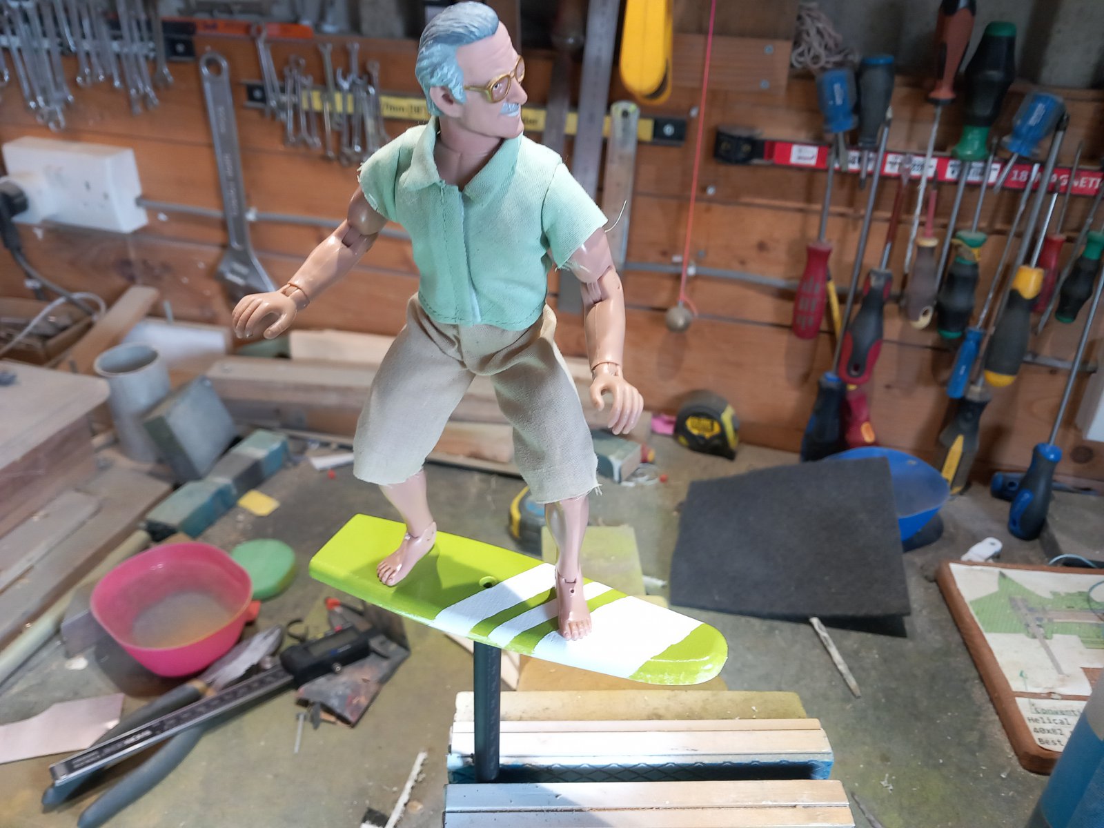

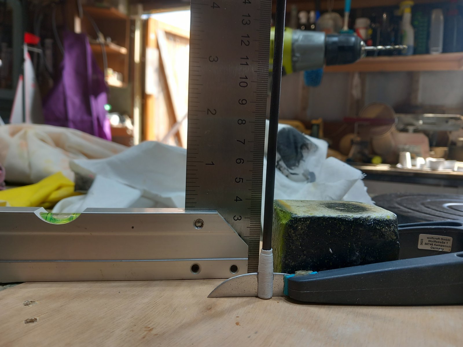

I superglued some of his joints to keep the stance , then drilled a hole where it hurts to allow water to drain out. I need to decide how long to make the tubes, it would be better too long so I can cut back, then I don't have to make new foils again.

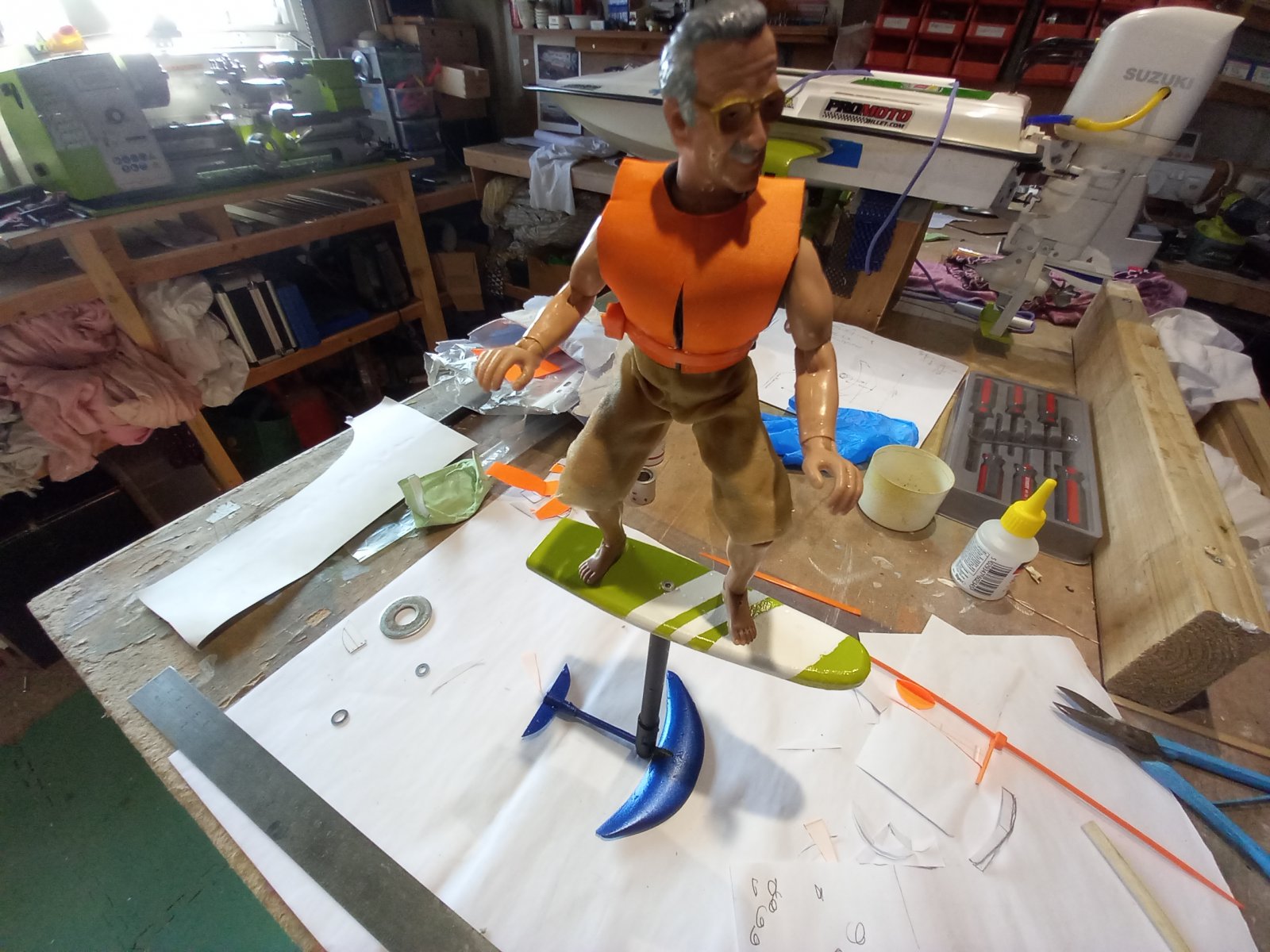

After a floatation test in the lake, I decided he needed a life jacket, now he floats better. Also he will be easier to spot in the lake if he gets detached from the boat. It could happen, if something broke or glue gave way.

Wonder how you are going to get this one going!
The front wing is lifting, the rear is lifting in the opposite direction.
The weight of the person - hence the weird position of the rider too much for your liking to the front - compensates, creating a equilibrium of lift and gravity.
There are foils who have both lifting surfaces, but have not seen them with neutral tails like an airplane.

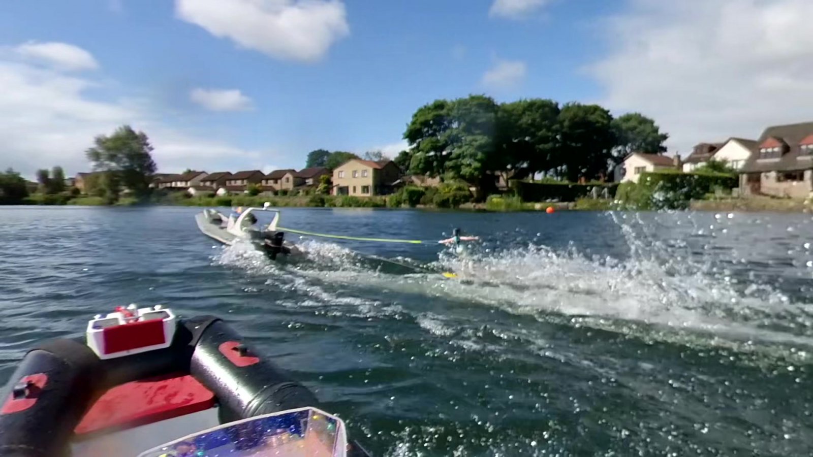

That's a shame, hope it's on later. New towing idea for the wake foiler.
