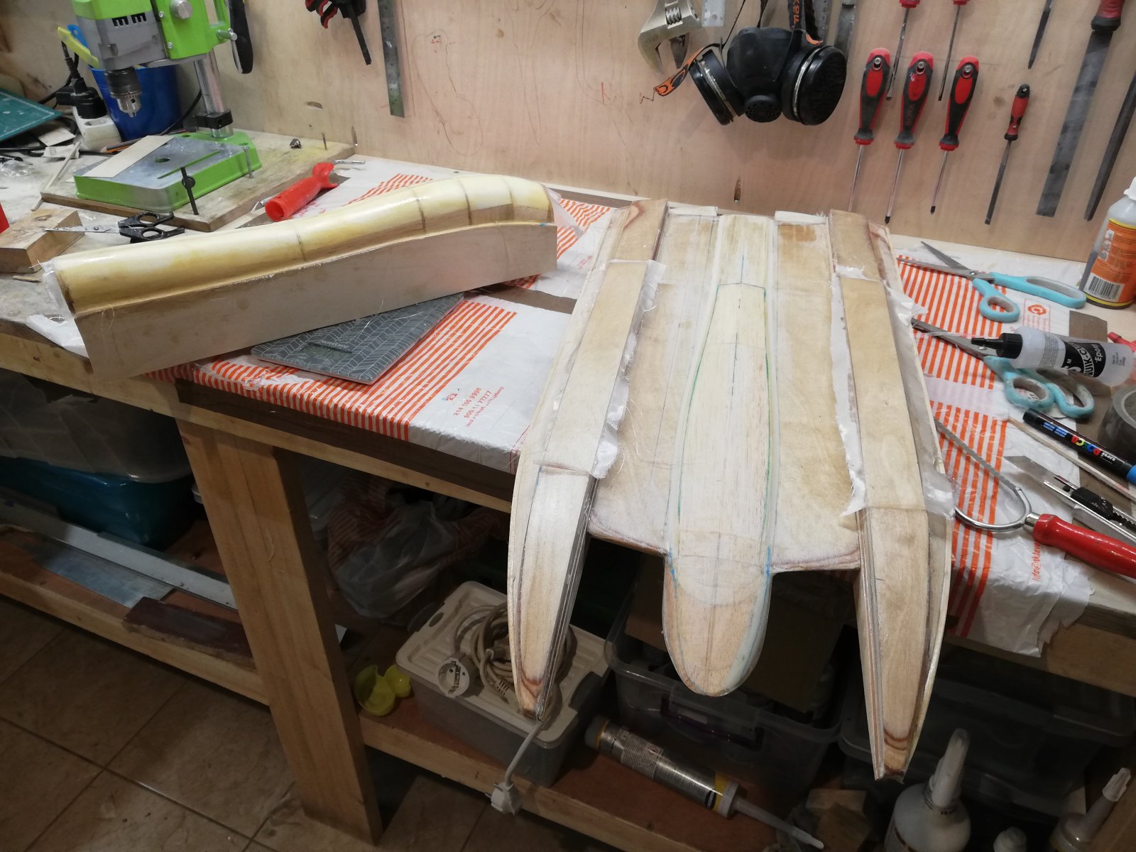

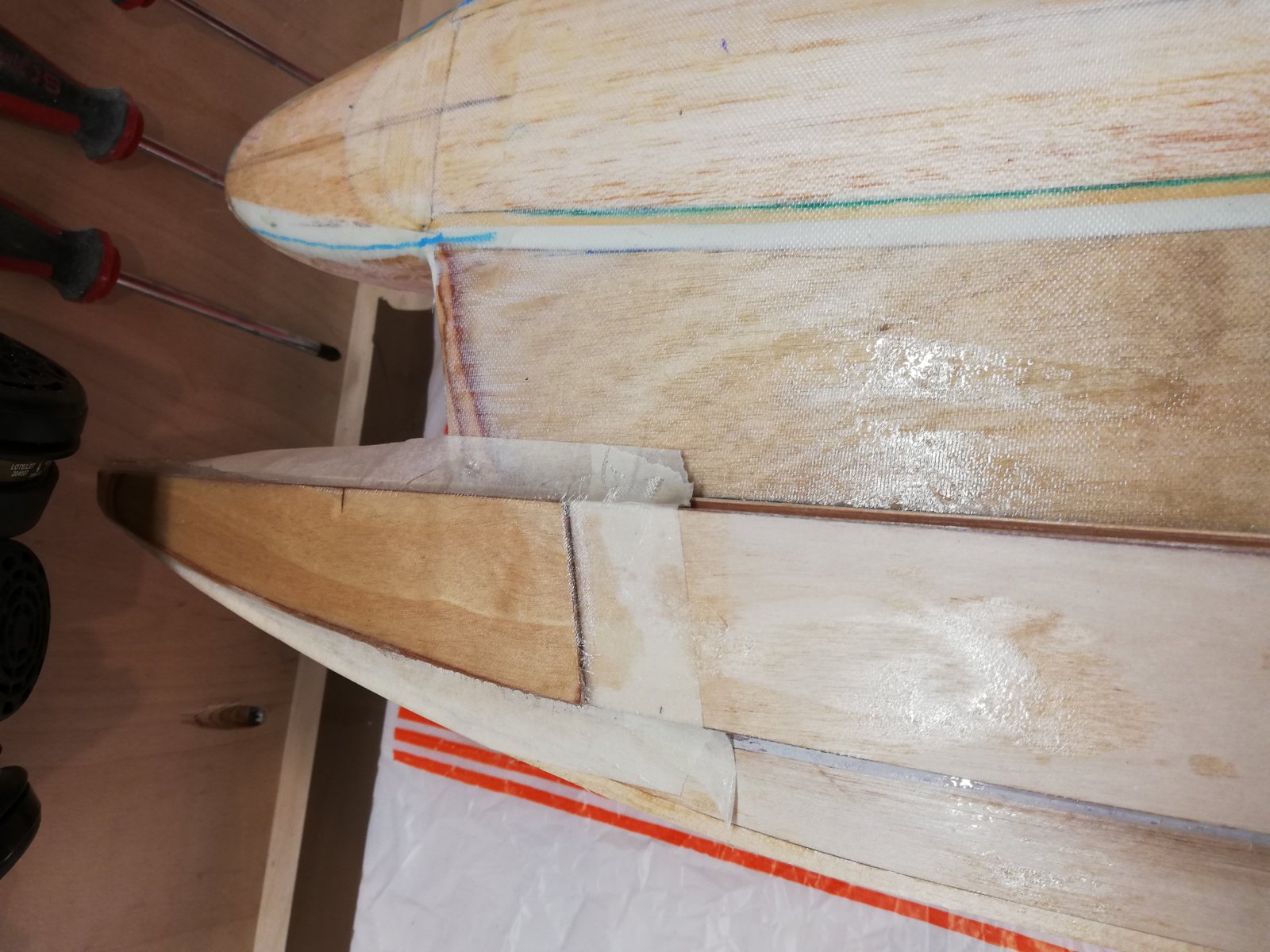

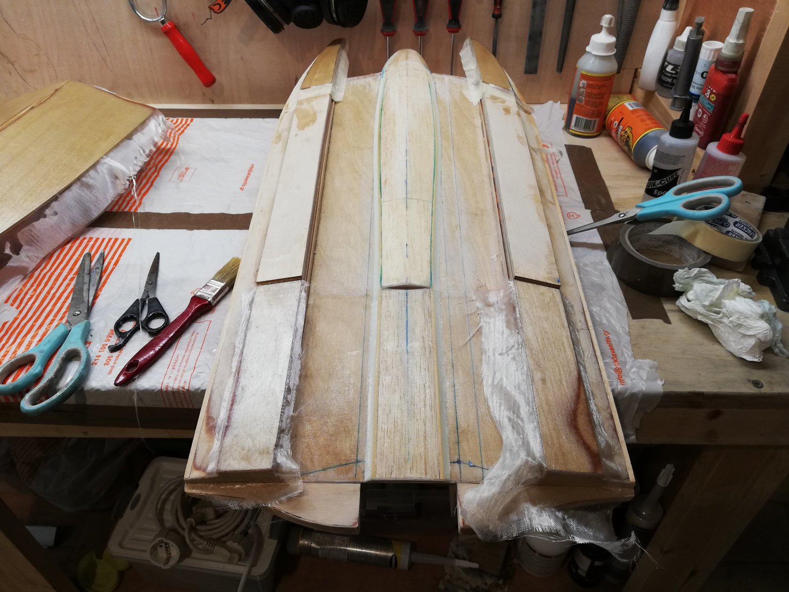

    Looks like a season 2022 F1 car looking at the bottom. All those channels, will they create a downforce?
    Again a model you made, which looks so fast standing still!

    Thank you Jan!:) I ve put a lot of effort on this hull and I am happy you can see it.

    Oh thank you for your wishes in Greek Michael and your nice words :thumbsup:!
    They improve the directionality and improve turning quality for sure. I ve tried to copy the bottom of the real boats including the air steps.

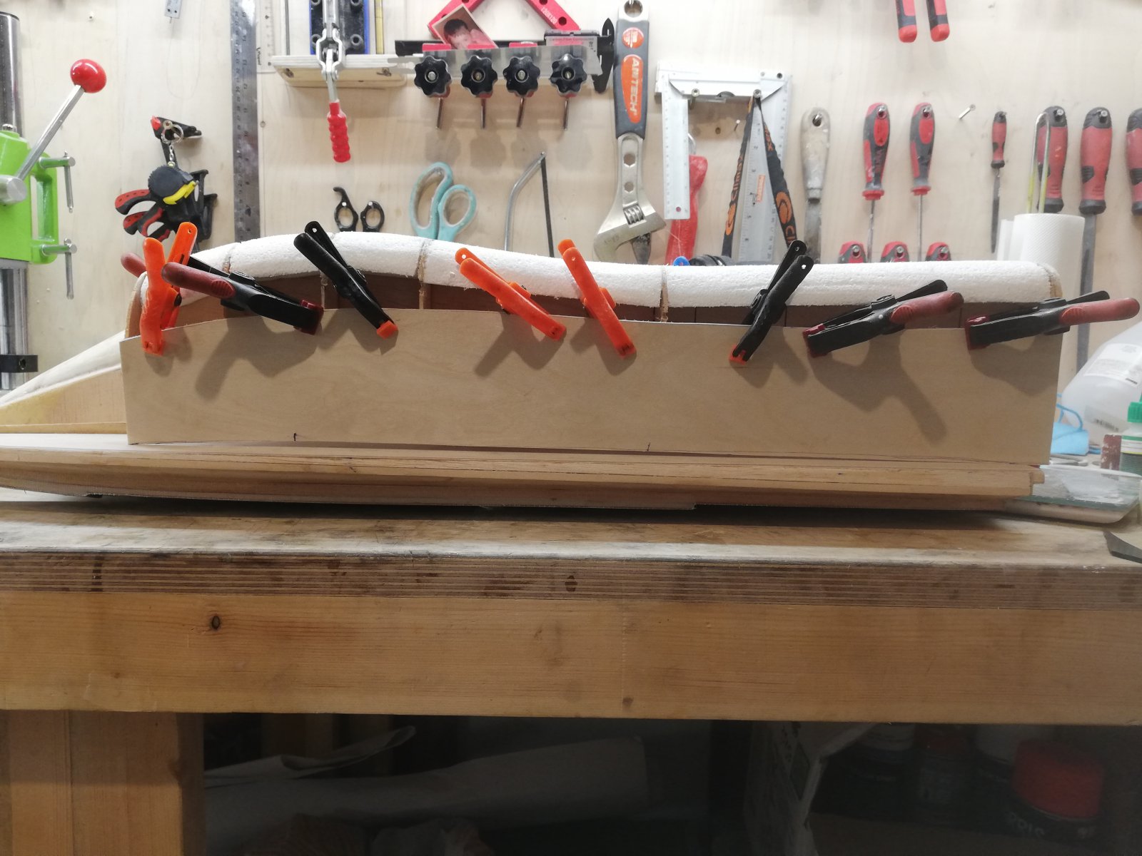

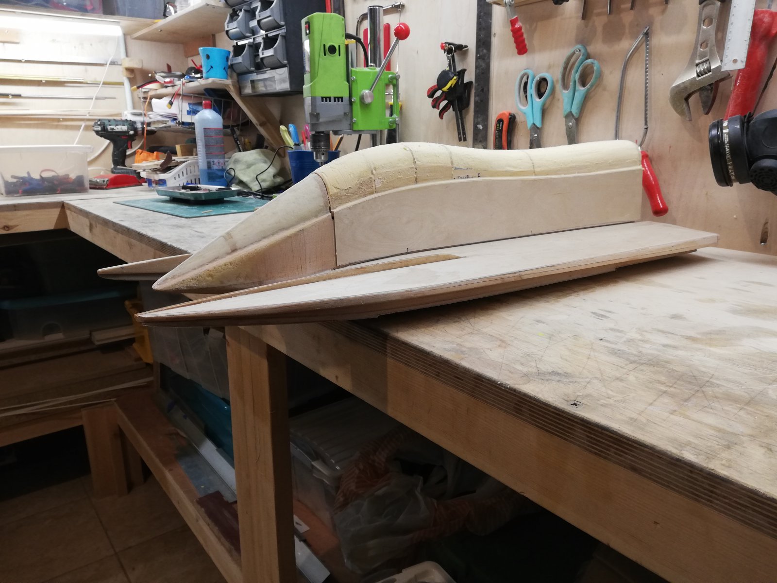

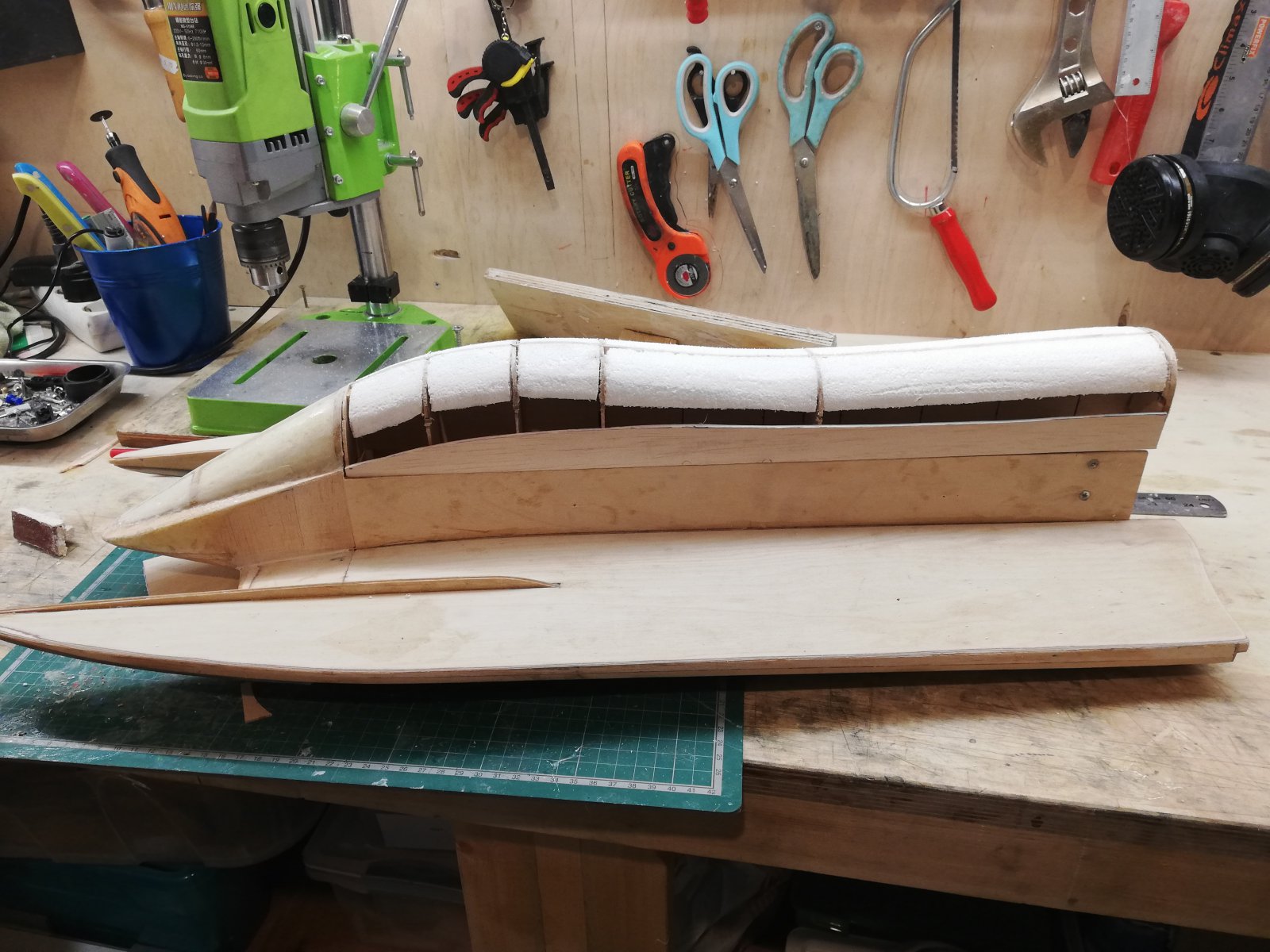

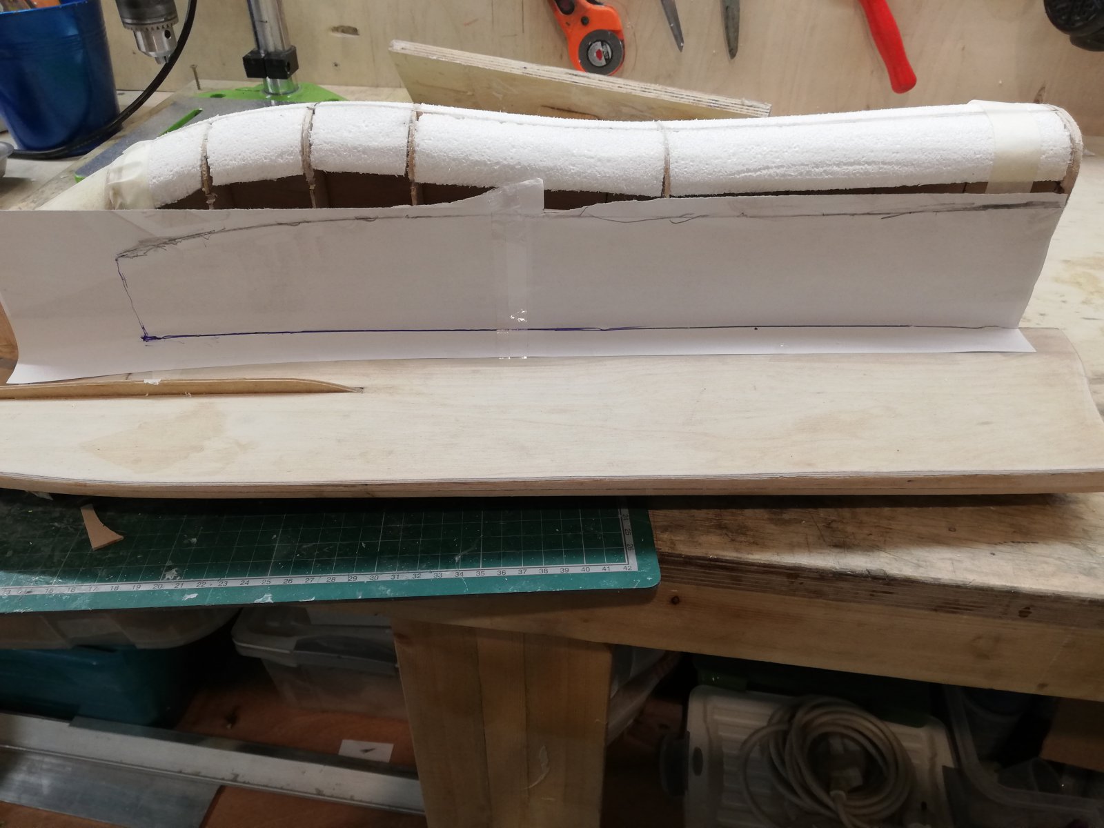

    I started building the cowl. Here is my progress :

    Great work! Will that be the mold, or is it the actual cowl already?
    And I'm curious how you are going to close the sides.

    This is the actual cowl Jan. I am going to use 1mm ply for the rest of the cowl and then fiberglassing.

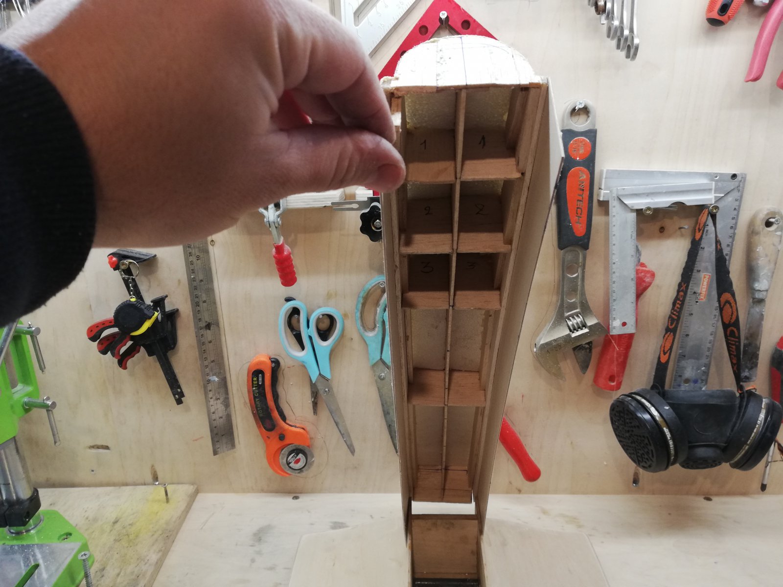

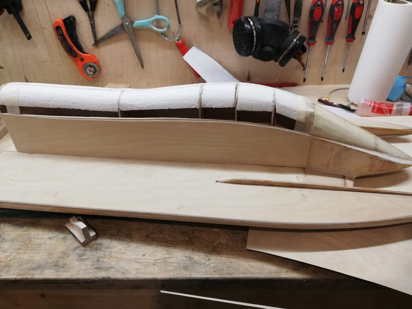

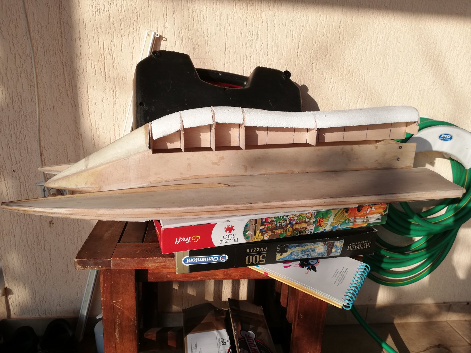

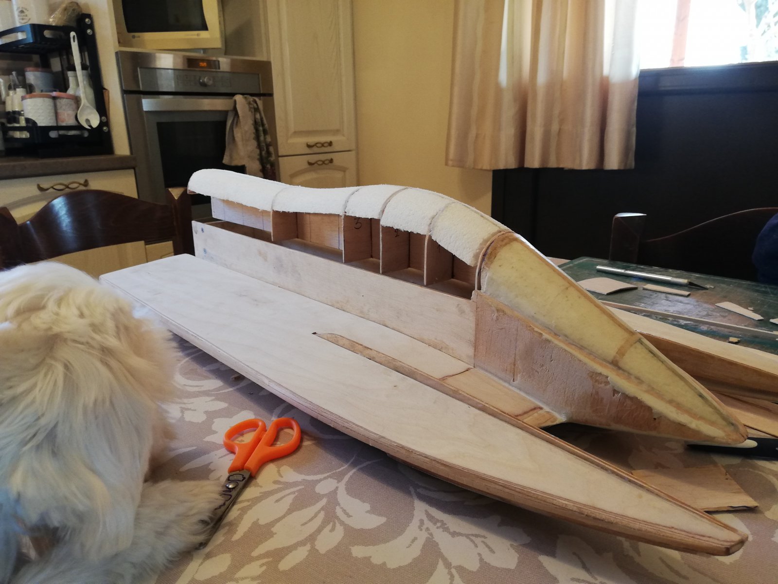

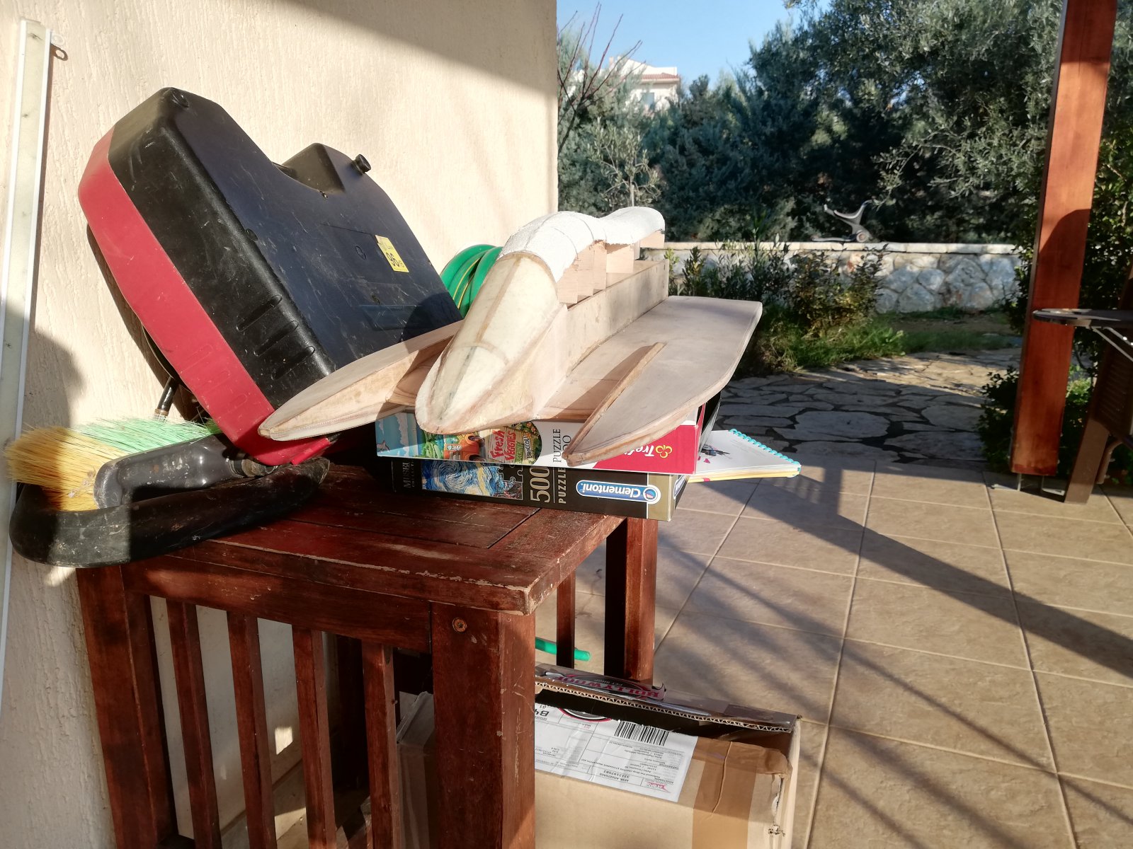

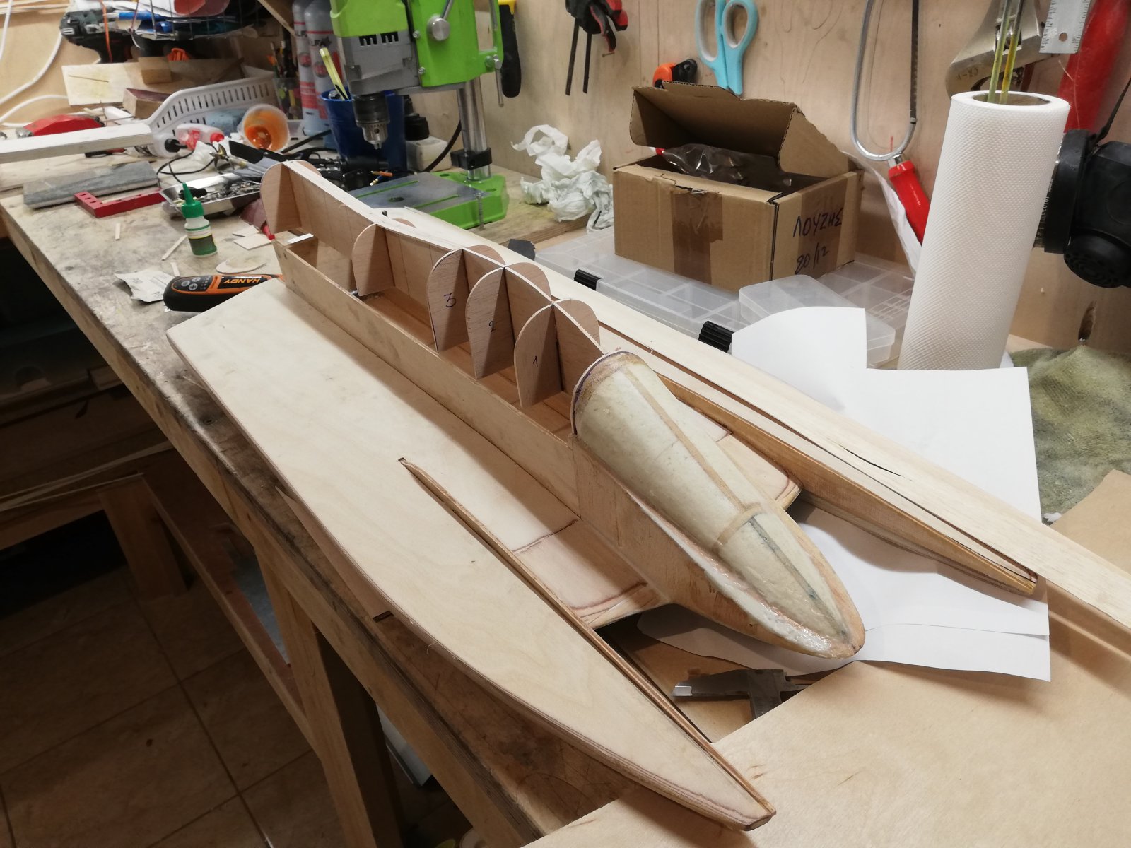

    The building strategy of the cowl went well. The yellow material over the foam is a special putty for foam and balsa. It is easily sanded but it is not strong. Next step sanding and fiberglassing.

    Awesome! The many pictures show your build steps nicely

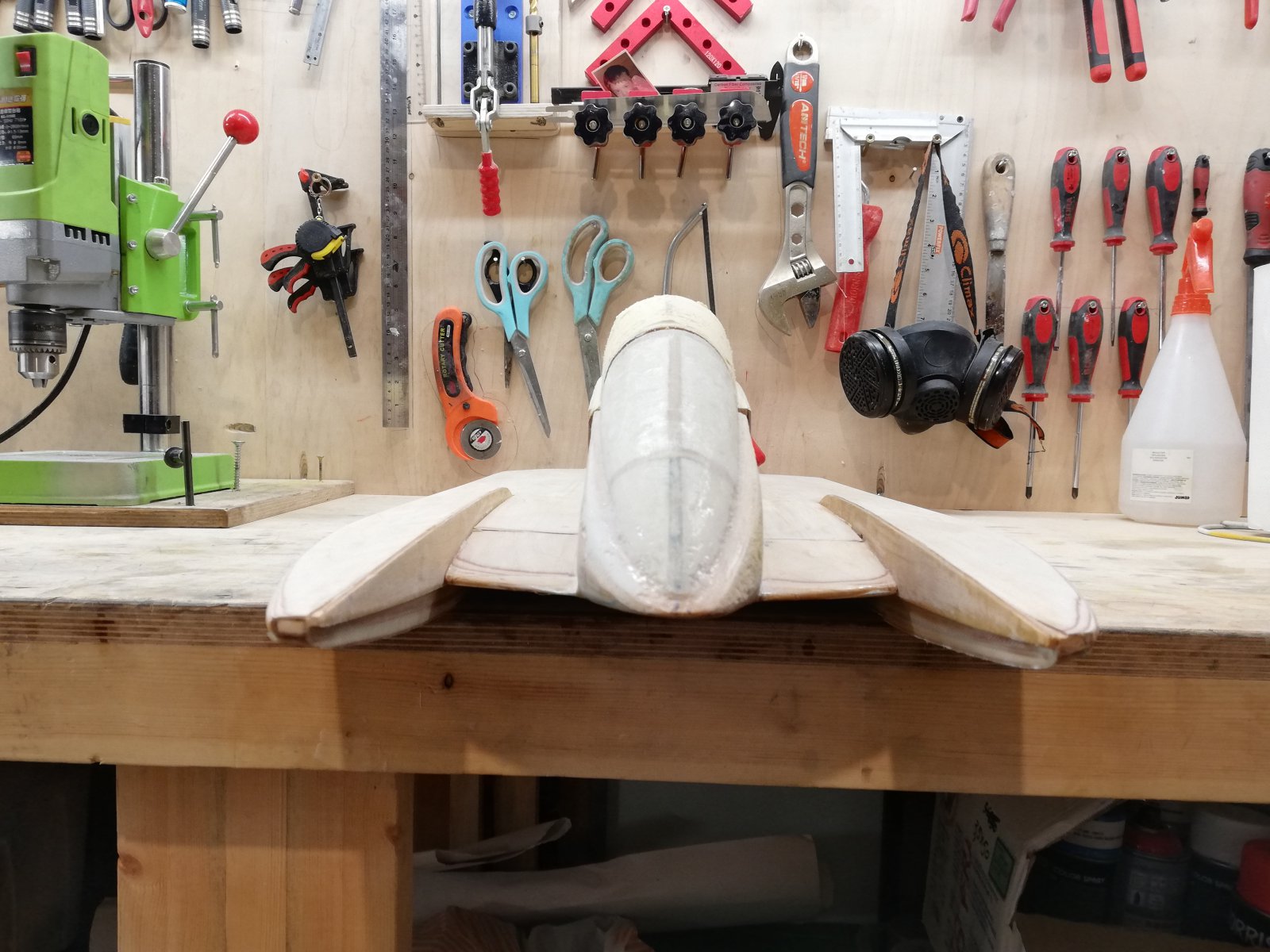

    By the way Jan I think that the hull come out a little overweight. It is 1,300 grams already with the cowl but no fiberglassing. I would expect something like 1,100 grams at this stage for a 73 cm hull.

  14. Dirk Jan
    Dirk Jan Forum veteraan
    Lid geworden:
    2 apr 2003
    Berichten:
    3.599
    Locatie:
    Veenendaal
    It could be a little lighter, but I wouldn't worry too much. The cowl- and fixed nose design add some weight, but it seems you got the power to push this boat forward with good speed .

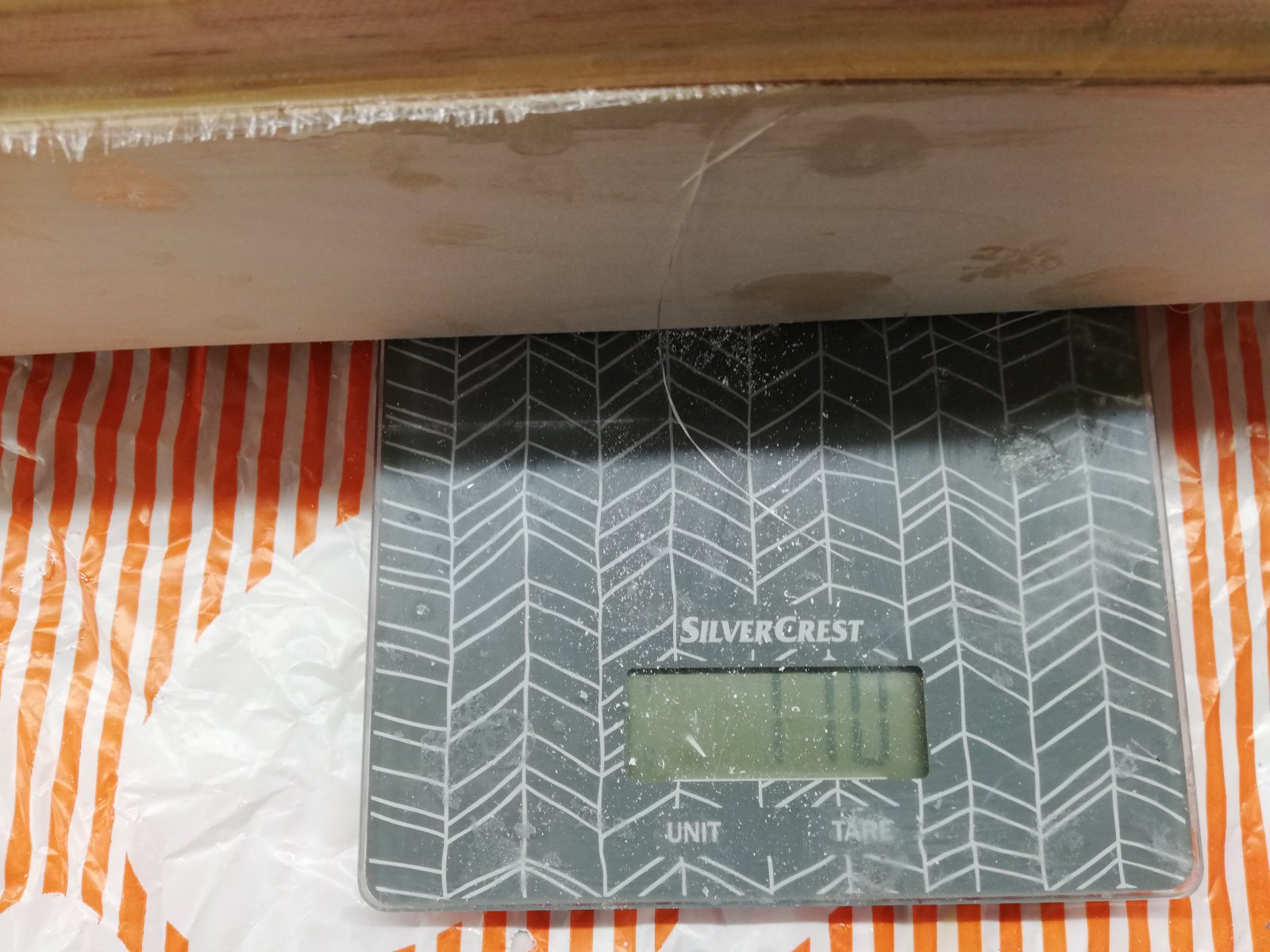

    I came at this weight in the rough construction

    Wow I guess I am too heavy... almost 450 grams heavier. Is this your current build and what is the size of the boat?

    the boat is 750mm
    [​IMG]
    I have already kept the subject as thin as possible
    and for the hood I use 3x 25g glass
    gr Jan

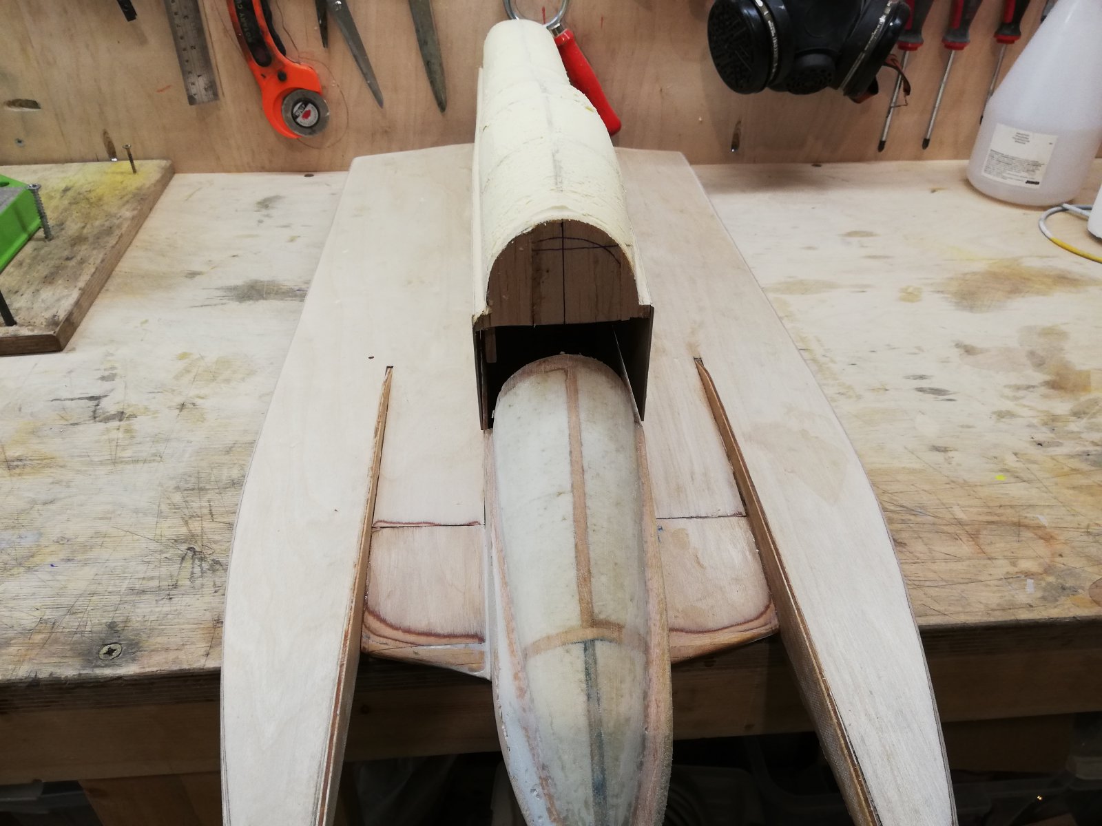

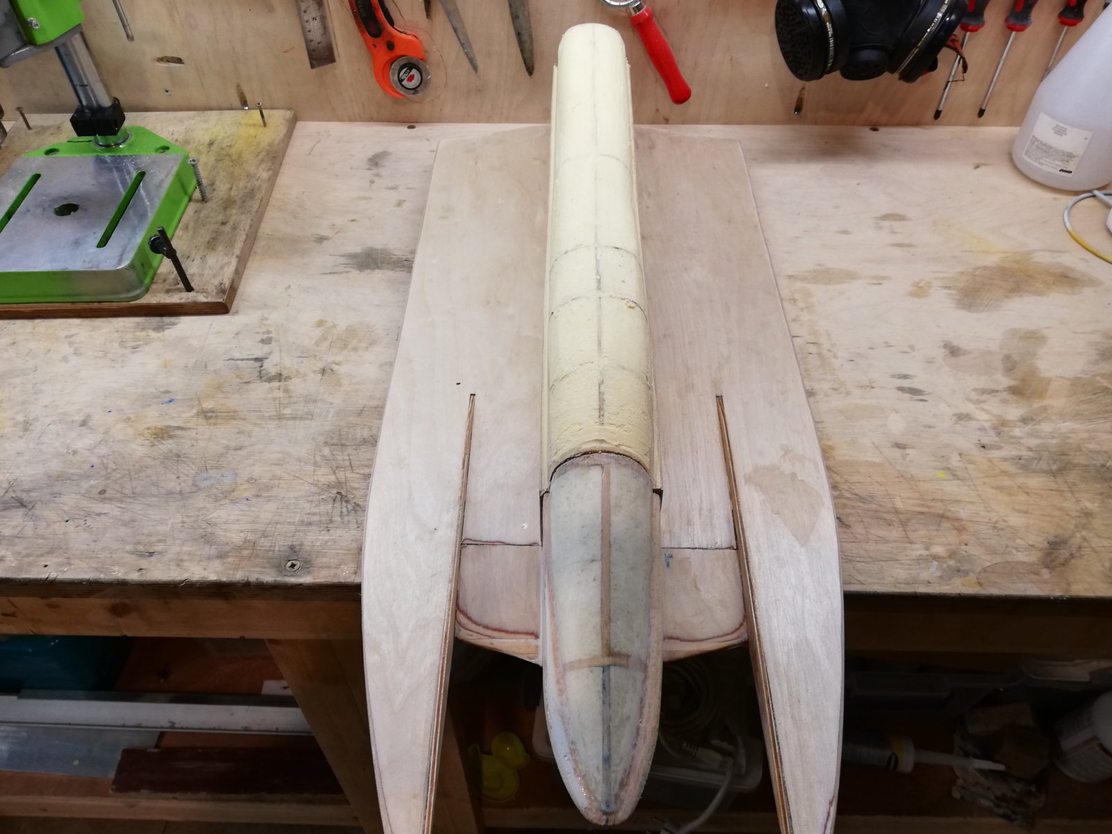

    Fortunately I had forgotten that I laminated the bottom of the hull and the sides of the sponsors. So I am gonna save some grams !
    I laminated the foam part of the cowl with a 100gr/m2 fiberglass and the bottom of the the running pads with a 50 gr /m2 fiber. I had previously laminated the sides of the sponsors with a 100gr fiber.
    The cowl is 170 gr already and will probably reach 200 - 220 grams painted. Maybe another layer of fiberglass is required. I will remove the inner structure to reduce weight later on. At least I love its shape...
