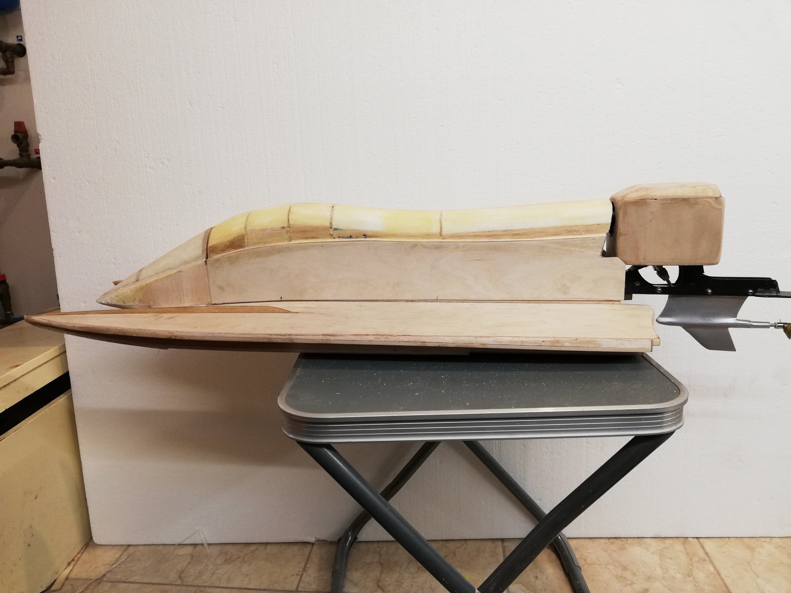

    Oh thank you for your encouraging words. Jan! :thumbsup:
    The starting point will be a 5s and 40mm 1.4 propeller and then we see.

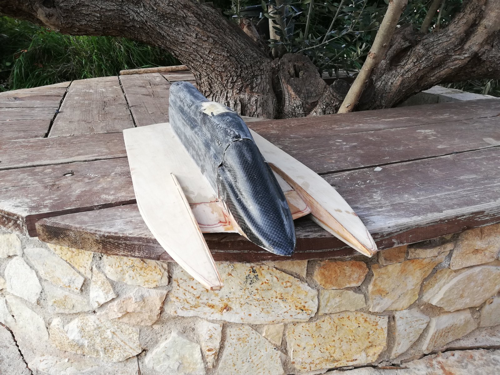

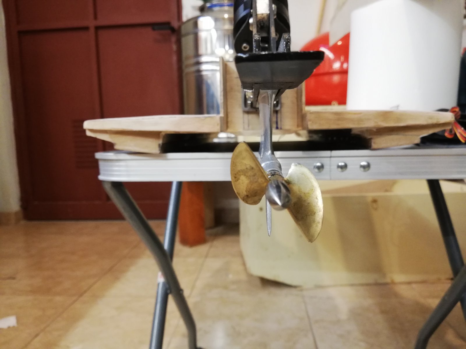

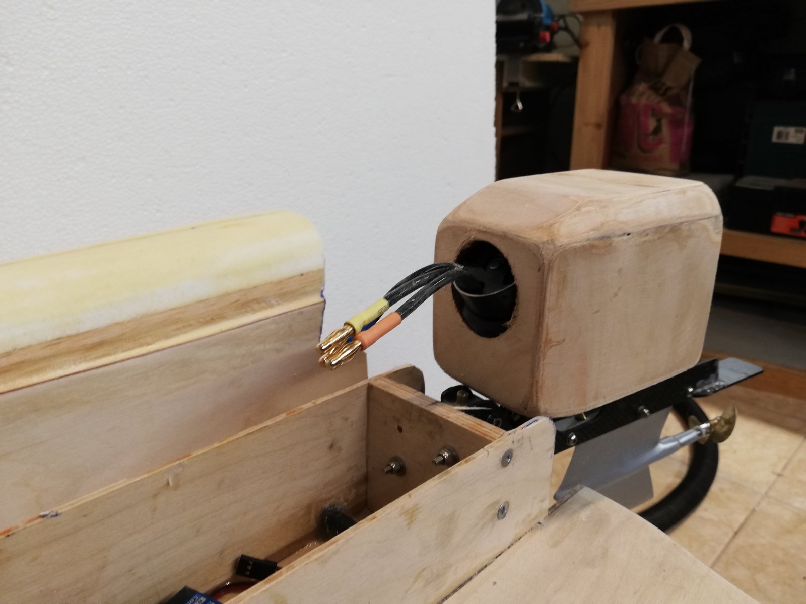

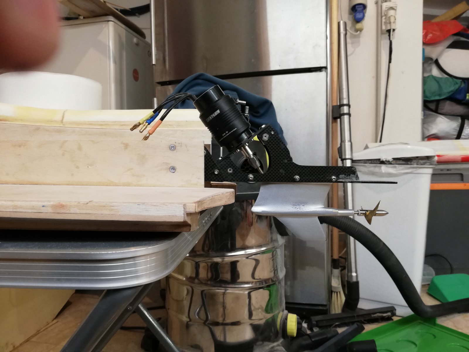

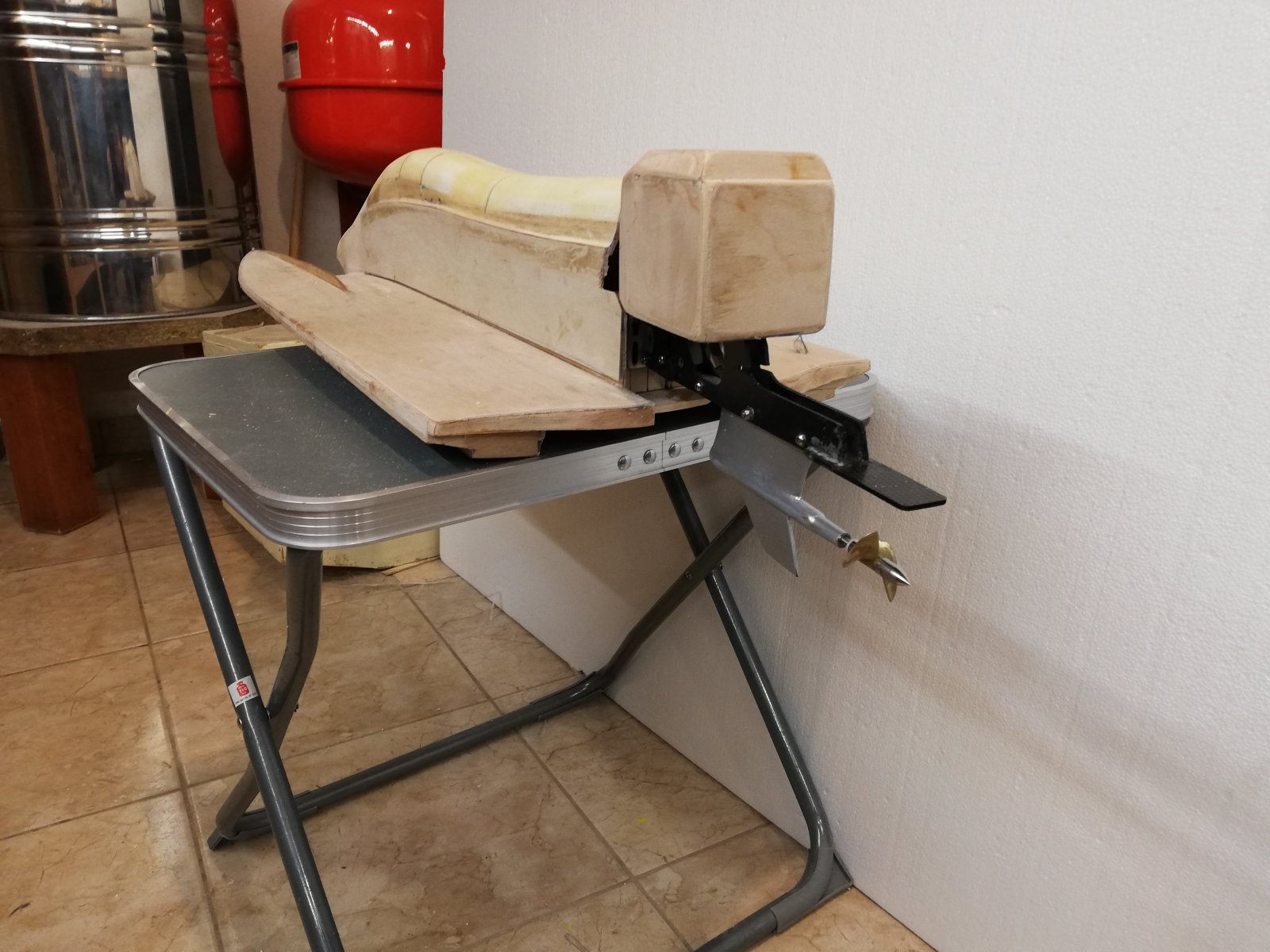

    Finally the outboard with its cover is on the hull...
    Tamiya1970, cadcam en Dirk Jan vinden dit leuk.

    It looks awesome Great design and build. I'm very curious to see how she runs.
    Dim L vindt dit leuk.

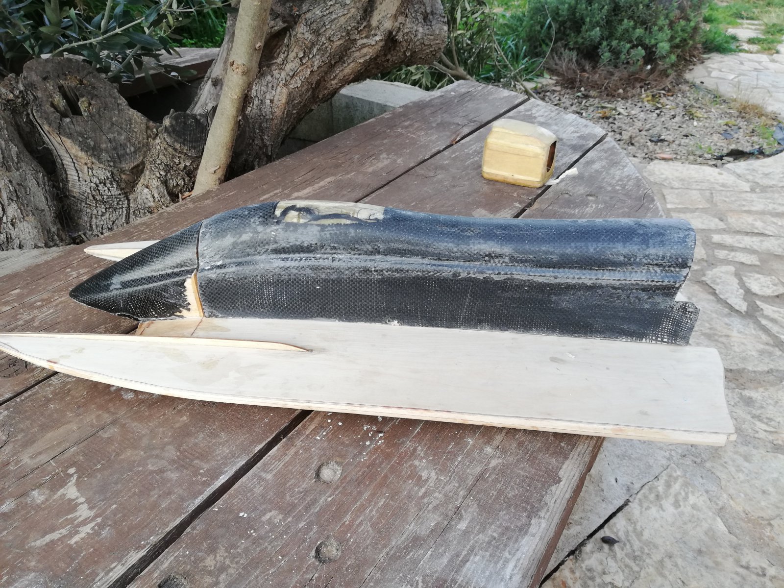

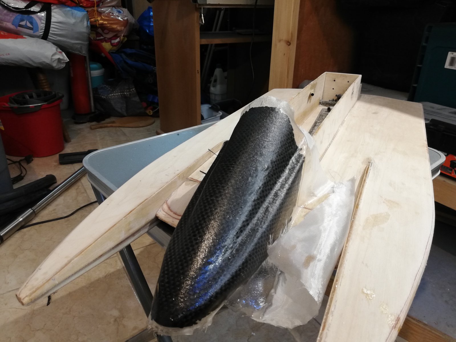

    Goodmorning rc friends!

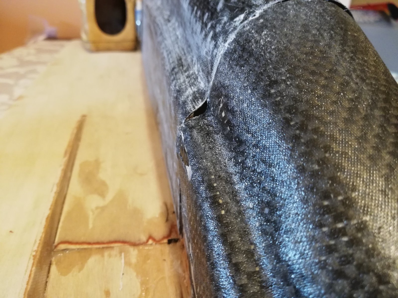

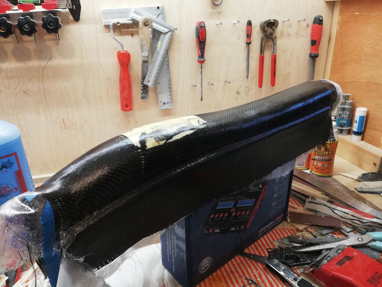

    I ended up using 160gr/m2 cf and
    50 gr fiberglass to strengthen the cowl and the nose of the hull.
    I feel that the hull is much safer now.

    Nice job! It looks like you left a glass surface at the top of the cowl for rx and gps signal .
    Did you decide the paint scheme yet?
    Tamiya1970 en Dim L vinden dit leuk.

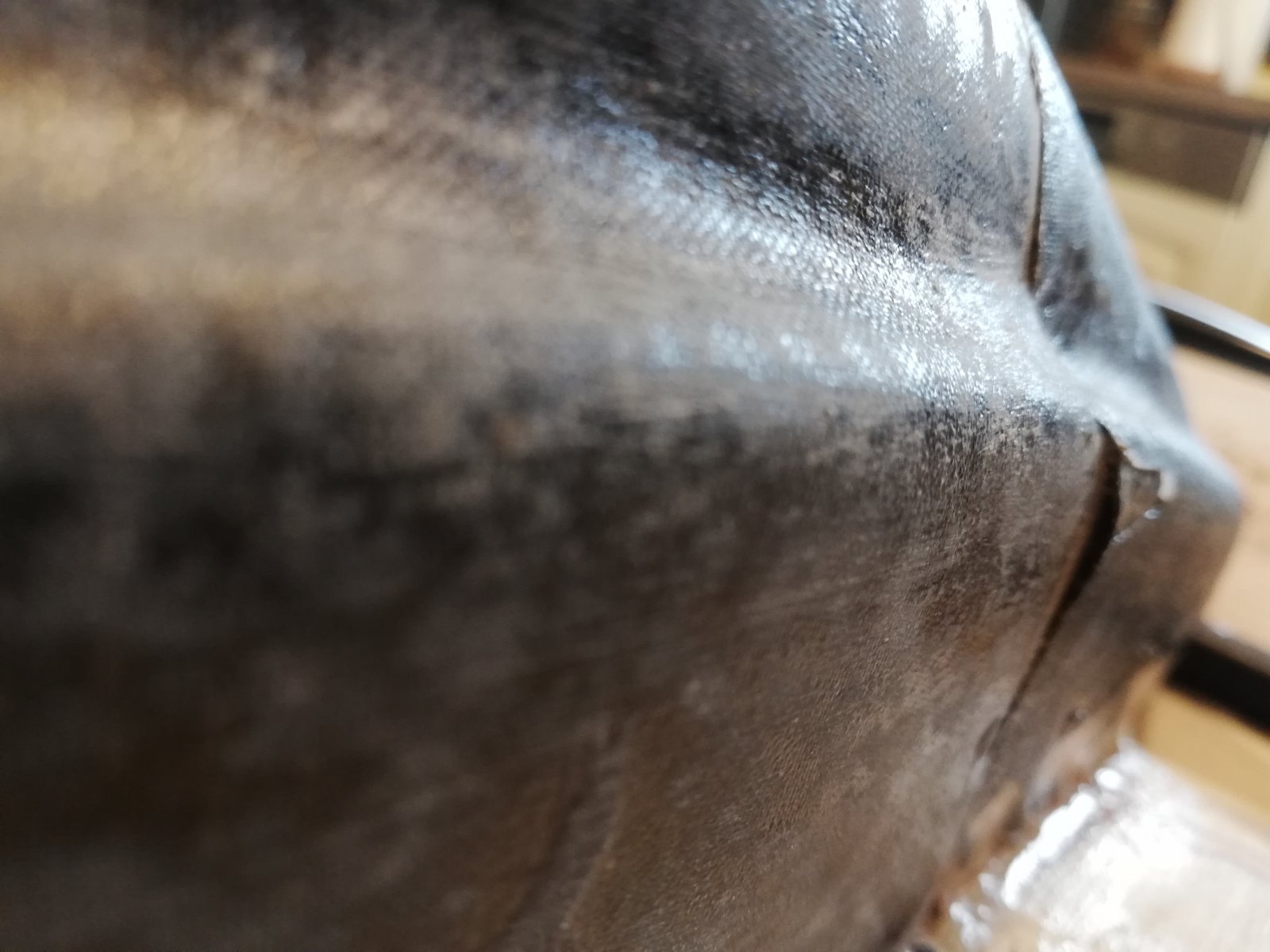

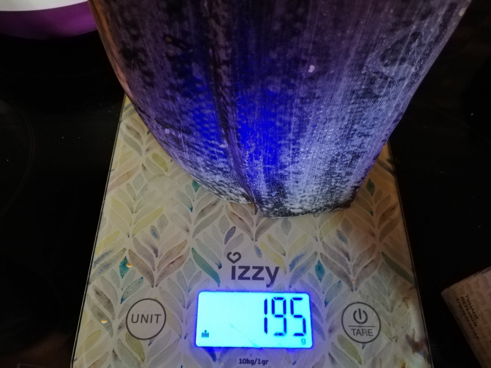

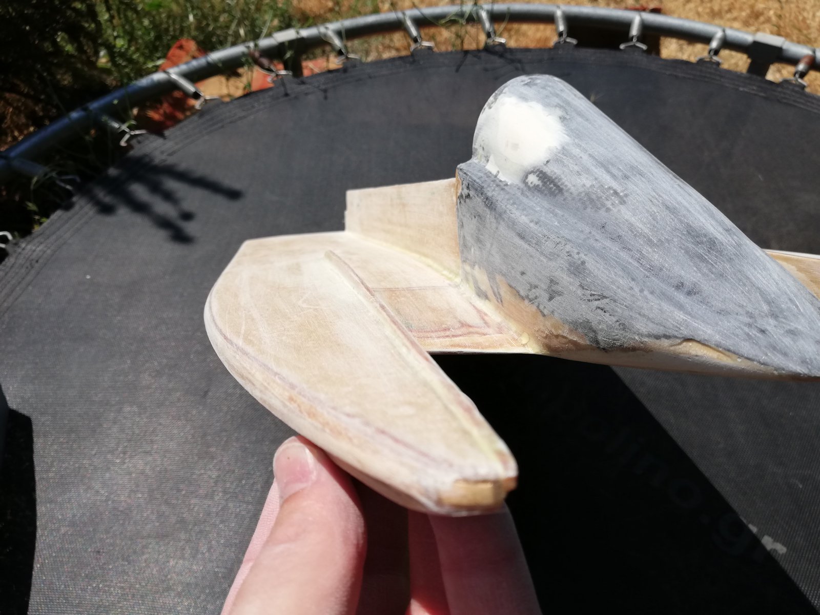

    I stripped off the inner construction of the cowl and I enhanced it with 100 gr/m2 fiberglass. The part without carbon fiber was further enhanced with 4 pieces of thick fiberglass tape. The cowl weighs 195 gr but it is quite strong.
    Overall, I am very happy with the the result in spite of some inevitable imperfections that must be improved.
    And the imperfections...

    It looks great, I like the side flanges on the nose cone and cowl . 195gram sounds good. It better be strong than very light!
    Dim L en Tamiya1970 vinden dit leuk.

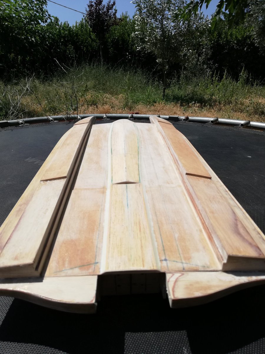

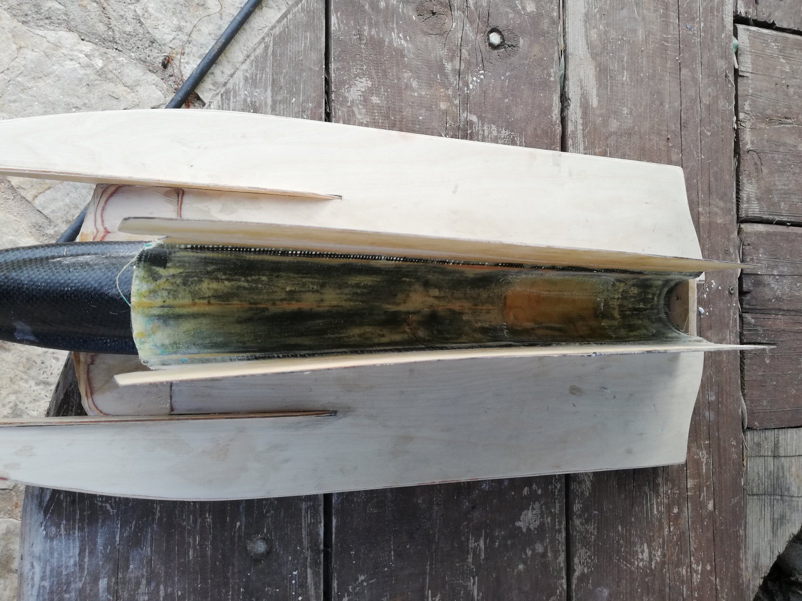

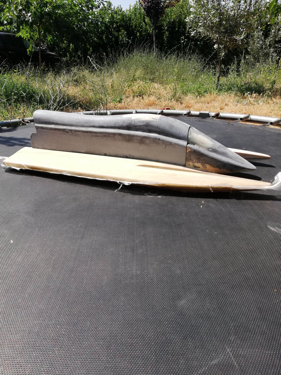

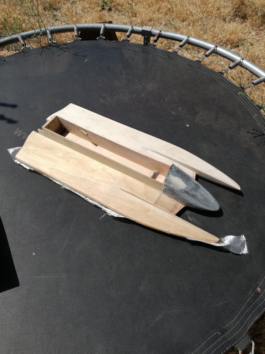

    Fiberglassing the hull....
    I also sanded the cowl + putty. The cowl still needs so much work
    I fillet the corners with thicken epoxy. The cloth at the top is one piece... Very happy for this.
    After trimming and initial sanding...

    This is your best built so far, in my opinion. Quite complex but the result so far looks great.
