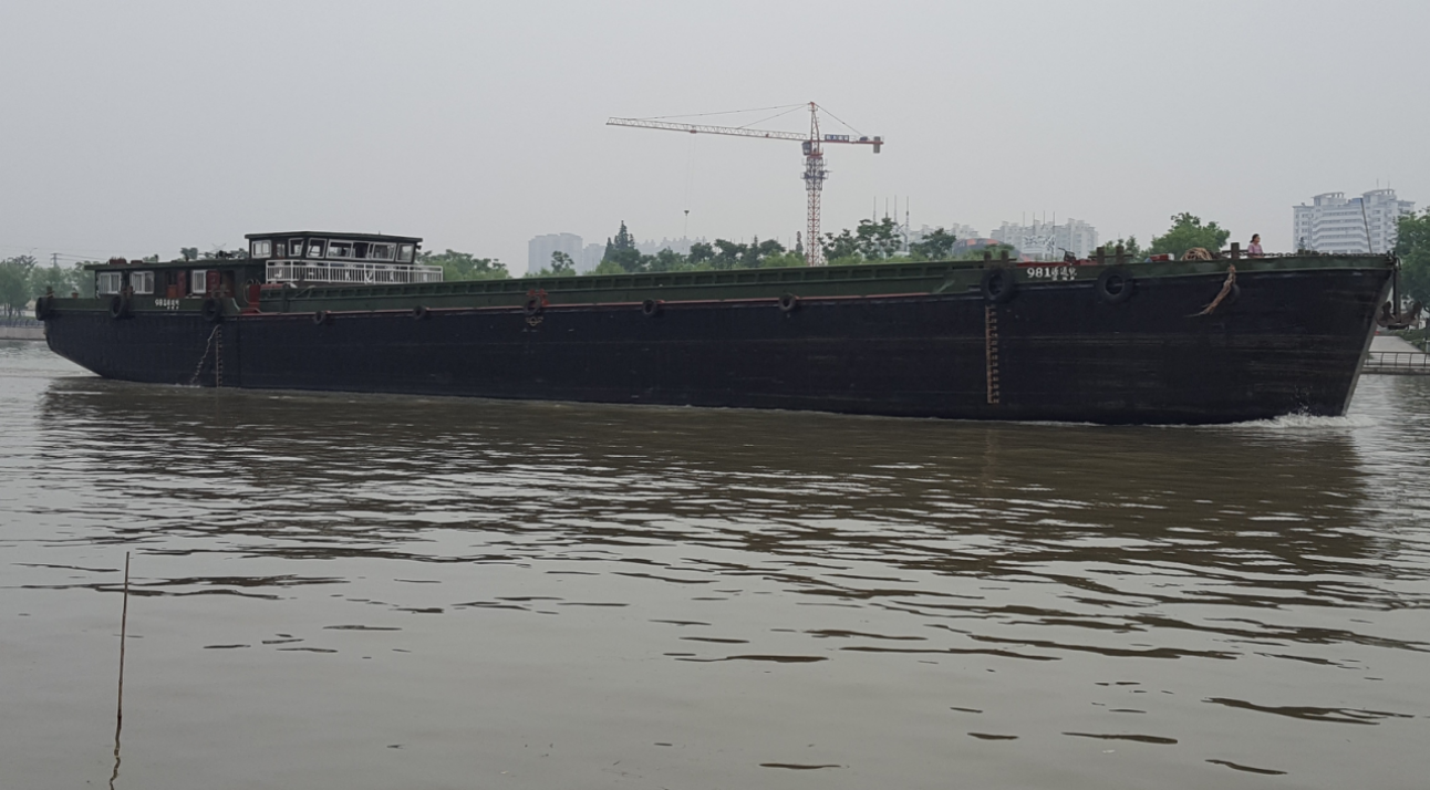

N Paar jaar gelede studente van mij het my uitgeneem vir ete by een restaurant recht langs een van Nantong se kanale. Terwijl ons buite sit, kom daar een boot/schuit.schip verbij al langs de kanaal af - geluidloos behalwe vir de groot dieselenjin.
Zo kom dit toe uit dat dit een van China se "sand boats" is wat bouwsand vervoer vanaf de binneland na Shanghai. Ik was onmiddellik gefascineer en wouw meer uitvind van de leefwijse van deze boat people. Terwijl ik opgelees het oor de sand boats kom ik toe af op de Tanka people en voila!
Maar wat nou vir mij zo leuk is: kijk net de ooreenkoms met de binnenvaartschip! Twee kontinente apart; twee kulture apartt; twee nasies apart - maar de boot is basies diezelfde! :) Dit is waarom ik nooit wil ophou leer niet!

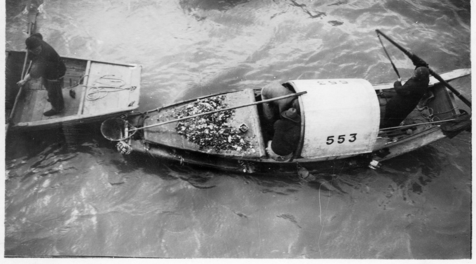

Worcester in his excellent book, The Junks and Sampans of the Yangtze, writes:
This quaint and colourful little craft is a distinctive feature of the Shanghai Harbour. It is called the Hung-T'ou or red head, because of its painted bow, but is more commonly referred to as the mu-chi, or hen boat, for its supposed resemblance to that fowl. Actually, if one were to liken it to a bird, a duck would be a better choice, for it is squat in appearance, with a turned-up tail, and rides the river like a duck.
These boats are entirely Chinese in design and construction. It would seem that they owe something to the Amoy influence. Their history is obscure, but the fact that they have no guild would seem to point to a comparatively recent origin.
They are preferably built of Foochow pine, but if this is unavailable, softwood from Ningpo (Ningbo) is used. The bulkheads are made of hsiang-chang, a hardwood from Kiangsi. The timber is supplied by the merchants in the form of chang-pa-t'ung, that is to say, poles of 1 chang 8 ch'ih. These sampans are all built in or near Shanghai.

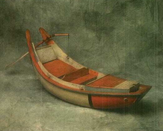

The sampan illustrated below is 18 feet over-all, with a beam of 5 feet and depth of 2 feet. It draws only a few inches unless loaded to capacity, when there is the minimum of freeboard.

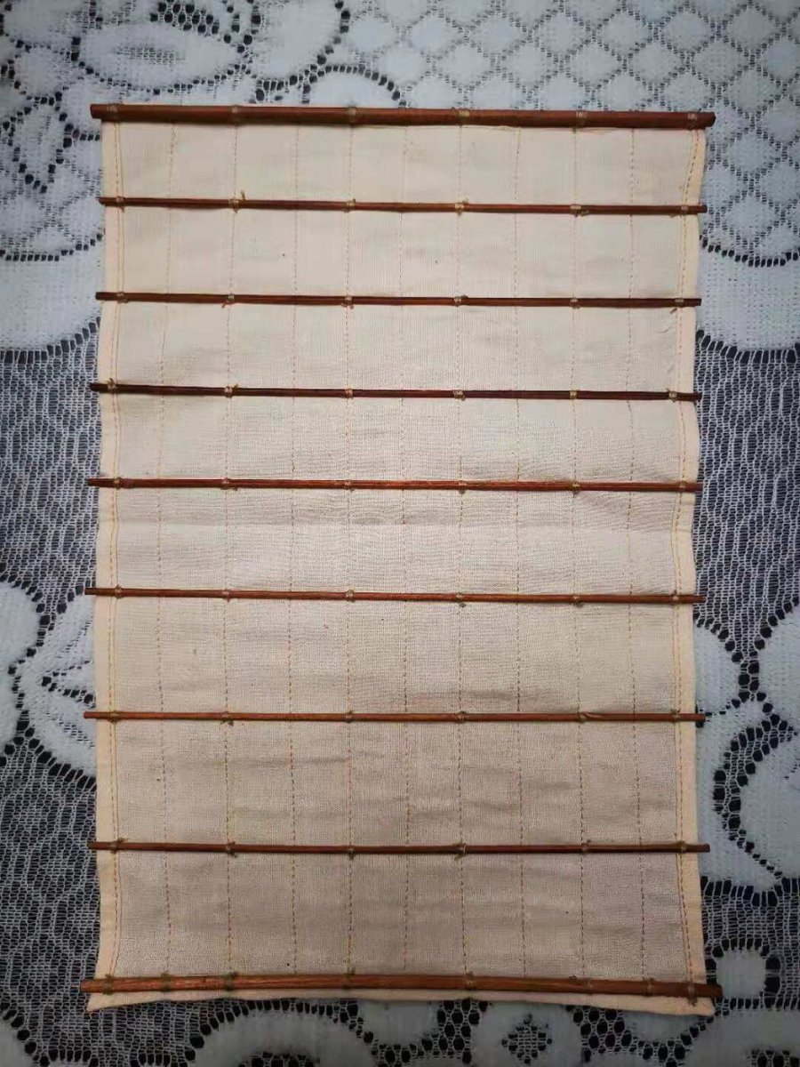

Next my beautiful and wonderful Admiral Anna stepped in and sewed the spars to the pre-sewn sail. I was utterly relieved that I could escape that ordeal and - as I have come to know when she planked the Leudo - the sail was perfect!
That is all for now. Let us see how far we get tonight.

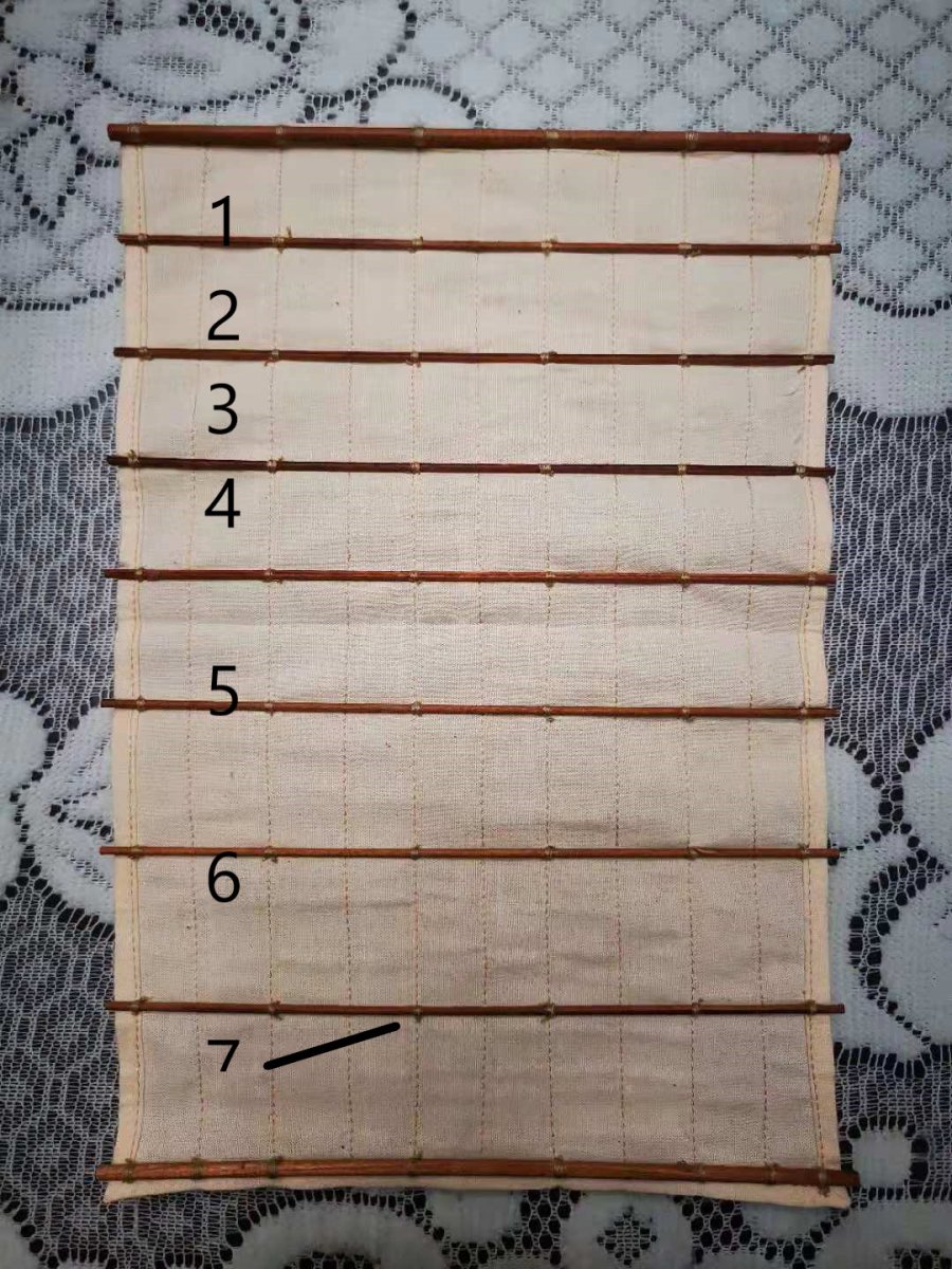

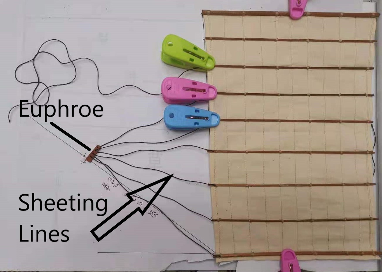

If we can just for a moment take a look again at Admiral’ Anna's sail, you will see that marked # 1-7 are the battens. The fact that the High-Net Fishing sampan had 7 battens meant that it was a large one by sampan standards – normally they had either four or five battens.

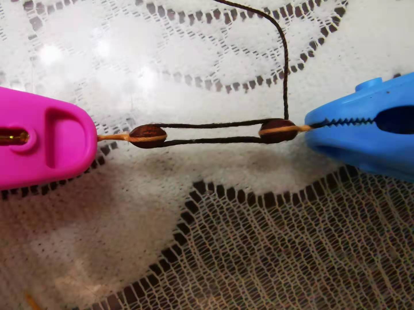

My first job was to glue the sheeting lines to the Port Side of the battens. You can see that I used a large sheet of paper to clamp the sail to and then I drew the angle of the sheeting lines on that. The Euphroe (essentially a friction block), through which all the sheeting lines pass and which maintains equal tension on all the lines is seen above connected to the lines.
Verskoning dat de pllatje op zij kop staat.

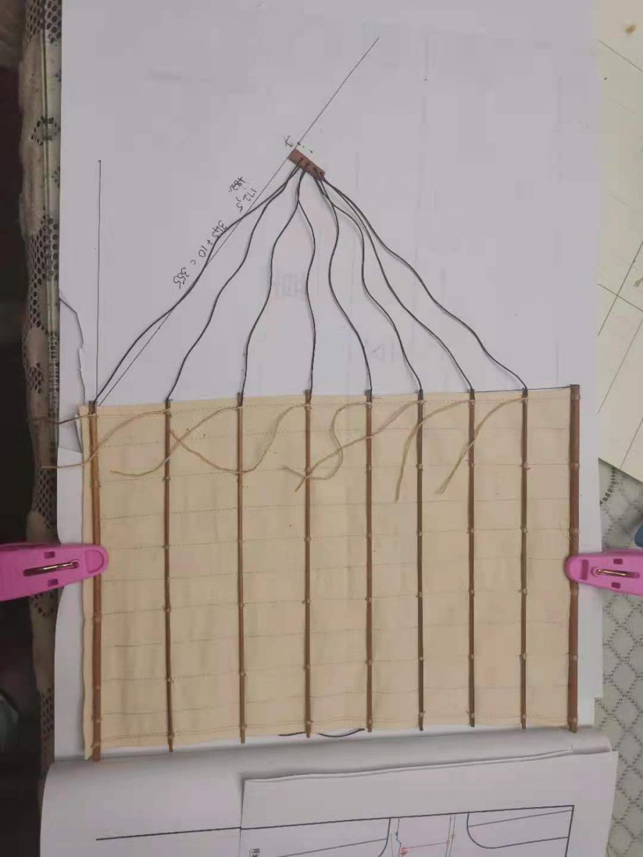

With all the sheeting lines attached to the battens and the with the Euphroe in place, all 8 lines were stropped where they were affixed to the battens. On the picture above you can see that I have already glued the stropping lines into position.

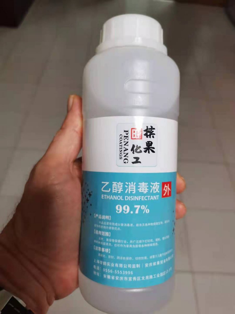

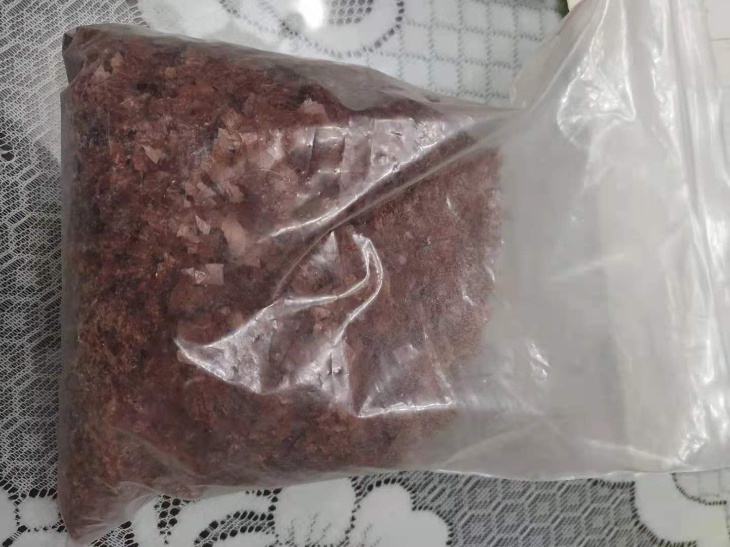

I made contact with some prominent Chinese modelers to find out what they use to stain wood (My Kolderstok stain was far too dark and I wasn’t going to place an order to the Netherlands just for that). They advised me to use Shellac – the first time for me using that.
This is how the product is advertised on Taobao. I obviously selected the “red” color shellac (It is the closest in color to the almost reddish shine of the Pear Wood) and together with a bottle of 99% alcohol, ordered my stash from Taobao.

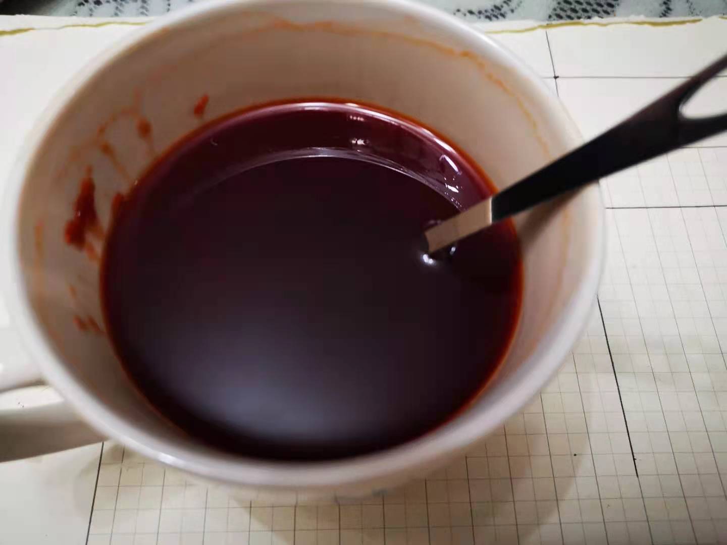

Now comes the fun part where I get to be alchemist. The dry shellac flakes and alcohol are mixed in a ratio of 1:5.
Even though the alcohol had just been added to the shellac, you can already see the colour that it is assuming. 50 grams of Shellac / 100ml of alcohol.

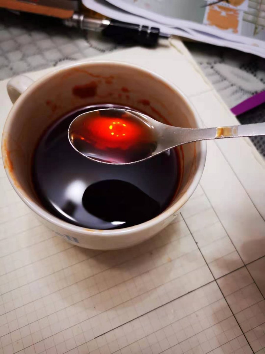

After 15 minutes. this was what the mixture was looking like. If you look closely you can almost see a Chinese flag in the spoon (There are just too many yellow stars!):rofl:
And after approximately an hour, the mixture was ready for application. Mixing the shellac, I all did with meticulous attention to step-by-step pictures, but when it came to treating the mast with the shellac, I did not take any pictures! Stupid!

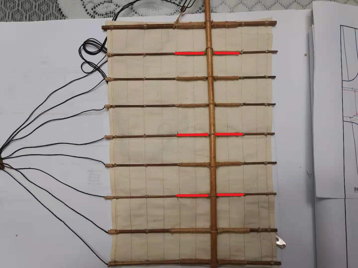

In any case, here you can see the effect of the shellac and the mast in place. Now earlier on, someone on SOS mentioned that there are luckily not ratlines. This may be true BUT the mast had to be stropped - on both sides - in a total of 9 locations. The three red lines just indicate some of the stropping lines.
So as you can see- I had quite a productive day.

Prachtig werk weer Heinrich, my friend, en je nieuwe mast heeft een mooie kleur gekregen van de schellak.

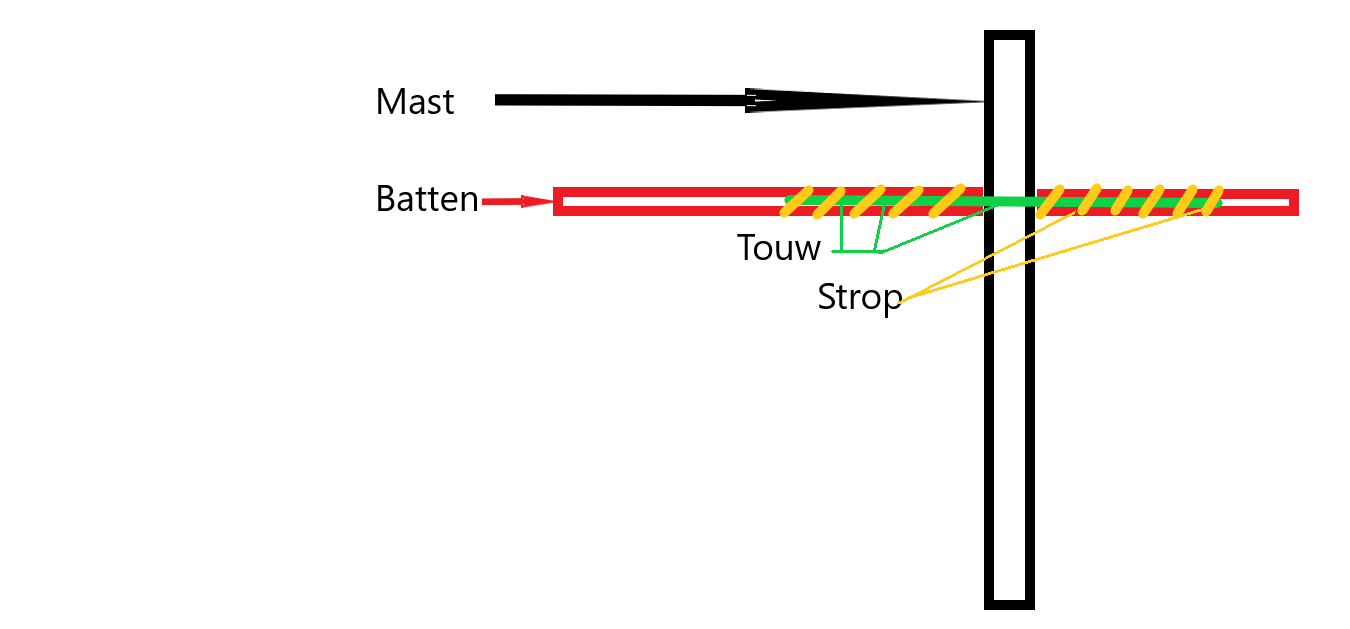

Maar, even uit nieuwsgierigheid, heb je misschien ook een foto van de bevestiging van je zeil aan de mast??
@Pingu57 Vele dank Peter. Ik denk ook de mast past heel goed by de battens. Nouw de zeil word glad niet aan de mast bevestigd niet! :) De battens word vasgenaai aan de zeil en de mast wordt net los op de battens geplaas. Dan word een touw vasgelijm aan de batten, net los oor de mast geplaast en weer aan de anderkant van de mast vasgelijm aan die batten. Zodra de lijm droog is, word die gelijmde dele met touw gestrop,. Ik het geen plaatje daarvan, maar ik het vir jou n schets gemaak.
