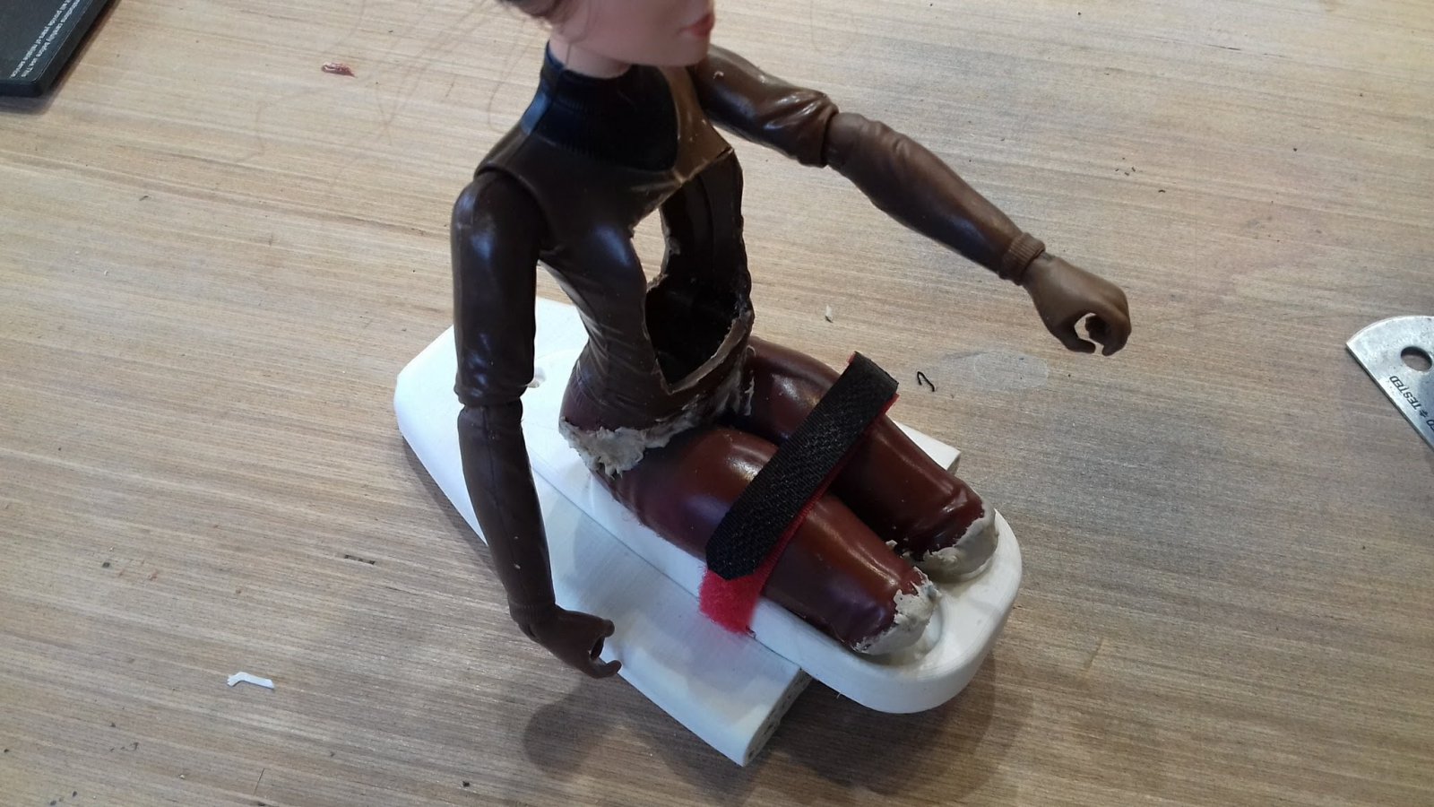

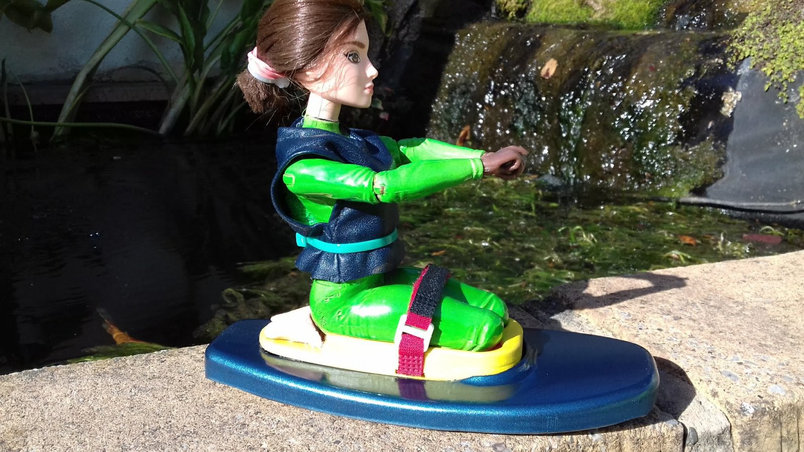

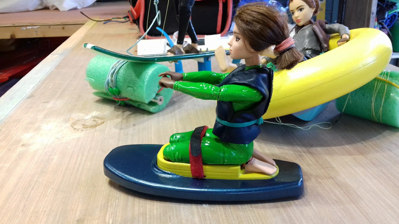

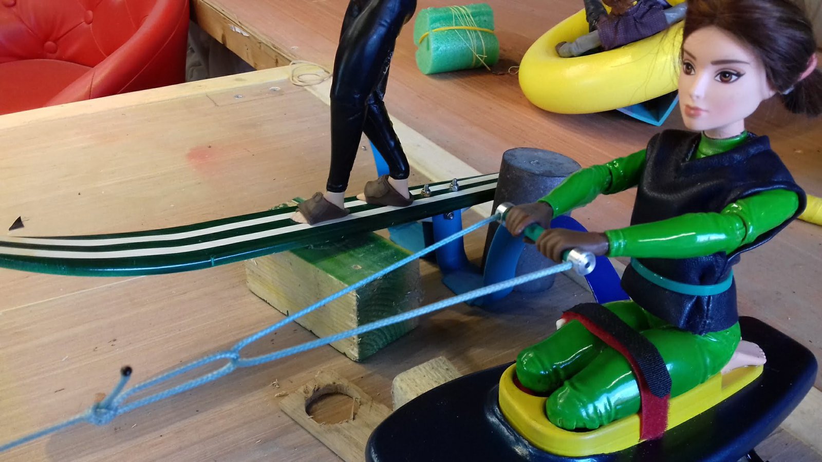

Having a chat a the club with a very nice lady, about skiing, she asked if I had done full size. I replied yes when i used to have a bowrider, but I had more fun kneeboarding, which got me thinking if the foil would work with a knee board. So I am working on the idea, the figure is well on the way, kneeling down of course. I am printing the board now, doing it in 2 parts which screw together when the blade holder is attached. I need to make a Velcro strap to go over the girls knees, and i will need a new tow rope and handle.
Lex will it work?

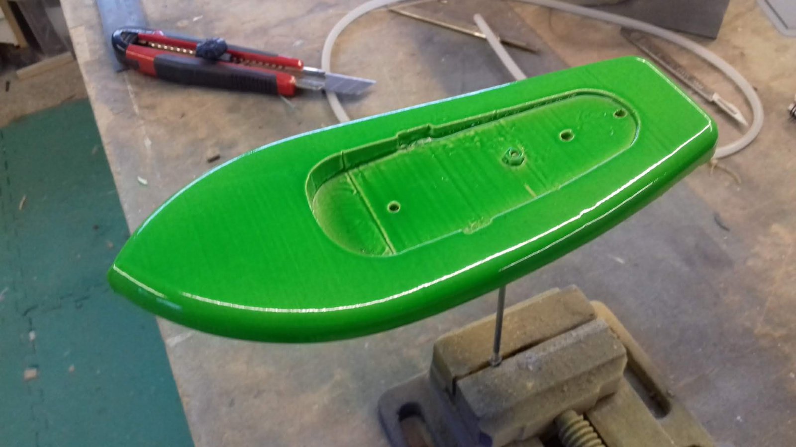

Well I am having fun, I was pushing my luck printing the knee board vertically, it got about half way and fell over. So I cut the messy bit off, now I will print the other half and glue them together.. It might be the new pla I am using, called polyterra.
So I will use my expensive stuff for the next try.
A lot of effort , so I hope it will work. I have made 2 lots of foils , normal and wide, the wide ones give an extra 12mm each side. I think Lex said the wider they are the slower you can go. I hope I don't loose her the strap is all that's holding her to the board

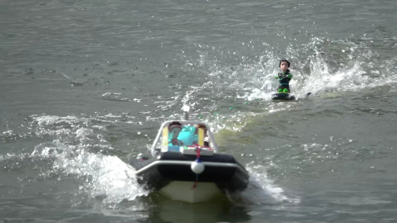

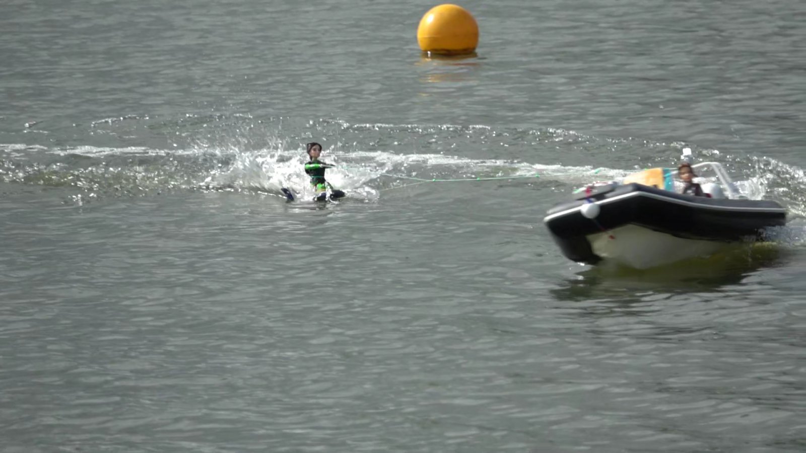

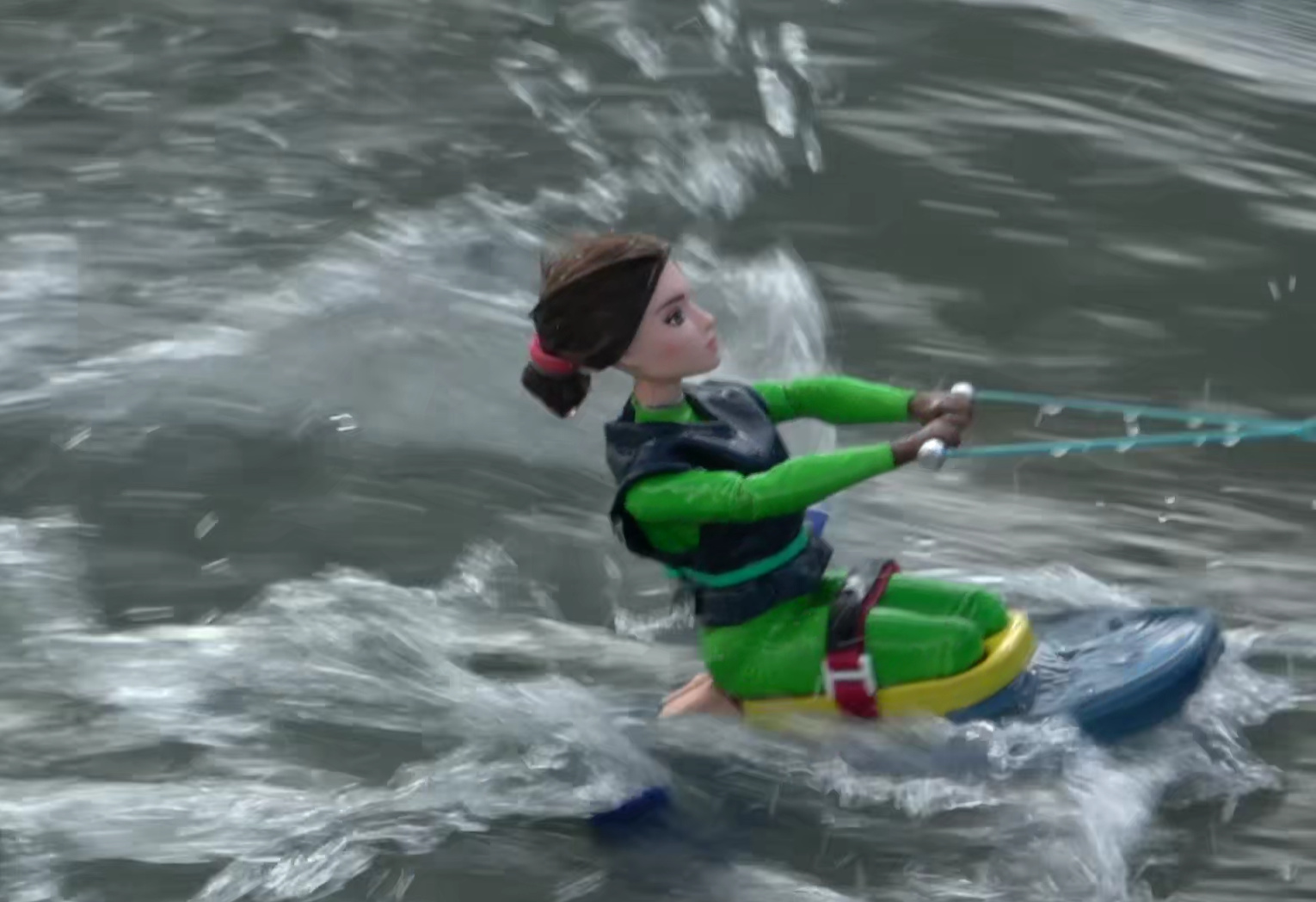

Success right from the start with kneeboarding , in fact because of a lower center of gravity it worked almost better than the ski. Didn't get any film though my camera man was on holiday. I used the Rib with the white outboard today to do the towing and it was fine, I was at 1/4 throttle most of the time. When I can we will get it on film. I am drawing another kneeboard , I can try different designs as it's easy to swap them over.
Terrific!
She starts on her side, so you might want to finetune that too.
But regardless how she starts it works very well!
Well done, great movie!

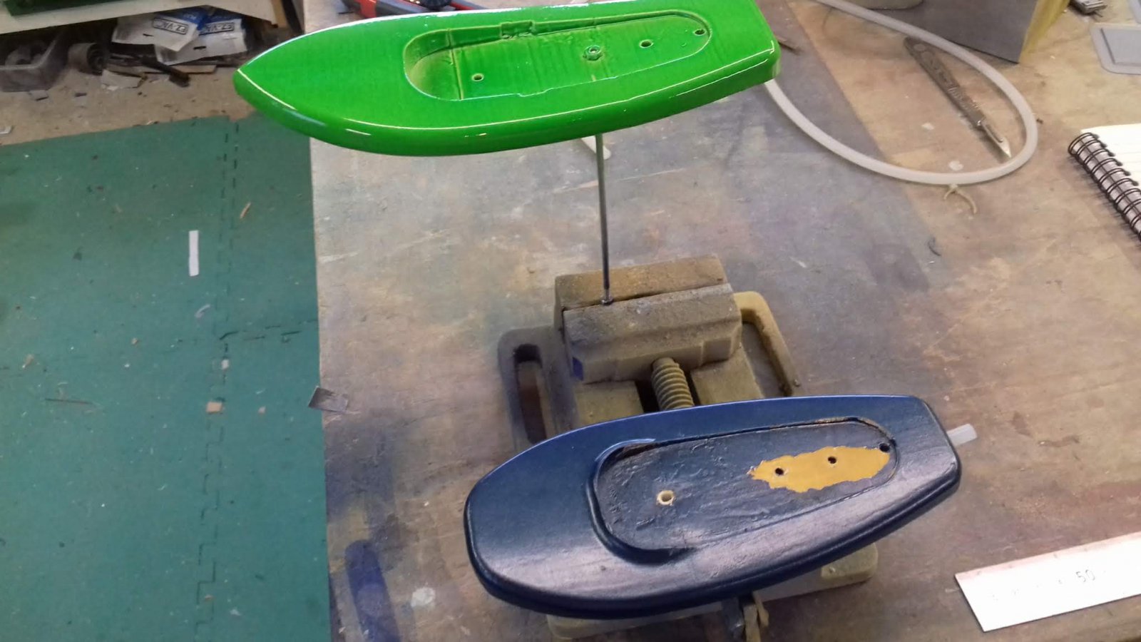

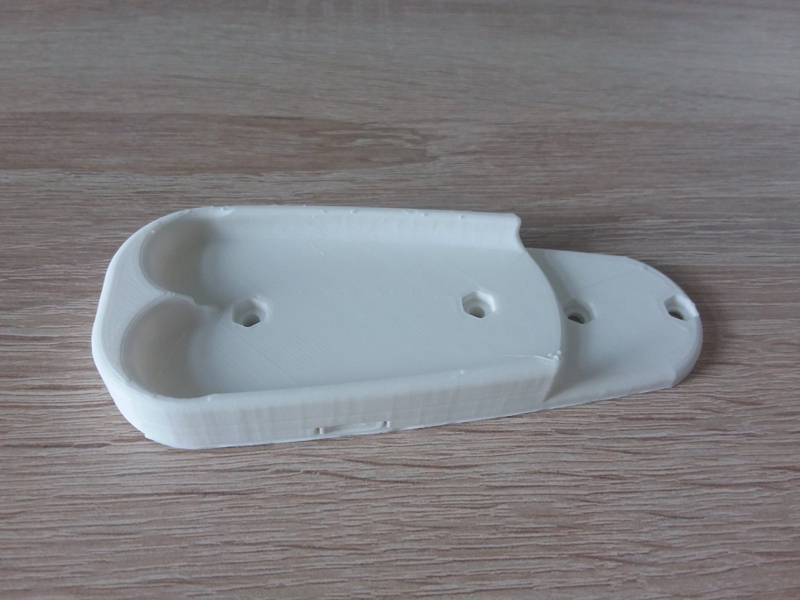

Thanks Michiel, I am working on that, it would be good if she floated upright. I have designed a new board today and I have used shell to hollow it out I can stuff some foam inside. At the back will be a plug for draining, I am printing the front end now, as I split it in two for printing.

I had the same idea , how to operate a rudder, so she could swing out and jump the wakes coming back. There is no room for a receiver and servo. By doing figure of 8s she does cross the wakes, this should show in the next film with on board footage. Maybe with two tow ropes fastened to a servo arm on the boat it might work, all the pull would be offset by a bar under the board. So Olga's new board is ready for tomorrow, I ended up printing it in 3 pieces.

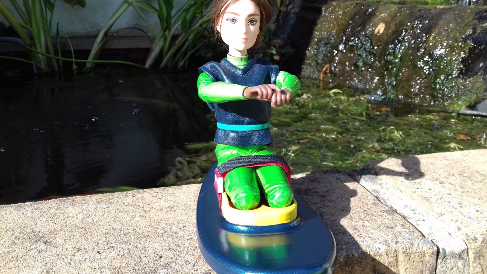

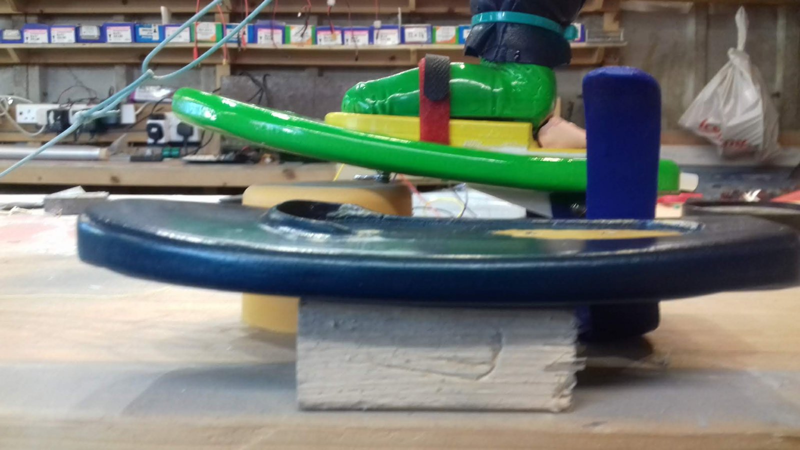

Olga is good to go. Somehow I've ended up with more curve to the board, we shall see if it still works. I added more weight by swapping the 20p pieces for bits of lead, but she still leans over , not as much.
More curve means rocker in surfboard terminology. More rocker means more planted in the water at the cost of more drag.
In your case that means the ski rope will a bit more tight, amps a bit up! We will see!
She looks good!
