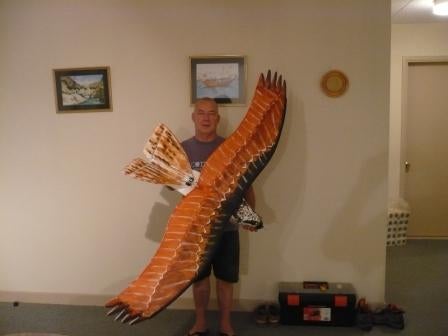

No problem with Osprey copyright, it belongs to mother nature, the painting is not too hard, just look at good photos of your intended Raptor and lightly pencil in the different colour outlines, feather details are done with a wide (20-30mm) almost dry brush, don't worry about perfection just be bold, wipe in an airflow direction with a damp foam kitchen sponge to get the effect. Here is a link to my older Osprey model, Flora, named for my wife.

I would suggest you choose a Raptor with a different colour scheme top and bottom to avoid disorientation, good luck with the paints, I used the cheapest kids acrylics I could buy, they have good coverage and wash up with water before they set firm.

@ Freijn, thanks for the tip, still it did not work for me, but you gave me the idea to post in RCgroups where it does work for me, here's the link;
RC Groups - View Single Post - "Flora" the 74" depron Osprey, *New Flight Vid up!*
I hope this helps you, you can get big image by clicking again the image,
I flew my Alulah again before the sun set, cooler, only 38c, I am very impressed by the effortless and beautiful handling of this bird, mine is 1950g with the GoPro, I think she will take another 250-300g without trouble, again thanks.

Sorry for the delay in finishing my foam version of Bluefalconholand's super design, been busy with the long distance arrival of our first Grandson, Riley. Born 22 July @ Inverness Scotland.
I maidened the 2mtr Alulah this morning, virtual Saturday, and she flew great, I had too much pitch up dialed in so had to retrim in the launch, climb rate is good and general handling super. I only flew for a few minutes as it is so bloody hot, 47c with high humidity...Baaah!
I painted her as an Osprey, I built one before and it flew, just, very twitchy, this Alulah is a much better kettle of fish! I will get my FPV gear in later once I iron out my settings and paint the white off the top surface.
Thanks for a great design Robert, and the inspiration from all you Dutch rc guys, I'm now totally qualified in Google translate, but my spelling sucks.
