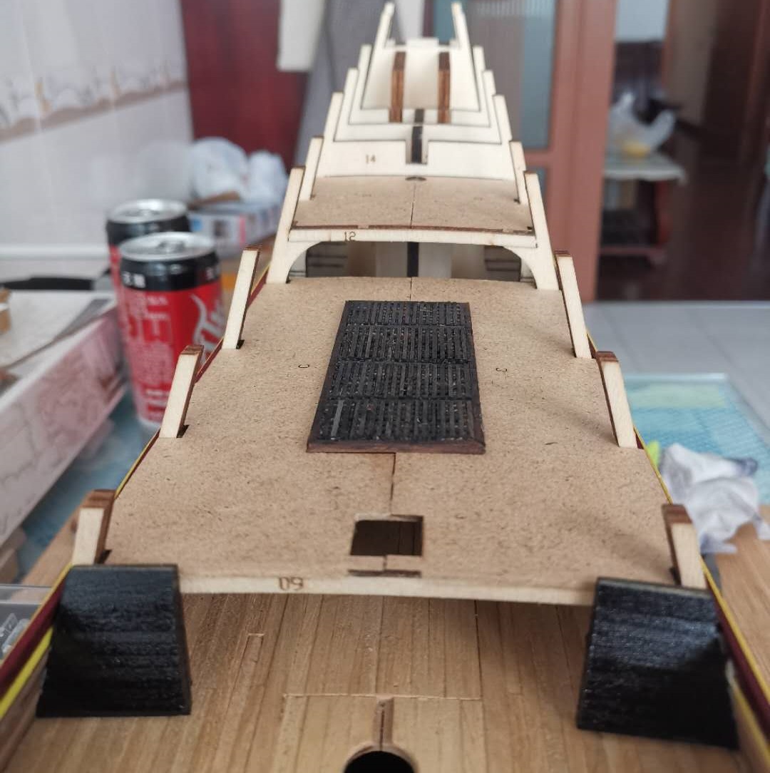

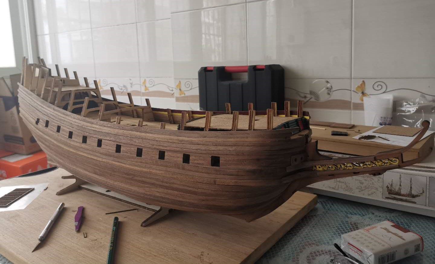

    Time for a decent update. Yesterday I had the day off and had (by my slow standards) a very productive day. So to kick off this post just a status quo picture of where I am at the moment before work commenced.

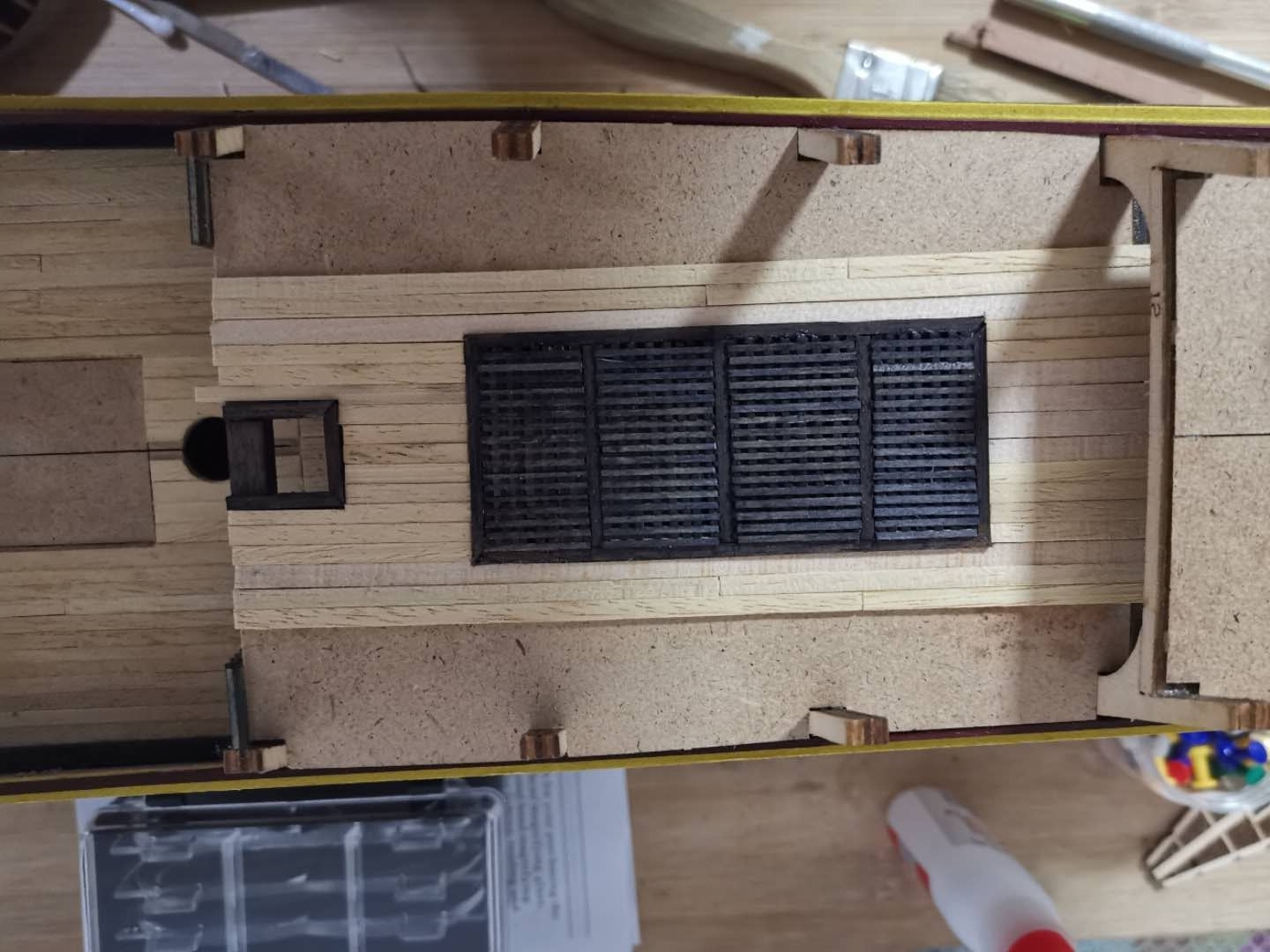

    With my replenished wood supply from Kolderstok having arrived, it was time to complete the coloured wales on the starboard side. I have to point out that me having to order extra wood is by no means an oversight on Kolderstok's part. I have purposely used the 4mm walnut strips for certain parts of the build where I should have used basswood.

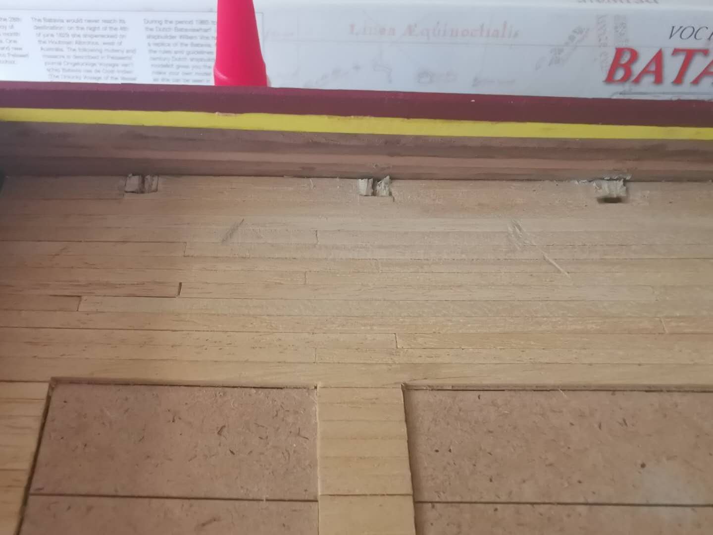

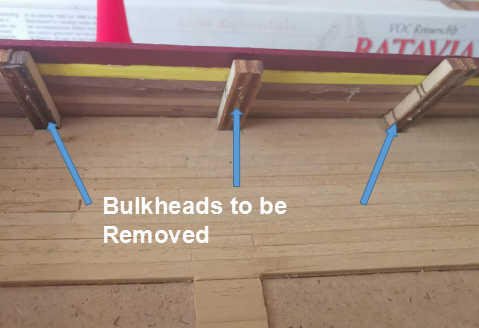

    With that done it was time to remove the protruding bulkheads from the deck.
    During the installation of the wales, great care was taken not to apply glue to these parts of the bulkheads; so removing them was a simple task by using a pair of pliers to snap them off at the base. Even so, it was quite strange breaking something on purpose after you have taken such great care during the building process not to. :)

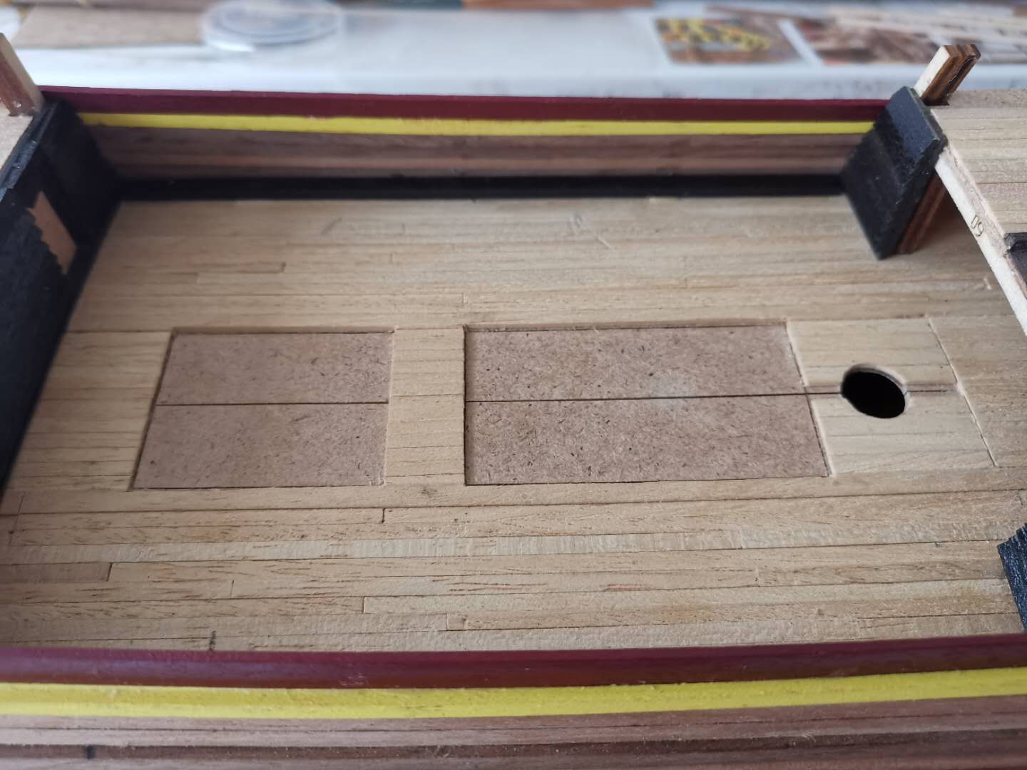

    The remaining stubs were simply sanded flat to deck level. Next the waterway was constructed from two 4mm x 1mm slats glued squarely to each other and then painted black. These two strips were then glued into position on both sides.

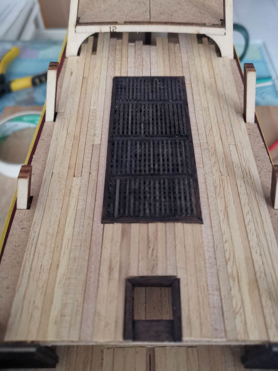

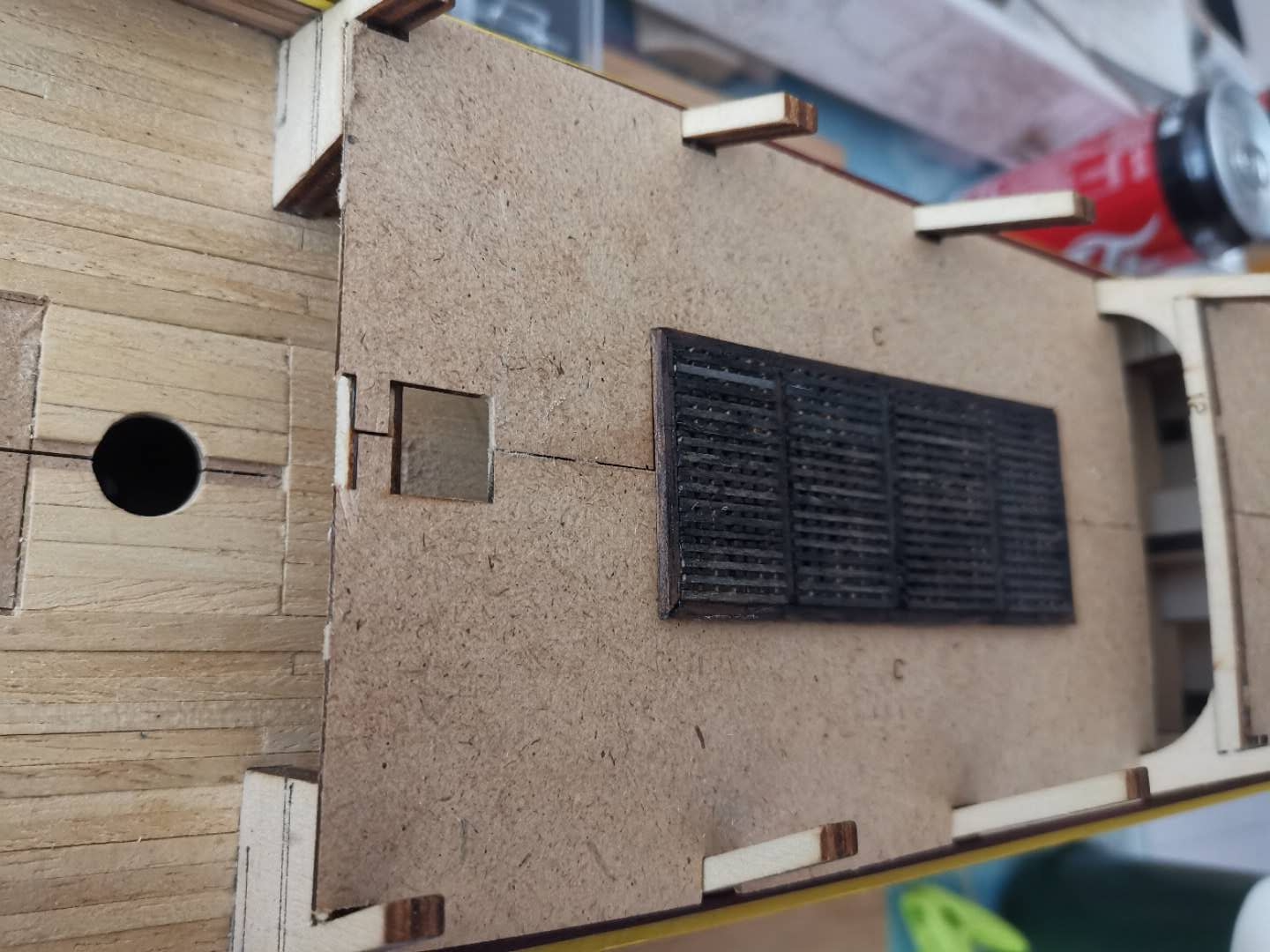

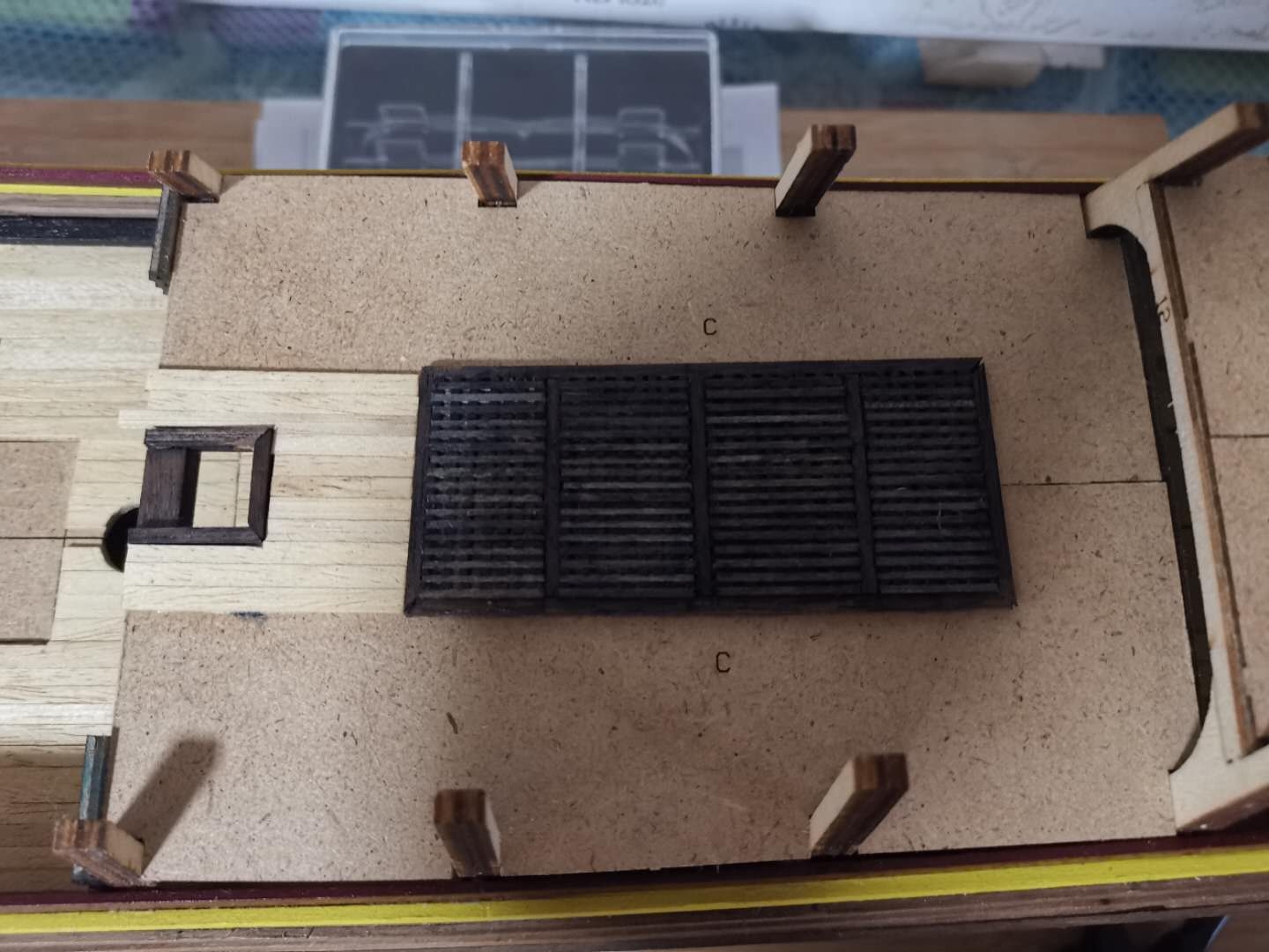

    Next I finally placed the half deck into position and glued the grating in its cut-out. The gratings: Trial and Error - far more "error" than "trial". However, I finally had something that I was happy. I stained it with the Dark Oak water-based stain that Hans has so kindly provided me with Free of Charge and was pleasantly surprised at the result. At first I thought it was far too dark, but seeing it on the ship - especially after I had planked the Half Deck - changed my mind completely.
    Half deck with grating and the two black half-walls are installed. As can be seen these are also constructed of overlapping planks in clinker-style.
    As it was not yet bed-time, I placed the walnut border around the front deck cut-out and started to commence with the planking.
