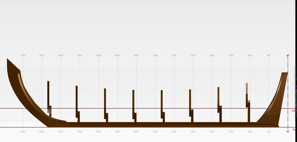

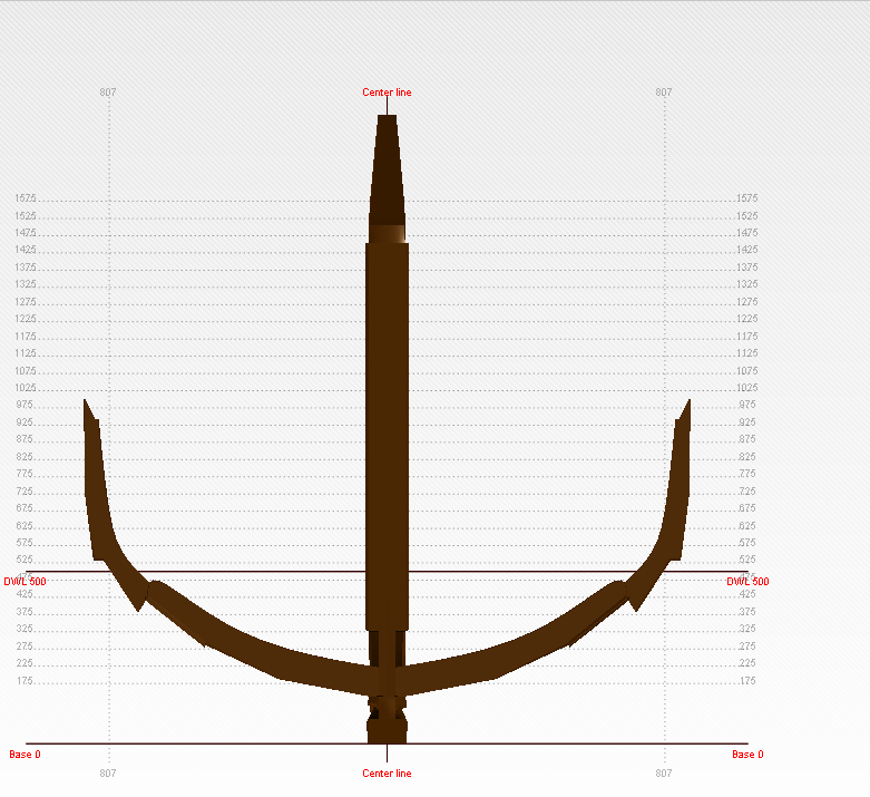

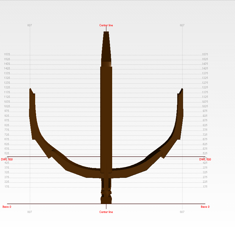

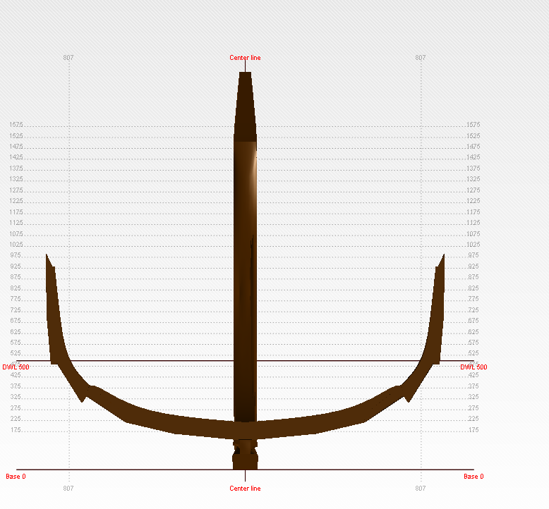

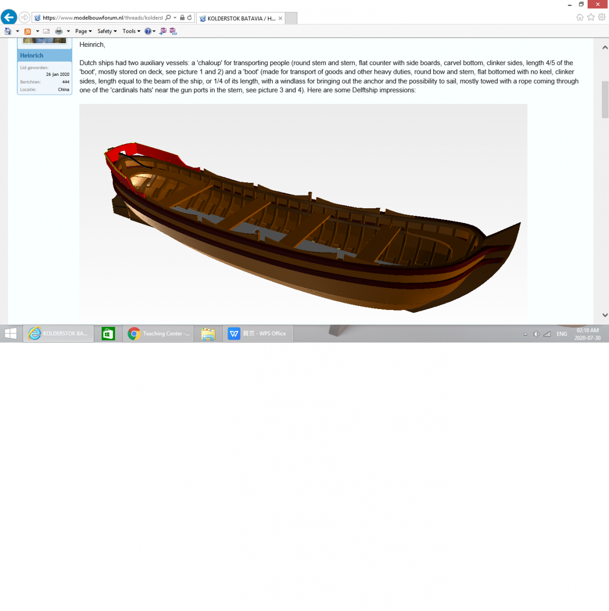

Dutch ships had two auxiliary vessels: a 'chaloup' for transporting people (round stem and stern, flat counter with side boards, carvel bottom, clinker sides, length 4/5 of the 'boot', mostly stored on deck, see picture 1 and 2) and a 'boot' (made for transport of goods and other heavy duties, round bow and stern, flat bottomed with no keel, clinker sides, length equal to the beam of the ship, or 1/4 of its length, with a windlass for bringing out the anchor and the possibility to sail, mostly towed with a rope coming through one of the 'cardinals hats' near the gun ports in the stern, see picture 3 and 4). Here are some Delftship impressions:

All and all: it does not seem a good idea to 'borrow' a longboat out of another tradition of sailing.
If necessary I can supply you with lines plans, just let me know.

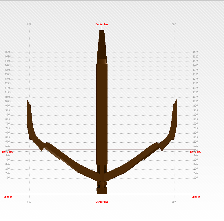

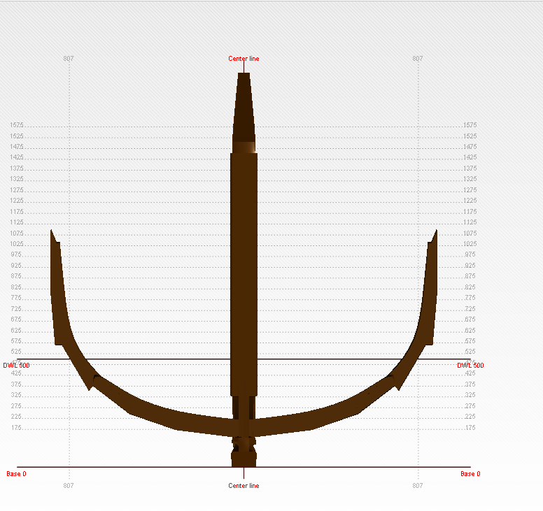

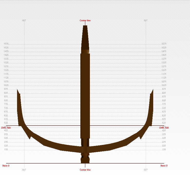

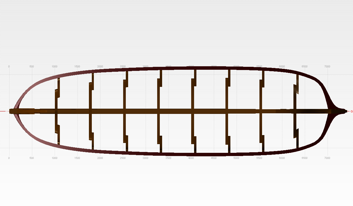

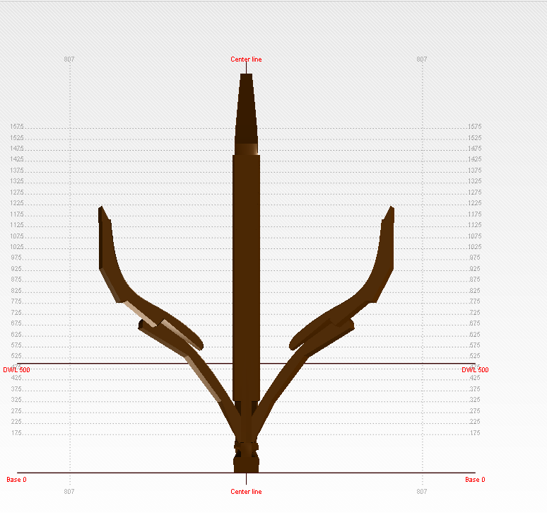

Bovenaanzicht
Spant 00
Spant 03
Spant 06
Spant 09
Spant 12
Spant 15
Spant C

Zijaanzicht
Ab Hoving
The length of the chaloup will be 32 feet (9,065m). The vessel I sent you is somewhat smaller at 26 feet but can be enlarged at will.
If you take the sideview and print it with a length of 32 feet at your model scale you can divide the distances betrween the given frames likewise. The following order is from fore to aft: F, C, 00,03, 06, 09, 12,15. In relaity there are two9 extra frames between each given frame.
Once you have the shape of the chaloup you can add the details according to the prints I sent you. The number of benches will be larger. Normally the space between is 4 feet (1.13m) so you can decide for yourself.
There you go gentlemen - go scratch-build those longboats!
