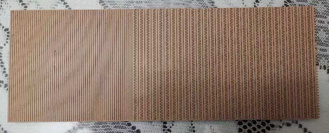

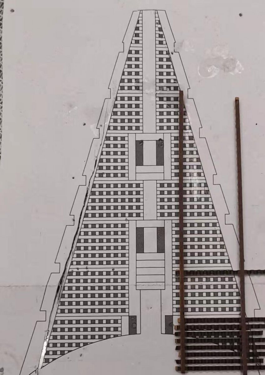

    As all Kolderstok builders are well aware, this is what faces us when we have to make roosters - and since roosters form a big part of the galjoen, this is the challenge for now.

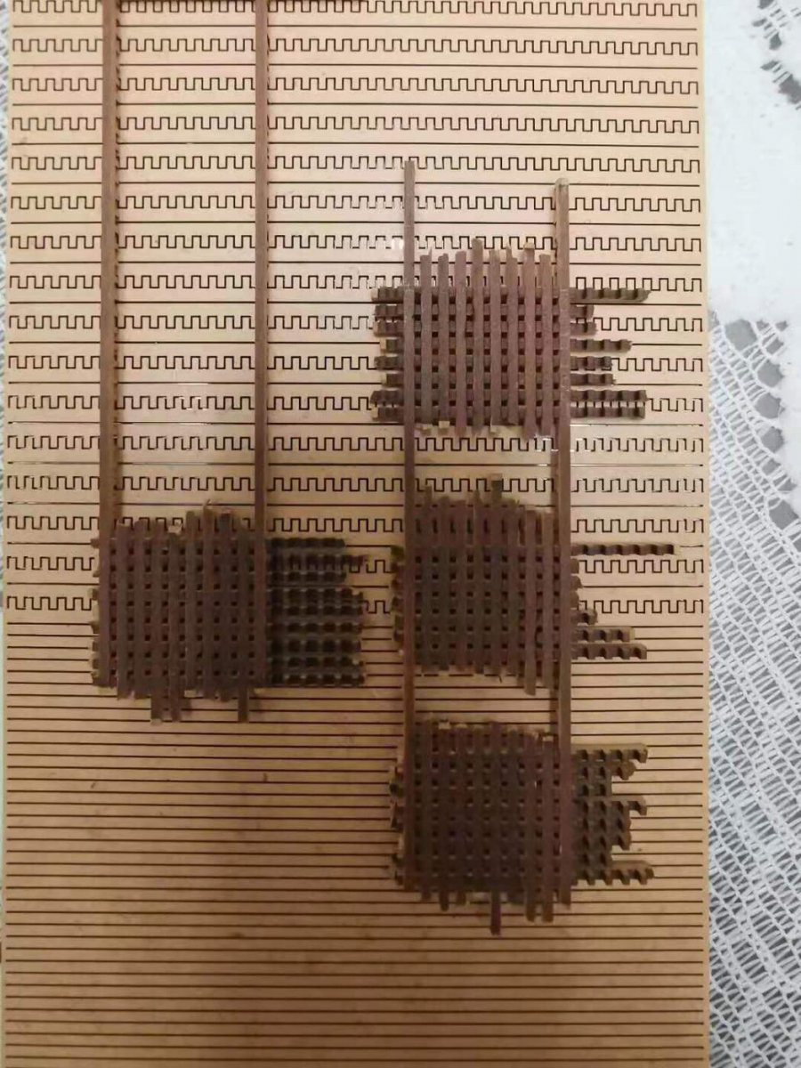

    Here you can see the notched sections from left to right while the straight pieces are inserted into the notches and gently pressed into position.

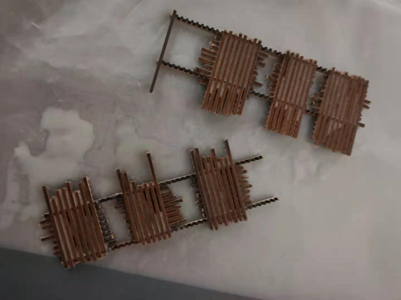

    Now if I may be excused for listing a pet hate, it is the completely out-of-scale size of the roosters that I see on most models - they are simply way too big. Luckily, Kolderstok does not make this mistake - but there is a trade-off. This is a job that requires plenty of patience and the whisperings of sweet-nothings into the ear of these parts which are not the most co-operative of sorts. With these done, it was time to mix the special cocktail.

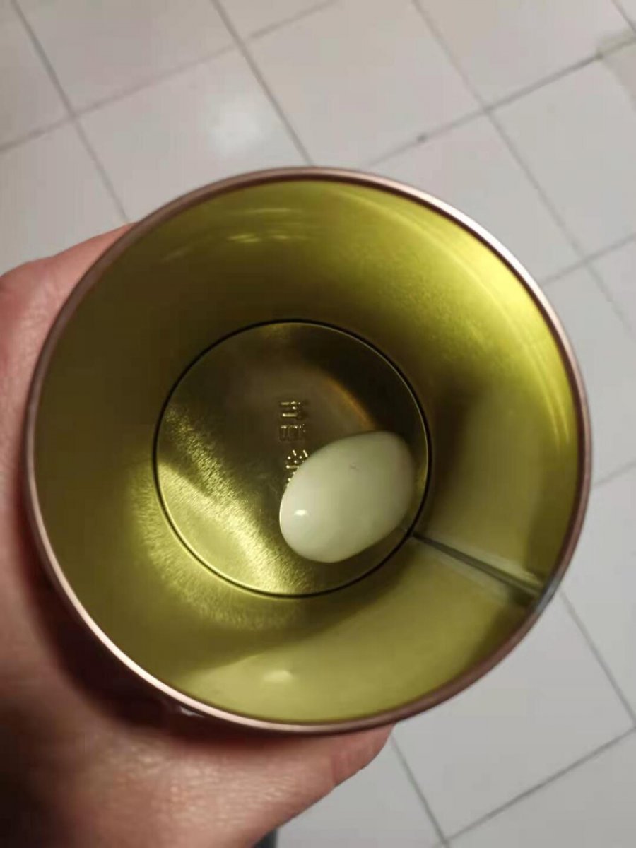

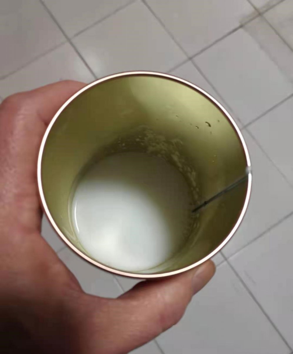

    PVA lijm
    Vermeng met warm water om die mix makliker te maak.
    Daarna word die houtlijm goed in al die nooks en crannies ingewerk en tijd gegee om goed droog te word.

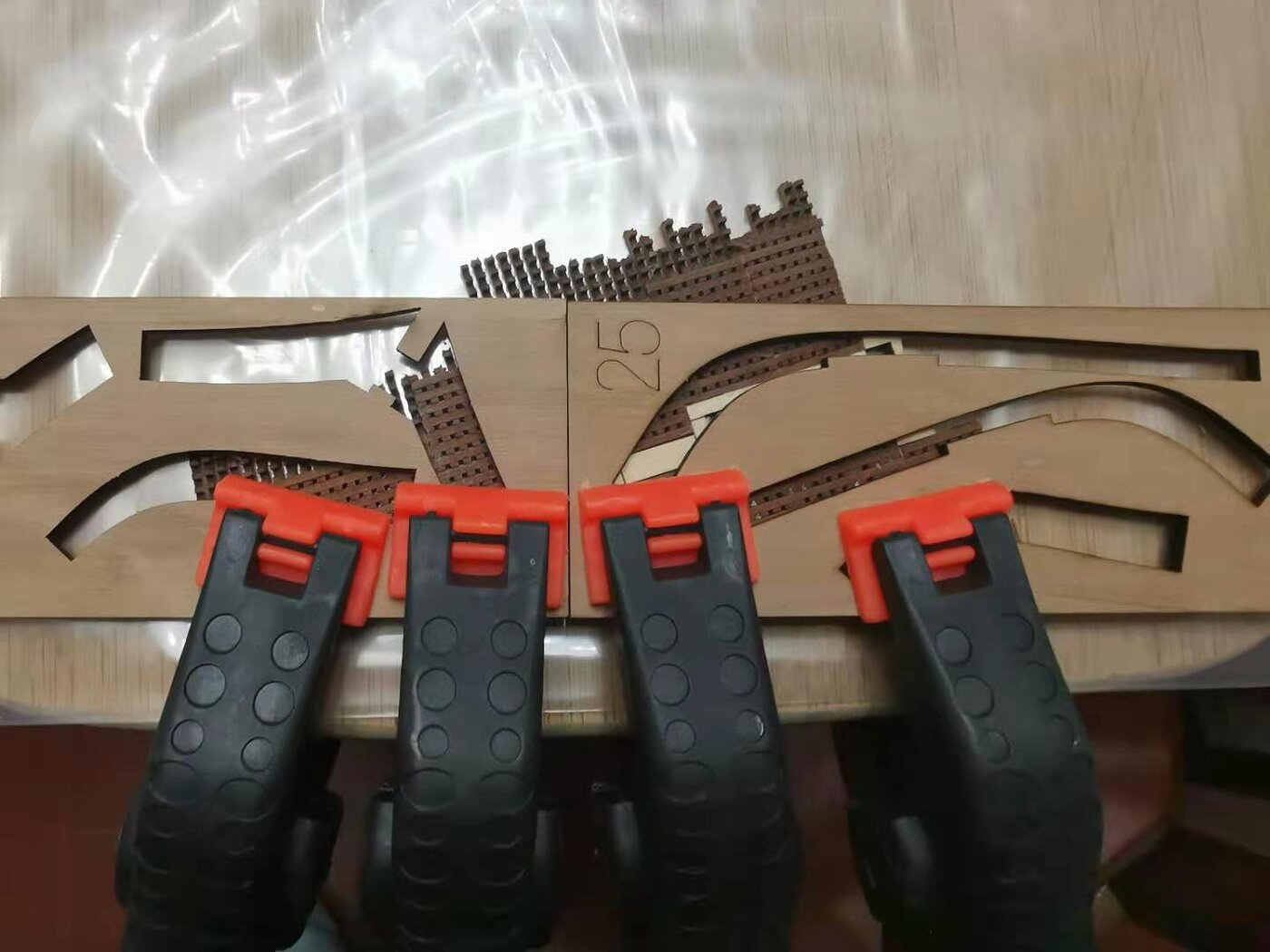

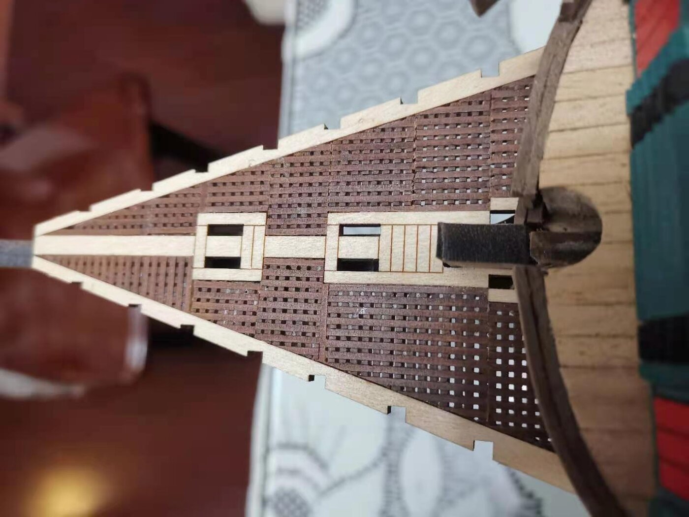

    After that, the individual units are then cut to size and glued to the centre piece of the galjoen. When properly dried the edges are cut to size and the side-pieces are glued into the position.

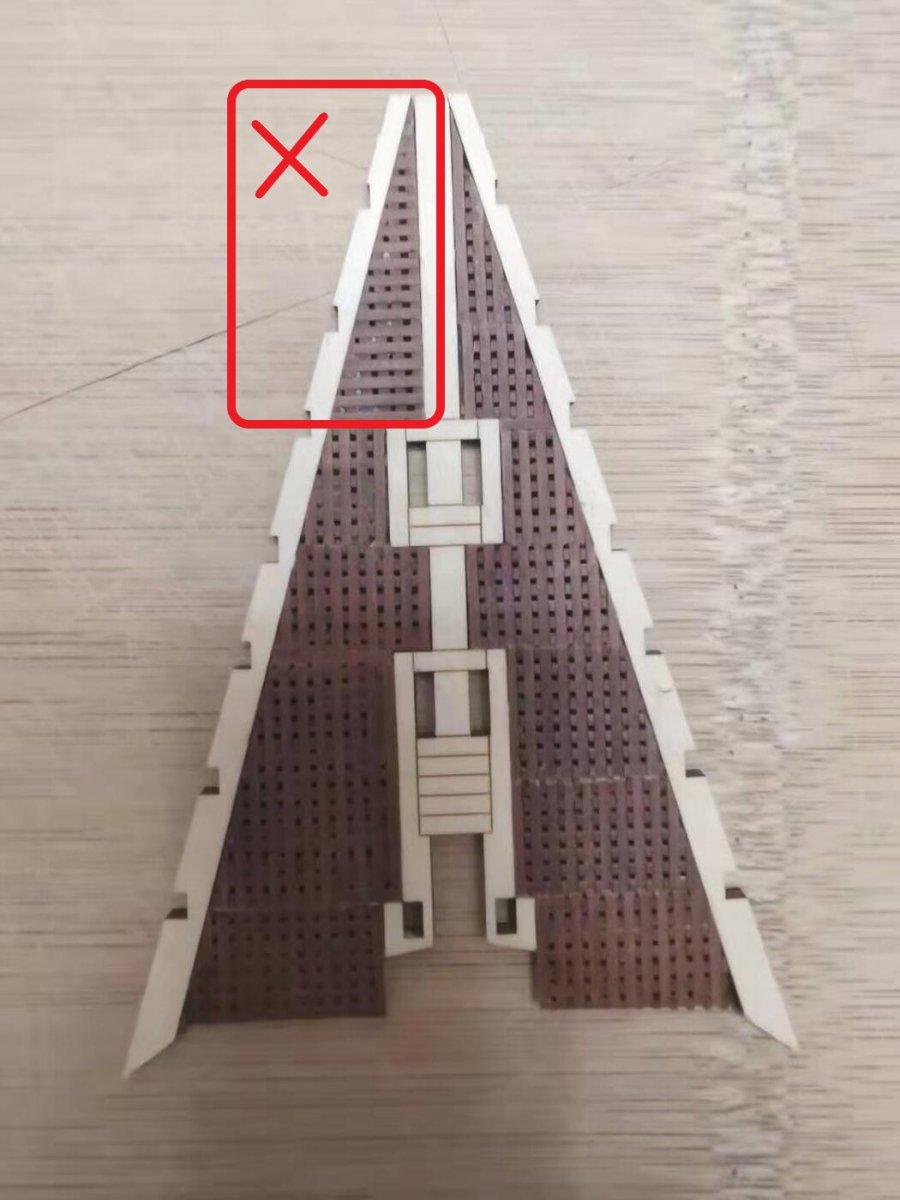

    After I had left the glue to dry for a good four hours, I removed the clamps and was very happy with how it turned out. MARRE toe ik na die plaatje kijk ....:hammer::hammer::hammer:n "Rookie" MIstake !!!
    The reality is that no one will see that in real life as the bowsprit - which is quite a substantial piece of wood - sits on top of that as well. I can redo the assembly, but then run the risk that it may not turn out as well as this one did structurally - it is just not worth the effort and risk.

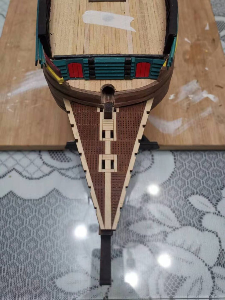

    En so pas die galjoen (net los neergesit) op die Haarlem.

    Bijzonder mooi wat je laat zien en dat het rooster verkeerd om zit valt straks niet meer op.

    Dat is baie mooi geworden, het viel mij geeneens op dat er iets verkeerd was:)

    Jammer van dat kleine foutje, maar voor de rest ziet het rooster er schitterend uit :thumbsup::thumbsup:

    Heel fijn dat je weer tijd gevonden hebt voor de Haarlem mijn vriend, en je hebt inderdaad mooie roosters gemaakt, but will your engineer/ directievleugel let you off the hook regarding this little mistake? Veel belangrijker, ga jij jezelf hier niet aan irriteren??

    @Pingu57 Hello me vriend! Nee wat, Peter - die foutjie gaan ek nie oor wakker bly nie. Ek kan die galjoen oormaak, maar dan maak ek dalk weer n ander fout! En om nog een te maak wat so mooi pas soos die een, is nie die moeite werd nie. In realiteit (nie so vergroot deur die kamera nie) en met die boegspriet wat bo-op kom, dink ek nie mens sal dit sommer sien nie. Baie dankie vir die Niuwjaarswense - dieselfde vir jou en die familie!
