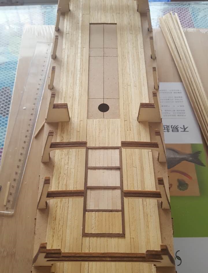

    Time to move on to the next step. I had to decide whether to start with the afschuinsing and rompbeplanking or do the deck planking first. I know that planking the hull first, keeps the deck free from glue-smeared fingers, but despite that, I chose to start with the deck planking. Whether it was wise or not, I have no idea, but I do know one thing ... planking the deck second would have been a LOT more difficult with the hull planking in place. As it was, it seemed if I had barely enough room ...

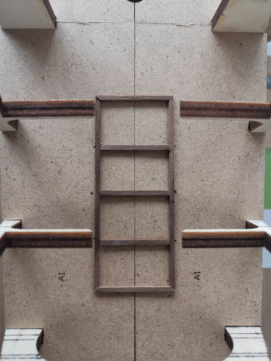

    The first step in the planking process is easy. Construct a grating box with 3 crossbeams using the 1.5mm x 1.5mm walnut strips. The sides were mitred at 45 degrees, put in place and glued.
    Next up is the two schaarstokke on either side of the grating and then the fun began:

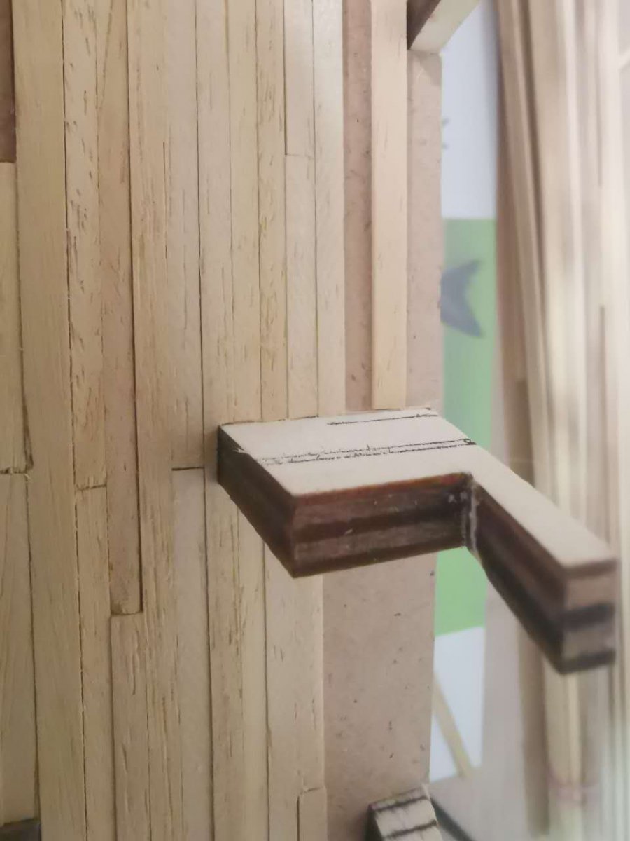

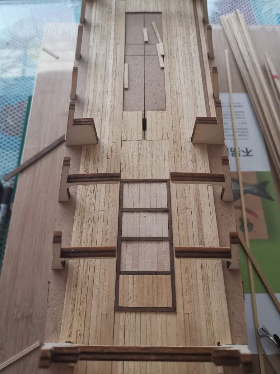

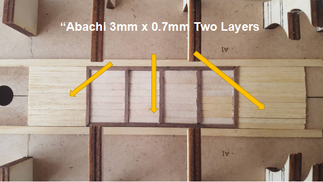

    The planking between the two Schaarstokke is done with 3mm x 0.7mm Abachi planks that need to be planked in two layers. So I completed the first level between the gratings and the two sections on either side of it. An then I was puzzled ... Why did I have 11 planks between the sections on either side of the grating and only 8 in the grating. Because ... Heinrich had not used the 3mm planks, but the 4 mm ones. [​IMG]
    SPOT THE MISTAKE!
    Then I realised. This deck may look simple, but it is going to be require care. Luckily, I had only put down the first layer, so that could easily be repaired by the next layer, but the message was clear: PAY ATTENTION!
    I took great care that the joints were properly lapped.

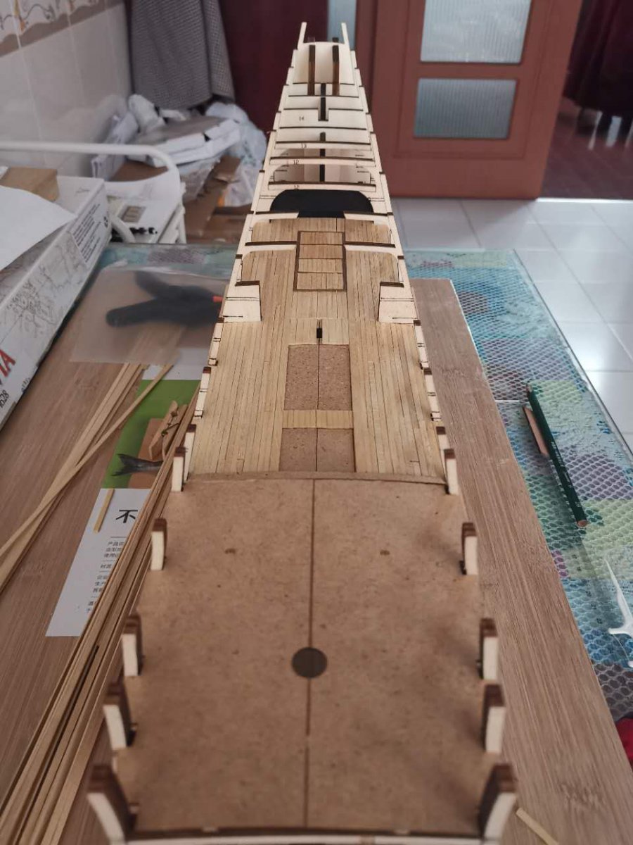

    After 3 days of working on and off on the deck this is where we are now. The funny thing is that working so closely on the planking, you get tunnel vision and can't really form a good overall idea of the planking. Only after I had downloaded the pictures on the PC, could I get a proper idea of what it looked like.

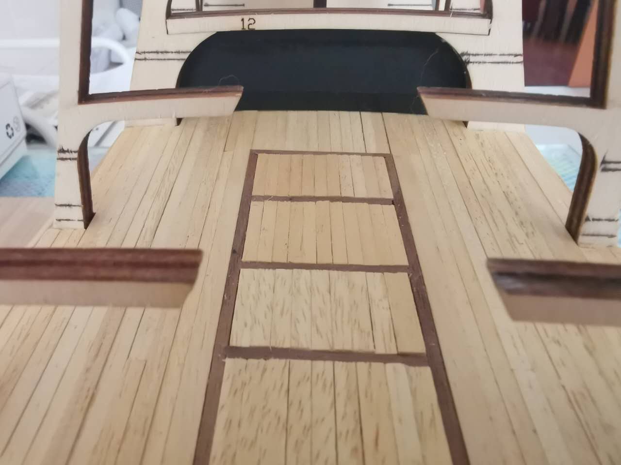

    I like how the Abachi takes on a "yellowish / orangy" colour in bright daylight ...
    Which then becomes much darker in the fading light.

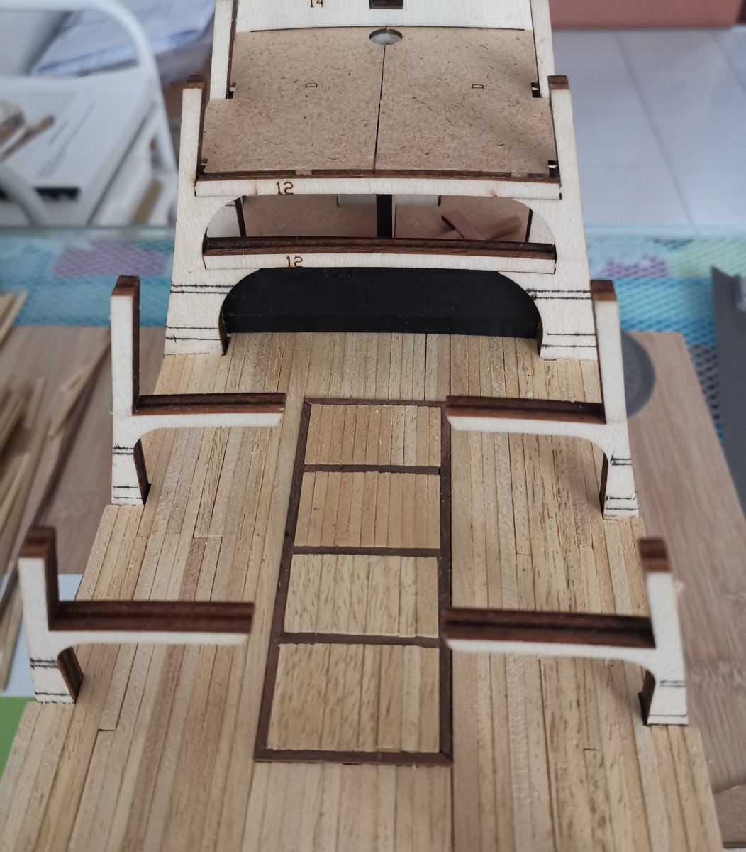

    This then is where I am now. Of course, the finishing off still needs to be done, but for the time being, I think I will move on to the next step.
    Thank you all for your interest and for following.
    Kind regards - Heinrich
    Montgomery, janzwart, TIMBERWOLF en 4 anderen vinden dit leuk.

    Actually, the wider planks in the grating are pretty realistic. The gratings were covered with removable planks to allow sailors to walk on the gratings without twisting their ankles. These planks can easily be wider or narrower than the deck planks, so to actually have them be a different width from the deck planks accentuates the fact that they are loose items.

    Tja het blijft opletten Heinrich ;)Maar wat ik altijd doe bij het begin is om de doos op de eetkamer tafel uit te stallen en dan al het uitgevoerde hout uit te zoeken en te sorteren, dit is heel wat werk maar dat verdien je later geheel terug. ....
    Er is een troost, van deze roosters en gedeelte dek zie je later niets meer terug, tenminste op de Batavia: p

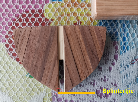

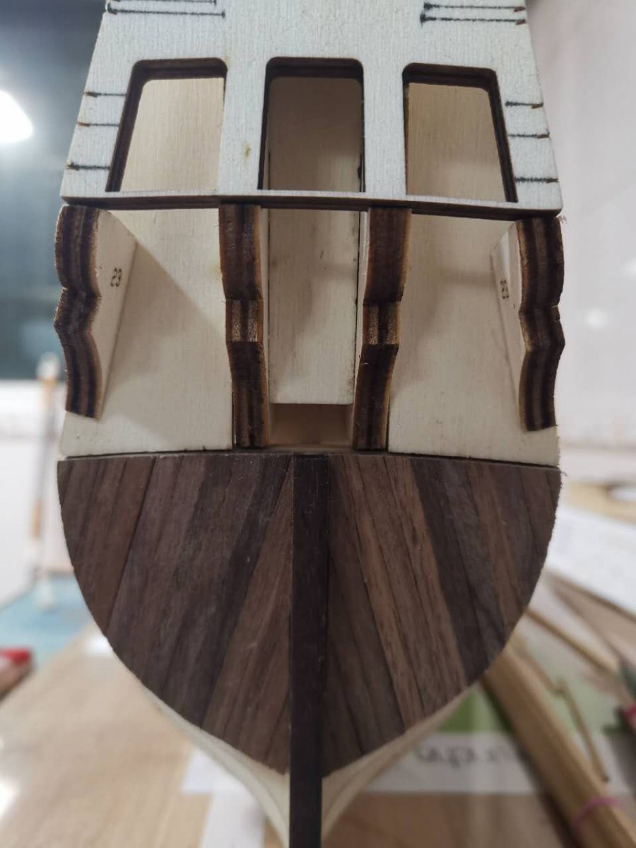

    I am slowly working towards the planking of the hull, but first there are a few loose ends that need attention. First was the wulf that needed to planked. Some of you choose to do the planking on the ship, but I was not that brave. I dry-fitted it to the hull, and then traced two lines on either side of the keel with a pencil. This area would represent my “keep clear” zone - otherwise the wulf would not go over the keel.

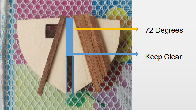

    With the help of a protractor the correct angle was determined and the first few planks laid down. You will notice that the thickness of some of the planks vary slightly (not much, but noticeable) which I really like in this case. They can obviously be smoothed out during the final sanding and finishing, but for now they create great definition between the planks. Also, I did not try to select strips that were the same in appearance to one another - I picked them randomly. As the Admiraal has already noted, the Dutch ships were built with whatever was at hand and sometimes it led to a far less structured approach than ... say ... the British.
    Once I got planking, I completely forgot to take photographs. So, unfortunately, I have no pics of the wulf in its "ystervark" state. With the planking finished and the glue properly dried, I turned the wulf on its other side, clamped it to a cutting board and traced repeatedly with a box cutter around the outer edges. This went surprisingly easy.

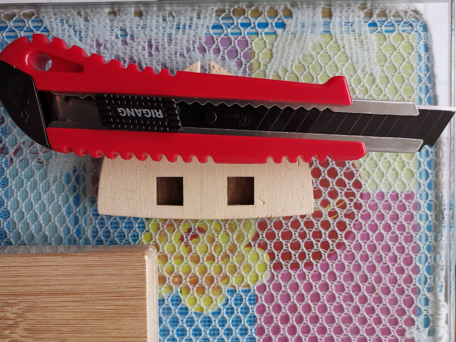

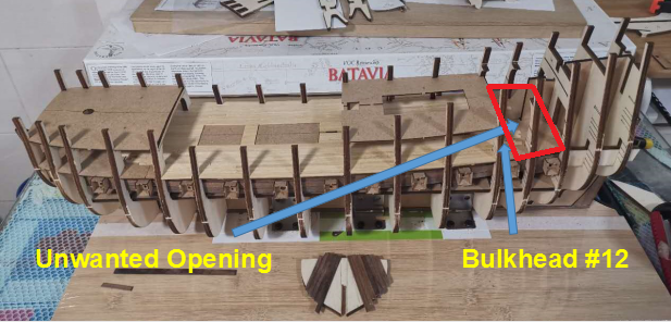

    Then it was time for cutting open the gunports and trying to see if there is a way of installing cannon boxes in the very limited space available behind the wulf. But then I realised ... there was no way that my box cutter / multi-purpose knife was going to fit into the gunports. Neither do I possess a chisel with a 5mm (or smaller) cutting face. A visit to the hardware store was also unsuccessful, so I ordered an Xacto knife from Taobao and will now just have to wait until it gets delivered.
    Nou hoekom die foto upside down is, sal net hy weet. Maar al staan ek op my kop gaan die mes nie daar inpas nie!

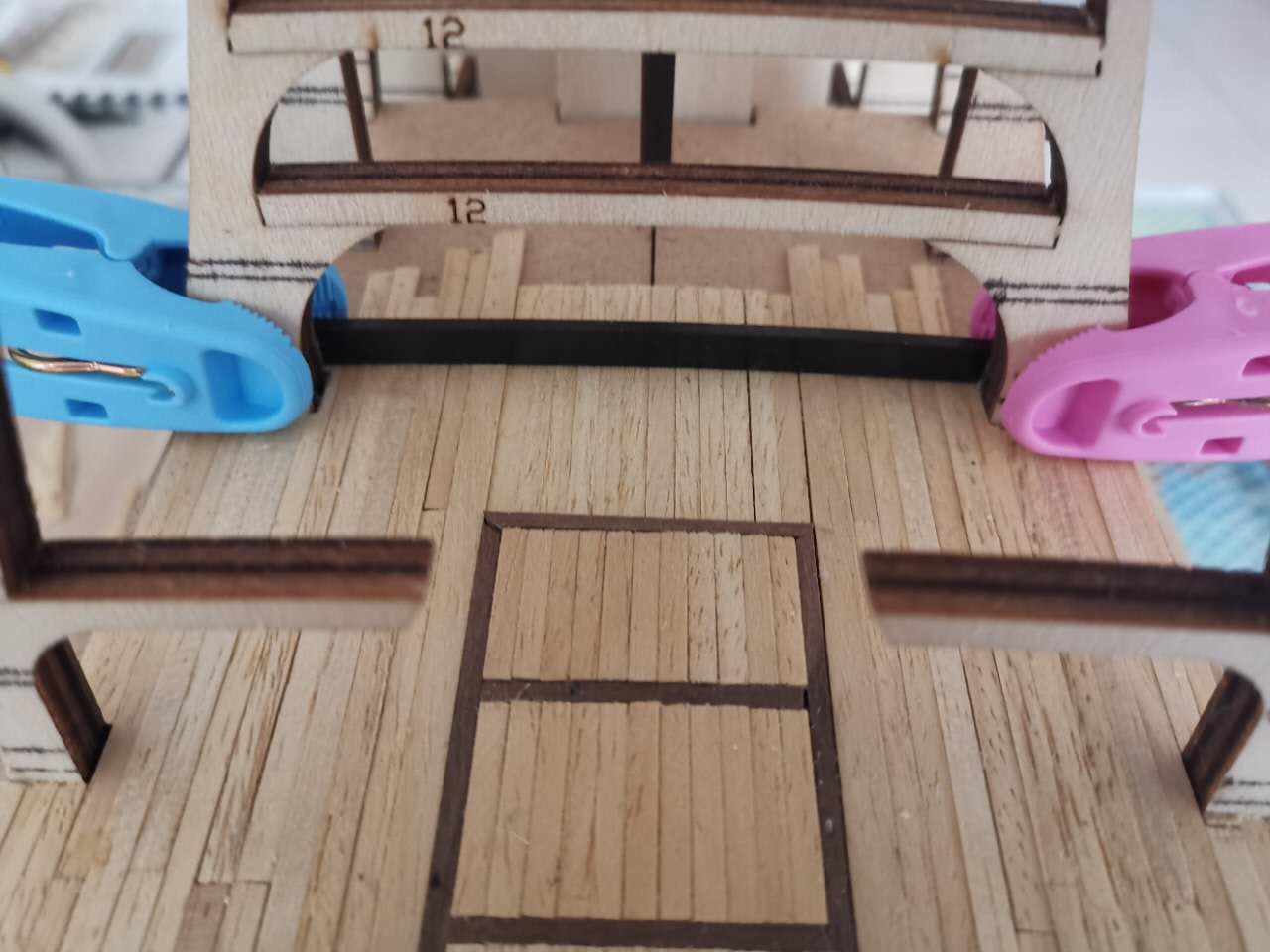

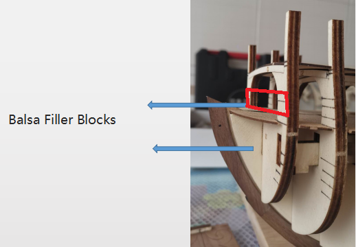

    When I viewed Danny Mulders's build log of the Batavia, the opening behind Spant #12 was sealed off with a black-painted “wand” which gave a nice and finished-off look to the deck area below the quarterdeck. I checked but did not have such a wand in my bouwdoos. Hans told me that because this area is not really visible, this piece has been omitted from later kits. Granted, I agree it is not very visible, but I liked it.
    Die gat in rooi gemerk, moes toe.

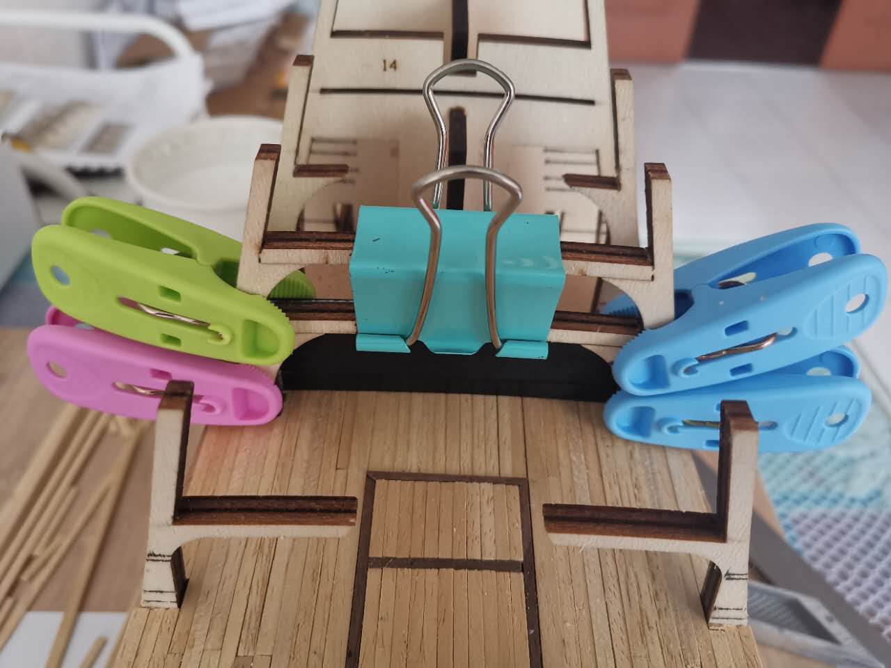

    I delved into my box of scrap wood and came up with a “beam” which I cut to length, bent into the curvature of the deck, painted black and glued up against the rear of spant #12. A scrap piece of MDF was then shaped to follow the beam’s curve, painted black and glued on top of the beam and against spant #12. Now with the black wand, the unfinished area is no longer visible from the front and there is a definitive and clear line from where the planking starts.

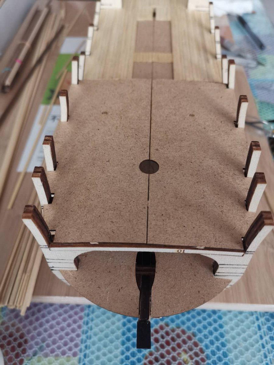

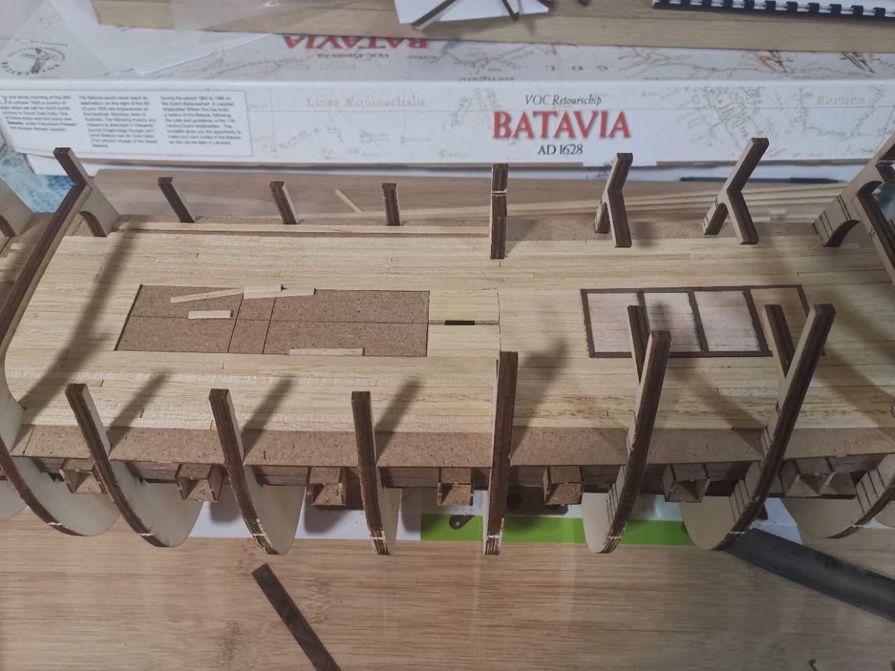

    Still keeping the planking in mind, the bow section is filled with balsa blocks which are then shaped into the correct form to assist when planking. Below the false deck this is easy, but above the false deck the balsa blocks do three things: 1. They also assist with the shape of the bow; 2. They form the floor on which the planking in front of the luizenplecht is done and 3. they provide the correct height for the front wand of the luizenplecht.
    I thought it was a good idea to install the bakdek at this stage as I think it will help making the shaping of the balsa blocks at the luizenplecht easier.
    Bakdek sit.

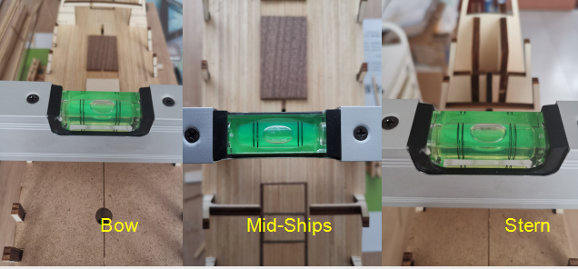

    En om seker te maak daar is mooi eweredige spanning op die spanten het ek oof die stuurplecht dek geplaas. Eintlik moes dit die halfdek gewees het, maar daar is nog te veel afwerking wat op die hoofdek gedoen moet word.
    En laastens net seker gemaak alles is waterpas.
