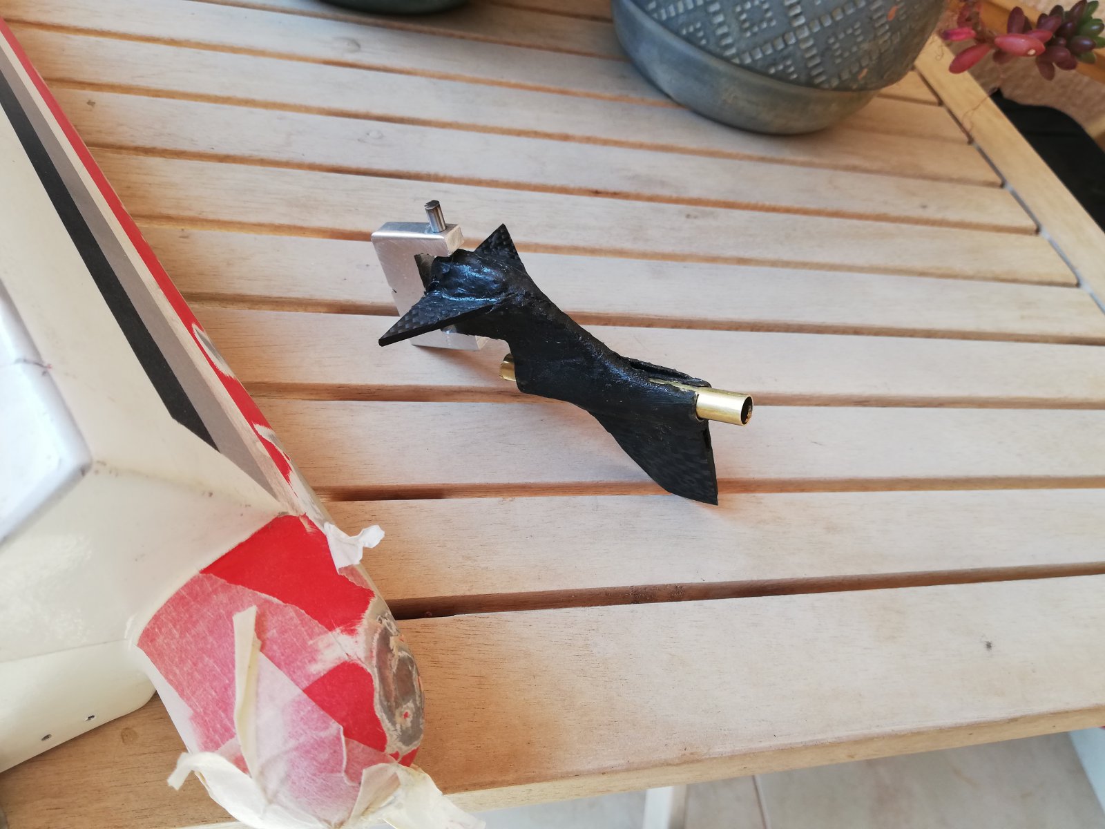

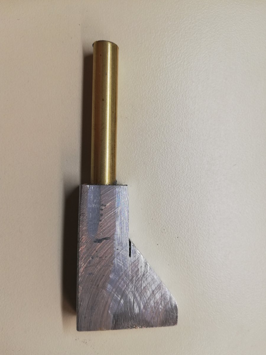

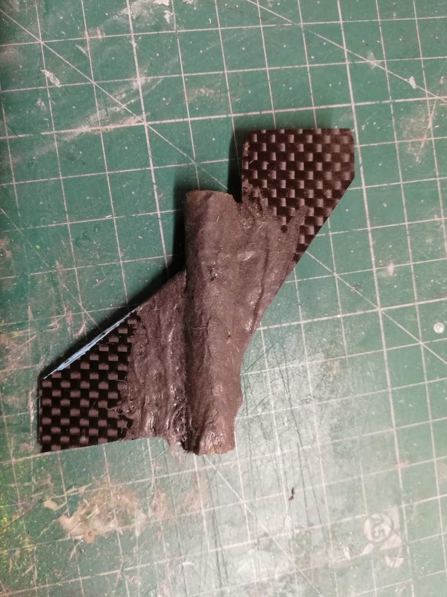

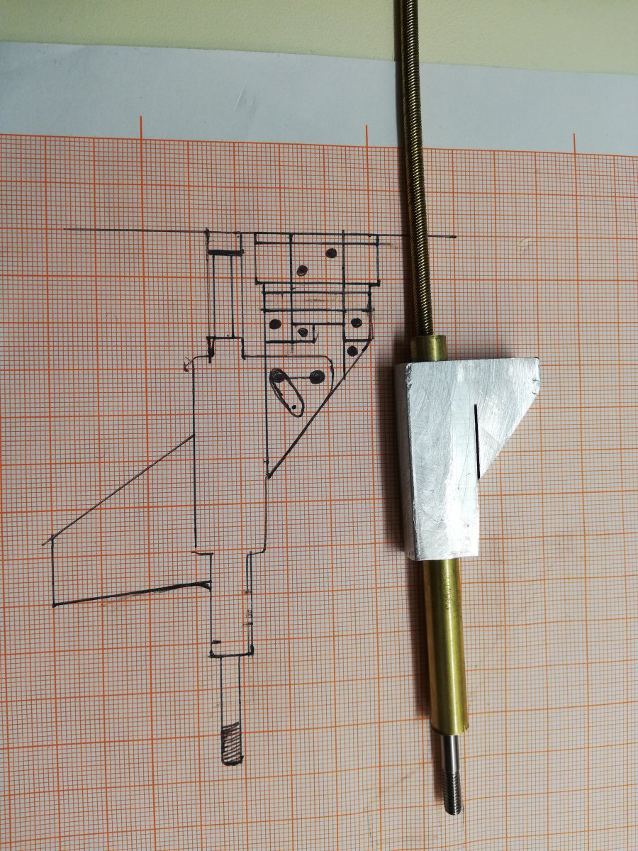

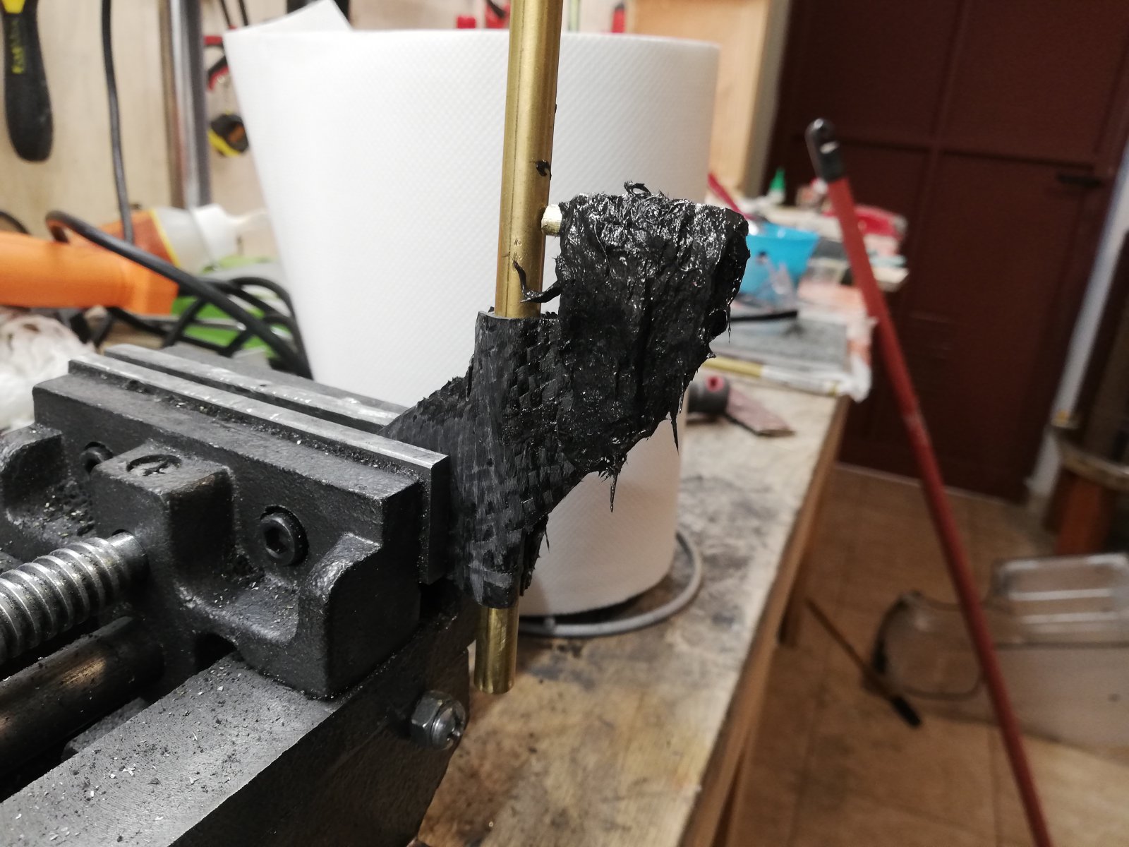

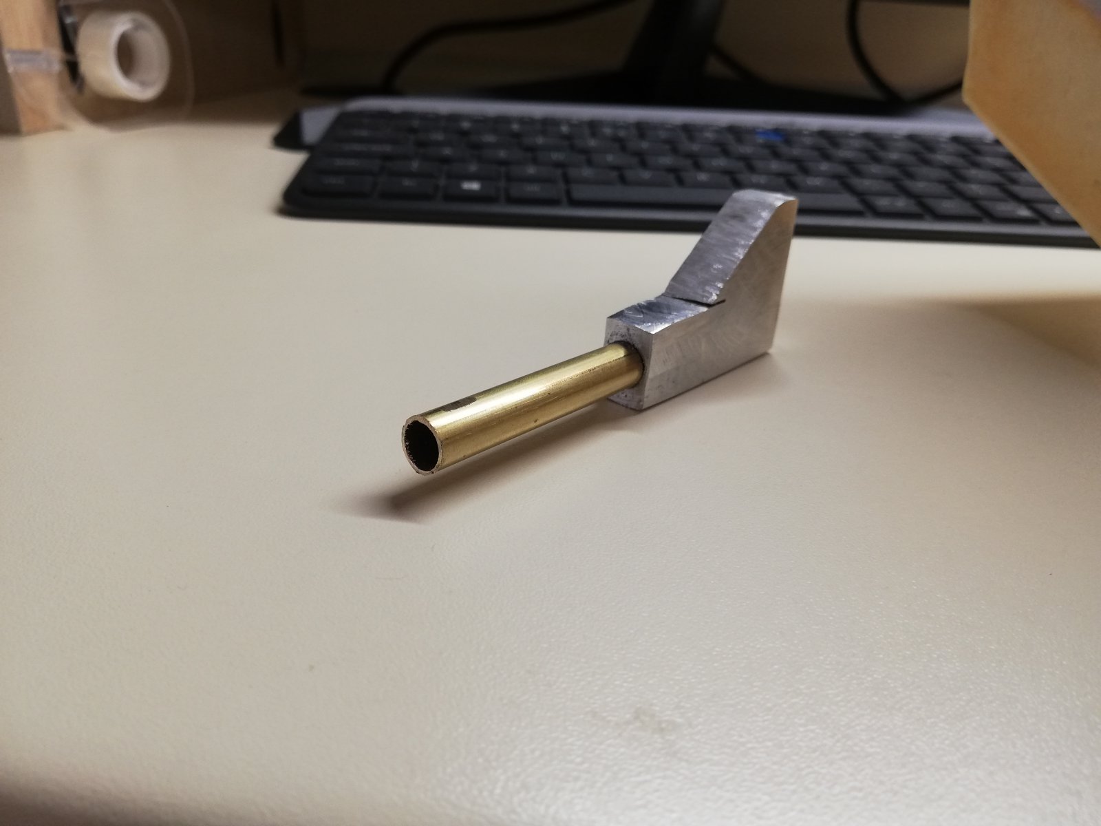

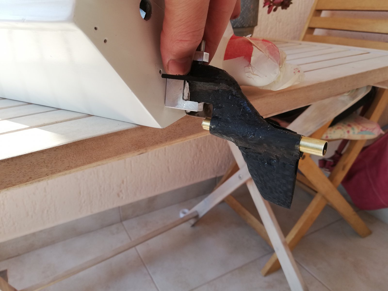

Α first attempt of a DIY stringer drive (or power trim I don t know exactly the terminology)

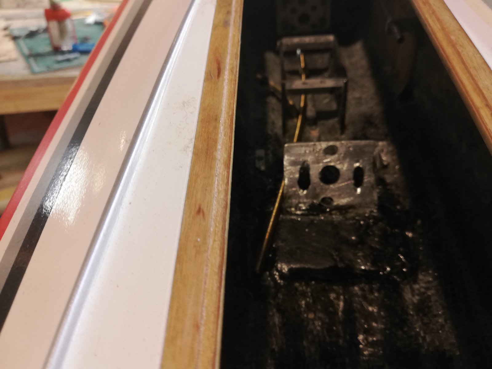

Nice project! Did you still have the bouncing behavior before you decided this rebuild, or did you get that solved?
I guess the flex shaft will come out of the transom and runs bare to the steerable part you just made?
Thank you Jan!

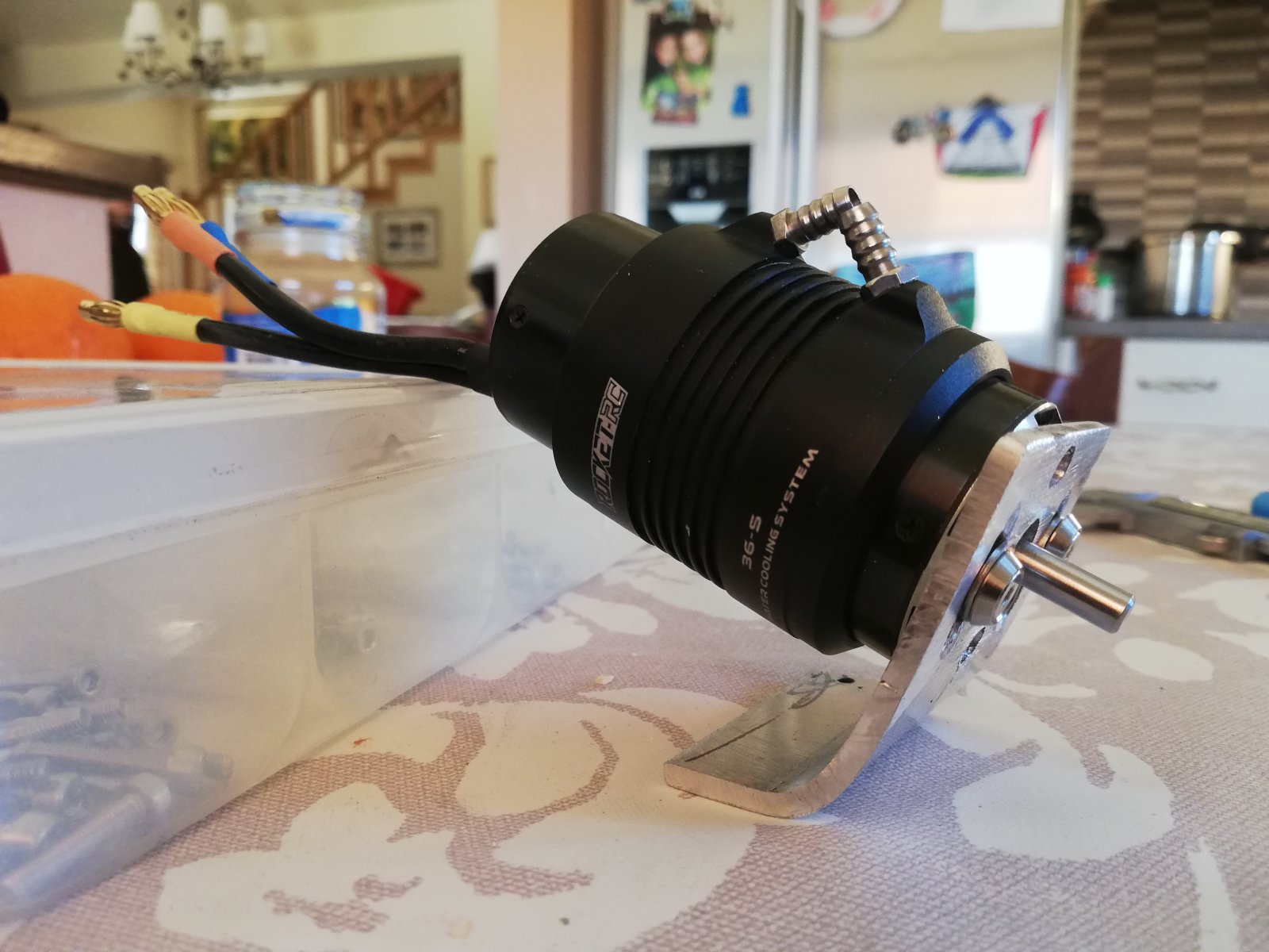

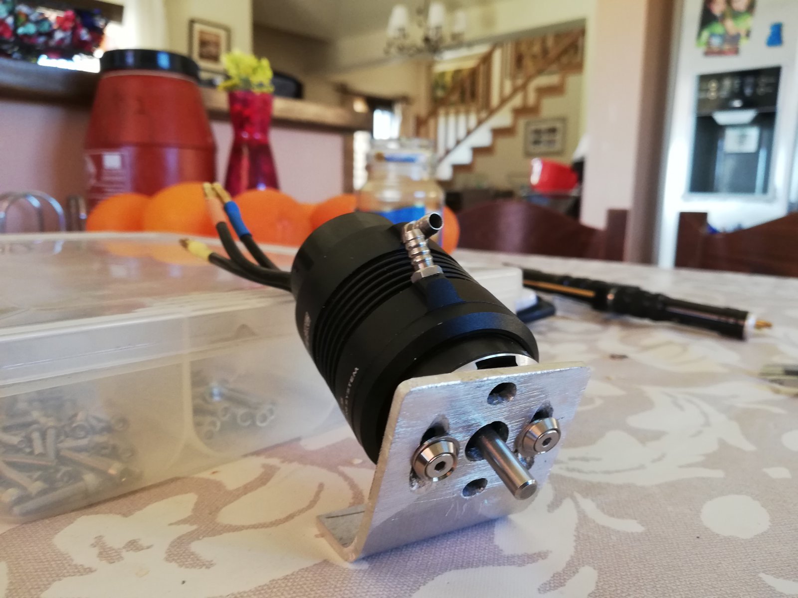

I did solve the bouncing problem by moving the battery way forward. But then the hull run very wet even in full throttle. Moreover, the hull seemed to lean a lot during turns.
I think that lowering the cog would help the sailing behavior plus a bigger motor will give this loose sailing that I couldn t achieve with the 2960 motor of the outboard.
Exactly! Just like the "fake" look alike MHZ outboards.
