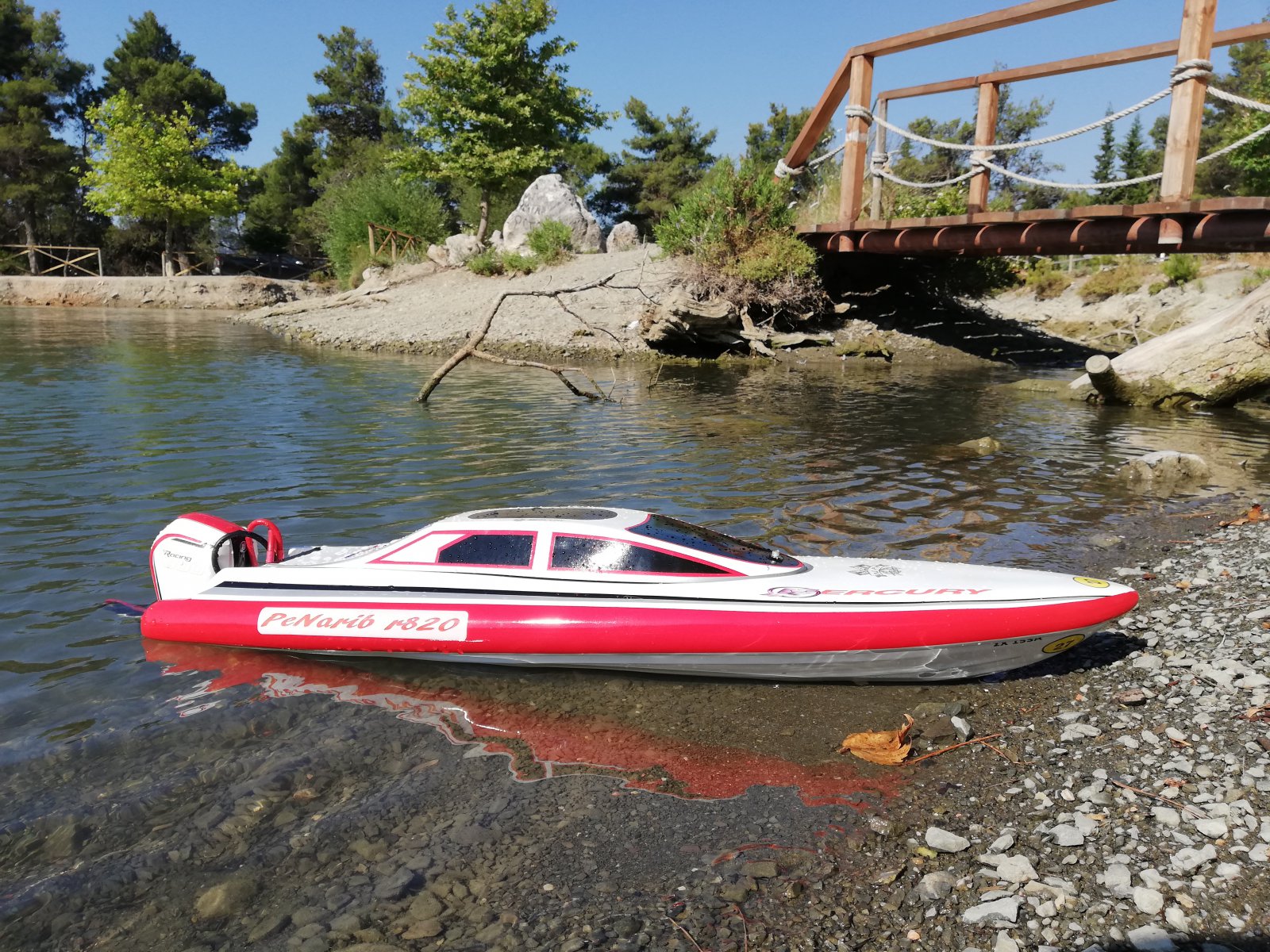

Well guys the maiden sail was successful and I am overall satisfied. However, I think that there is a lot of work to do with the set up of boat and there was also an unlucky moment... :confused:...
Let's synopsize the most important moments of today's rc sailing.
1. I really enjoyed the looks of the boat.

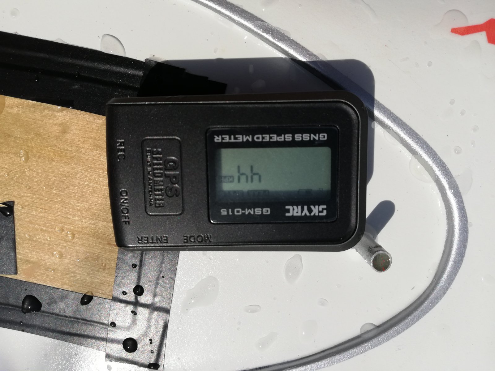

2. I am very satisfied with the top speed 44 km/h with only 75%-80% of the throttle because of the very bad spot, as you see in the video, the wavy water and the instability of the hull in high rpms due to propeller torque. I need flaps or turn fins? Any other recommendations guys?
3. The outboard and and the watercooling system worked perfectly. Especially the outboard seems to work smoothly transmitting the power of the motor flawlessly...
4. As I said the spot was terrible (we didn't go to the standard location due to a fisherman) and a wood hurted the hull
5. The videos do not show the big picture of the overall sailing behavior but they give you an idea.
Any recommendations on the set up from the experts are more than welcome:)

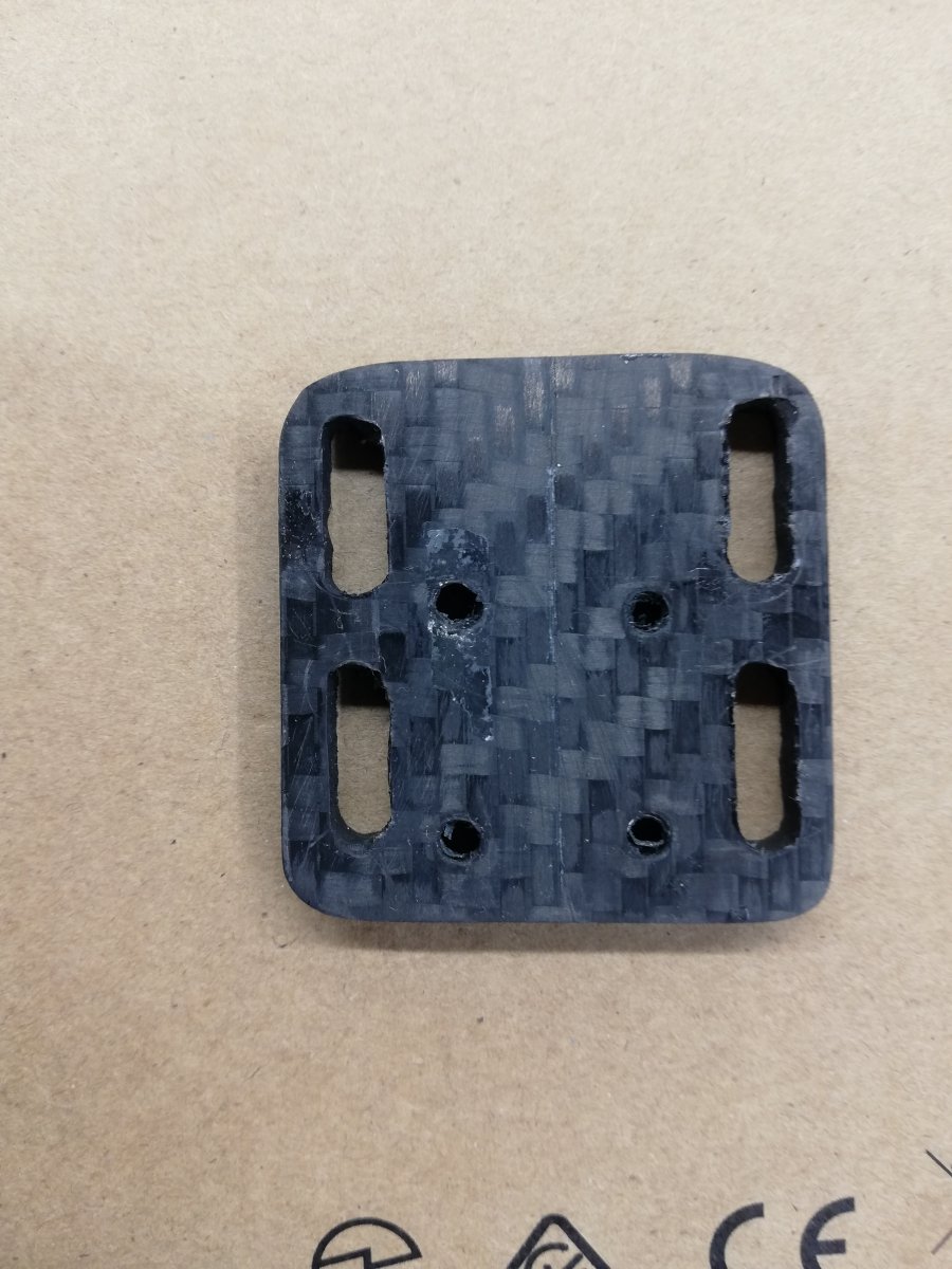

I also thought of constructing a new mounting plate for the outboard so as to be able to mount the outboard somewhat (1 - 3 mm) to the right to offset the prop torque.

Regarding the location, this is the nearest lake to my house and we usually go to another spot few meters away much more suitable for rc boats. Unfortunately today a fisherman had taken the place... :cool:

Congrats Dim! For a maiden run it is not bad! But the lake is far from ideal, with al those weeds. You cannot really run a speedboat there [emoji85]

Great result on the outboard and already you got 44km/h with short bursts of throttle! I guess 60-70 km/h could be reached quite easily.

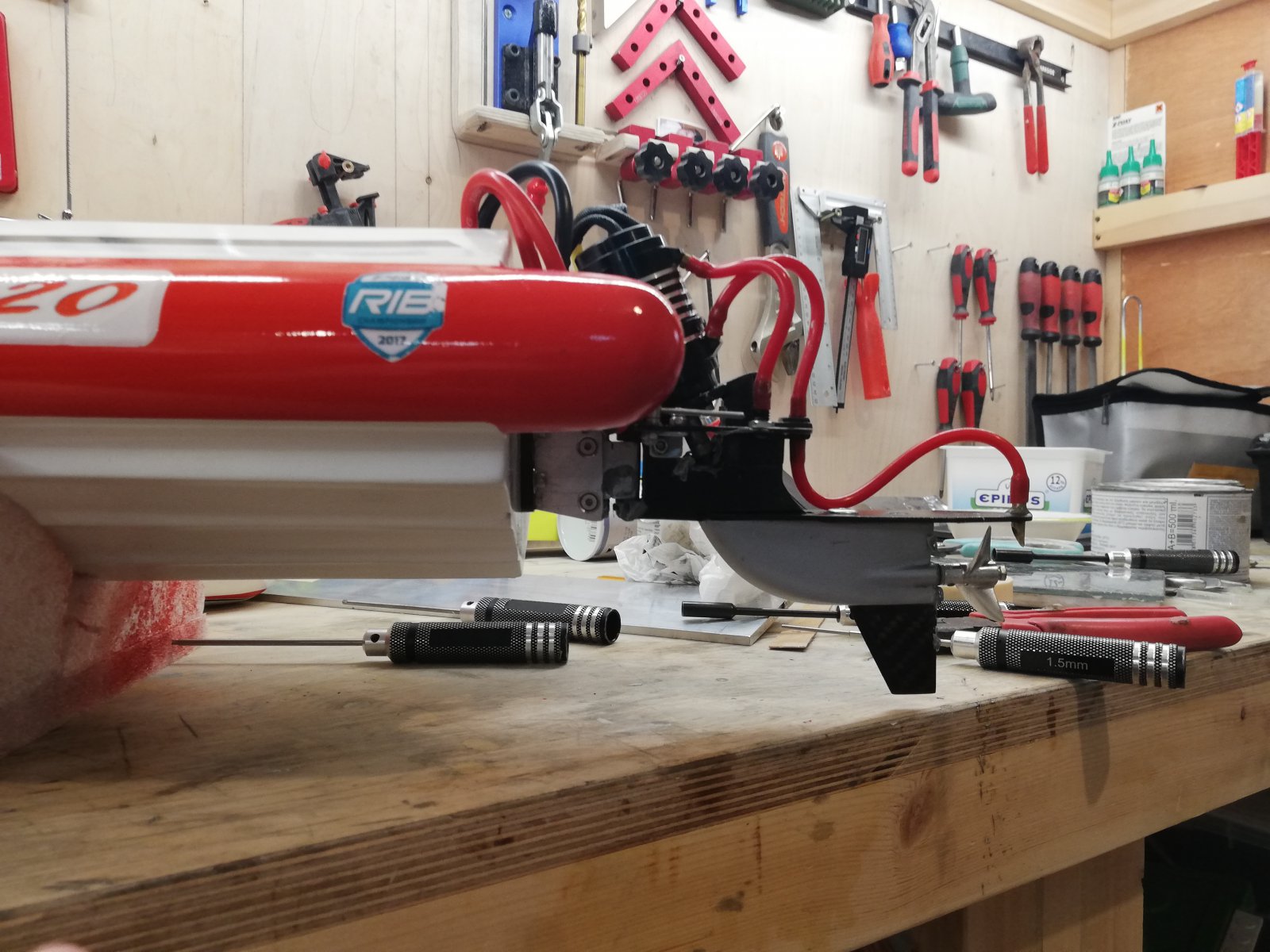

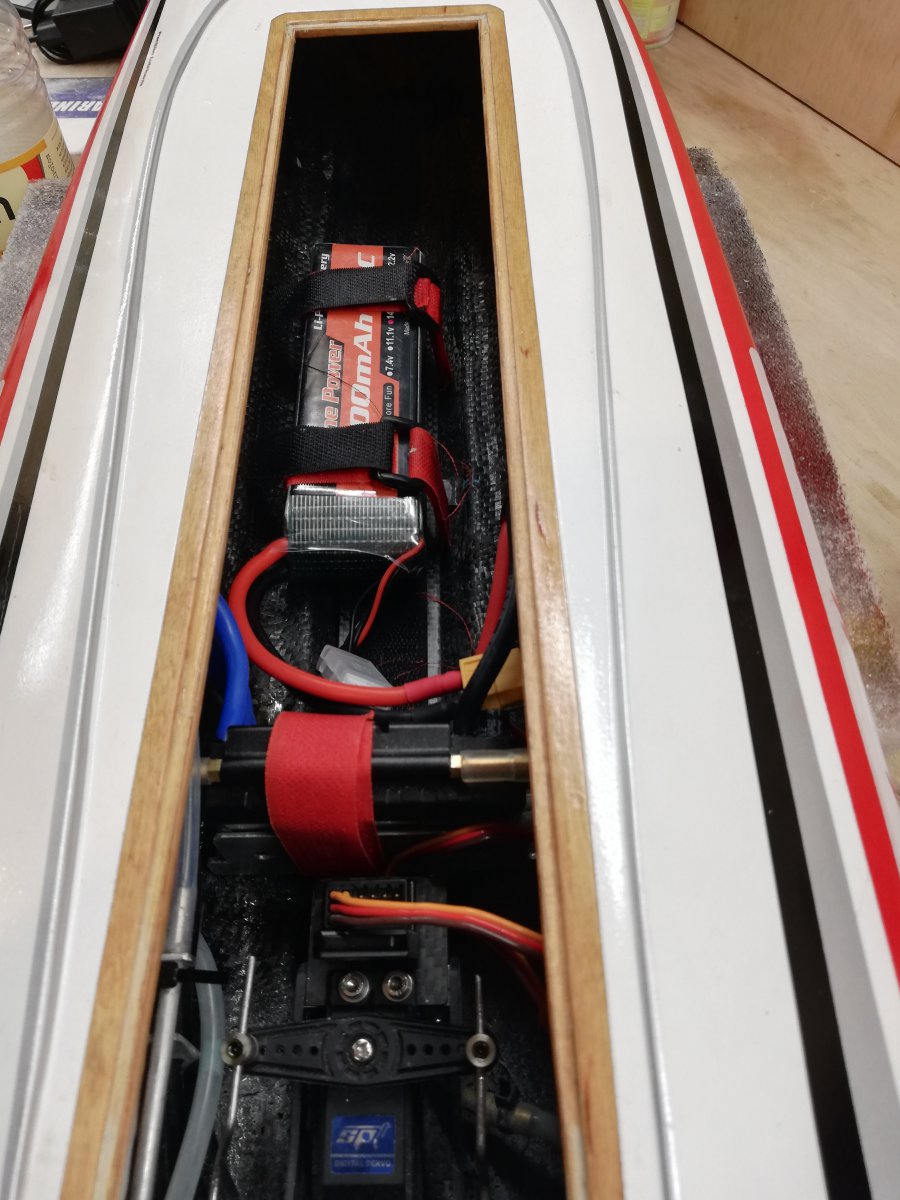

Let's start with the changes I made with the set up to offset the propeller torque: (a) I moved the battery forward and to the left (b) I also moved the outboard to the right after trimming the mounting plate.
Regarding the height and the trimming of the outboard you can get an idea from the following picture:
Now regarding the sailing itself as you will see in the video below the boat is very jumpy and instable at high rpms. I tried even more trimming but then the boat tended to tip over more easily. I also reduced the height of the outboard without any significant result.
I will proceed with some (or all :D) of the following changes in the set up:
a) move the battery even more towards the bow, b) use smaller (35mm instead of 36mm) propeller c) add some weight to the kneel to lower the center of gravity d) use trimm tabs e) replace the horizontal plate of the outboard with a wider one. I ve already ordered the following very nice trim tabs:
The outboard seems to work perfectly and I feel that it has much more to give in terms of speed.

Yes Michael it is a very nice pond up to the mountain Parnitha near Athens and close to my home (10 minutes by car). Unfortunately a large portion of the wild forest there was burned down by a wildfire last summer.

Great spot and now it's much more clear to see the hull performance. From what I can see, you need a couple degrees down angle on the outboard. If you push the throttle, the boat almost jumps out of the water.
I agree on that Jan for sure.;)

The height of the prop axle seems level with the bottom of the hull. That should basically be fine to start with. Maybe a little higher after fine-tuning. If you angle down, the prop will sit lower again. I would raise the prop axle to be level with the hull bottom again.
Here's a photo of the angle I'm running on my 152VO Speedliner. It is a flatbottom, so different hull. But just for referene; some hulls need quite a lot of down trim to run well!
Regarding the outboard behind a Cozy T800, it could work. It would definitely move, but my feeling is it is on the small side. Some guys, like Alex on his WSB Tunnel, even run 40 size motors.
You already have the motor. Just build a T800 and you will find out [emoji28]
Oh thanks Jan for the photo!
This is some serious trimming. Let's see what angle will be the optimum for the Penarib hull.
