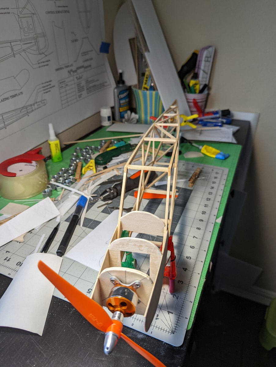

I attach my plane, i have forgottenn how many time i have crashed and how many time i have repaired it. And still does not fly like your. The Savage bobber is my favorite pane and i want to build one that fly.

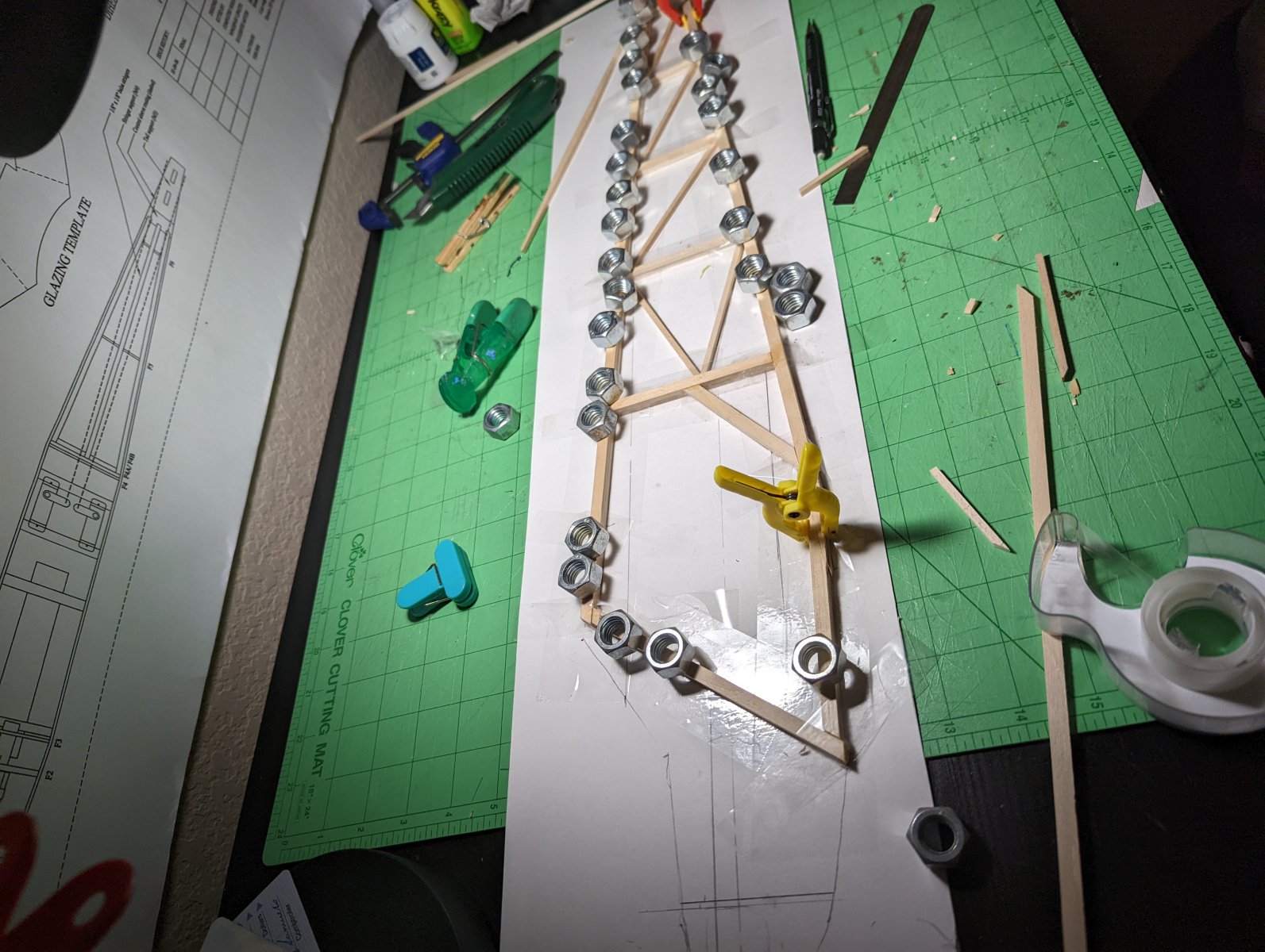

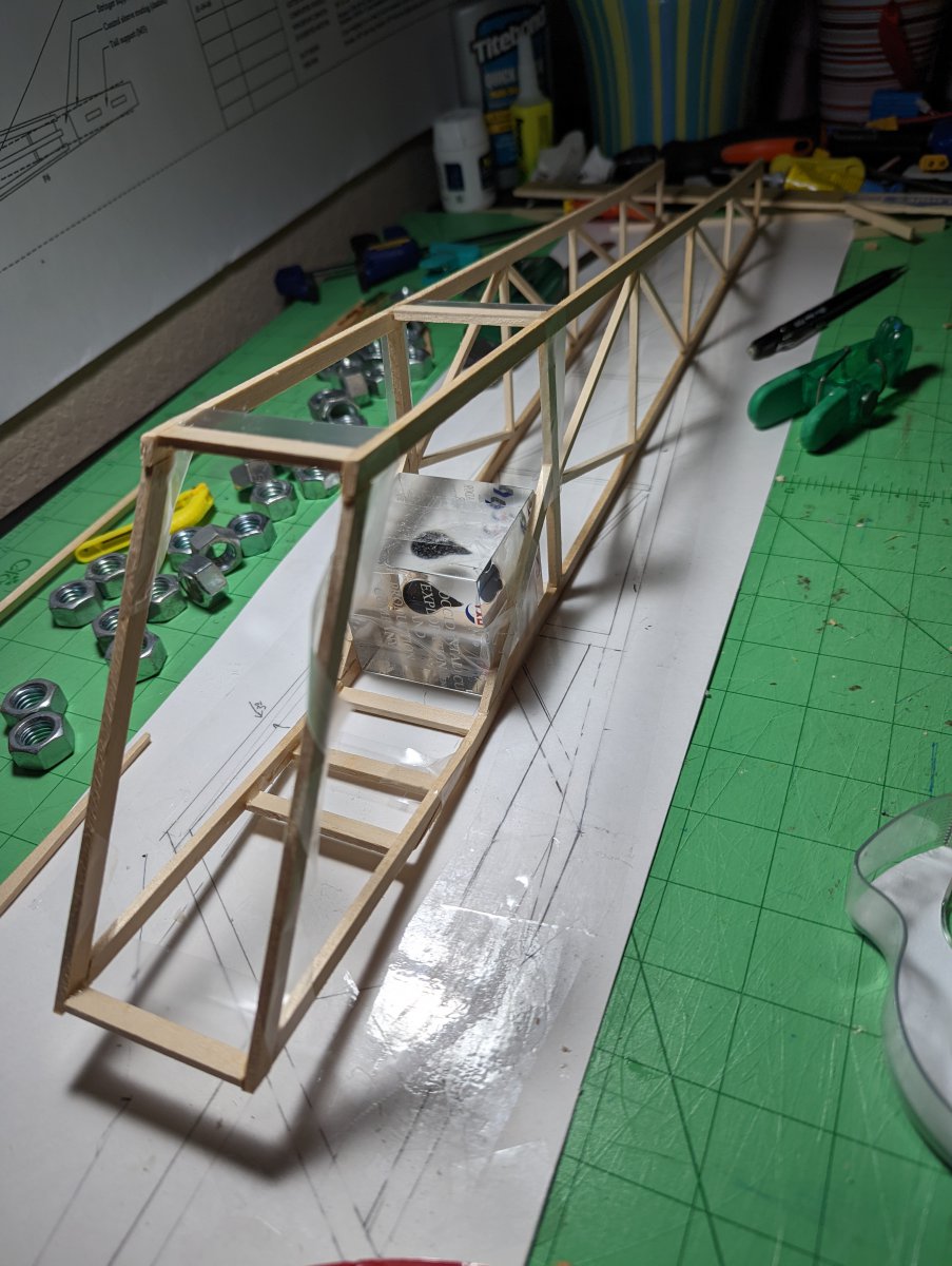

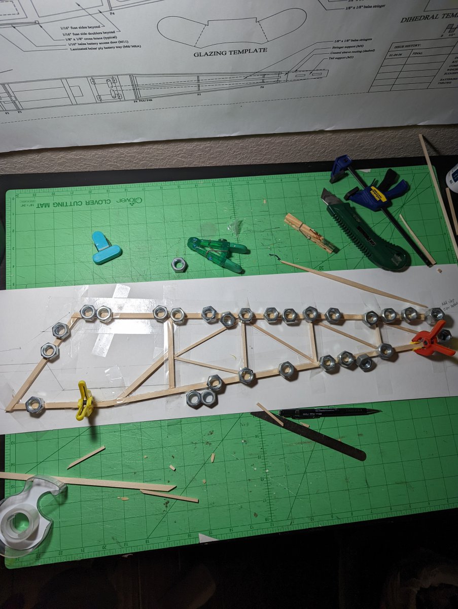

I started my second bobber. However, my experience, my skills and the average 12 mph wind speed in my local park make me to build a heavier than 250 grams model. I do not have an indoor place to fly so I tend to build a bit heavier than 250grams.
I used basswood. Body is about 50grams so far, the motor add about 30grams more.
I have little experience with balsa wings but i have more experience with foam ( sorry ...) so wing and control surfaces will be made on 6mm foam i am expecting to be about 350grams.
I do not know how to proper use AutoCAD for the front formers so i did may curves with curves ruller by hand, they are not great , i may need to do some adjustment later.
I will post more picture later. Thanks for getting me inspired again!!
