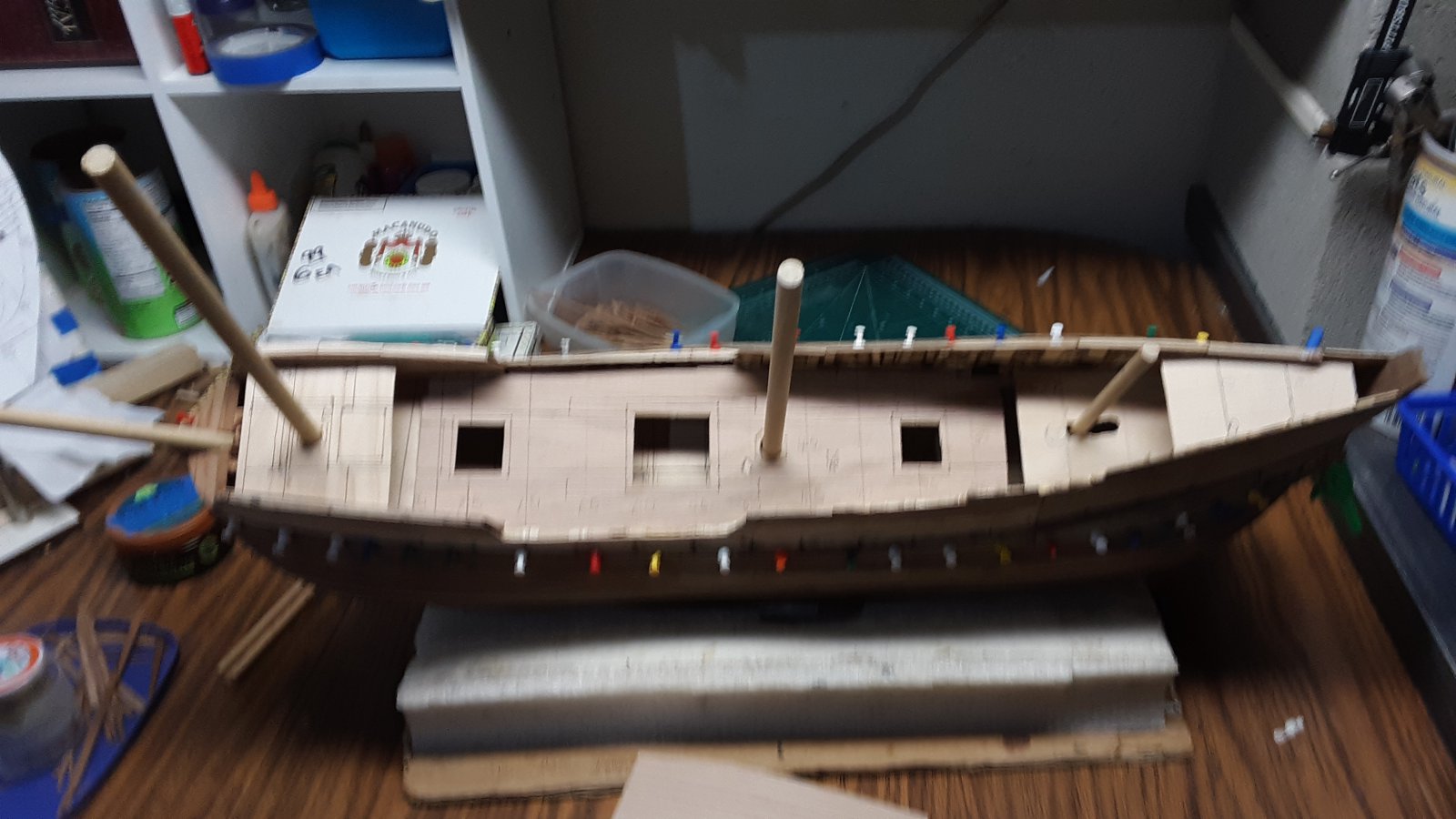

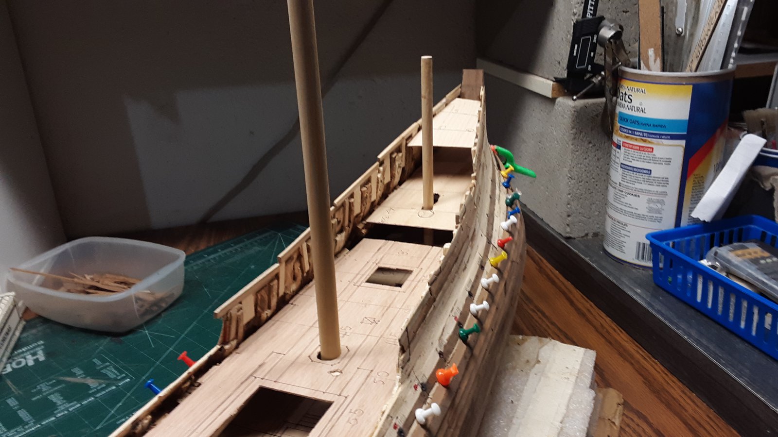

I did some dry fitting of positioning the different decks and masts as this will give me complete picture of what it will look like.

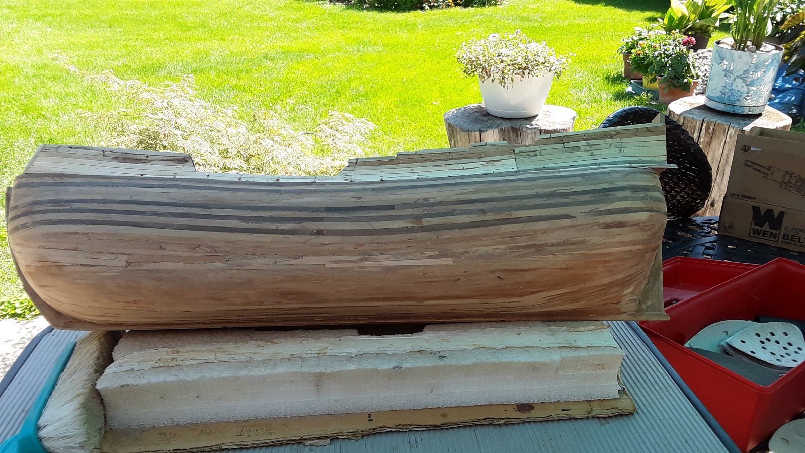

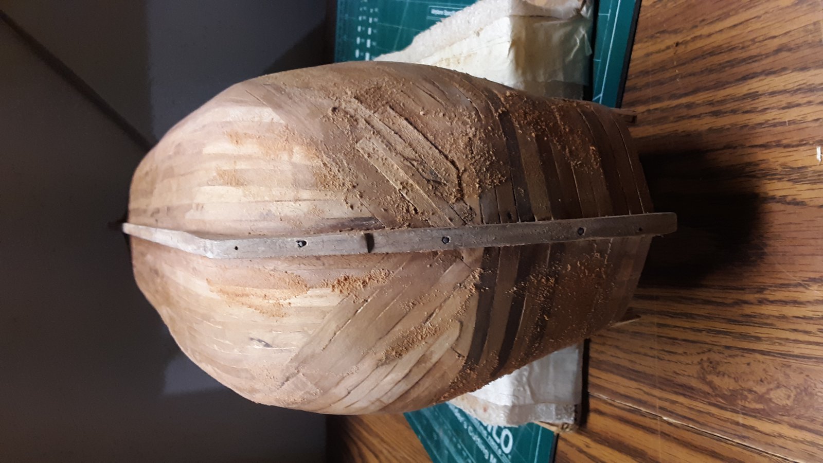

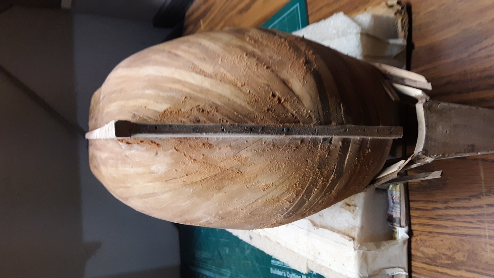

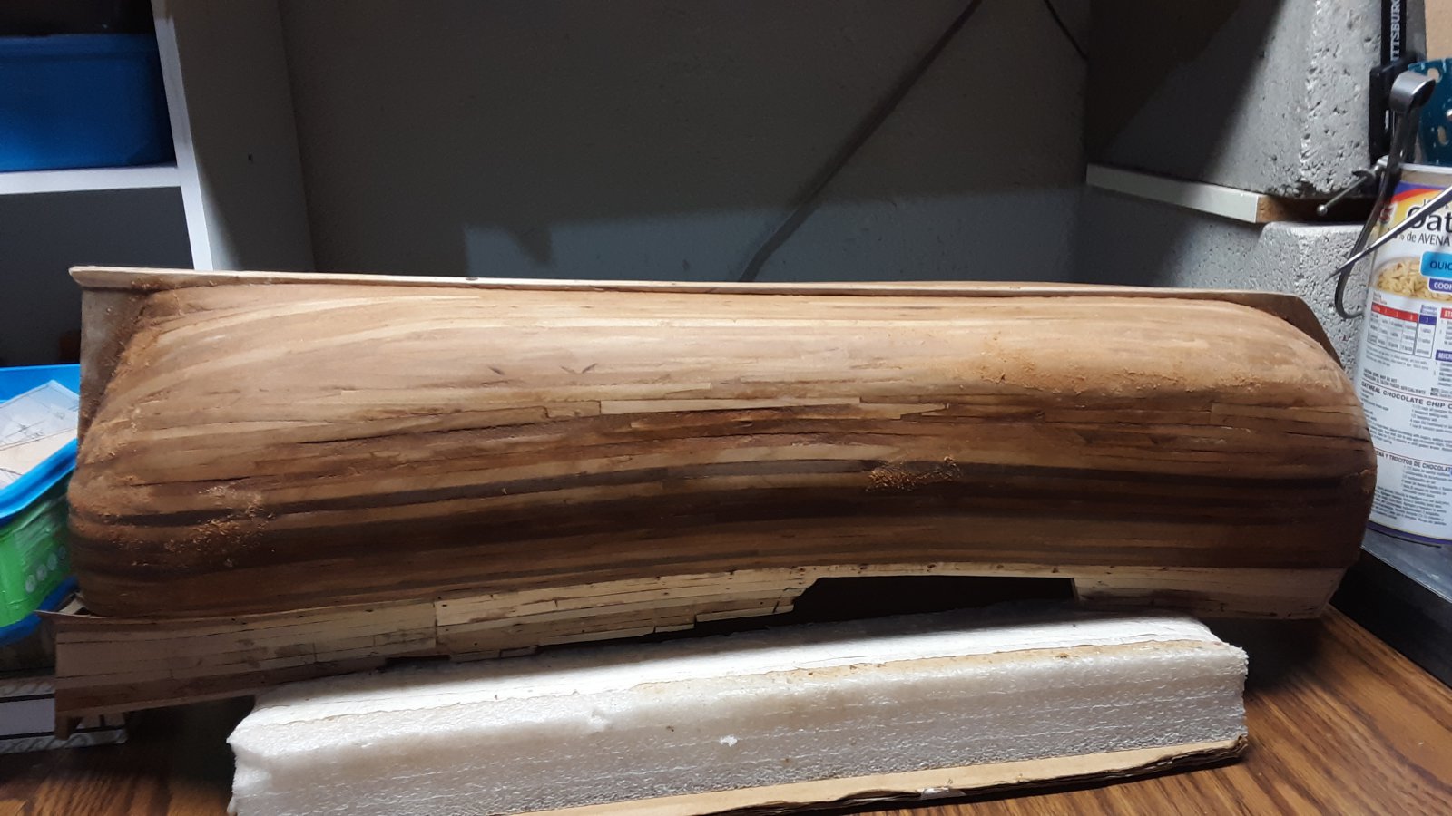

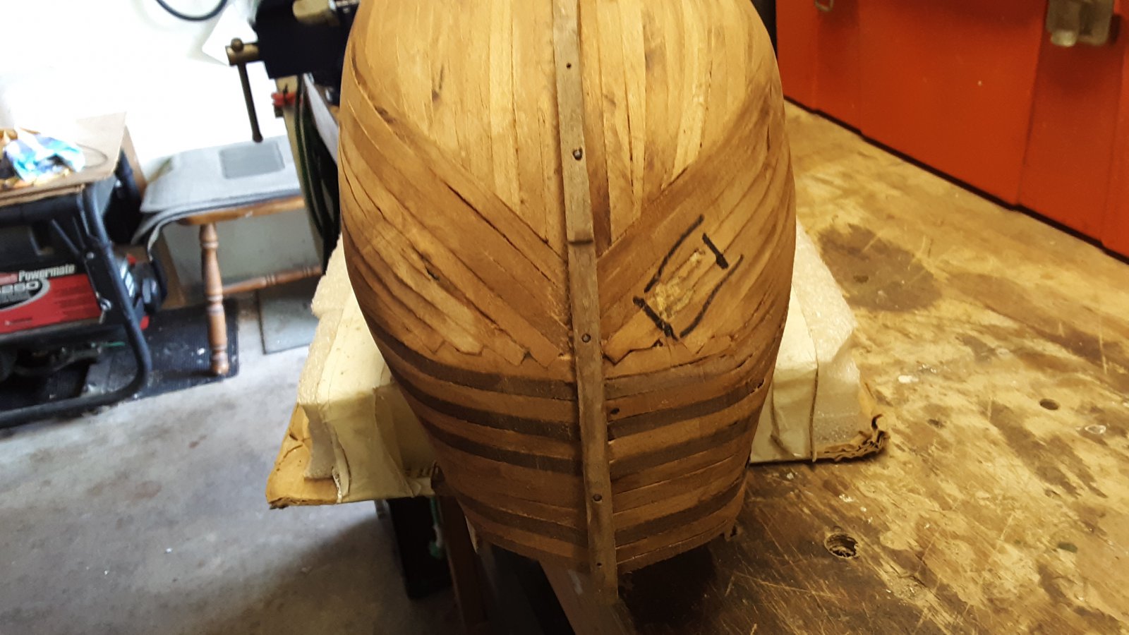

Today wasn't as hot so I decided to do a rough sanding on the part of the hull that has a second layer of planking.
I sand an area and leaving the sawdust on the hull. Then I take a mixture of glue and water and brush this on the hull mixing with the sawdust pressing this in the cracks that are between the planks. I do this until the cracks are eliminated and the hull is smooth.

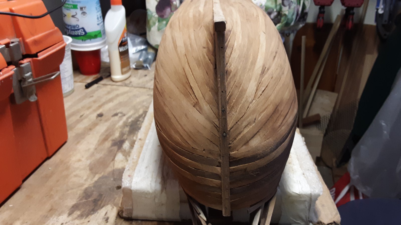

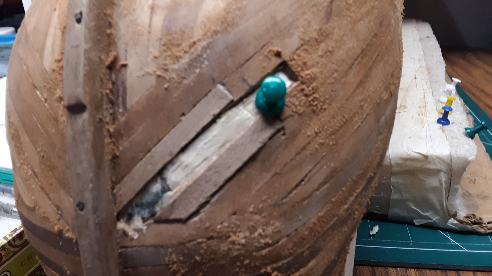

The black square on the bow is where I sanded a bit too much. So I will cut it out and re-plank the area.

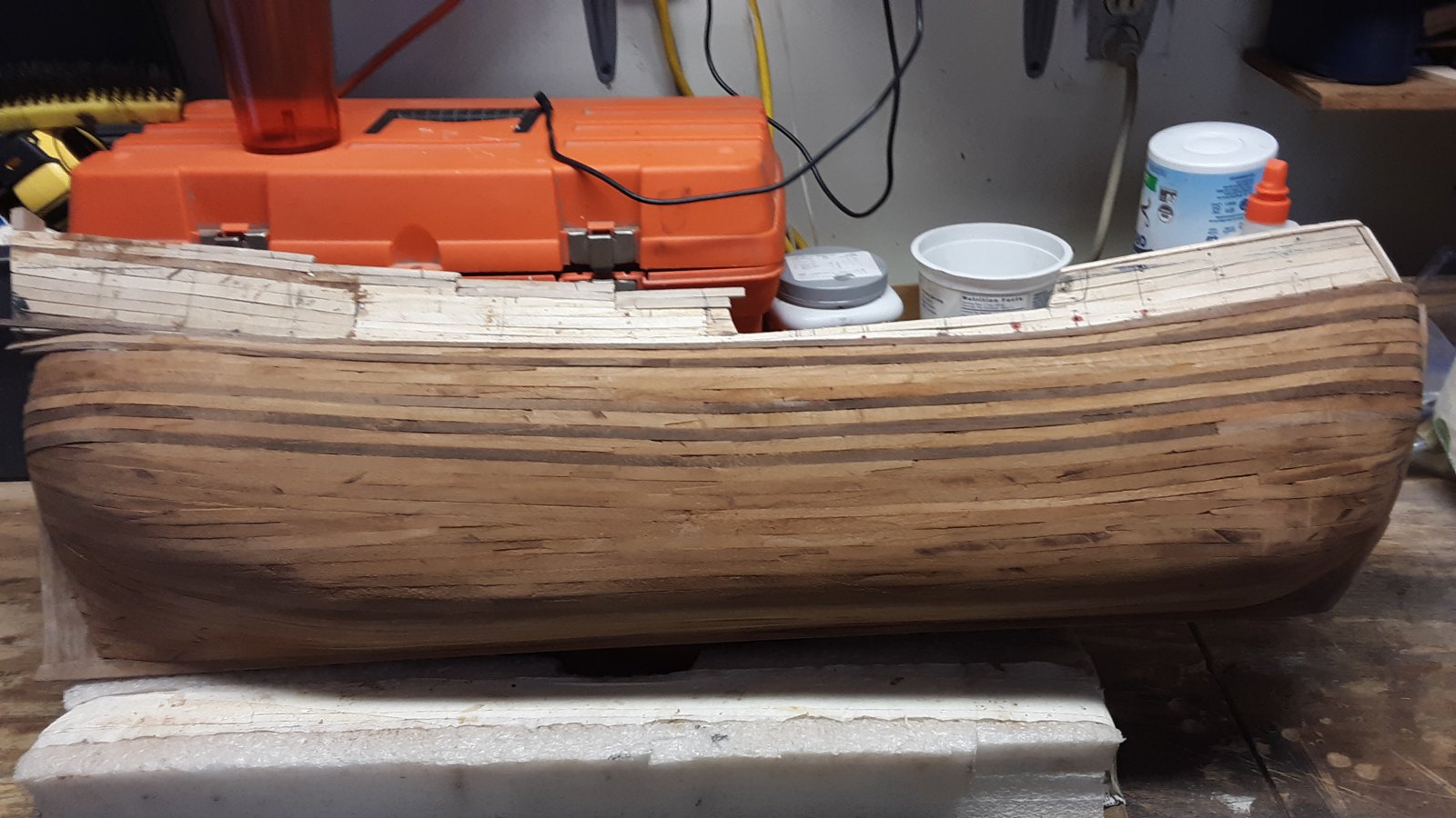

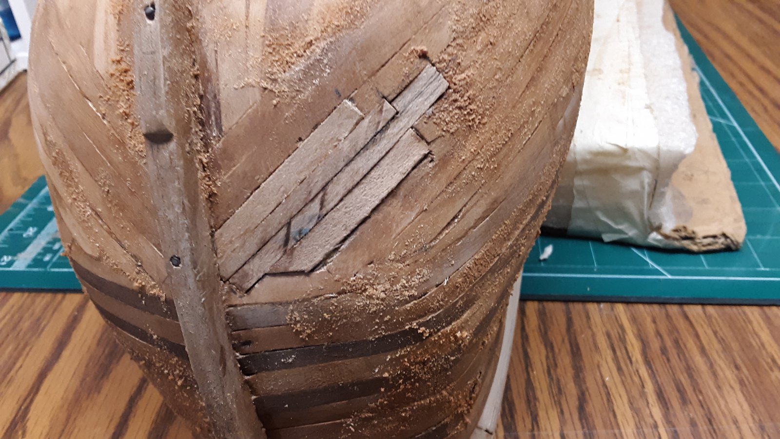

Repaired the bow and added crack filler.

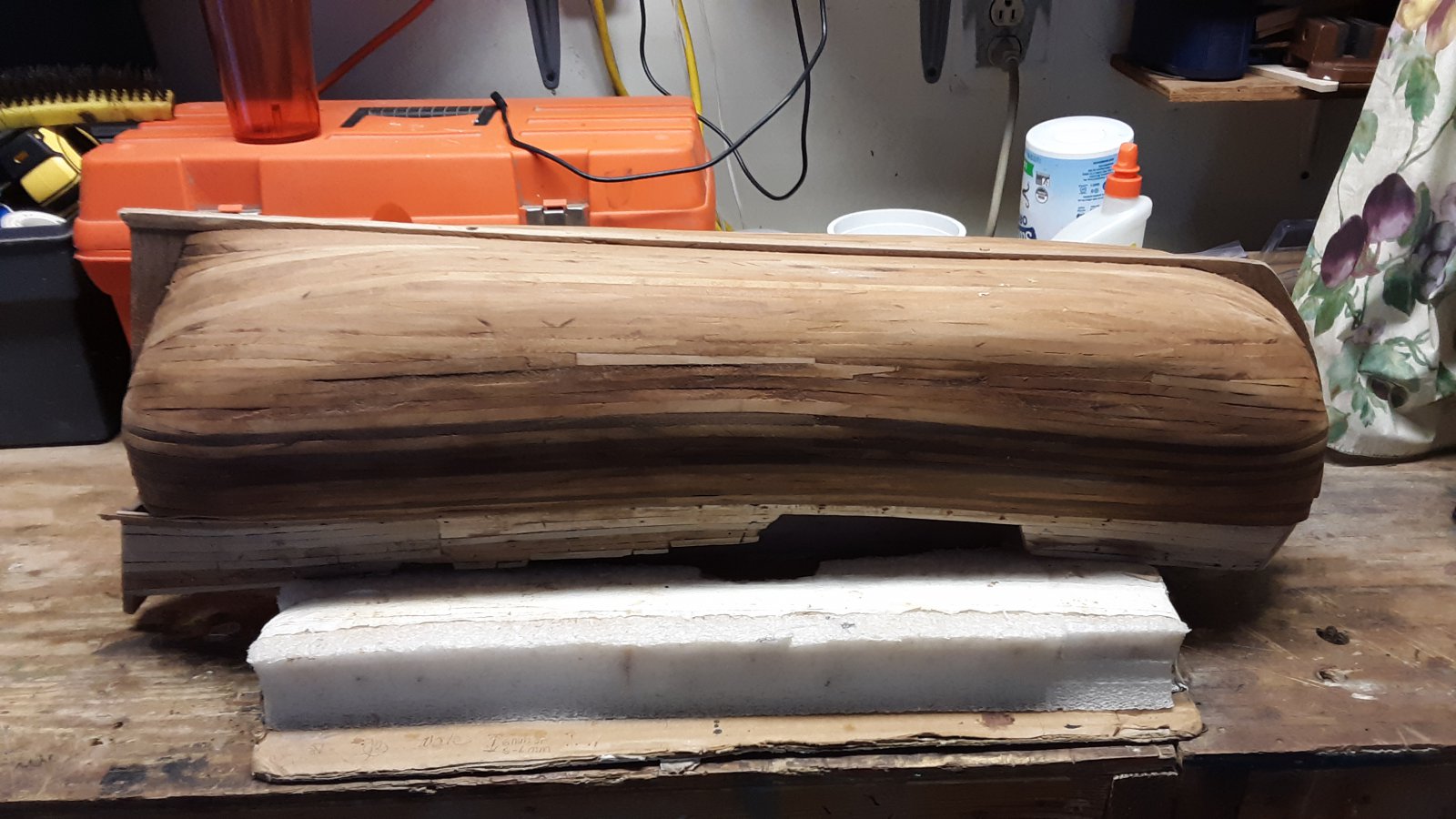

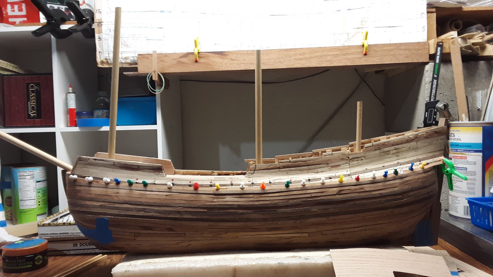

Did a first sanding of the hull, patched the cracks again and will do a second sanding in the next couple of days.
After that, will finish the rest of the planking on the sides of the hull. From looking at all the pictures I have from Fluits this area is clinker built. I will continue to study the books.
