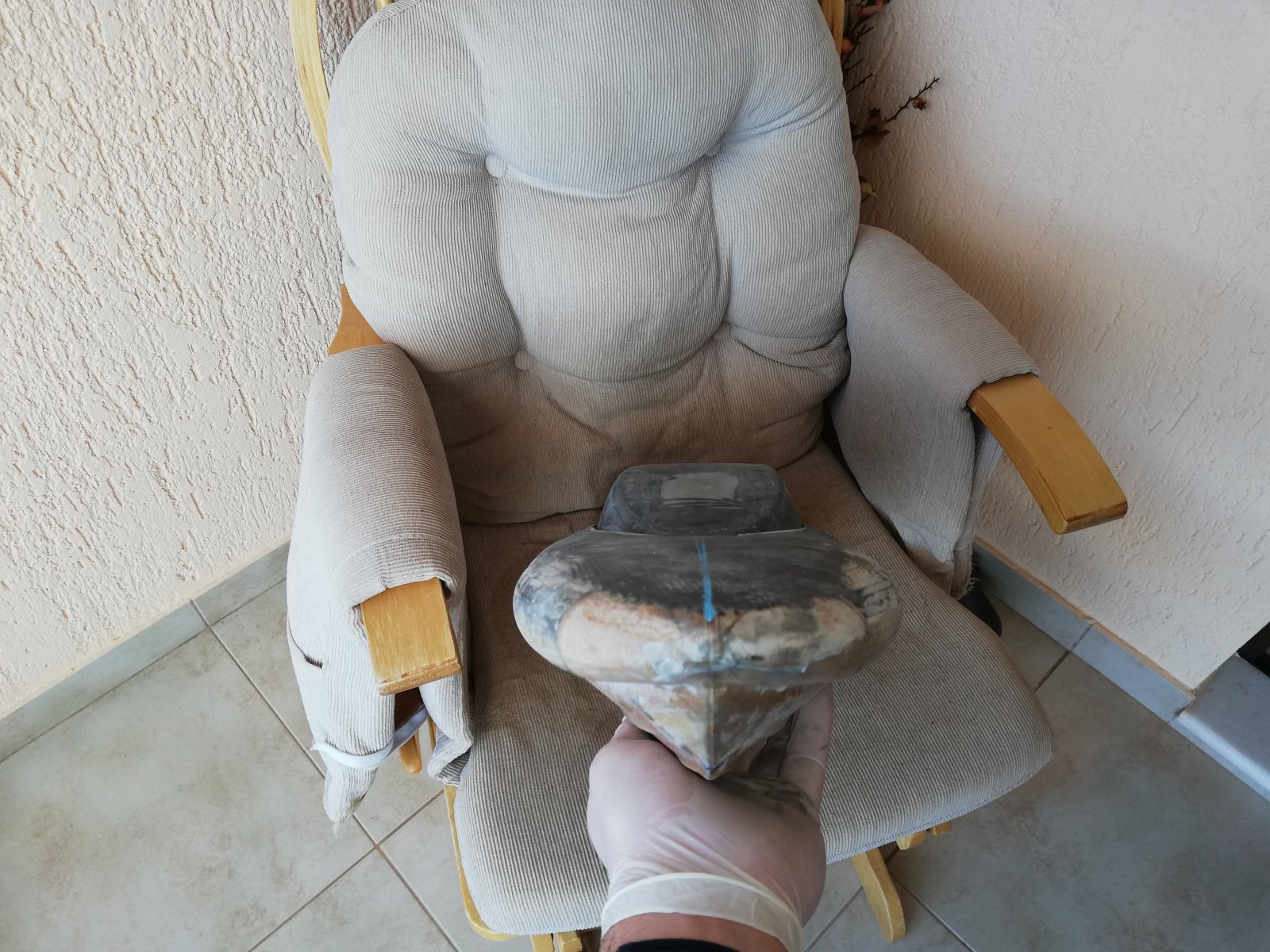

Meanwhile, releaseing was such a success for the first time...
The mold has no damage and the cowl is smooth and super light...

Well done, you know how to make a mould for sure!

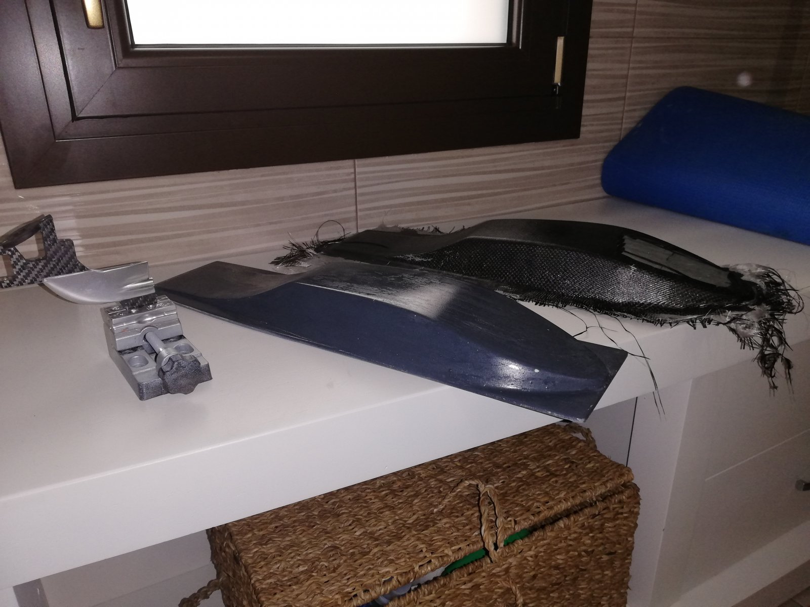

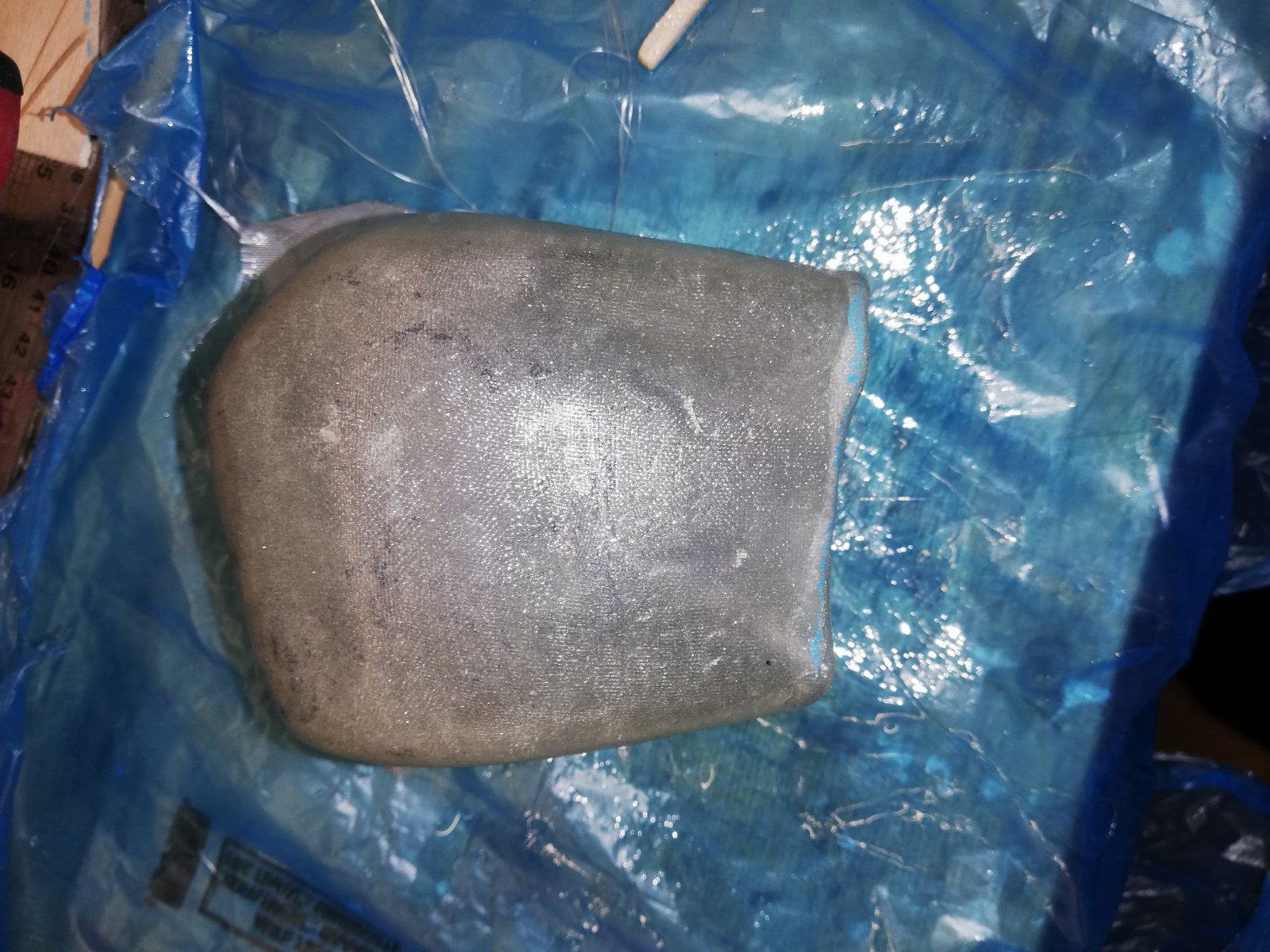

Update #21: outboard cover release.
The release was not that perfect as the cowl but generally was OK.

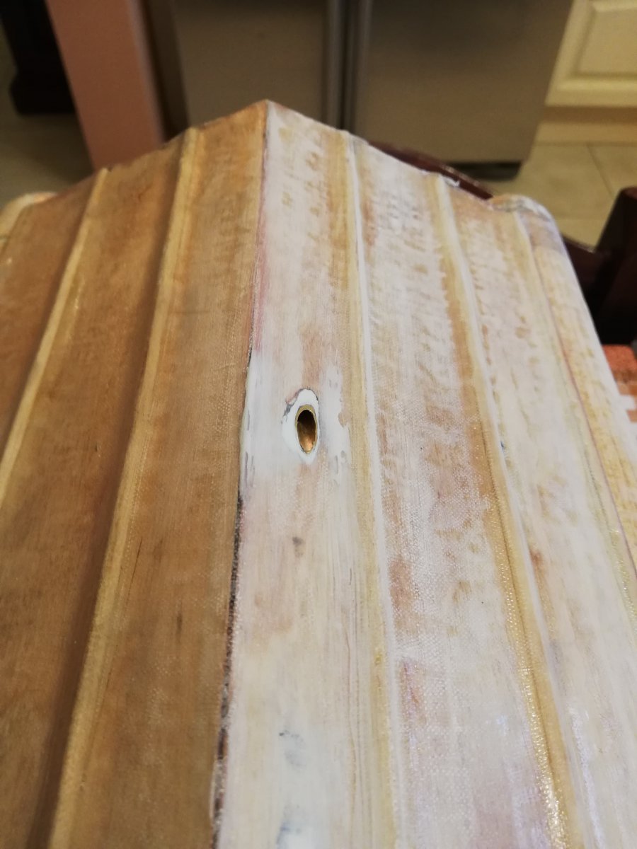

I glued the two halves with CA glue and then I applied 4 layers of 50 gr fiber on the one side. Then sanding and laminating the other side.
I hope you have a nice and productive week.

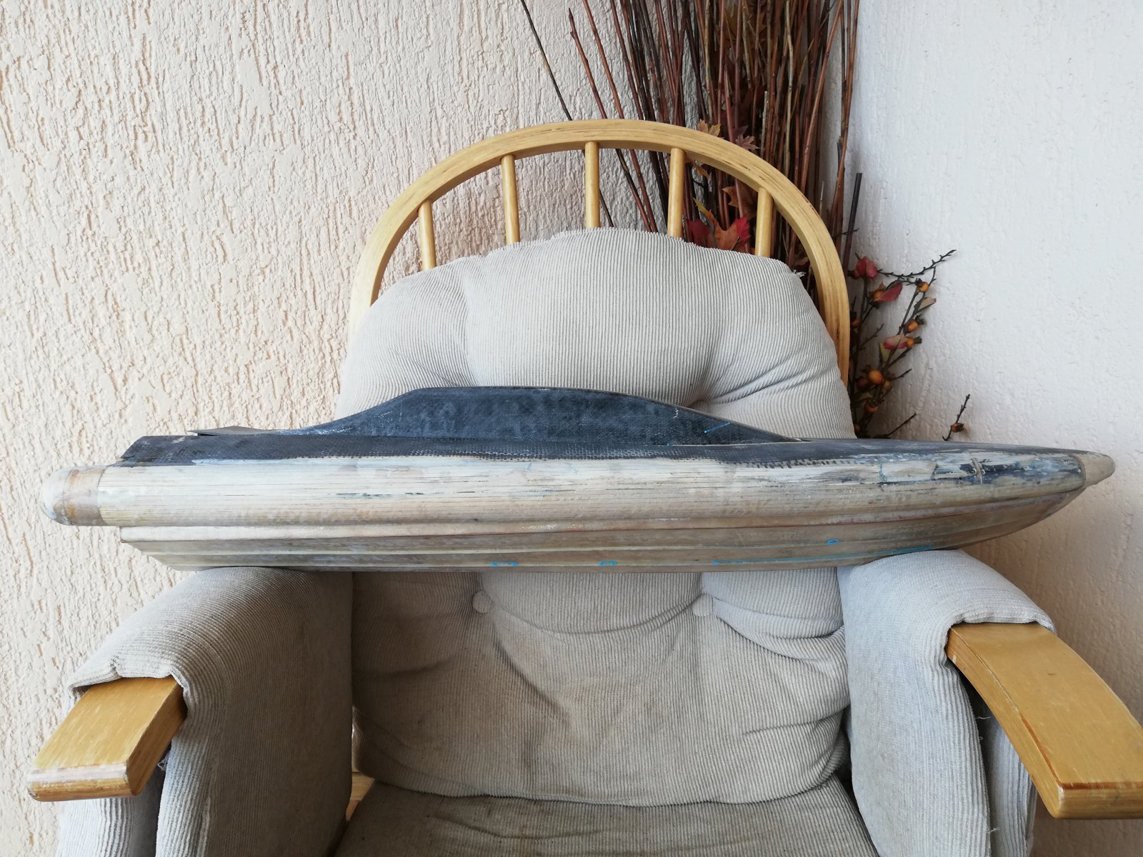

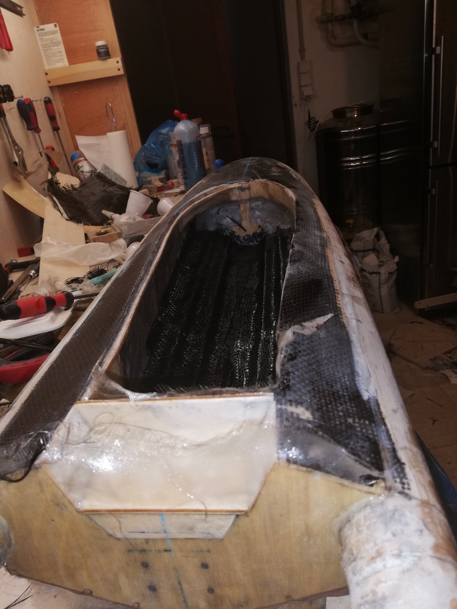

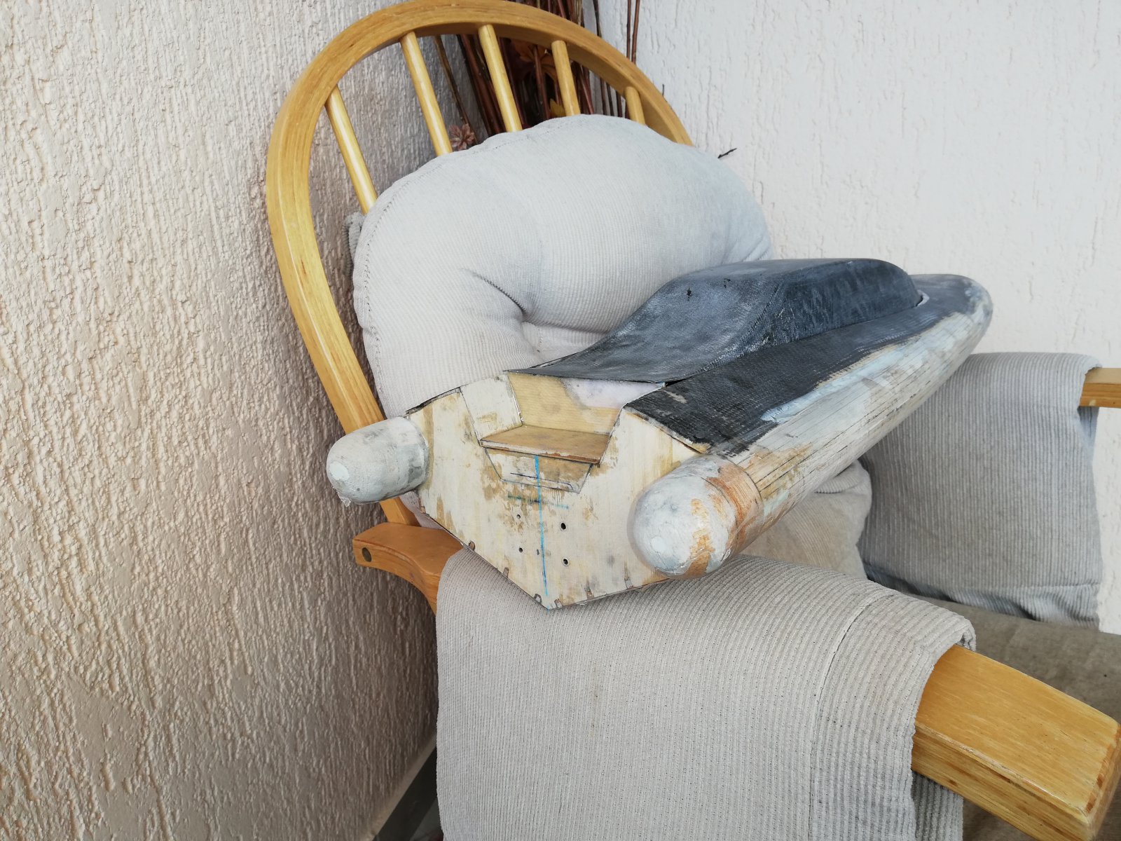

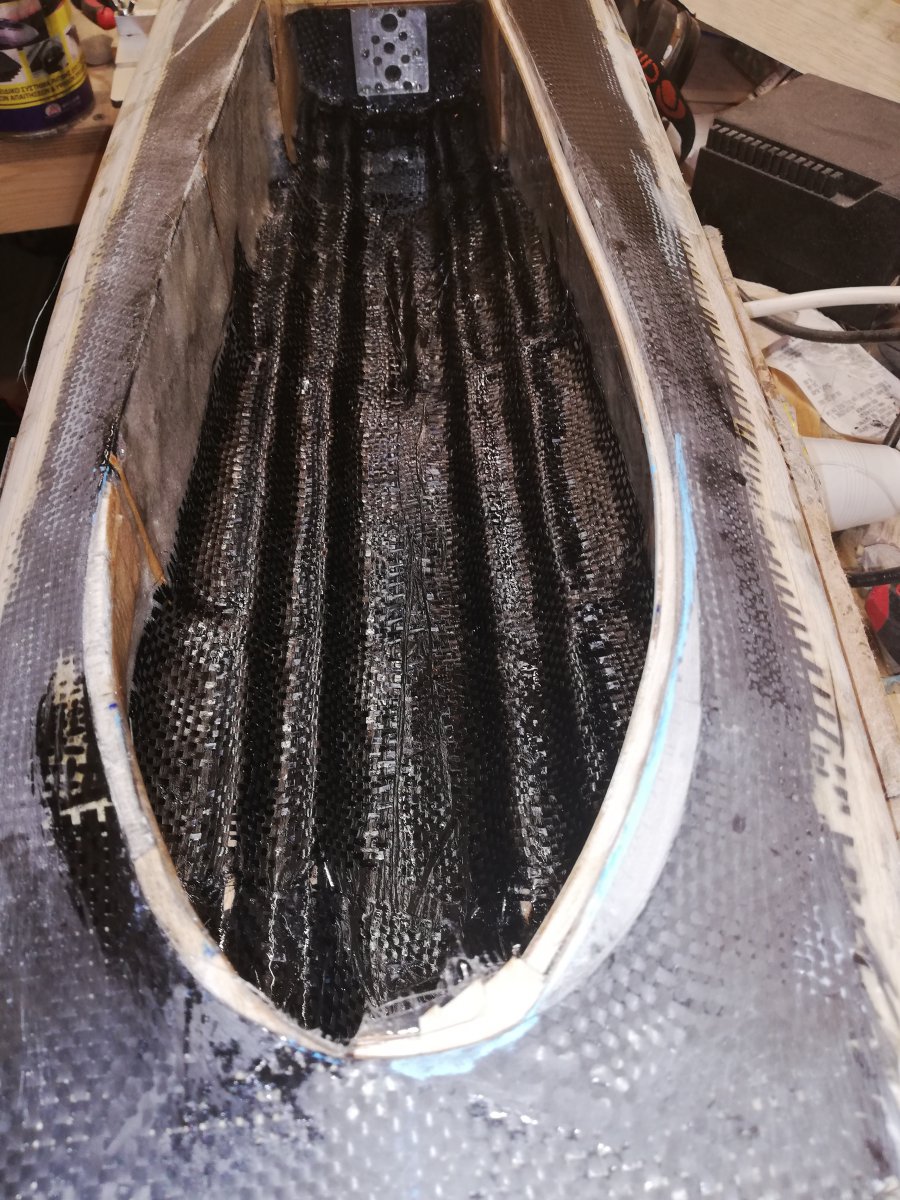

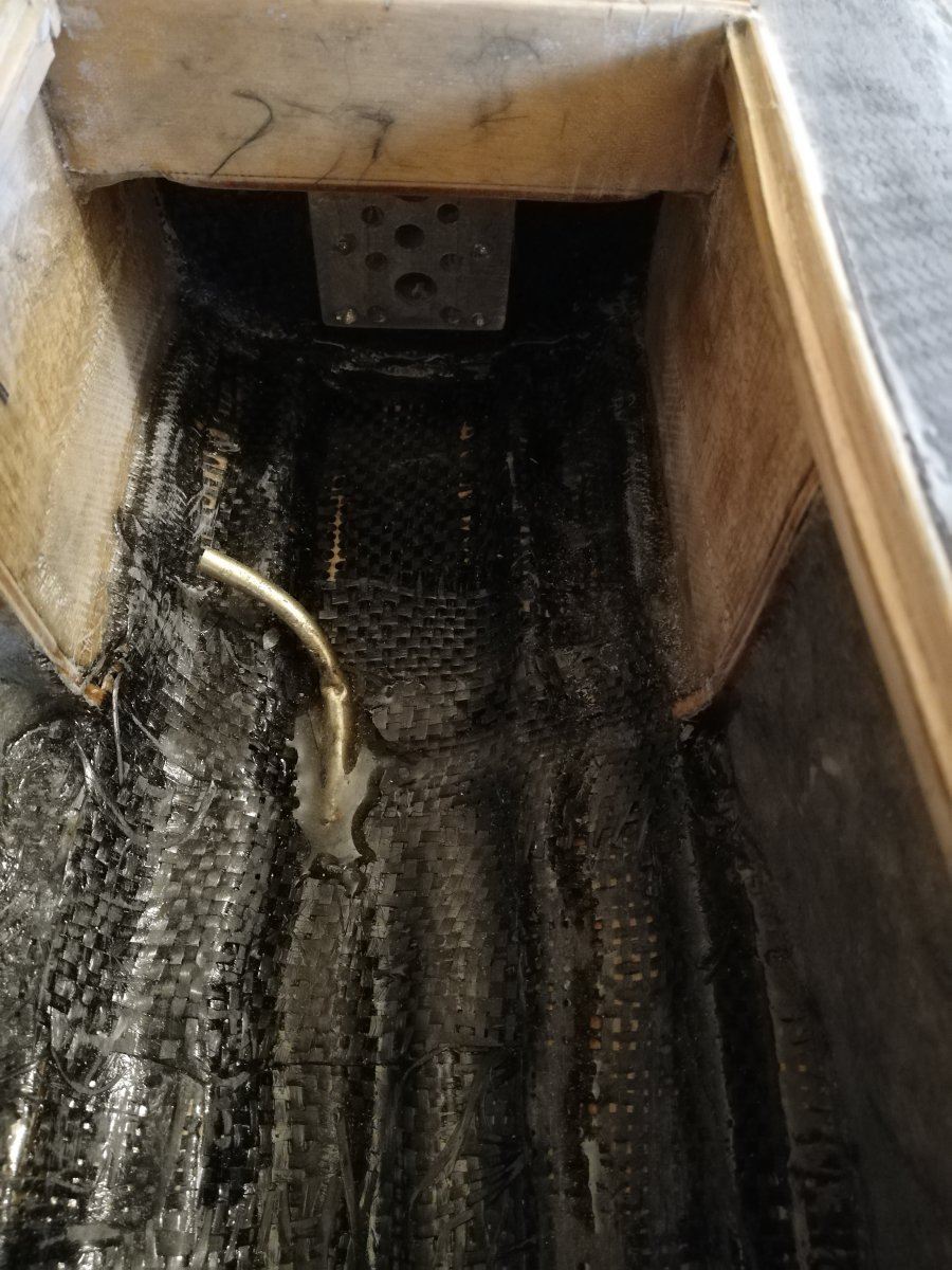

Update #22: Laminating the inner of the hull and the transom.
The bottom with 180gr carbon and the polyertherne at the tubes with one layer of 110 gr fiberglass.
These cf edges are very annoying. How do you stabilize them guys?
I do not like the looks of the laminated polyertherne but it is functional in terms of waterproofing and weighs less than plywood, so, I can live with that ;).

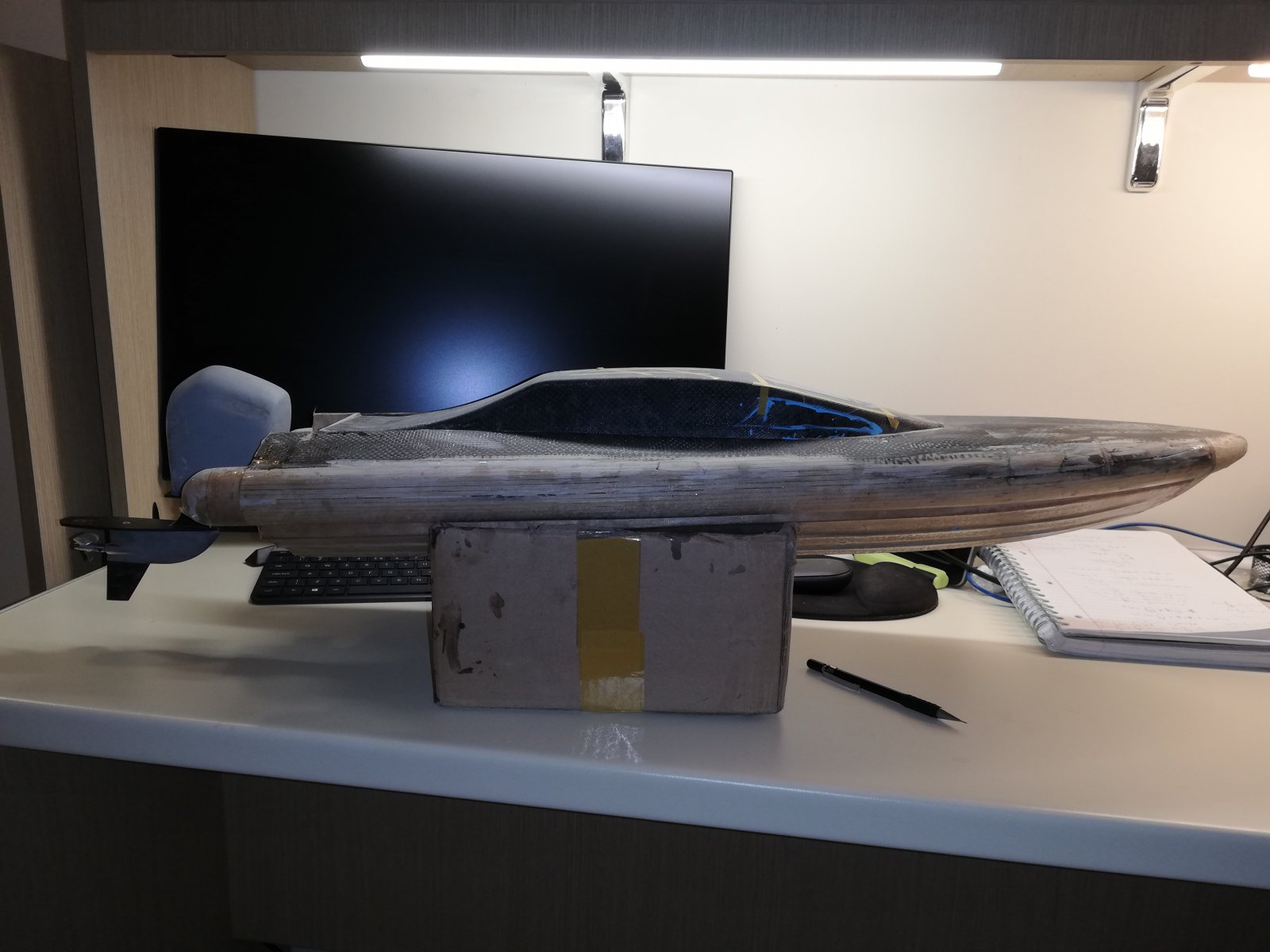

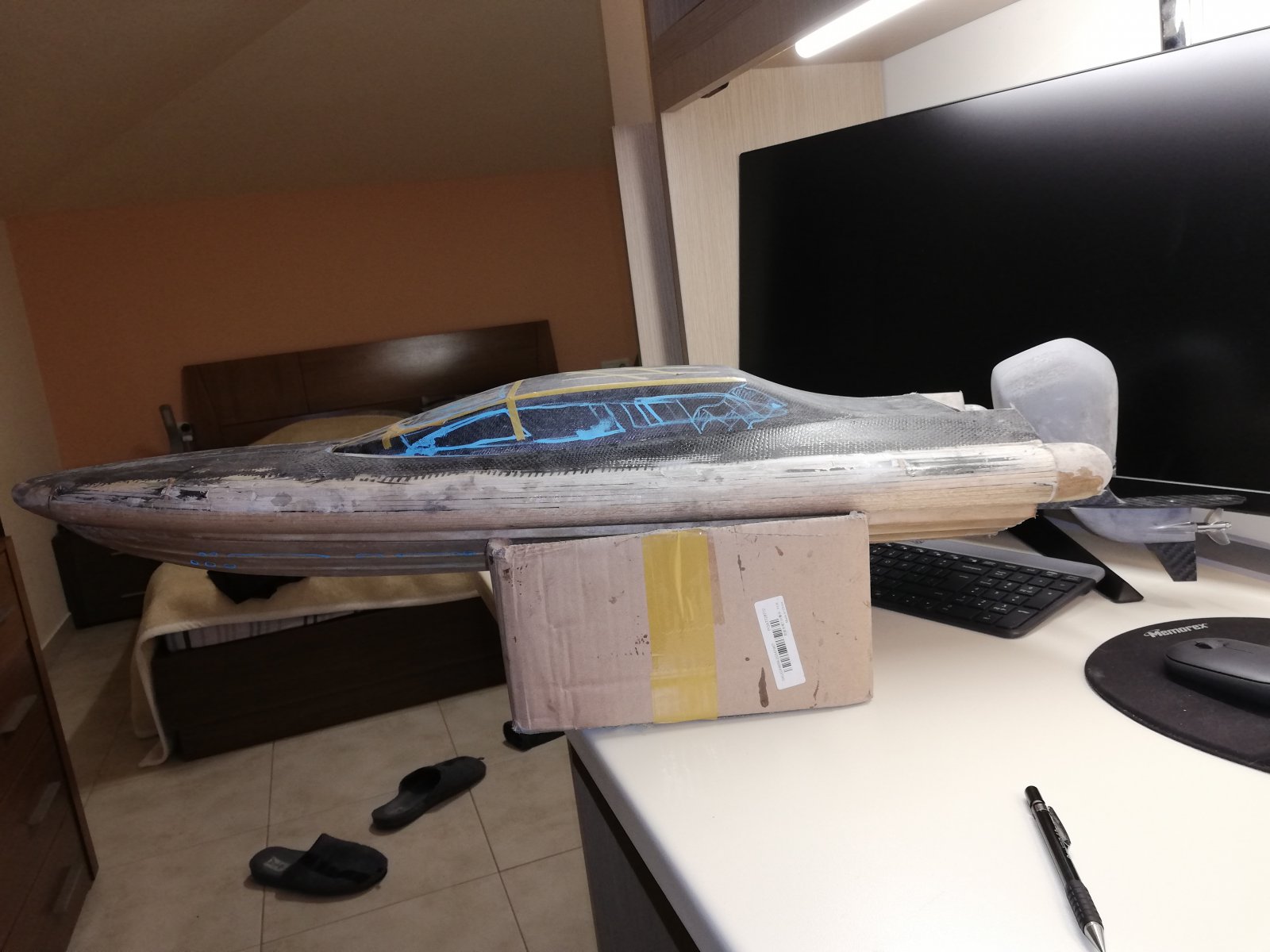

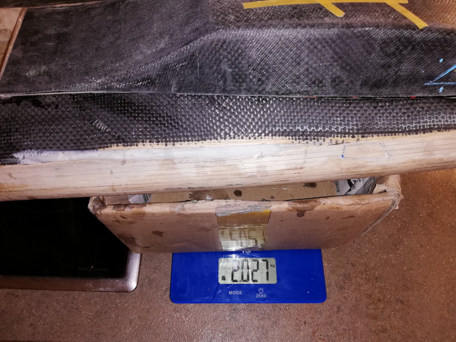

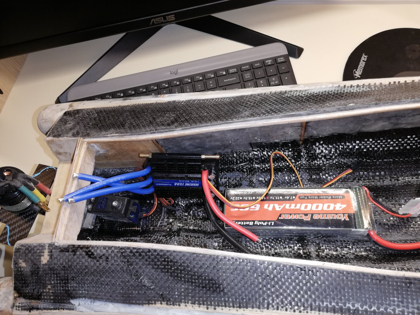

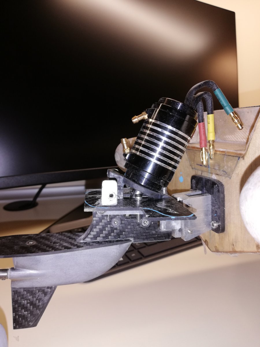

Update #23: securing the cowl on the outboard and mounting the outboard on the transom.
Total weight is about 2 kilos until now.

Looking good Dim! I really like that outboard with the aluminium and cf parts. It became a very nice unit.
Not to mention the boat.. with the stringers still visible at te transom, cf on top.. It looks fast sitting still; it has a nice stance. Great engineering [emoji106]
Oh thank you so much Jan for your kind words:)
It would be great to be fast at the water too ;).
Let's see how it performs, I am very curious for both the outboard and the hull.
Bytheway the cowl has enough room for a 3660 motor so if I want more power an sss 3660 1650 kv 1800 watt would be great.
Thanks Michael :)!!! Yes this is a nice photo.
As I said to Jan in the previous post I am very curious about the performance of both the boutboard and the hull. I hope that what it looks fast is indeed fast when it sails... ;)

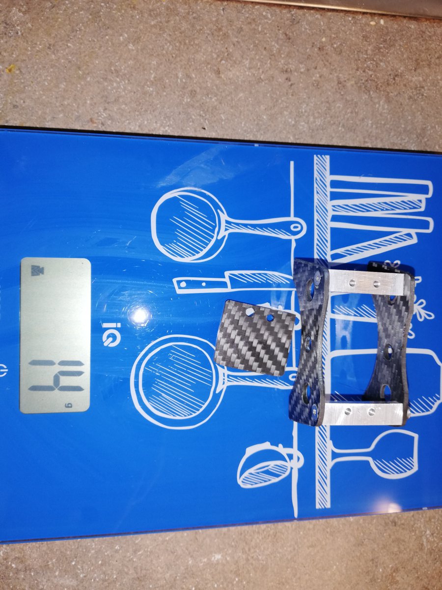

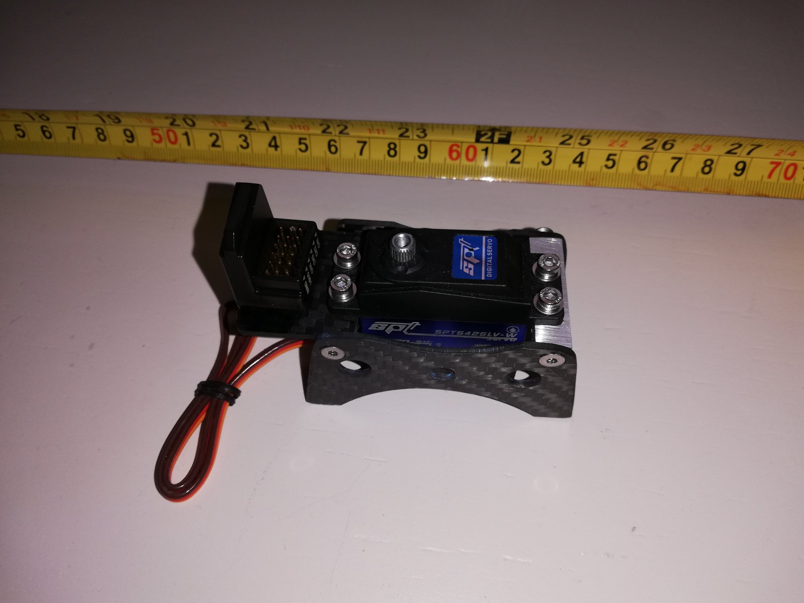

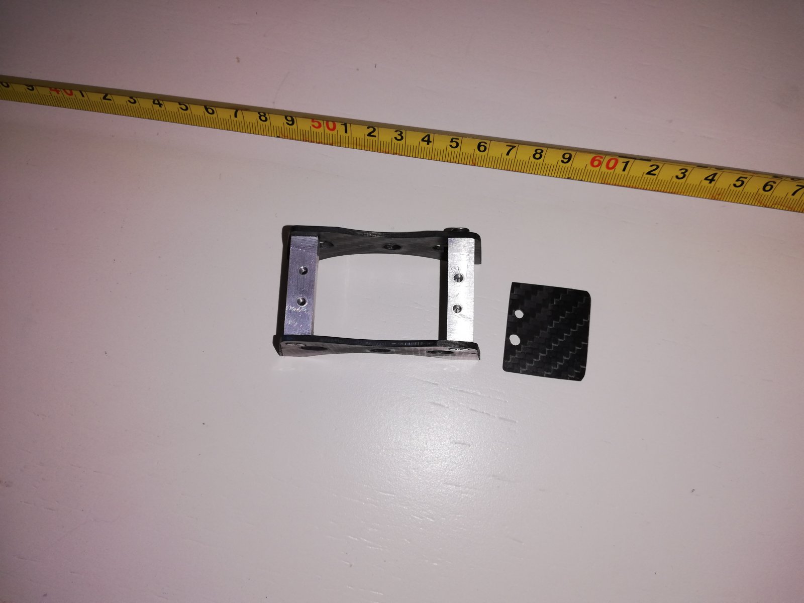

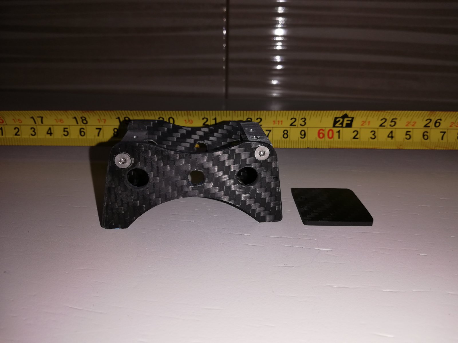

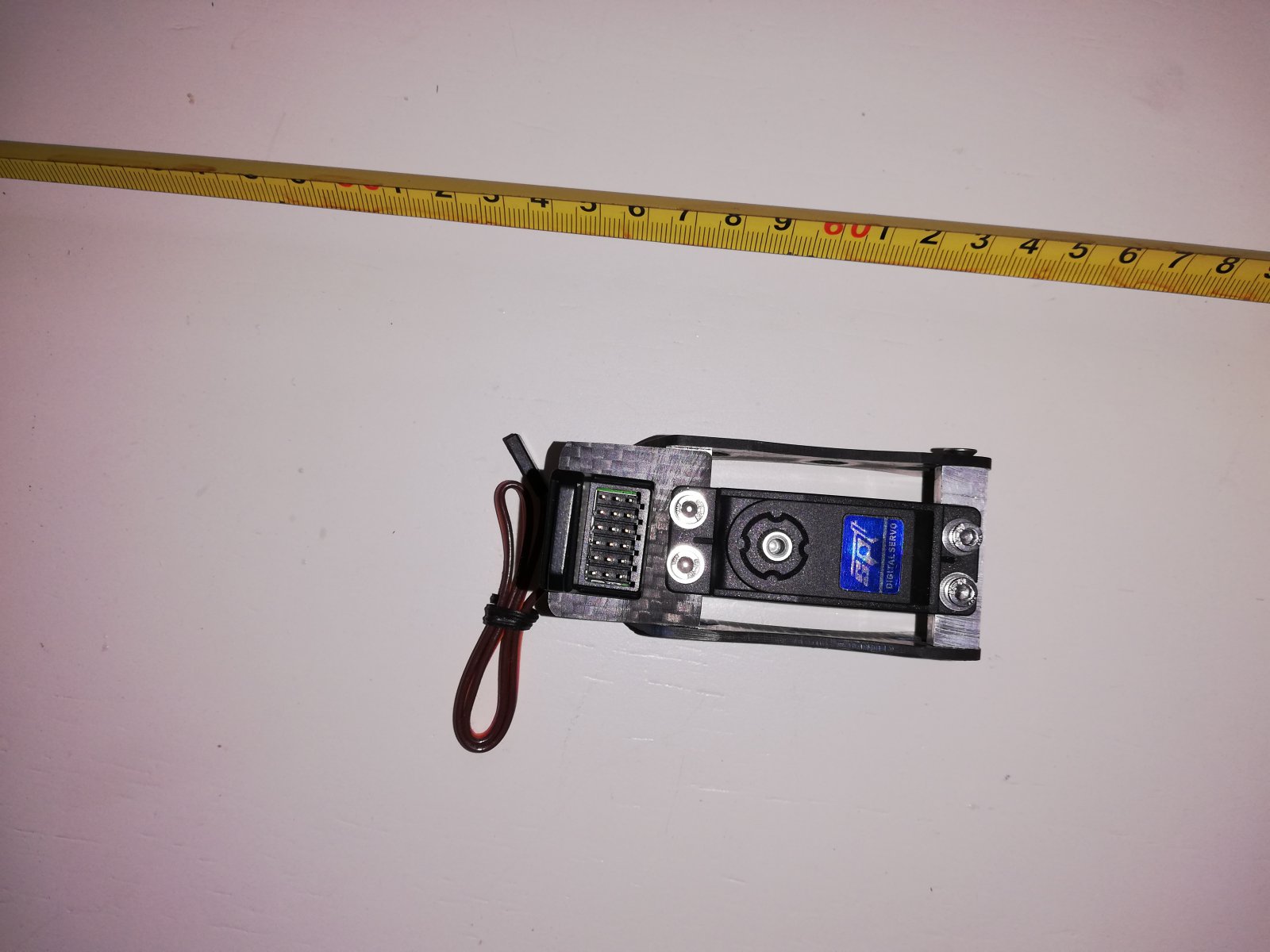

Update #23: DIY radio plate and servo holder.
Hi guys I hope you are having all great time. The weather is getting really warm here in sunny Greece (29 degrees yesterday) and I am looking forward to sail my boats again:koud:. (Bytheway, my Cosy is again on the operation table because on of my cats throw it down from 2 meters height:mad:. Fortunately not big damage).
Let me share with you my latest progress.
It weighs ony 14 gr, light and strong.
Since I made the outboard I feel much more confident when I work with aluminum and cf and I can say that now I love working with these materials.
Bekijk bijlage 489609
