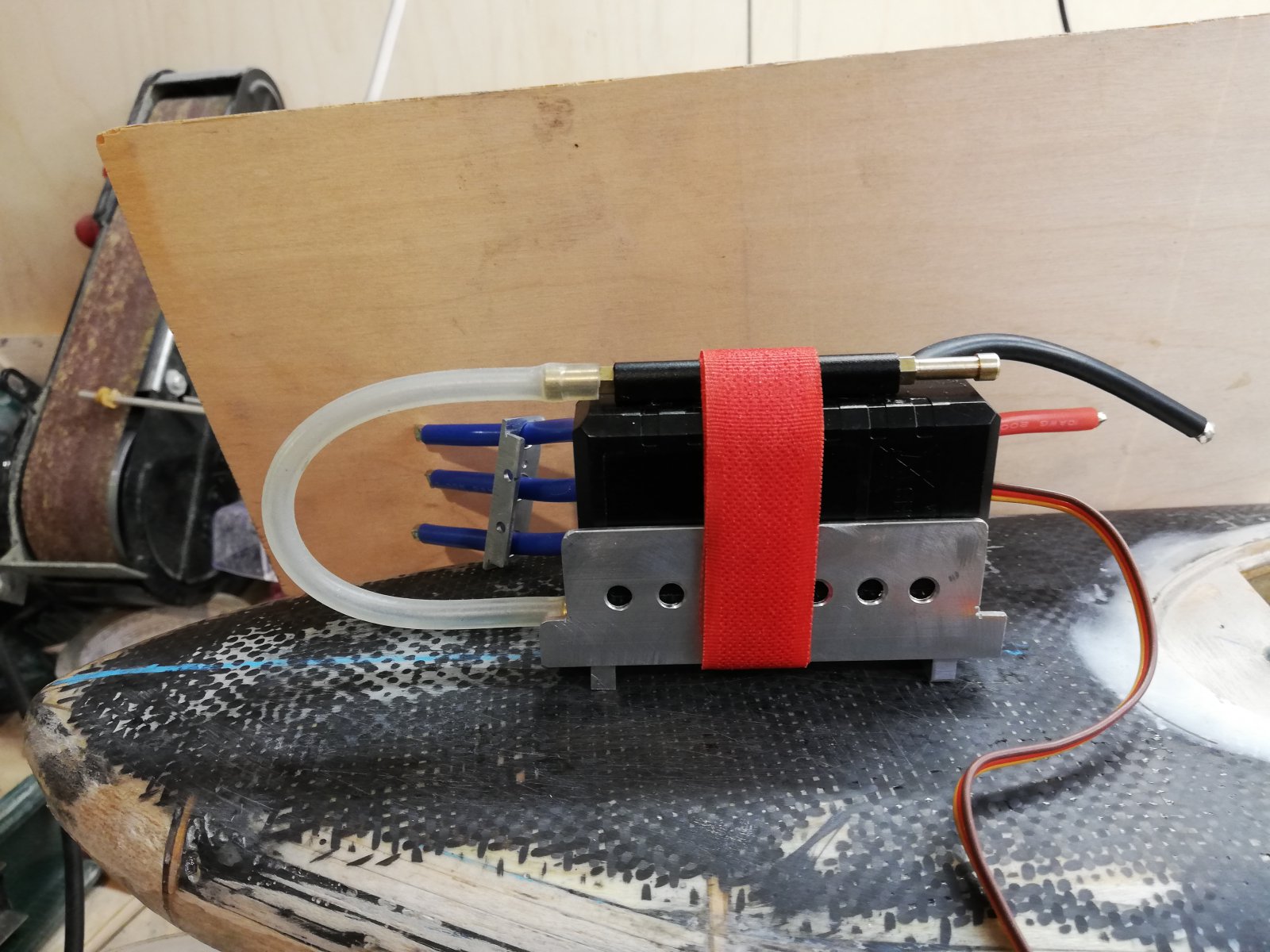

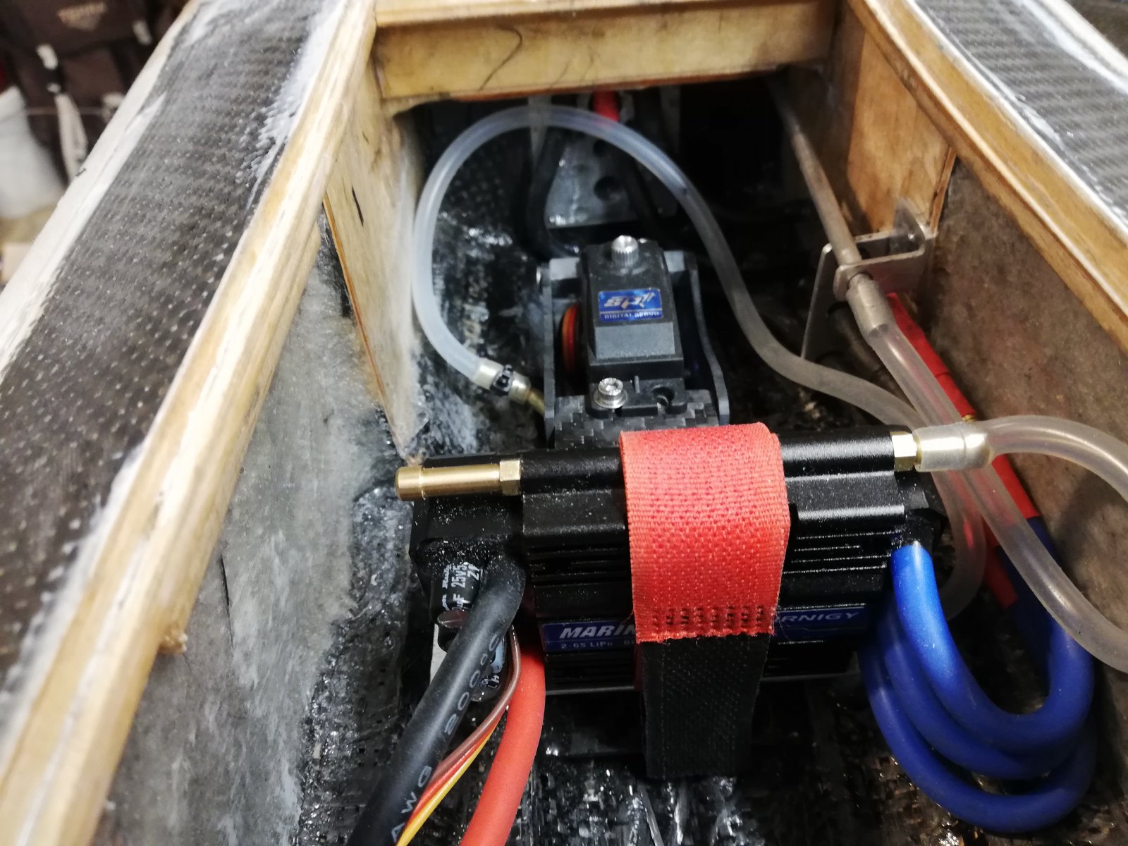

So the Esc and motor get their own cooling system? Not daisy chaining?

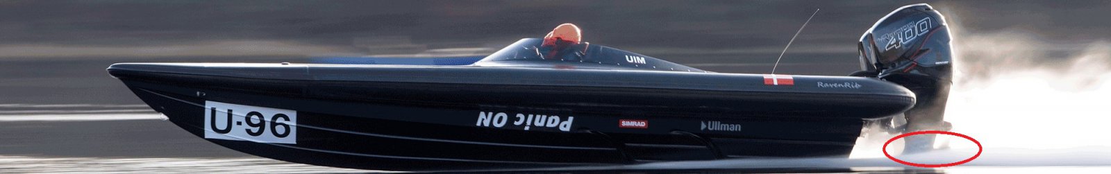

They have one fin. the rest of the craft is flying over the water in ground-effect by a horizontal wing.
They steer by a kind of waterski.
The trick is with the large fin.
Up till 80km/h (reaching cavitation speeds) their is a sharp fin.
Inside this fin there is a super-cavitating fin, which is pulled out of the normal fin at this speed.
Problem is a sailing vessel does not have the power to reach this speed using this high drag super cavitating fins.
(the flat part is the super-cavitating part. it is blunt, not like a knife what you would normally think it would look like)
This cavitating fin as the cross section of a surface piercing racing propeller.
Engines have the horsepower to overcome the initial drag, sailing vessels do not!
