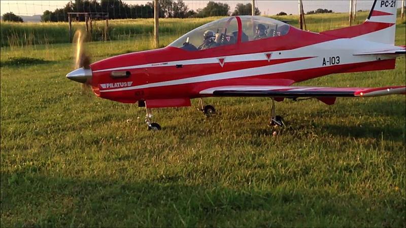

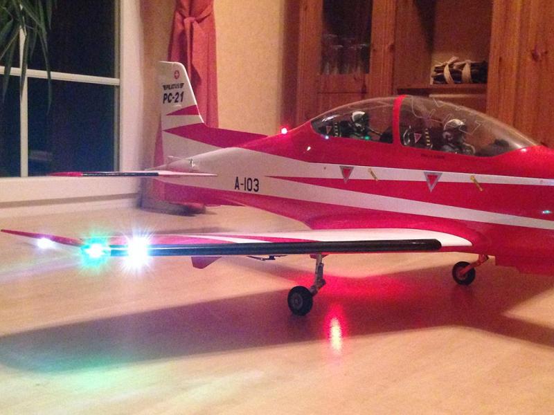

Thanks Jack
The Cockpit is only a printout of a 3D animation. (virtualpanorama.ch - Hier dreht sich alles um 360 Grad) Looks very scale without building a ful scale cockpit (weight&time) If you guys here are interested on scale stuff like this please let me know. Will send the templates for the cockpit, explosion cords etc
Feel free to send an email to joerg.schon@gmx.de
Setup
Hacker A50 L12 v2 on 6s 5000 Turnigy pack
Ramoser Multiblade Prop 12"x15,5" 66A on ground @ 1395W
Regards
Joerg

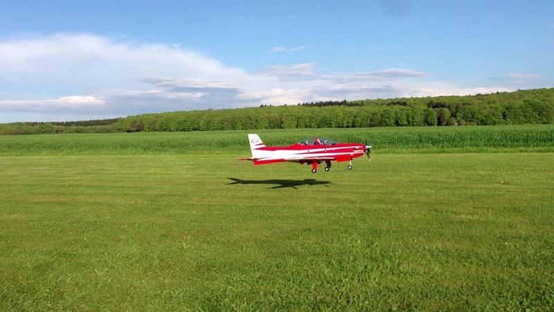

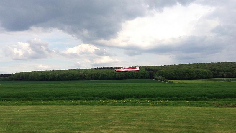

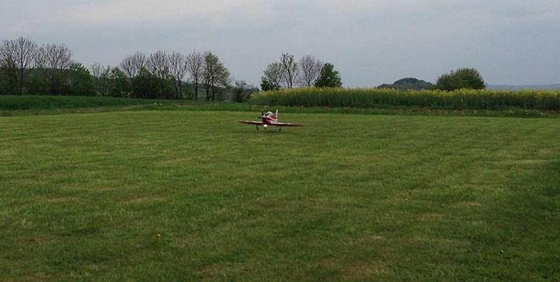

PC21 with 12x15,5 Ramoser 5 blade prop
Hi all
finally got a chance to fly this baby with the 12" blades on Wednesday.
What should I say, it was awesome.
Gave her some more meters on the runway regarding the stall on the prop (15,5" Pitch). To be honest I had some concerns re the thrust ratio of 0,62 but absolutely no issues during take off and once in the air the prop develops it´s full power. Very impressive are low pass fly by´s in full speed mode. Sounds really awesome regarding the higher RPM and Pitch of the prop.
Ok, verticals are limited but I think with this setup the PC is well prepared for dynamic aerobatics and scale flight in terms of the speed, which is approx. 100 mph and looks really scale like. And also the improvements on the main landing gear are successful. The "Kenner" struts are working fine with a good suspension. No bendings during take off and landings on grass in regard to the AUW.
Will also post some vids later.
Some Deails:
Sebart PC21: AUW 4,1kg
Engine: Hacker A50 12L V2 348 R/V on 6s 5000 lipoly
Prop: Ramoser 12" x 15.5" 5 bladed prop, 1390W @ 66A on ground
3700 mah charged after 7,5 min flying time with throttle management
Cheers
Jorg
