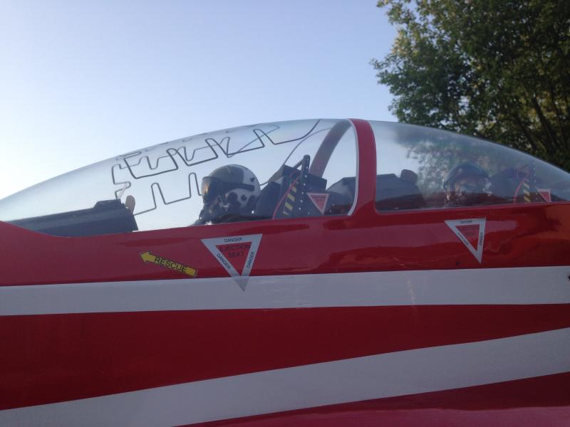

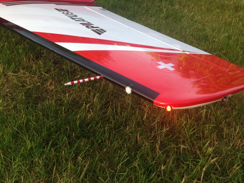

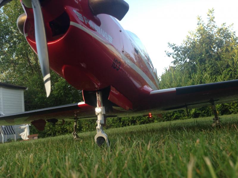

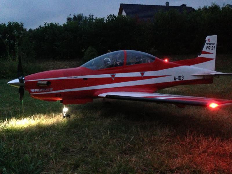

Here Some pictures of The PC 21.
Majestic pics of your bird Jack. You must have a very good fotographer I guess.

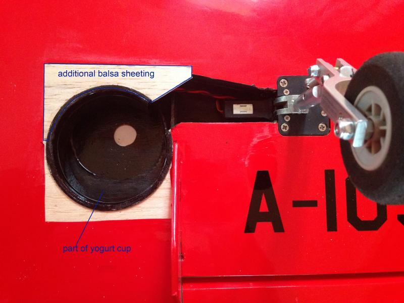

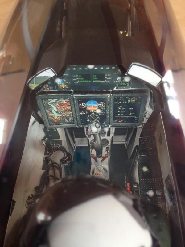

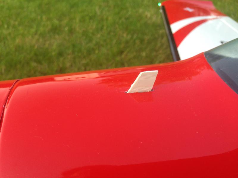

I can´t let it be and I added also some more scale details on mine. Next improvement on my PC21 will be servo operated nose gear doors. In the meanwhile the enlarged main gear bay´s are finished for using 2,5" wheels for better ground handling on grass. It needs approx 1h of work but absolutely worthful if you are operating on a non paved strip.

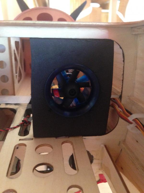

PC21 E-Turbine Sound Module
I have installed a 30mm EDF unit to use it as a sound module to imitate the start up and shut down sequence of the turbine. It also works as a separately cooling for the ESC. Just waiting for an additional 2s Lipo and a small 10A ESC to make it ready for usage.

OK wondering of you get the same result as in the video I was thinking more in the lines of servo delay to be programmed in the transmitter or some servo delay device to add to the second esc.
That was the video I tried to attach earlier on.
