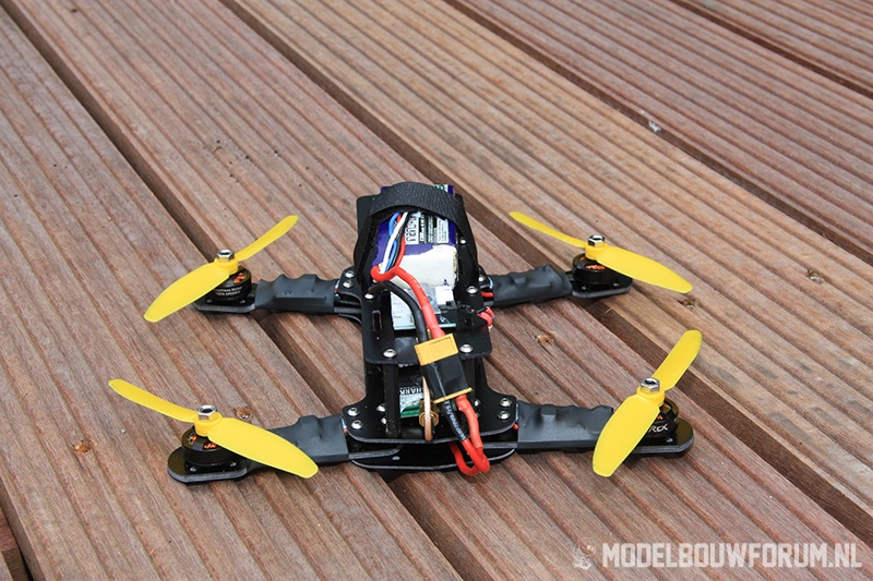

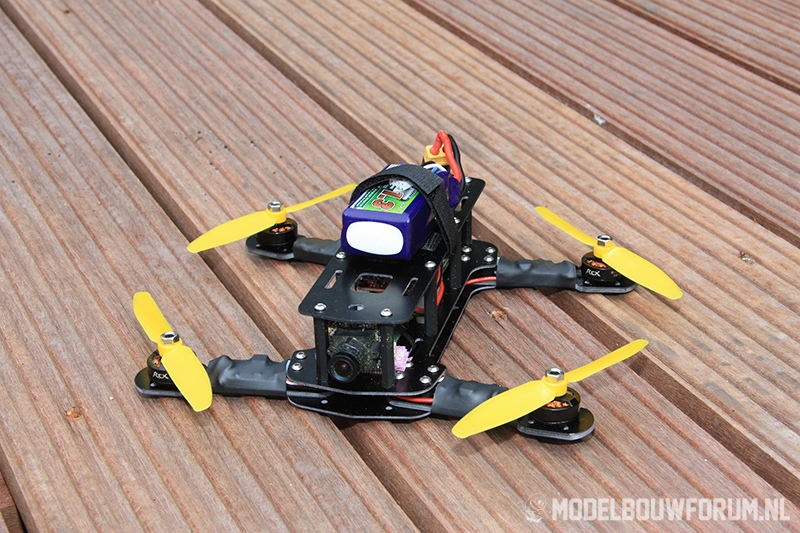

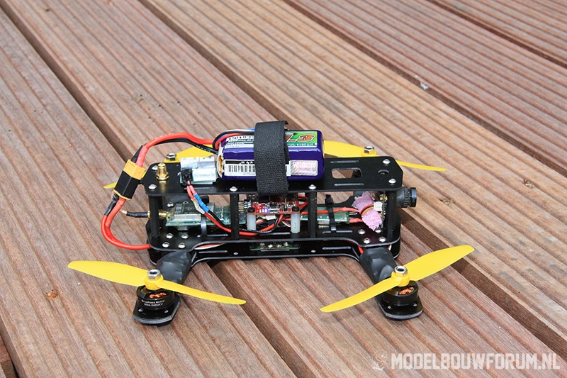

Hier de foto's van mijn nieuwe Mini Spider Hexa Clone:
setup:
Gerard-NL Clone Mini Spider Hexa
Blackout Mini Spider Hex PDB
Cobra 2204 1960kV
HQ prop 5x4
ZTW MANTIS 12A ESC (SIMONK)
Naze 32 ACRO
EzUHF 8 channel light receiver
650 mW 1.3 Ghz TX
Sony TVL600 SuperHAD FPV cam
Gopro Hero3
