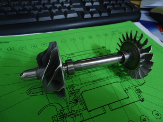

Hello Rik and other colleagues,
Reading your topic and other builders encouraged me to build my own microturbine. ;)
I am also building a MW54. :D
This weekend I made some pieces, which show you. 8-)
I have some doubts, it is a little tricky when you have nobody around here who wants the joy of building, ju st fly! :(
Thus surrender myself to learn with you.
Should I open a new topic? :confused:
full
Hi Edimar
sure you can open a new topic :) We will al help you there, and then you will have your information regarding your turbine together in one topic. I don't mind writing either in english or dutch, it's quite the same for me. I assume you prefer english? ;)
your turbine shaft looks sweet :)
Best regards, Rik
