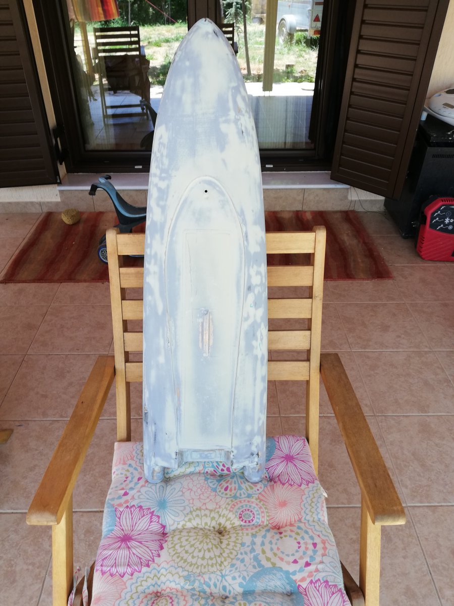

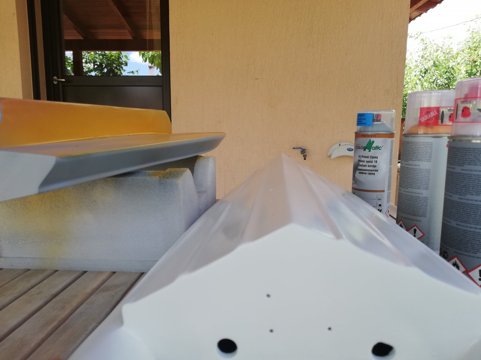

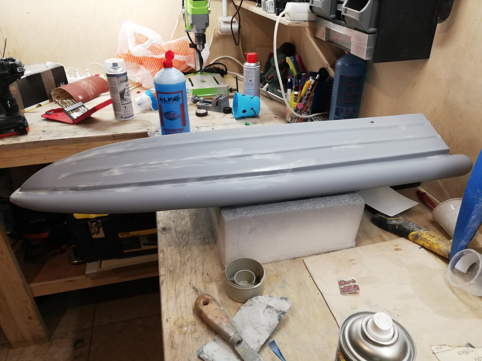

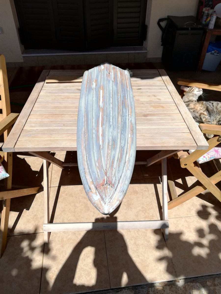

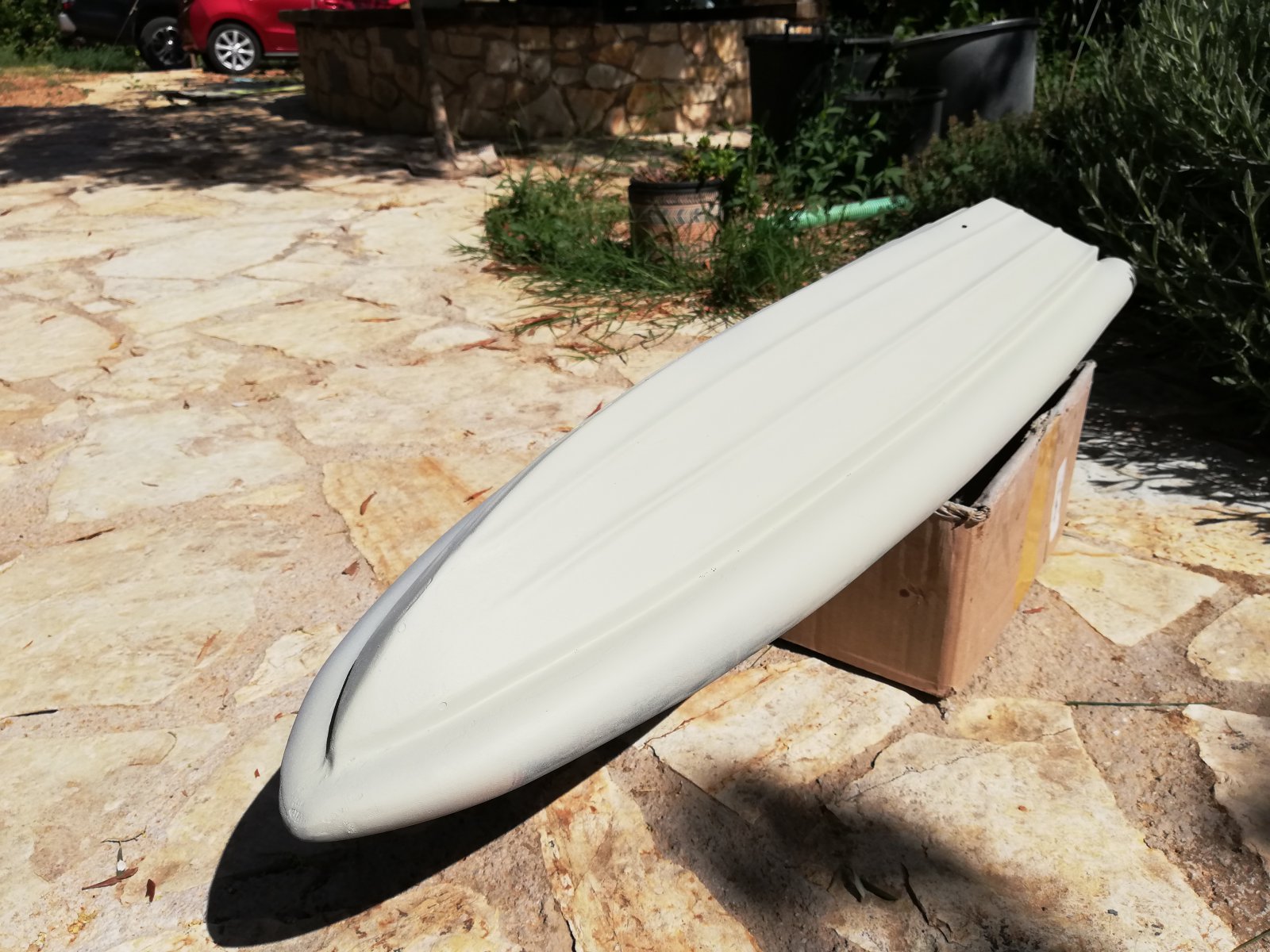

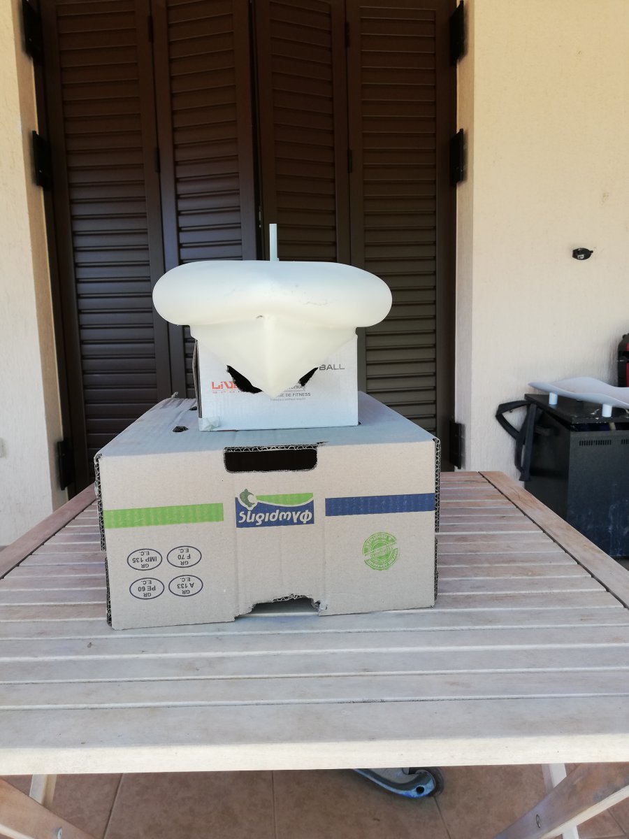

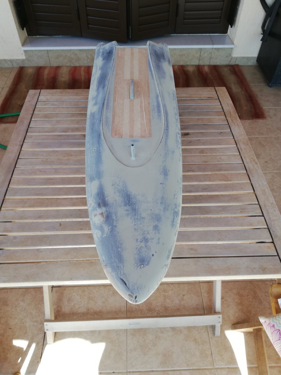

Update #32: First round of sanding...

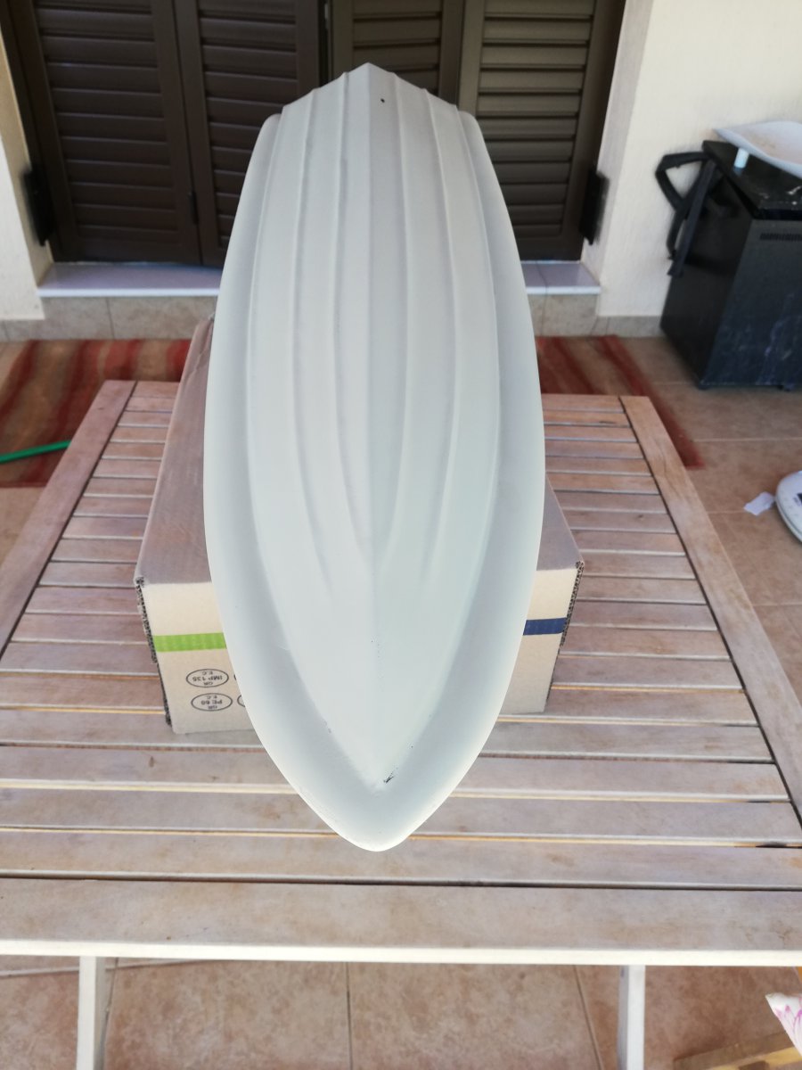

Next, 2nd layer of epoxy primer and spray putty again...
Much better now but still a lot of work to do as it is revealed with @Dirk Jan 's technique... :koud:
Next is epoxy putty. I still haven t found a good technique to apply the putty with minimum residuals... Any ideas?

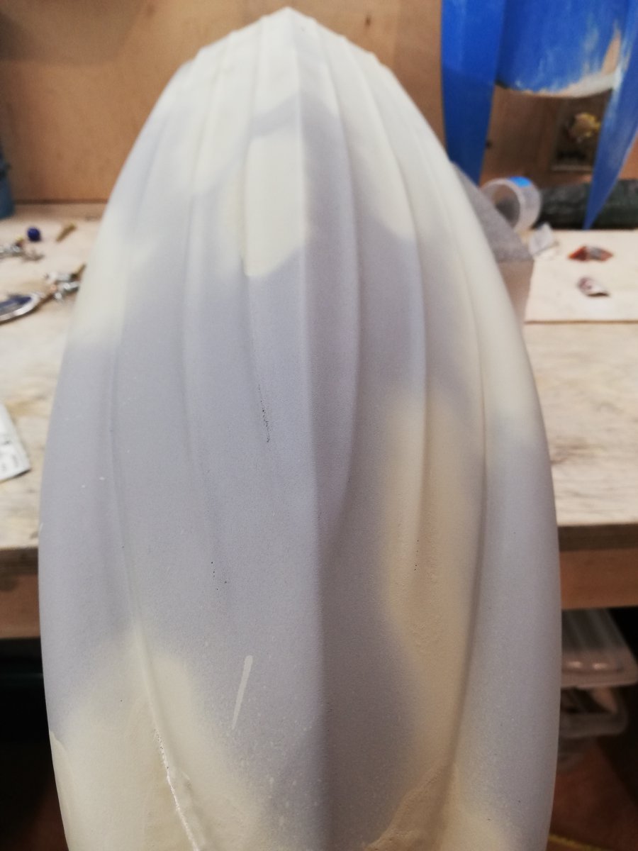

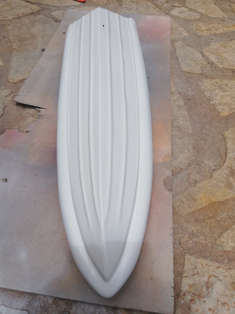

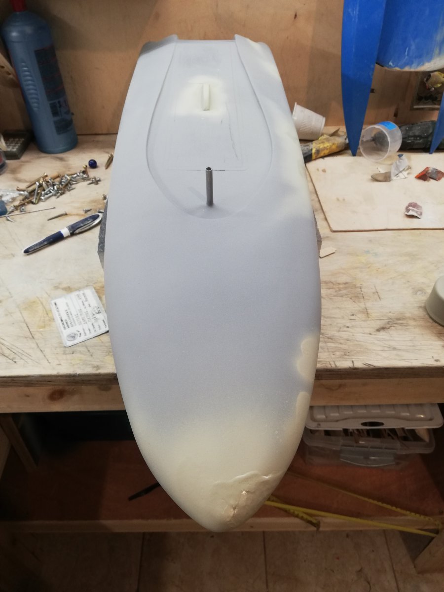

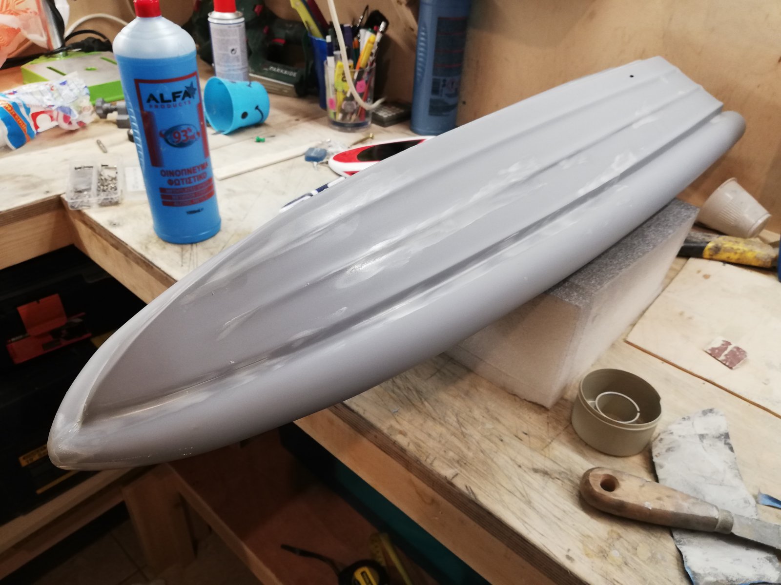

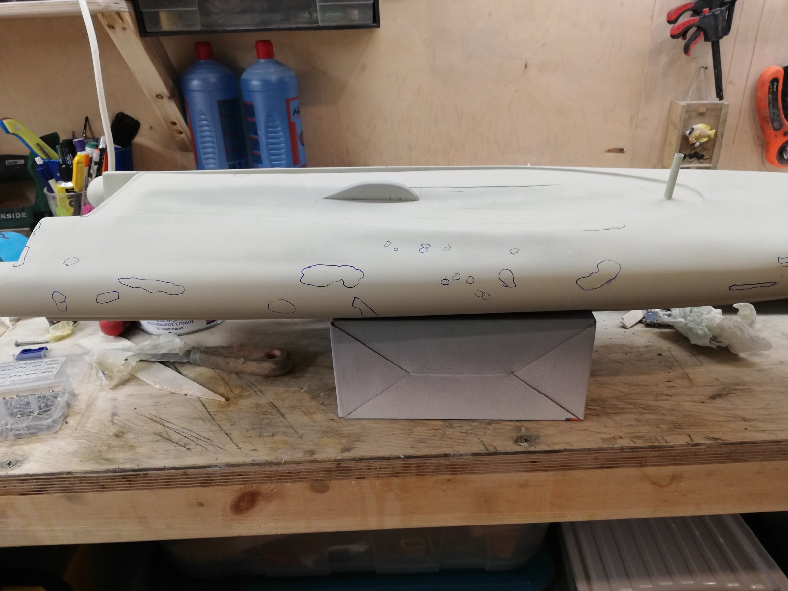

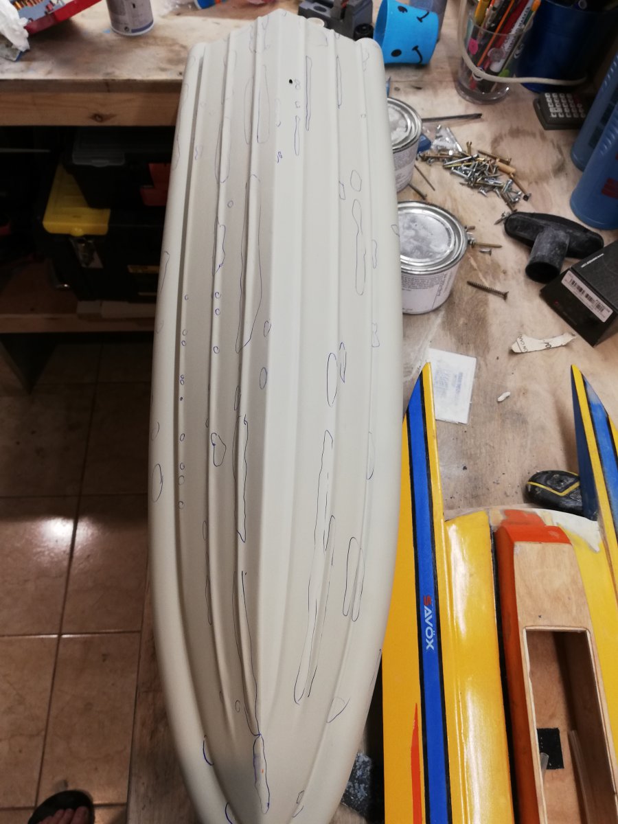

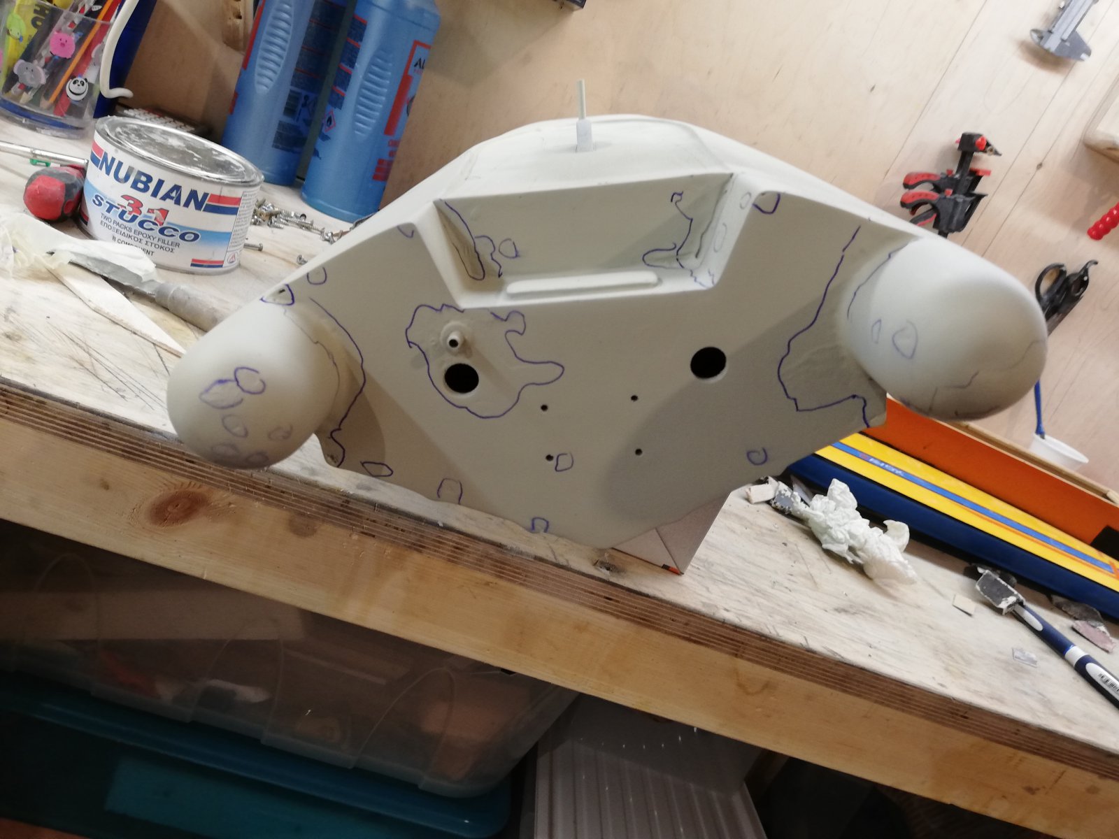

Update #33: 2nd round of sanding, primer and putty again.
This time I applied a thick layer of spray putty only on specific spots on the hull.
Next, I will sand lightly the spots with putty, primer again and hopefully painting...

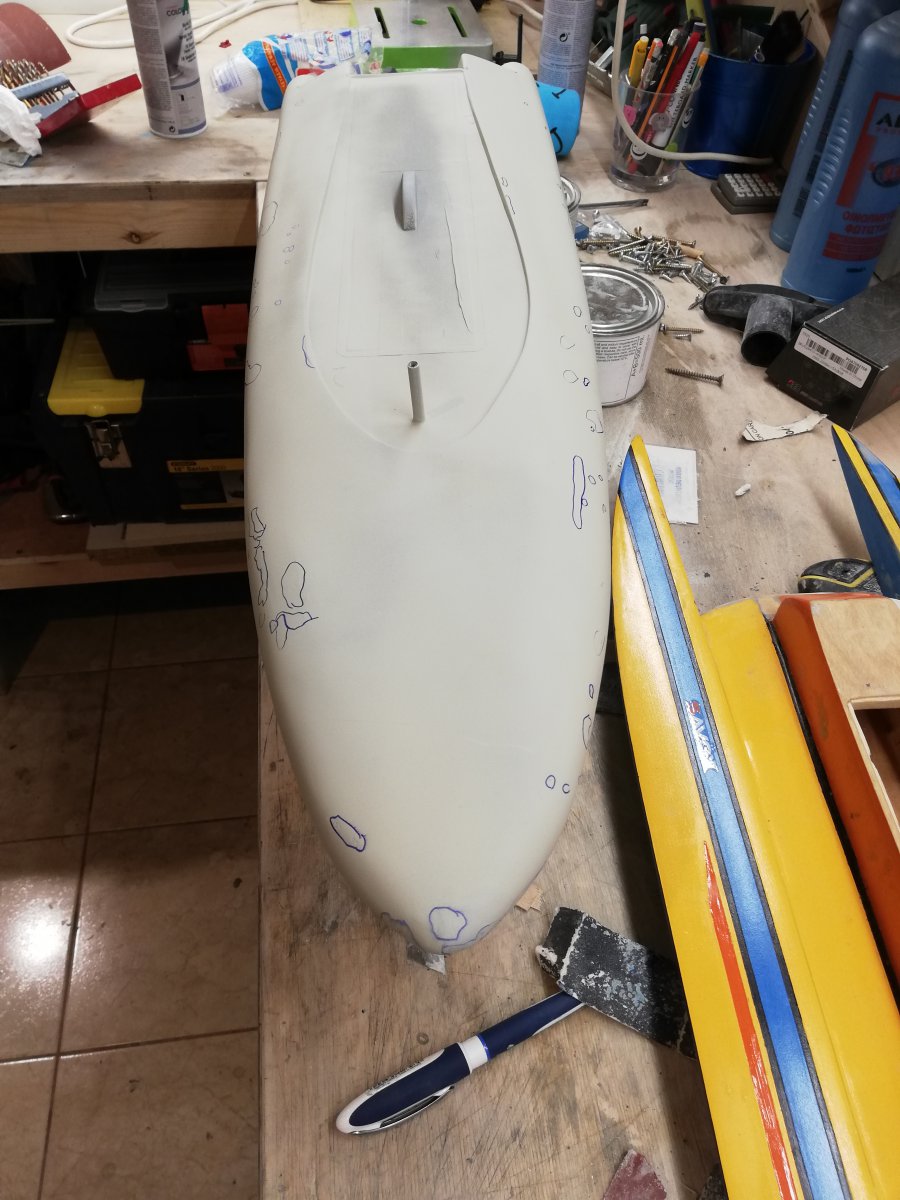

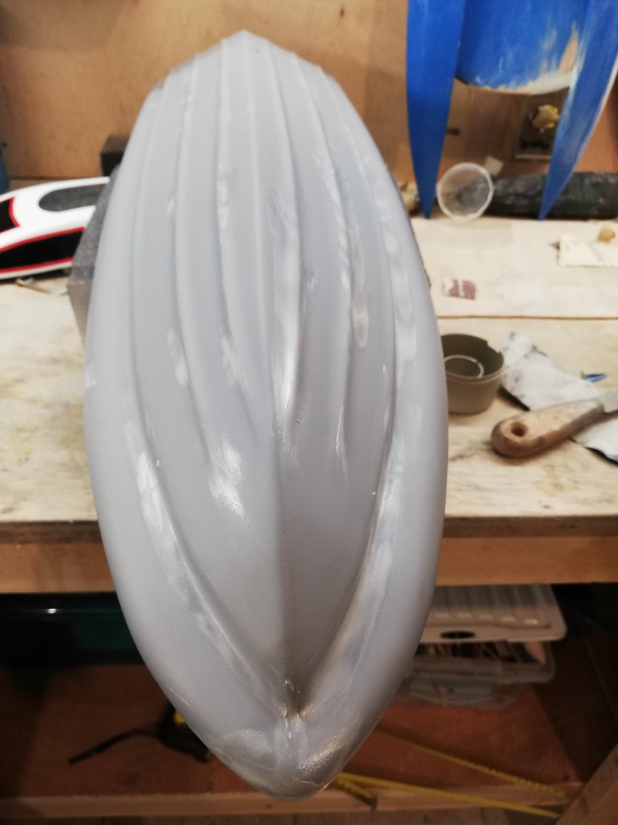

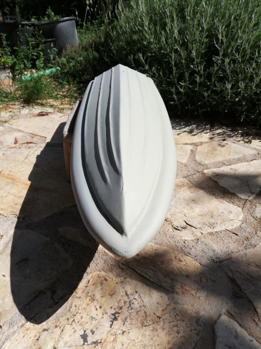

OK... This is the 3rd round of primer-putty-sanding and I still find imperfections... This time I applied epoxy putty with my finger so as to avoid too much putty residuals. I hope that this is the last round... :hammer:
Nice work Dim, it's getting smoother each time!
The trick is to apply putty where required, but to sand it down from the rest of the hull. If you add for example 4 layers of putty at an already smooth surface, it could make the surface less straight and it will add weight.
Thank you Jan for the tip :thumbsup:! You are absolutely right...
Generally this is what I m trying to do, but these spray rails are so difficult to get them 100% smooth... Another tricky spot is between the tubes and the hull...

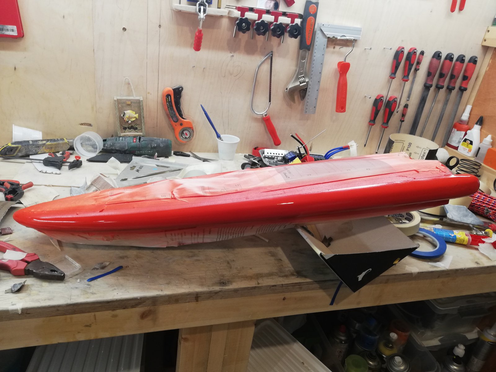

I hope this weekend to be able to paint the hull;)

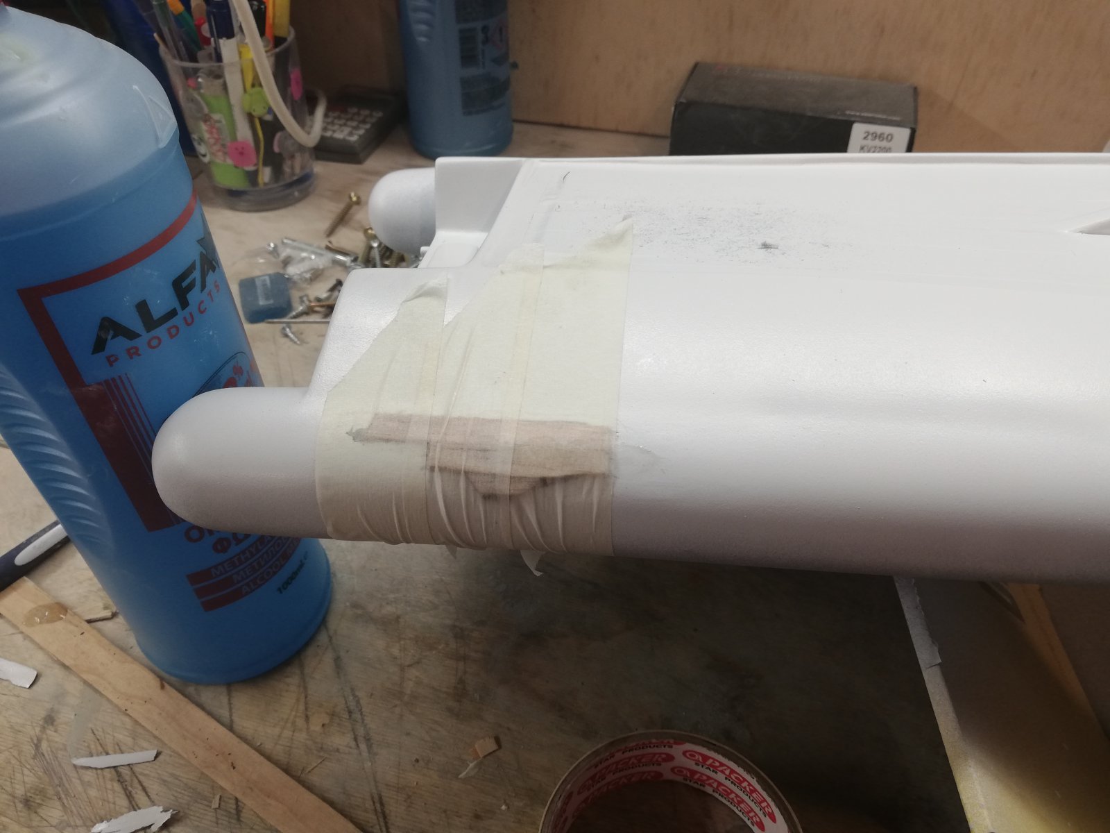

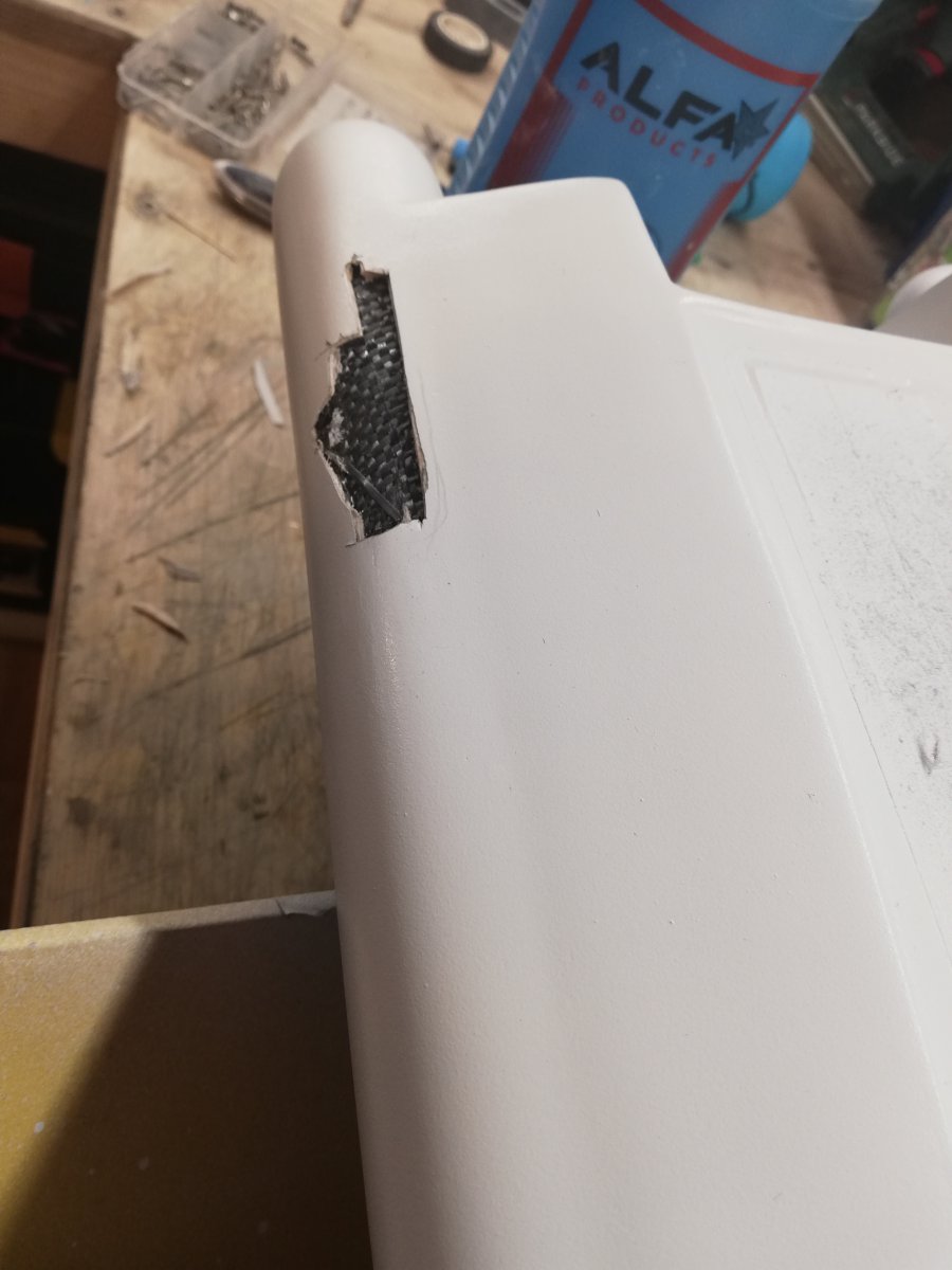

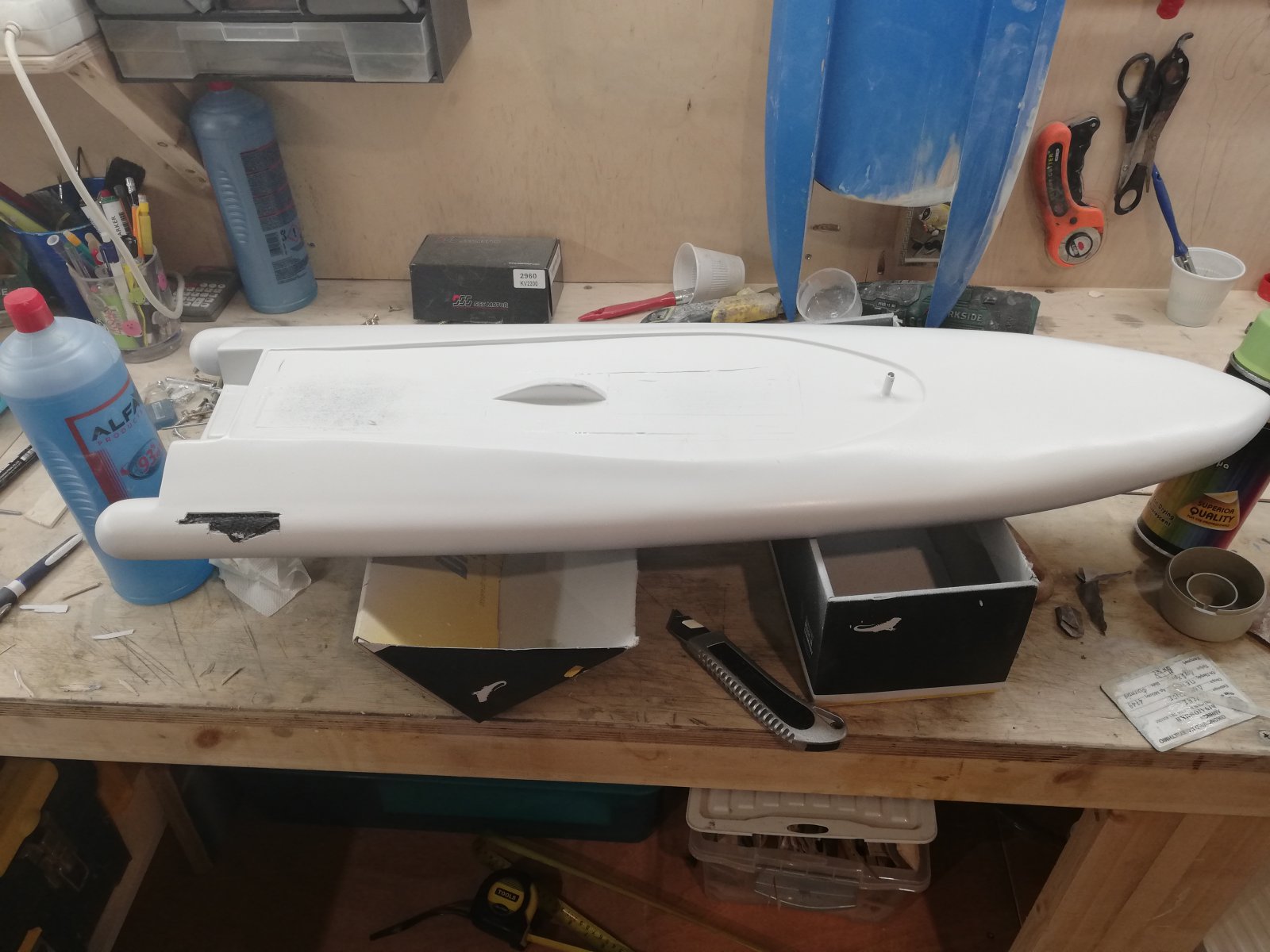

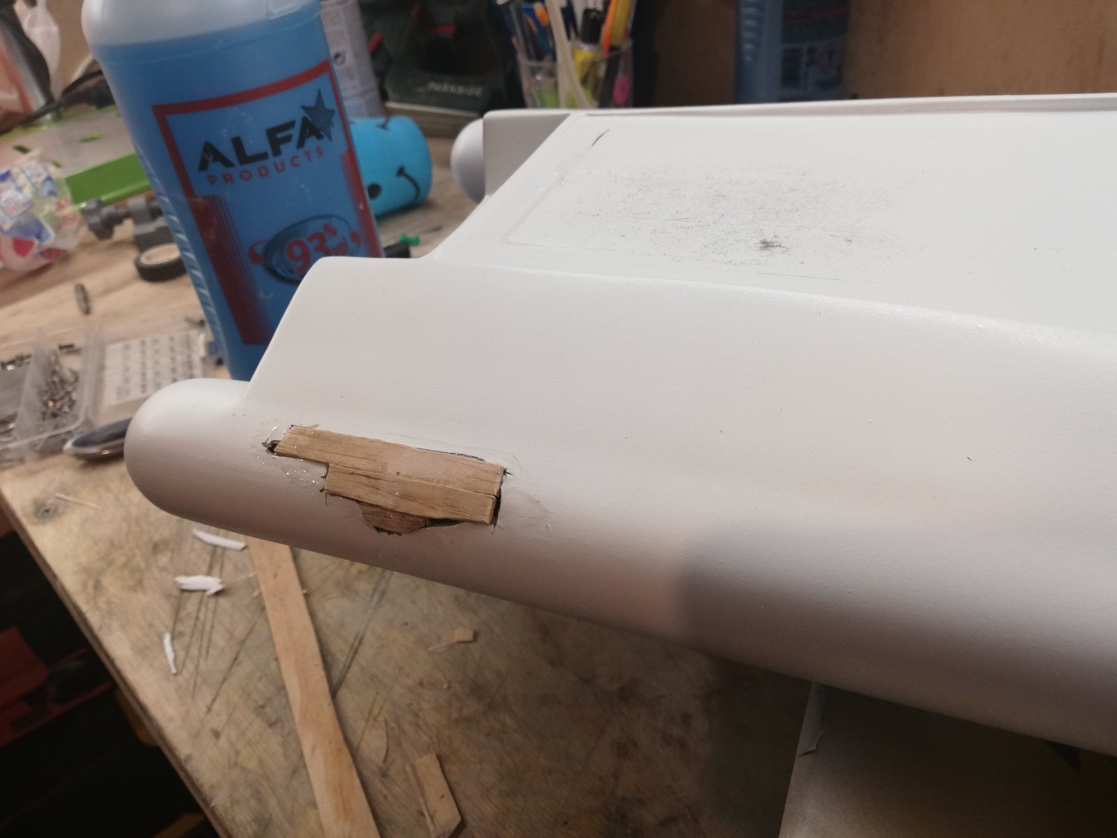

I wasn t lucky today... I started painting the hull and I noticed a very weak spot on the left tube. I decided to strip the balsa off and rebuild it immediately. Fortunately, the inner of the tubes is reinforced with cf so it is not that big issue.
Then sanding, epoxy putty etc....
Ouf... I have enough with building, I can t wait to see it in the water... :confused:
Well, better to discover it now then during the maiden, or even worse when you run it at sea!
Now it is still dry and without the final paint job.
Luck by a unlucky event! ;)

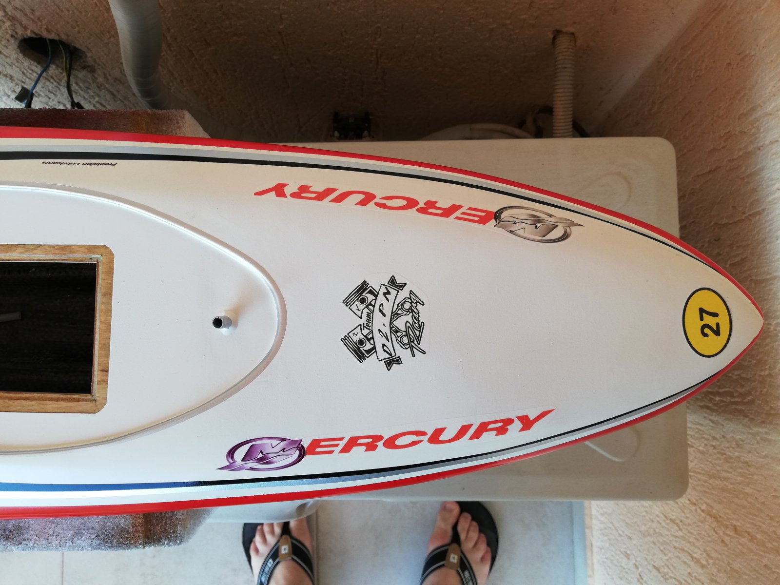

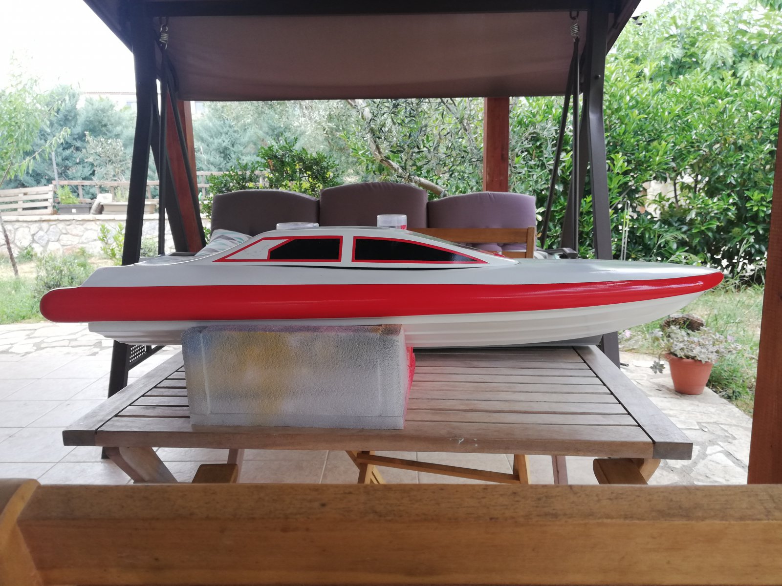

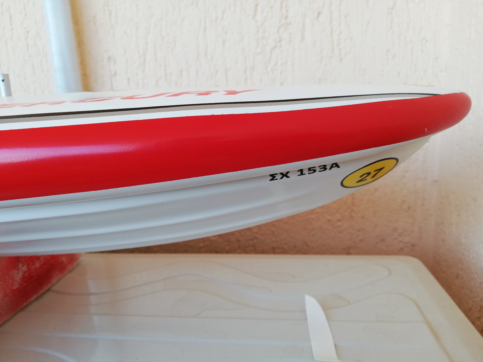

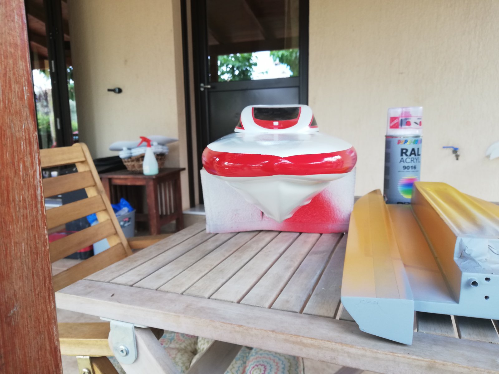

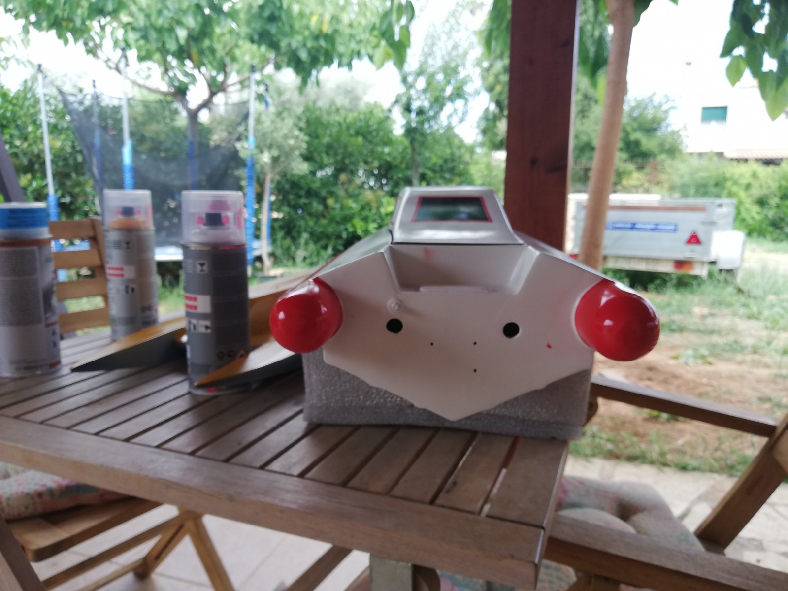

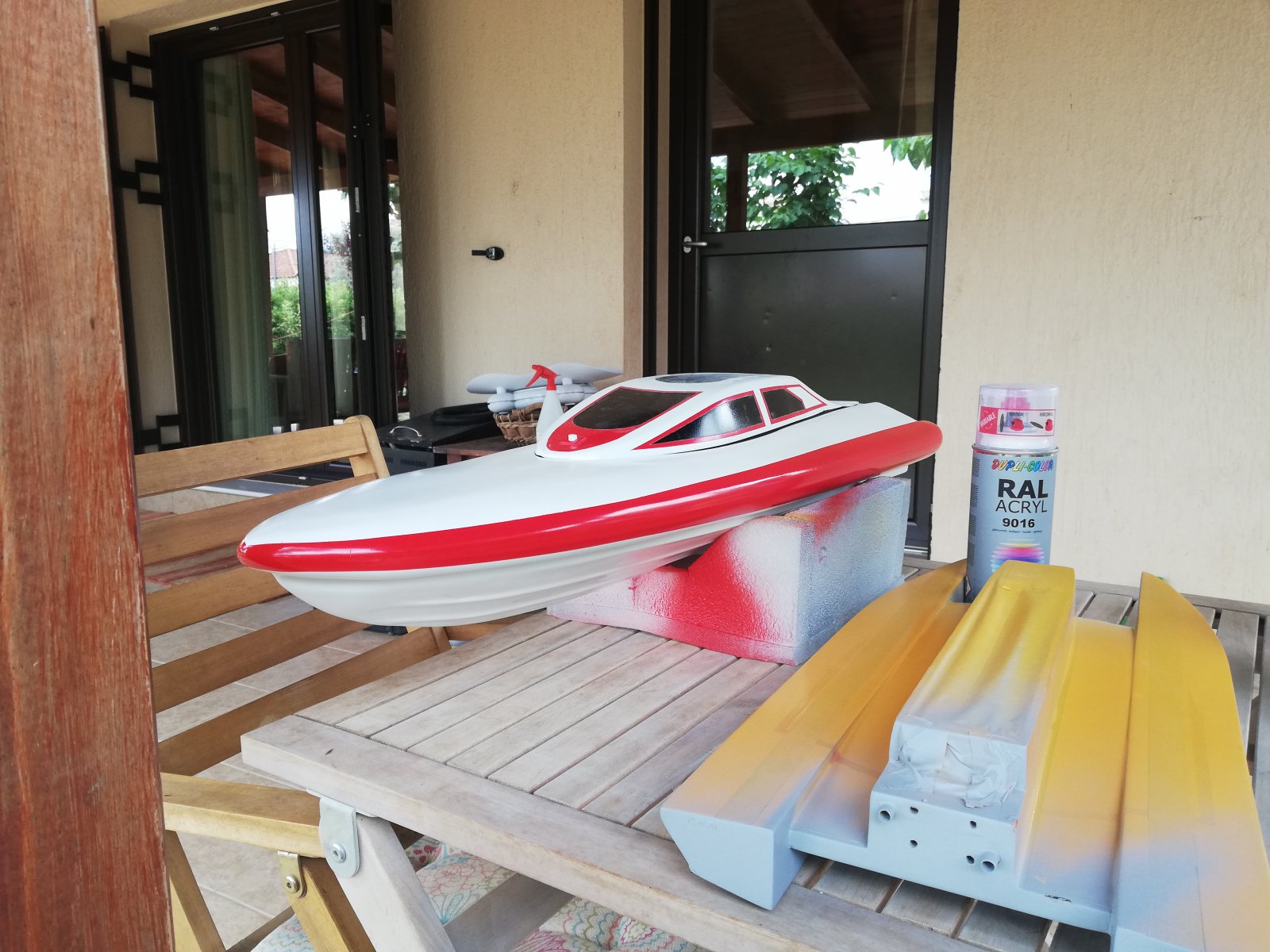

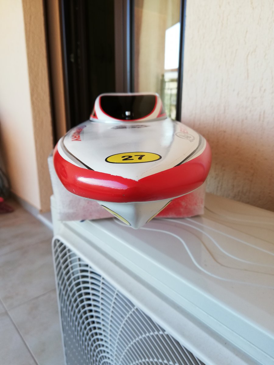

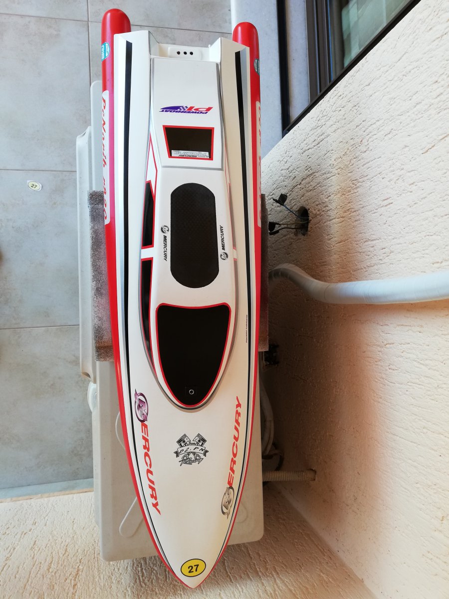

There are still many details to paint plus the decals but the main part of the work has finished.

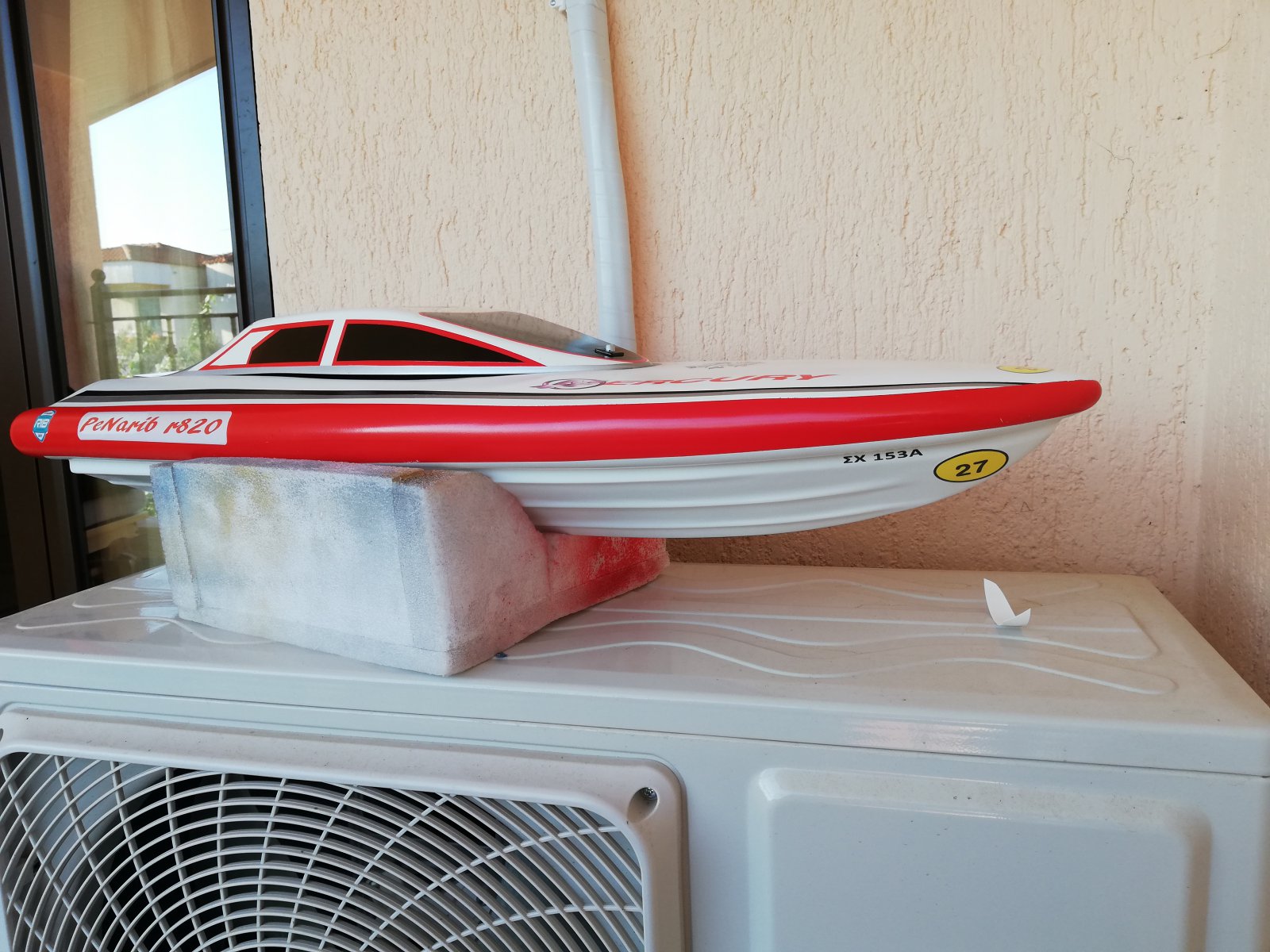

Just a sneak peek of the painting progress and the name of the boat, which is "PENArib r820". PENA is from the first syllable of my sons names (Peter and Nasos), rib is the type of the boat, r is for racing (haha :koud:) and 820 is her total length in mm.
To be continued...
